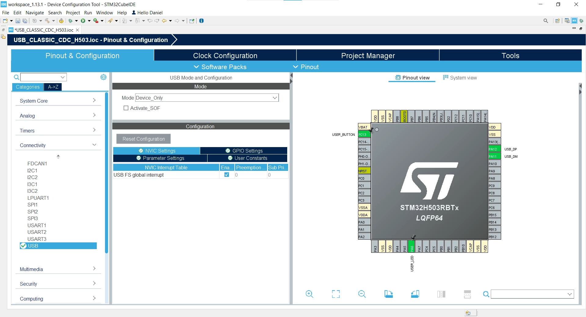

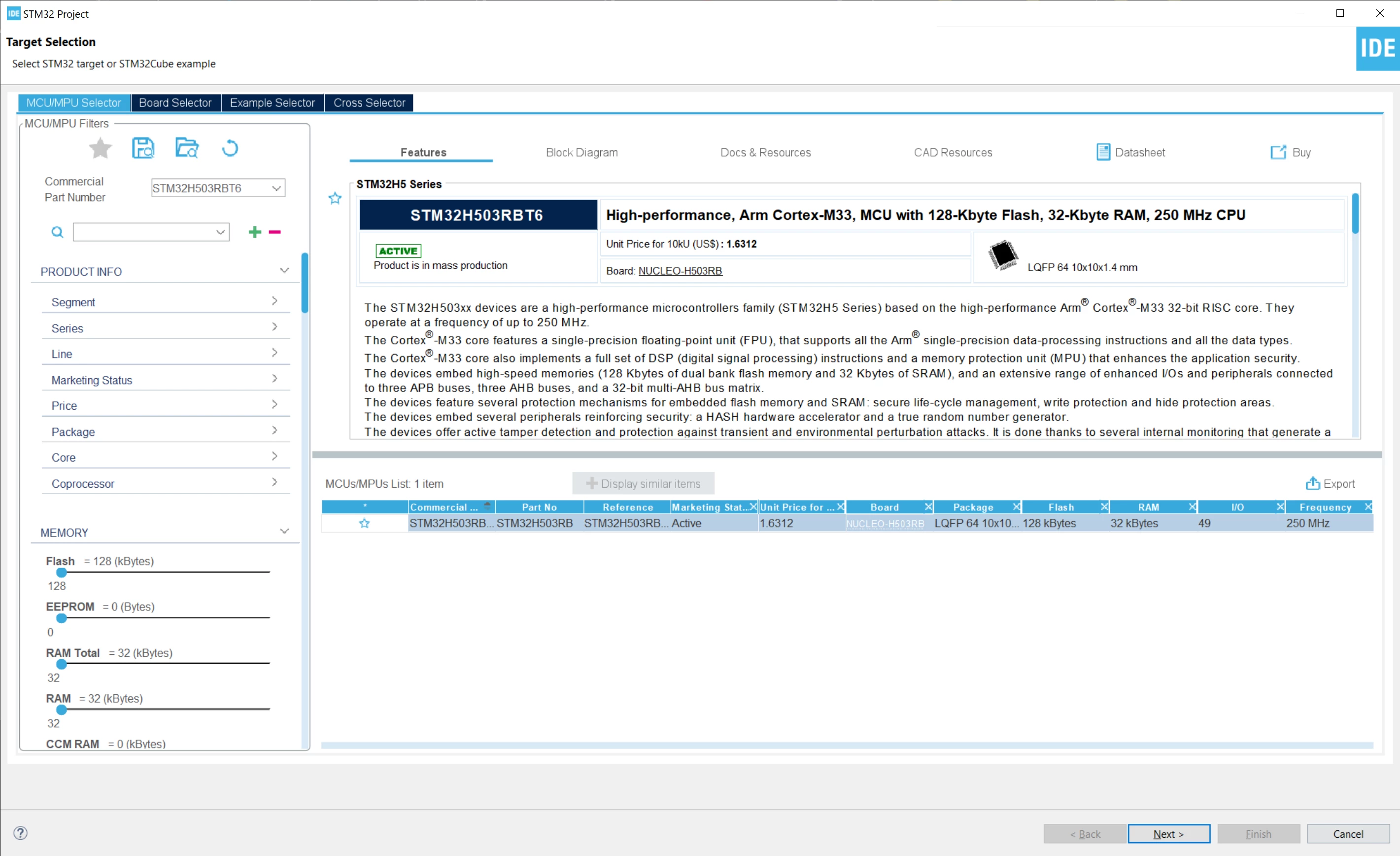

Start by creating a project for the STM32H503RB in the STM32CubeIDE.
Once the project creation is done, enable the USB Peripheral in Device only mode and activate its interrupt in the NVIC Settings tab.

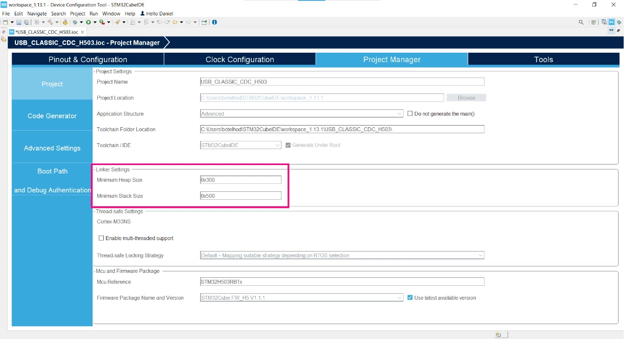

After that, increase the amount of heap and stack size of the project as indicated in the image below, this action can be done in the Project Manager tab:
After doing that, generate the code by clicking on the highlighted icon, or just pressing the alt + K shortcut.

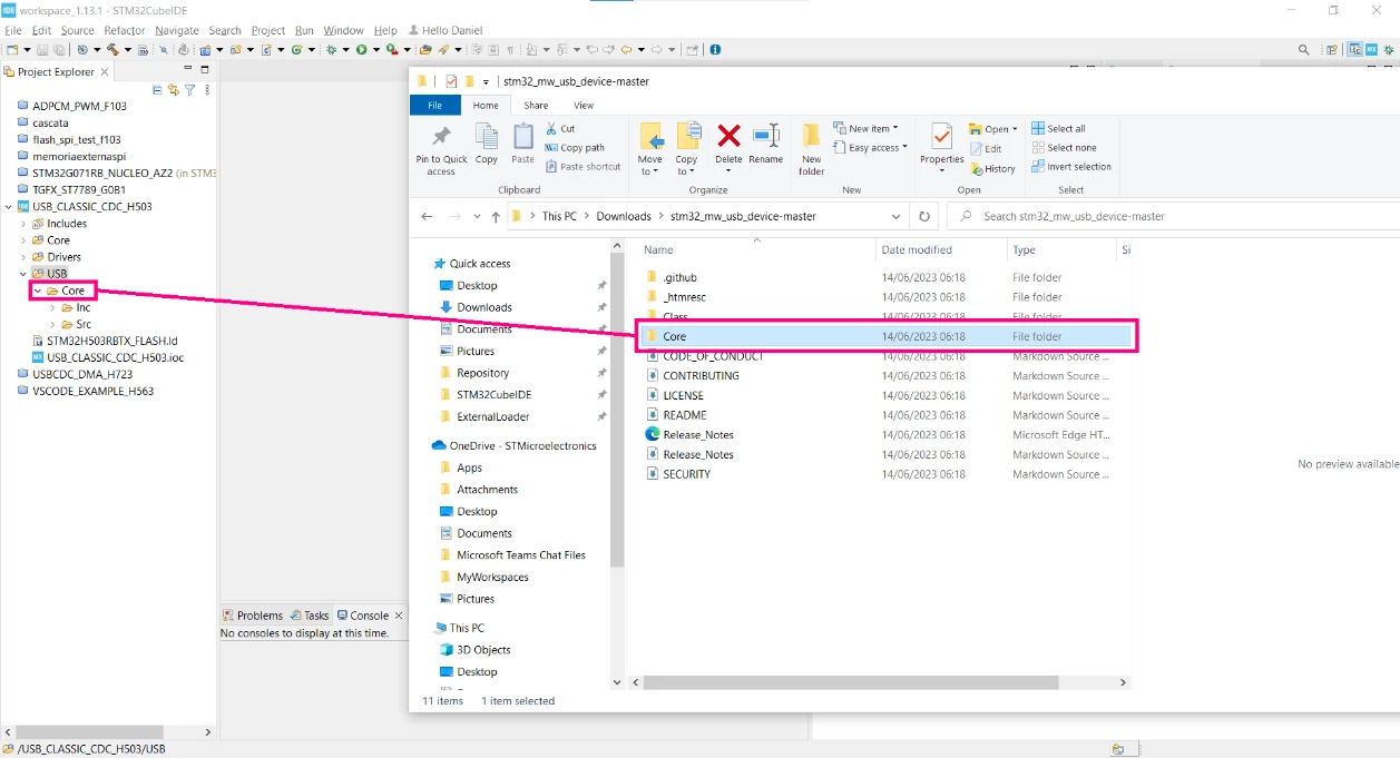

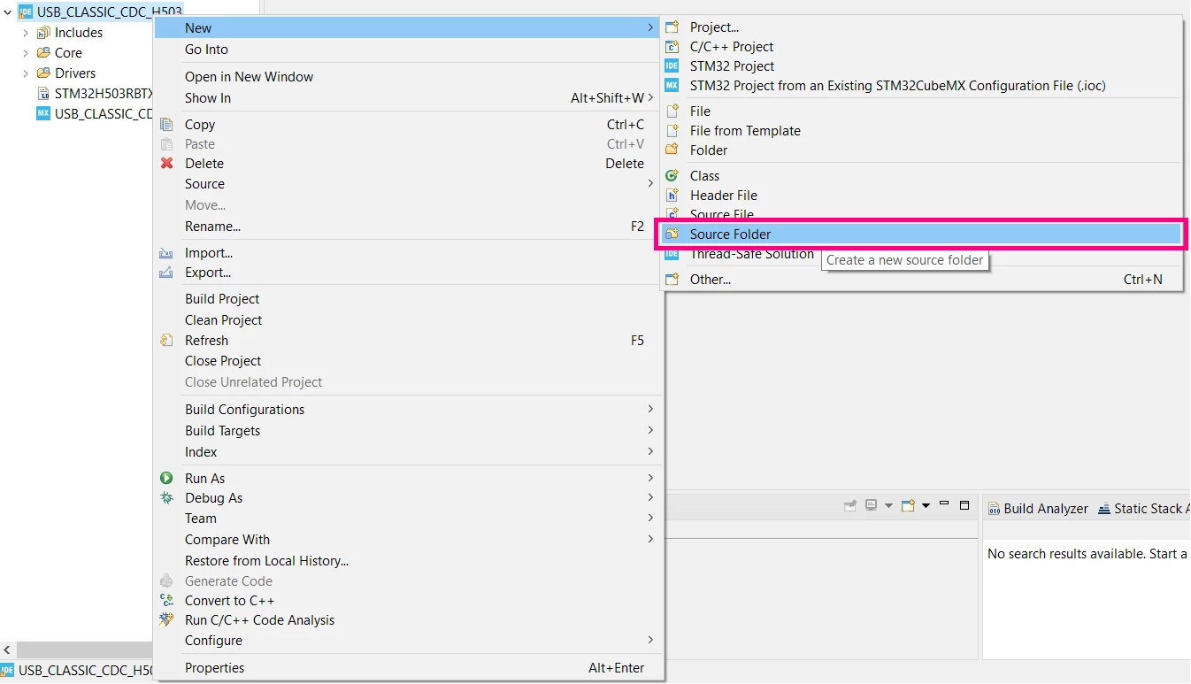

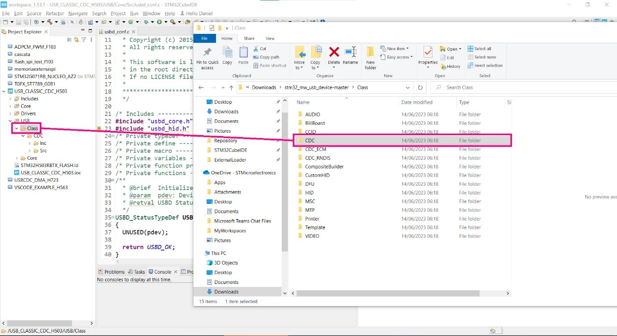

Once the code is generated, create a source folder in your project called USB.
Download the USB Device package from the GitHub (the same link presented in the introduction of this article). Open the software pack folder and import the Core folder into the created ‘USB’ folder.
Now, create another folder called ‘Class’ and import the desired classes to your project, in this case, the CDC is the only one selected.

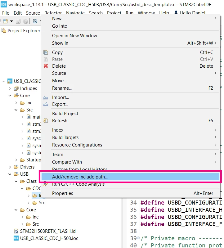

Add the path to the include reference. Right click in the ‘Inc’ folder inside the USB/Class/CDC/.. path, then select `Add/remove include path…` option, and in the pop-up menu, press OK. Perform the same steps for the USB/Core/Inc as well.

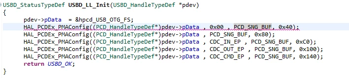

Finally, implement the code to perform the driver link for the STM32H503:
USBD_StatusTypeDef USBD_LL_Init(USBD_HandleTypeDef *pdev)
 pdev->pData = &hpcd_USB_DRD_FS;
 HAL_PCDEx_PMAConfig((PCD_HandleTypeDef*)pdev->pData , 0x00 , PCD_SNG_BUF, 0x40);
 HAL_PCDEx_PMAConfig((PCD_HandleTypeDef*)pdev->pData , 0x80 , PCD_SNG_BUF, 0x80);
 HAL_PCDEx_PMAConfig((PCD_HandleTypeDef*)pdev->pData , CDC_IN_EP , PCD_SNG_BUF, 0xC0);
 HAL_PCDEx_PMAConfig((PCD_HandleTypeDef*)pdev->pData , CDC_OUT_EP , PCD_SNG_BUF, 0x100);
 HAL_PCDEx_PMAConfig((PCD_HandleTypeDef*)pdev->pData , CDC_CMD_EP , PCD_SNG_BUF, 0x140);
 return USBD_OK;

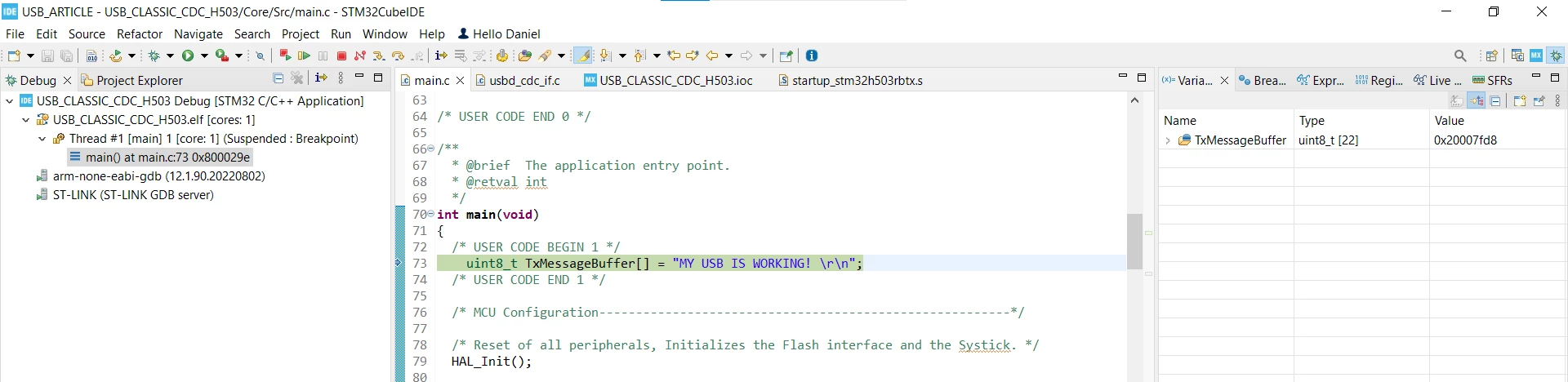

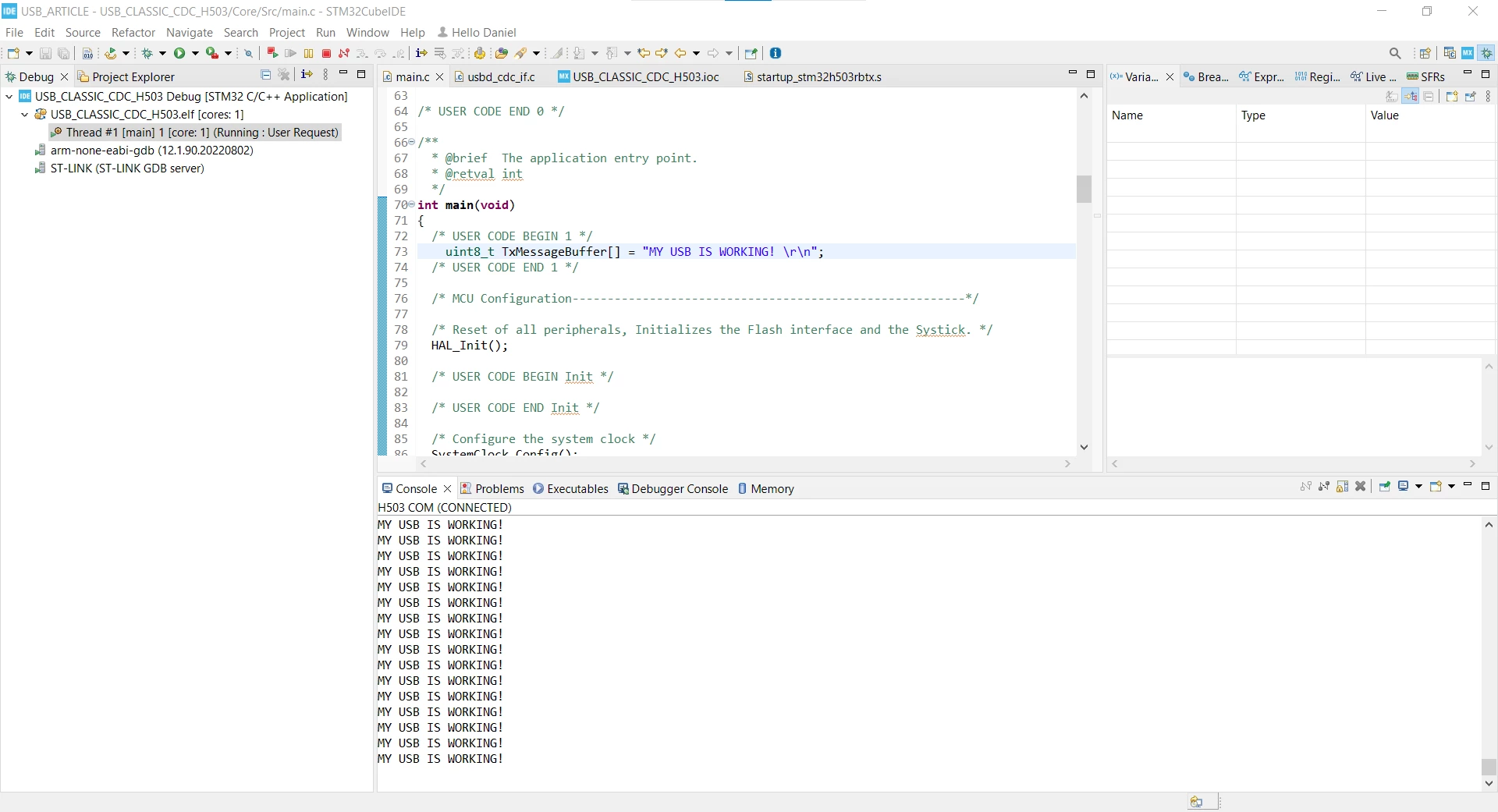

Now that you know how the demo works, let us try it. So, build (you should get zero errors and zero warnings) then click on the Debug button and wait for the debug session to be opened. Your STLINK might request to be updated. You can do so and then issue to debug again once it is completed.
Wait until the code reaches the breakpoint in the first line of the main function:
Then click on Resume, or press F8 to let the application start to run:

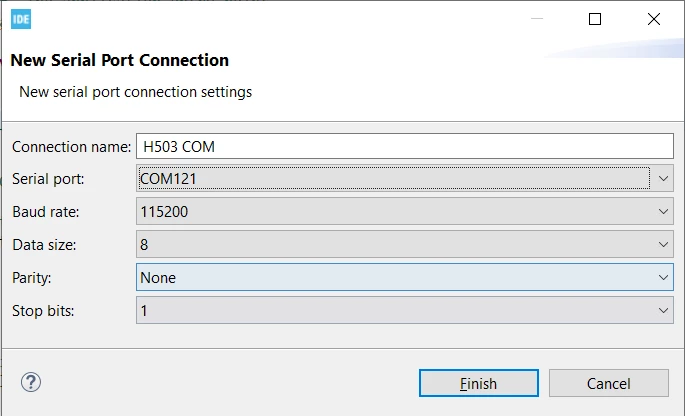

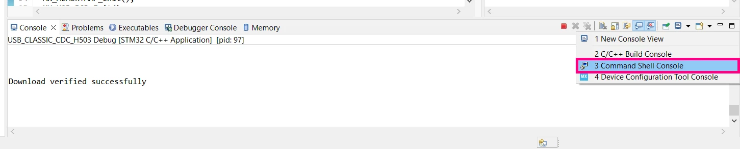

Let us open a terminal in the STM32CubeIDE to see the application running. For that, click o New  Shell console:
In the opened menu, select Serial Port for the Connection Type, then click on New…
In the new menu, create a connection for your board. Make sure to select the proper Serial Port, then click Finish and finally OK:
Doing that, a console with a Virtual COM Port terminal opens and we can see our application running, printing the message on every 500 ms. If you type ‘1’ the User LED should be turned ON and ‘0’ will turn it OFF.

Hello @B.Montanari
Thank you for this article,
I'm trying to do the same using the STWIN.box (STM32U585) but I'm getting errors in "usbdd_conf.c" as shown in the picture.
error displayed: 'PCD_SNG_BUF' undeclared (first use in this function)
What's the problem? Thanks in advance
