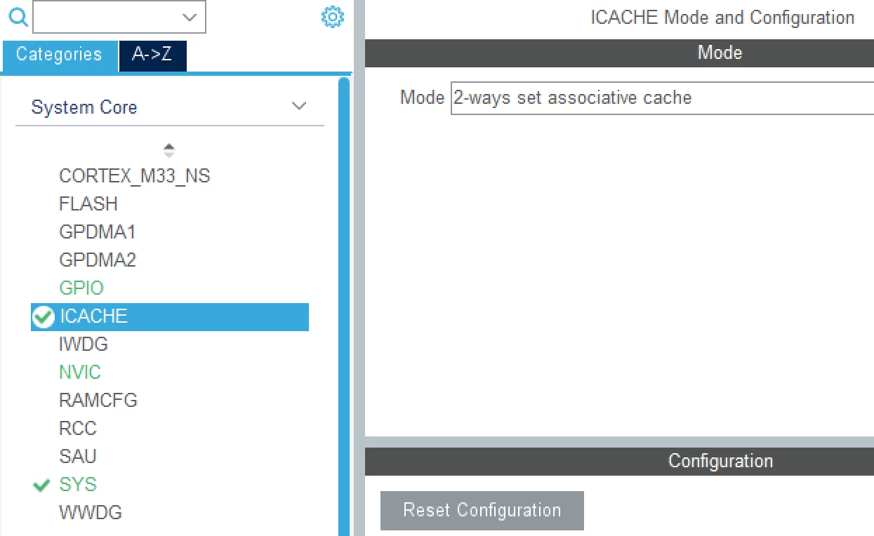

Once the project creation is done, enable the USB Peripheral in Device only mode and activate its interrupt in the NVIC Settings tab.
After that, increase the amount of heap and stack size of the project as indicated in the image below, this action can be done in the Project Manager tab:
After doing that, generate the code by clicking on the highlighted icon, or just pressing the alt + K shortcut.

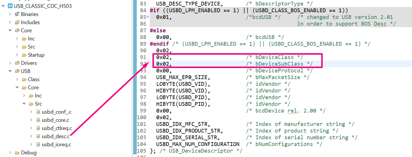

And change the descriptor settings, so the VCOM class can work properly (the lines 12 and 13 are the only ones that change from default):
__ALIGN_BEGIN uint8_t USBD_DeviceDesc[USB_LEN_DEV_DESC] __ALIGN_END =
 0x12, /* bLength */
 USB_DESC_TYPE_DEVICE, /* bDescriptorType */
#if ((USBD_LPM_ENABLED == 1) || (USBD_CLASS_BOS_ENABLED == 1))
 0x01, /*bcdUSB */ /* changed to USB version 2.01
 in order to support BOS Desc */
#else
 0x00, /* bcdUSB */
#endif /* (USBD_LPM_ENABLED == 1) || (USBD_CLASS_BOS_ENABLED == 1) */
 0x02,
 0x02, /* bDeviceClass */
 0x02, /* bDeviceSubClass */
 0x00, /* bDeviceProtocol */
 USB_MAX_EP0_SIZE, /* bMaxPacketSize */
 LOBYTE(USBD_VID), /* idVendor */
 HIBYTE(USBD_VID), /* idVendor */
 LOBYTE(USBD_PID), /* idVendor */
 HIBYTE(USBD_PID), /* idVendor */
 0x00, /* bcdDevice rel. 2.00 */
 0x02,
 USBD_IDX_MFC_STR, /* Index of manufacturer string */
 USBD_IDX_PRODUCT_STR, /* Index of product string */
 USBD_IDX_SERIAL_STR, /* Index of serial number string */
 USBD_MAX_NUM_CONFIGURATION /* bNumConfigurations */
}; /* USB_DeviceDescriptor */

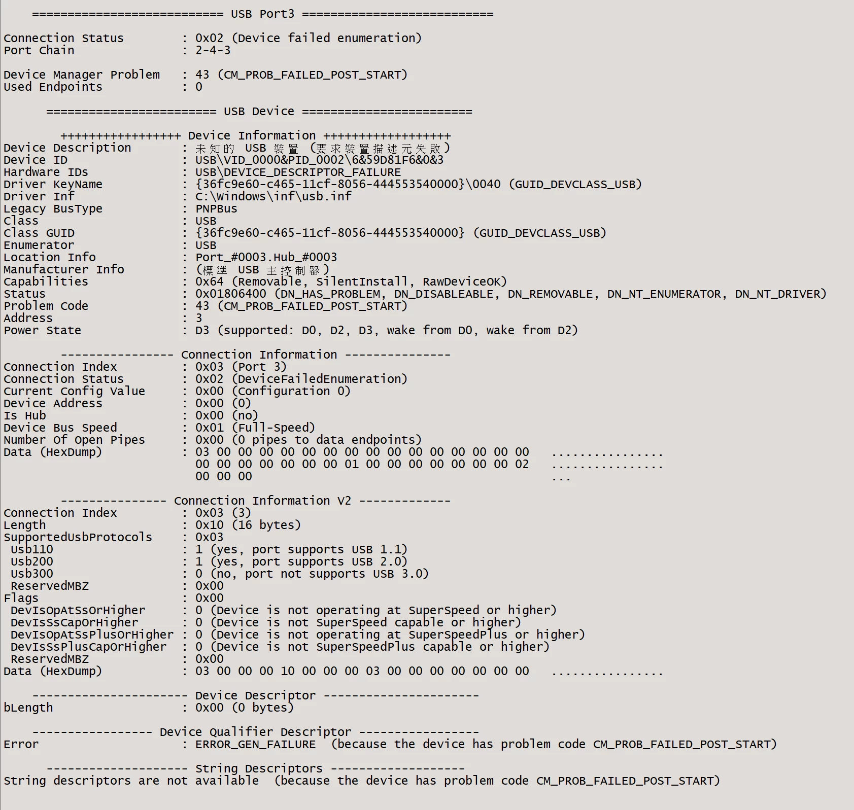

Nov 24, 2023 12:16 AM UTC
Hi @B.Montanari ,
Thank you for your code. I clone your project and it runs perfectly. Then I try to figure out why my code has issues there. I modify the bDeviceClass & bDeviceSubClass as you mentioned. But it still not work. After many tries, finally I found it's the ICACHE issue.
In your code, if I enable the ICACHE in CubeMX and re-generate the project, the USB device enumeration will be failed. Using "USB Device Tree Viewer.exe V3.8.6", we can see:
Then if I disable the ICACHE and regenerate, and everything goes back.
My code was generated by CubeMX using nucleo-h503,  the default MCU running under 250MHz and the ICACHE was default enabled, but your code was generate by CubeMX by bare metal STM32H503, it's 32MHz and ICACHE disabled, that's why my code always failed even followed your instructions.
So my question is how to make the CDC run with the ICACHE enabled ?

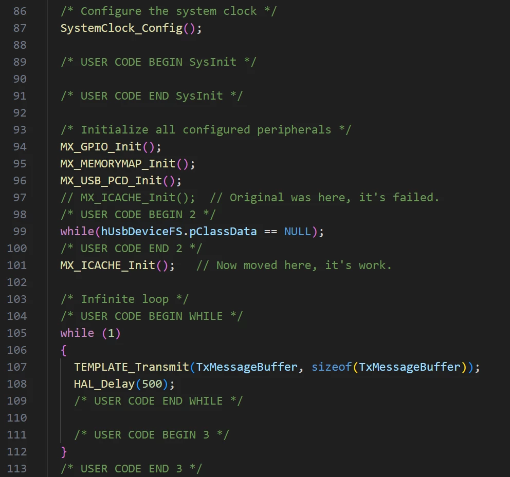

Nov 25, 2023 12:33 AM UTC
Using @B.Montanari 's project and enable the ICACHE, We get the code of main() in main.c:
The MX_ICACHE_Init() generated by the CubeMX was in line#97, in this case, the USB enumeration failed. Now I move the line manually to line#101, then the USB works. I don't know why.
