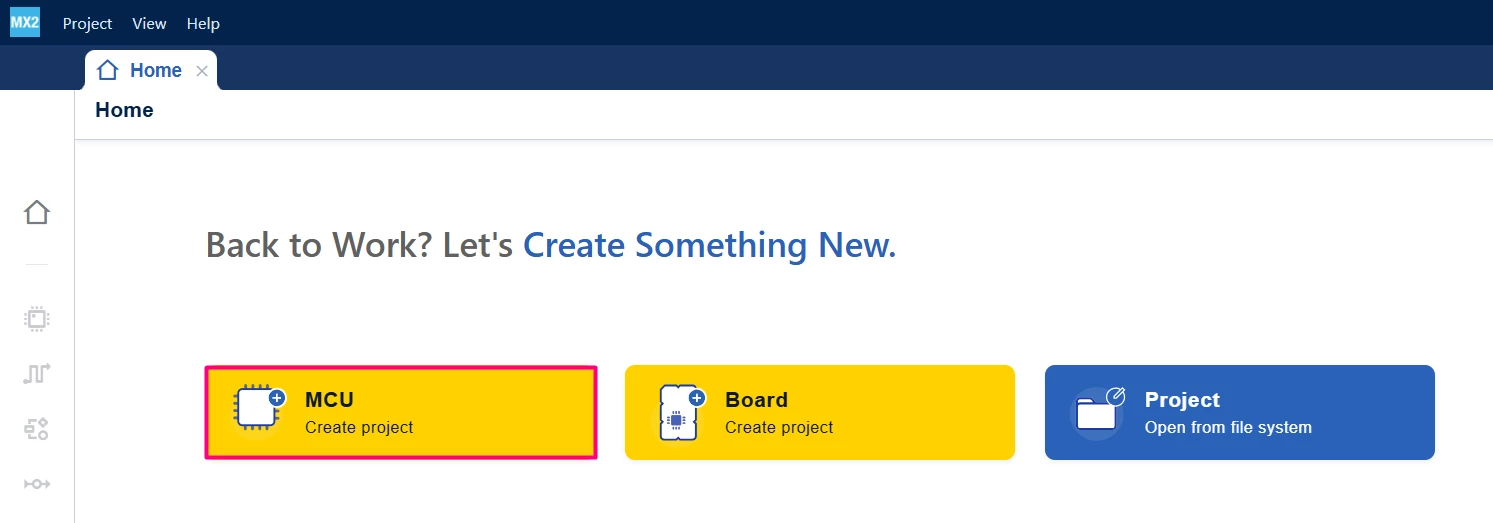

Open STM32CubeMX2. On the "Home" page, click the MCU square to create a new project.

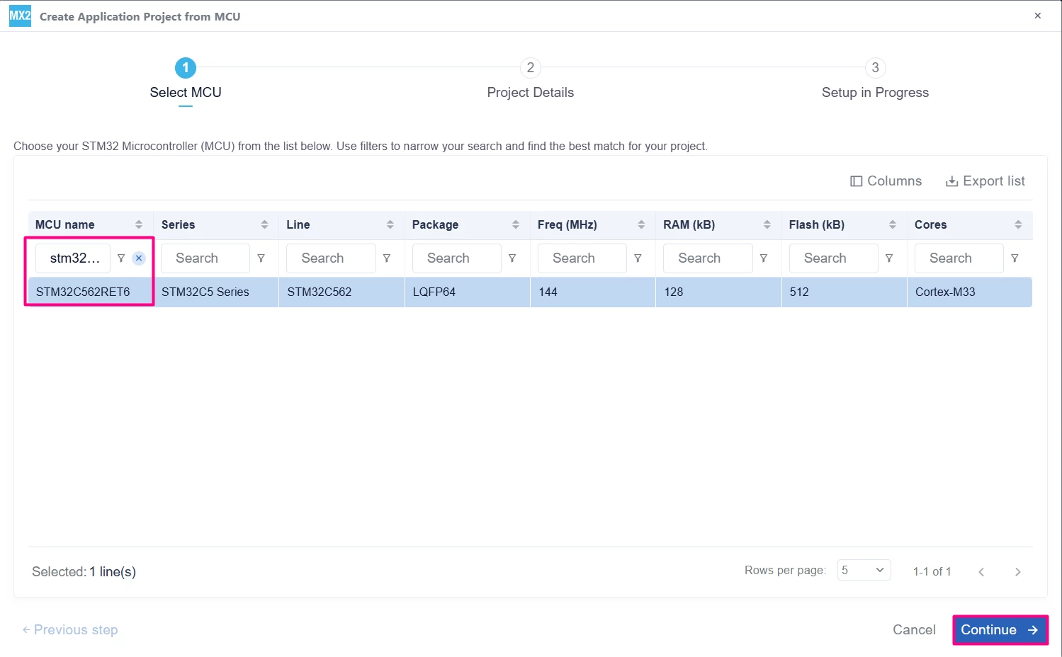

In the search field under MCU name, enter STM32C562RE and select the MCU. Click [Continue].

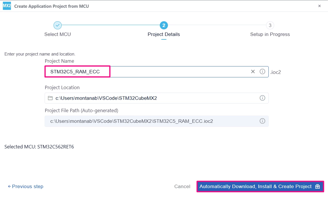

Enter the project name and location. Click [Automatically Download, Install & Create Project] to finish project creation.

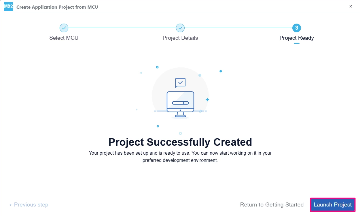

Click [Launch Project] to start.

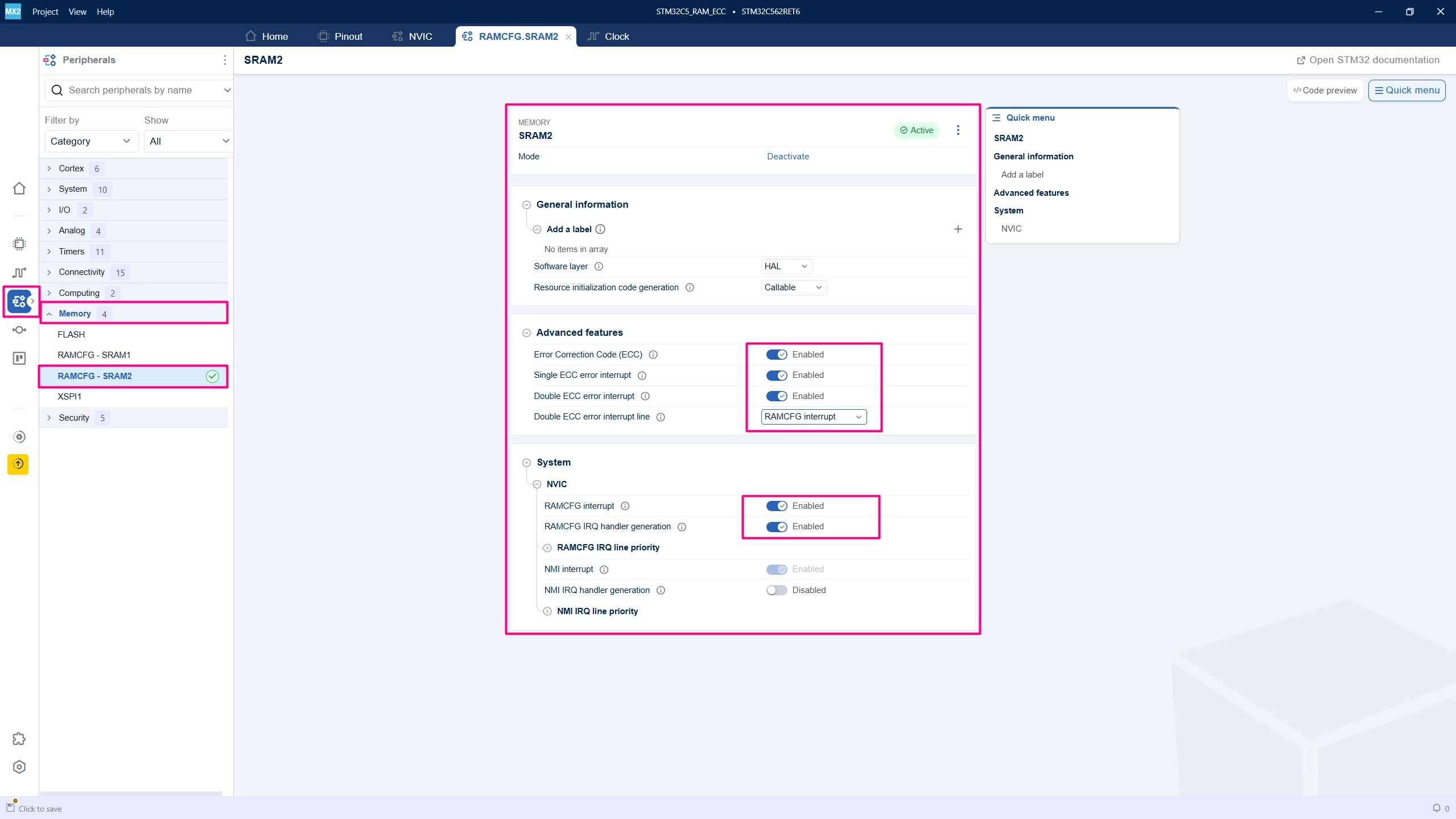

3.1.2 Configuration
In STM32CubeMX2, go to the [Peripherals] section, then click [Memory]. Enable the RAMCFG-SRAM2 with the ECC.

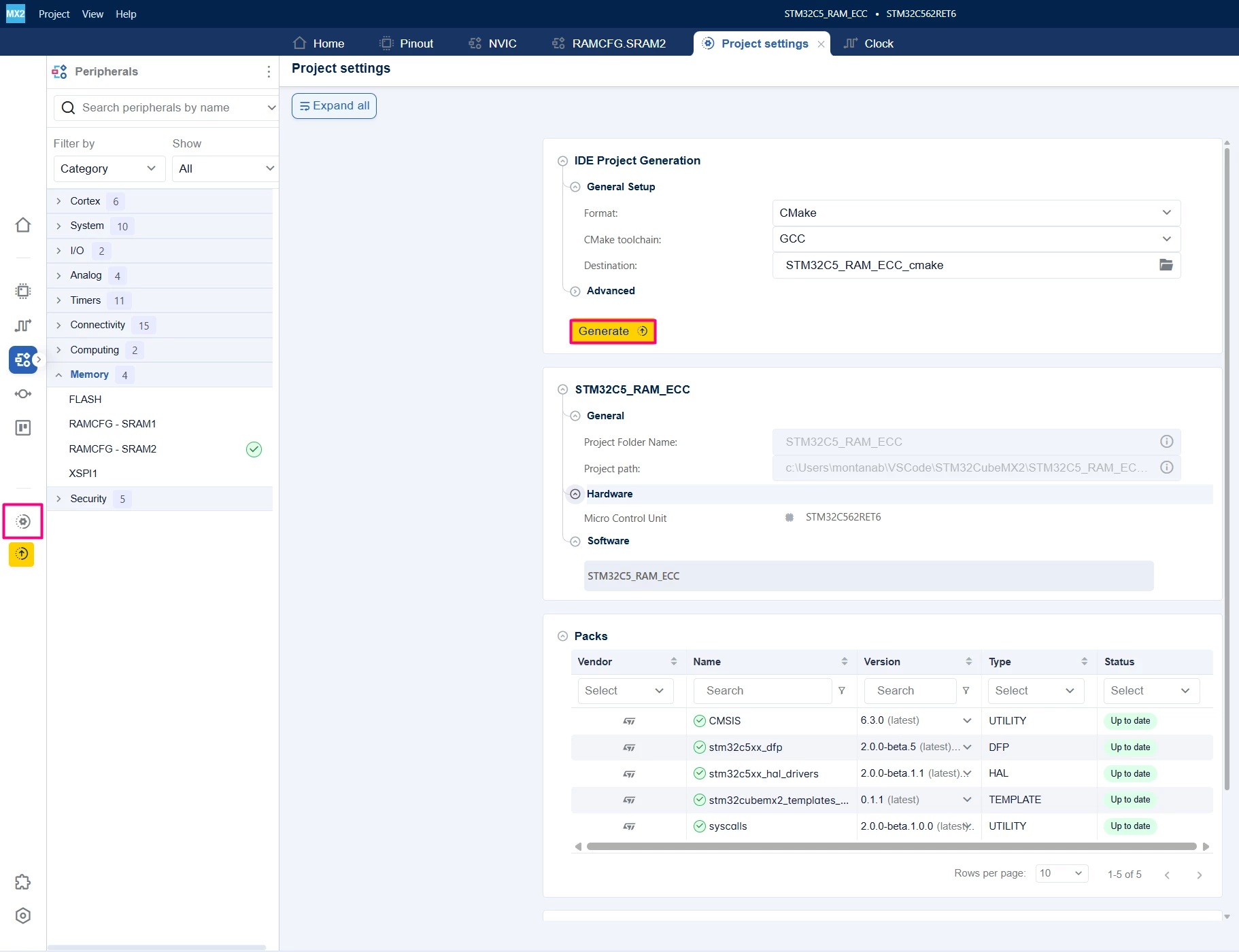

3.2 Code generation
To generate the code:
- Click on the [Project settings] icon and select the desired IDE.
- Click the [Generate] button.

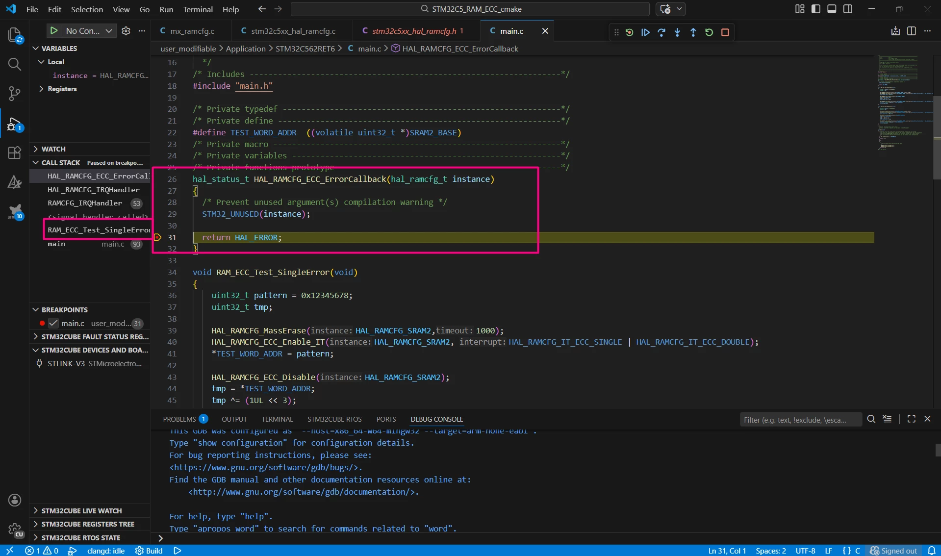

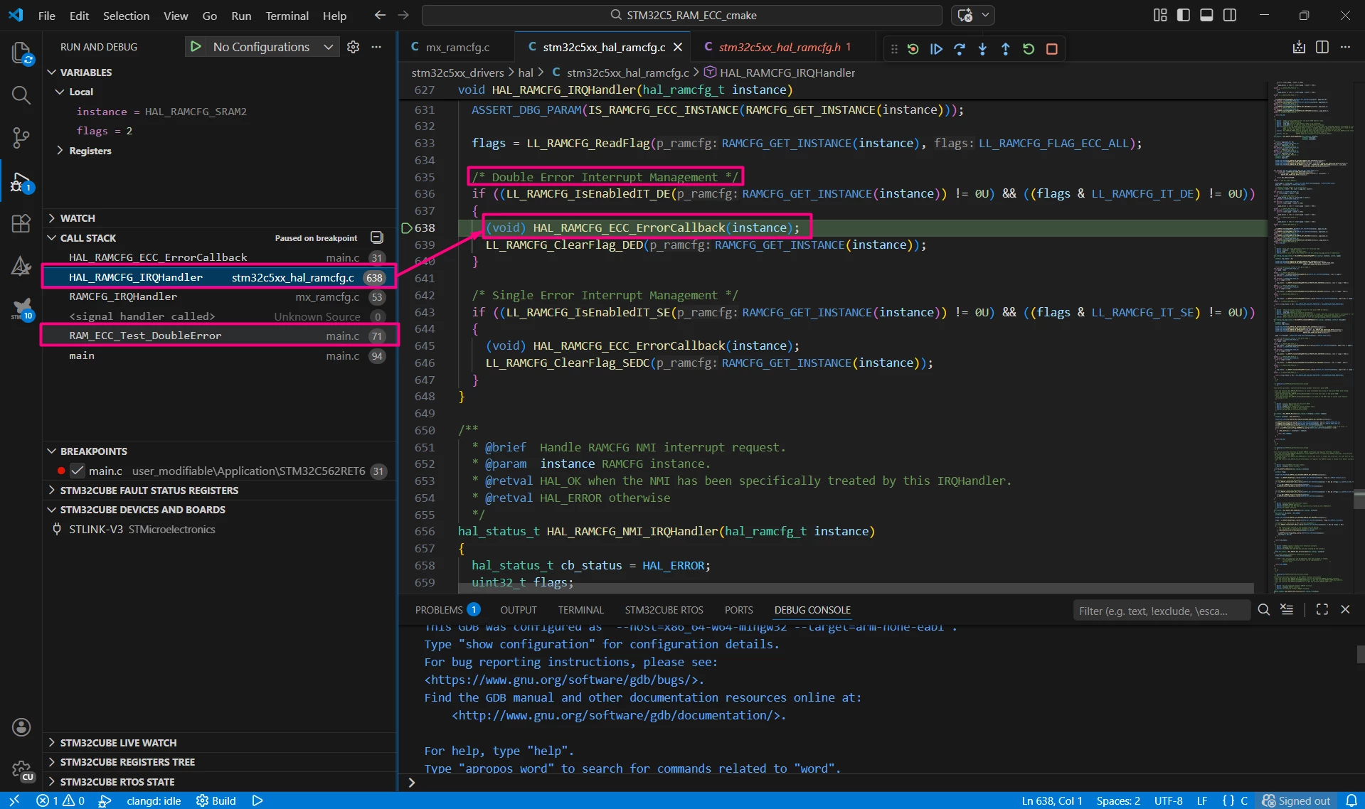

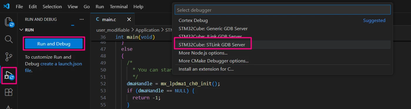

After building the application, click the [Run and Debug] icon. Create a debug session by selecting the STLINK GDB Server option.
Add a breakpoint in the callback and monitor the CALL STACK.

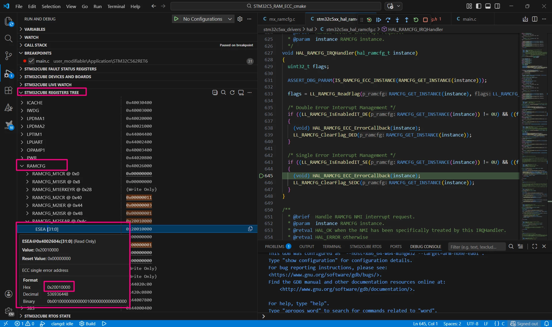

To monitor the address caused by the ECC, access the register tree. Given the used define TEST_WORD_ADDR is the first address of SRAM2 (0x2001 0000) we can observe it in the register.
When tracking the CALL STACK, it is possible to identify the error, either single or double error. The image below shows the check for double error.
