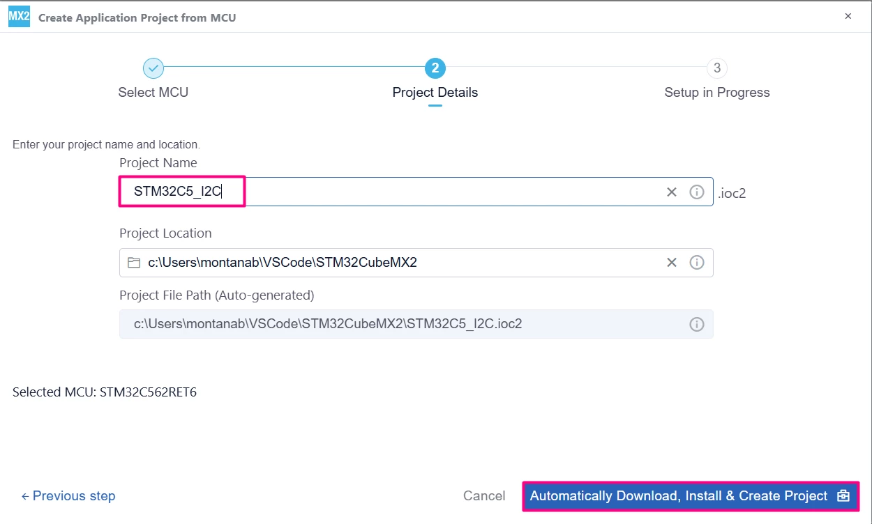

1.1 Project Creation

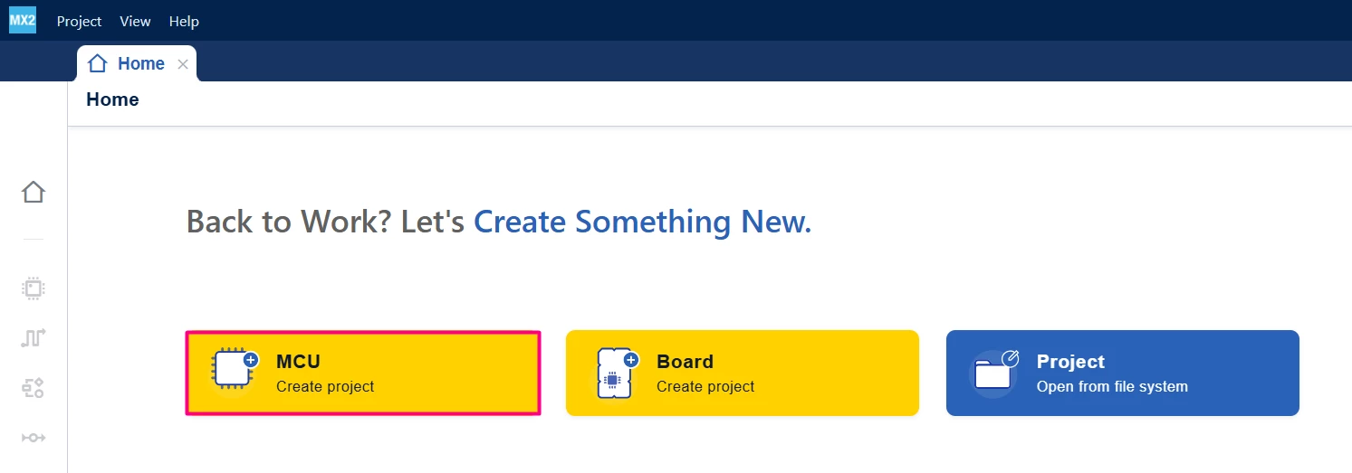

Open STM32CubeMX2. On the "Home" page, click the [MCU square] to create a new project

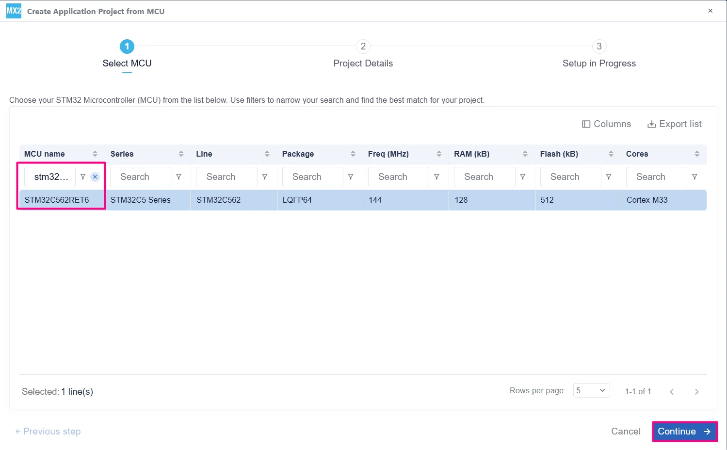

In the search field under MCU name, enter STM32C562RE and select the MCU. Click [Continue].

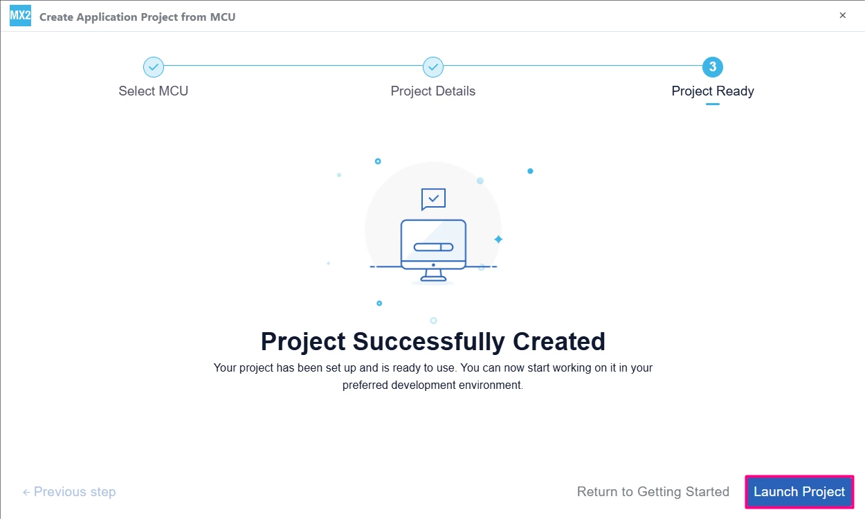

Enter the project name and location. Click [Automatically Download, Install & Create Project] to finish project creation.
Select [Launch Project] to start.

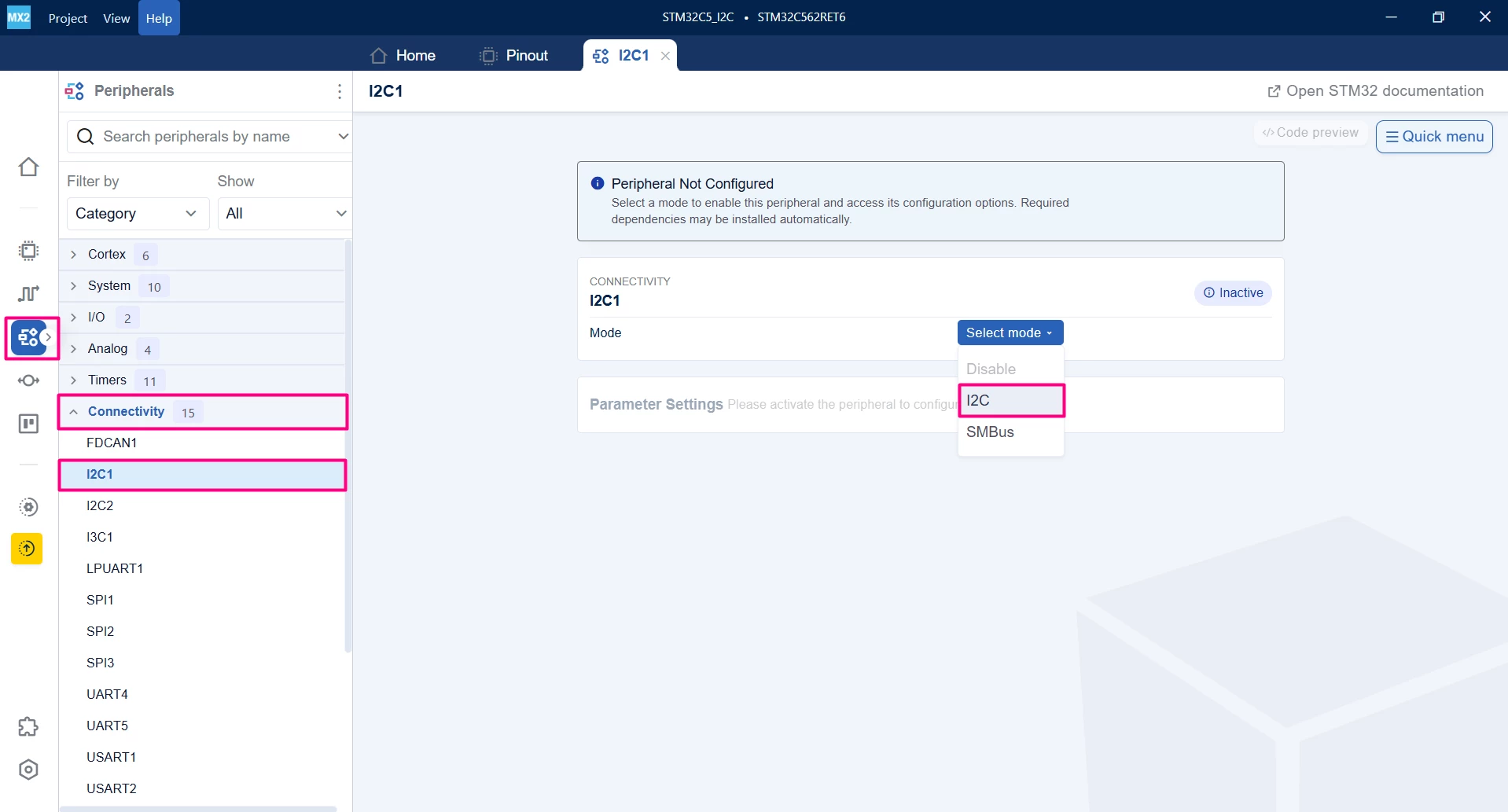

1.2 Pinout and configuration

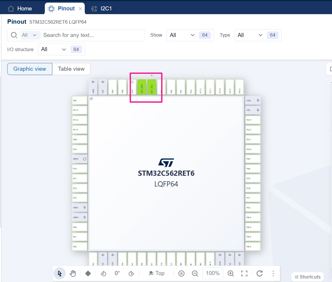

Navigate to the Peripherals section, then Connectivity → I2C.

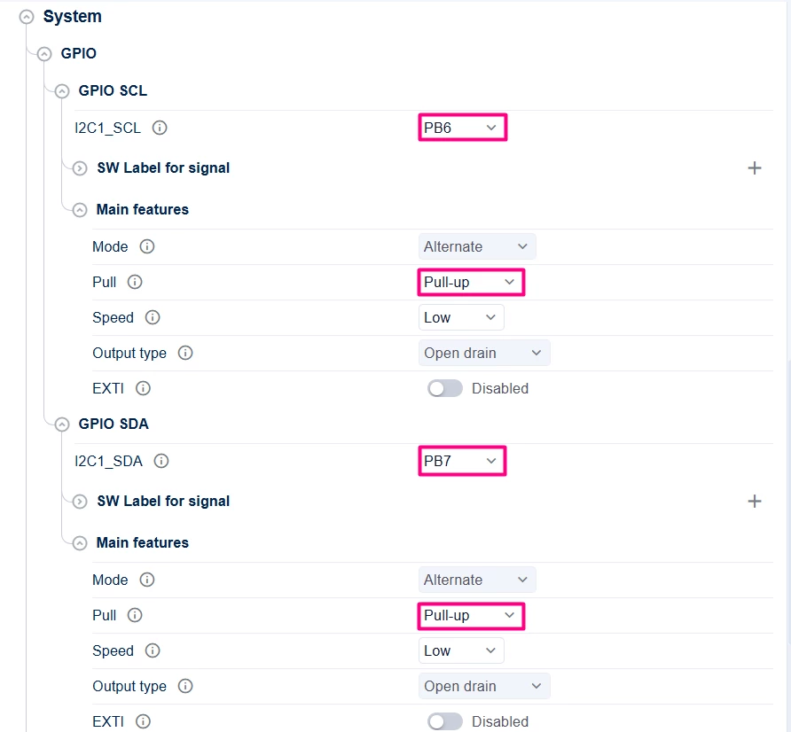

Enable the desired I2C peripheral, in this case, I2C1 with PB6 and PB7 and enable the pull-ups. I2C_SCL is CN5.10 and I2C_SDA is CN5.

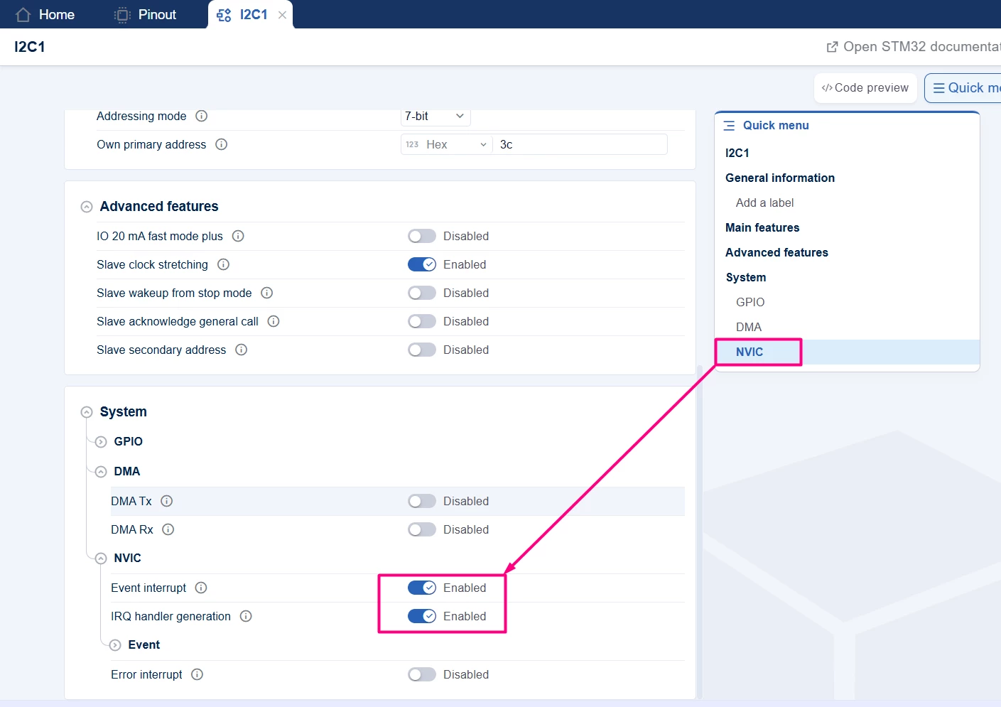

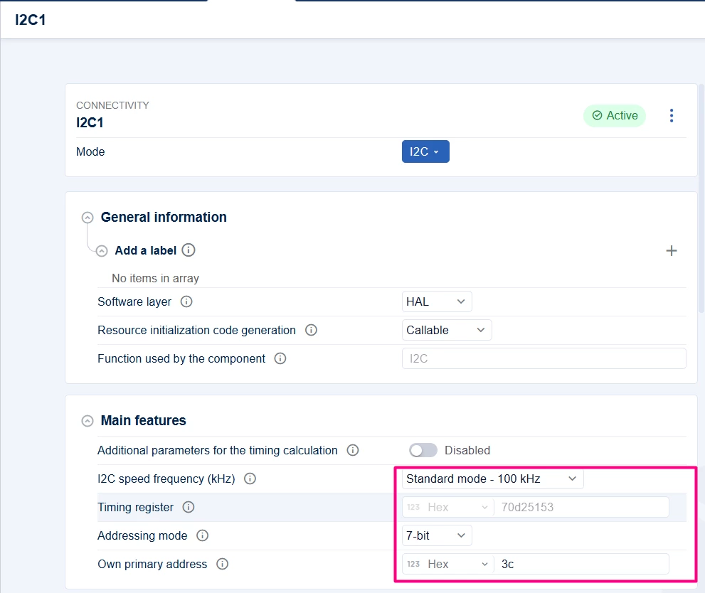

Configure the I2C mode in "standard mode" (100 kHz) and "addressing mode" with 7-bit. For the "own address", we use 0x3C.
Enable [Global Interrupt] and [IRQ handler generation] under the "system" sub-menu if you plan to use interrupts.

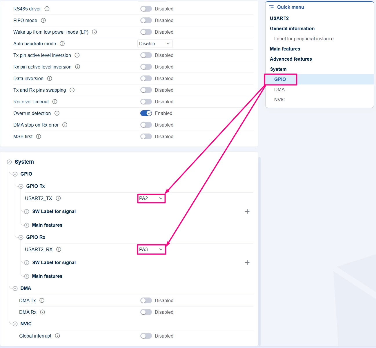

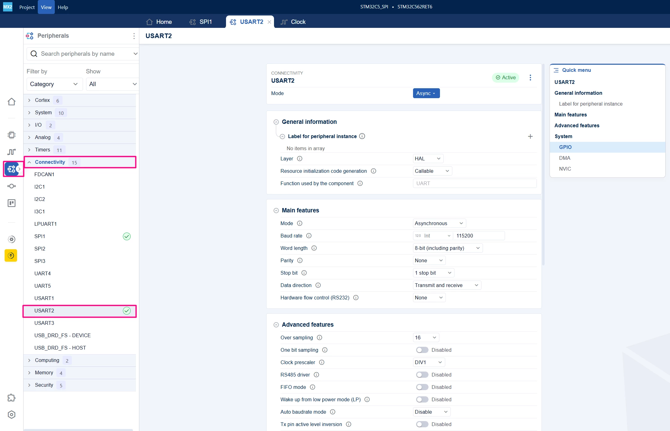

Optionally, configure an additional GPIO like LED or UART for status indication. In this case, a simple printf is used, so UART2 with PA2/PA3 is added:

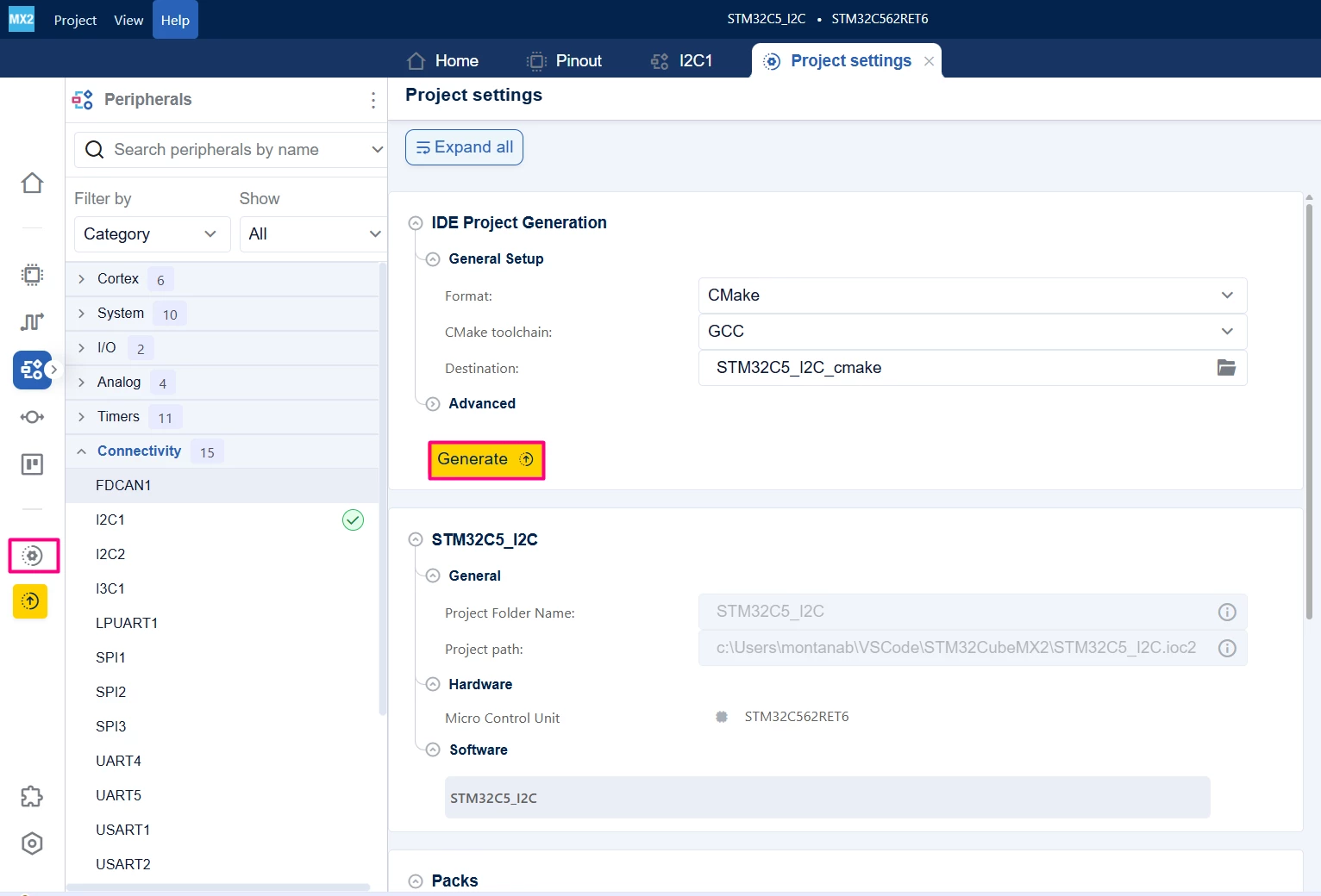

1.2 Code generation
To generate the code:
  1. Click on the [Project settings] icon and select the desired IDE.
  2. Click the [Generate] button.

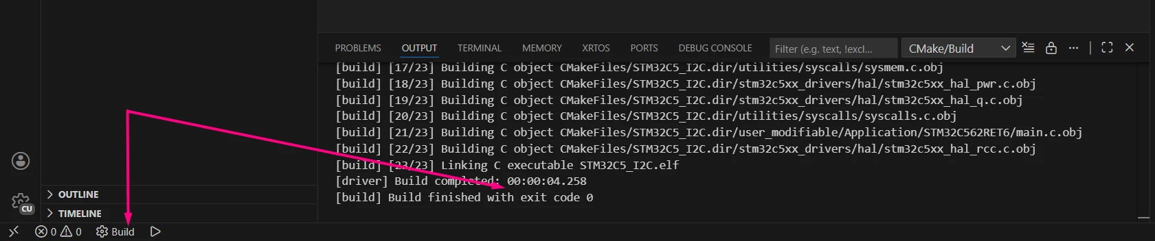

2. Configuring the project in Visual Studio Code
Open Visual Studio Code and open the project folder.
If prompted, select the configuration. If not prompted, press Ctrl+Shift+P, type CMake: Select Configure Preset, and choose the debug configuration.
Build the project to ensure everything is set, then proceed to code implementation.

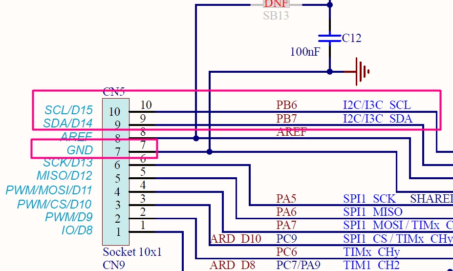

Connect the two NUCLEO boards by associating the GNDs and I2C signals:

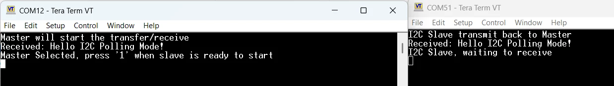

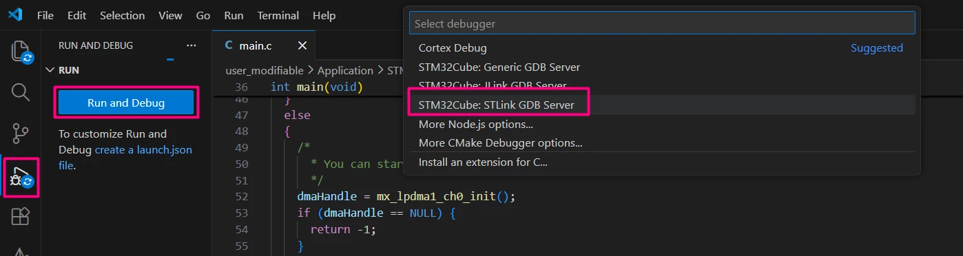

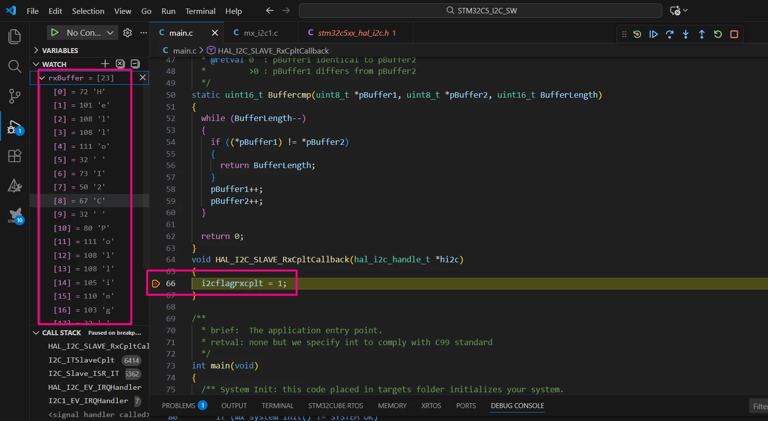

3.2 Debug and validation
After building the application, locate the [Run and Debug] icon, create your debug session by selecting the STM32Cube: STLINK GDB Server option.
Once in debug mode and before running the code, press Ctrl+Shift+P and type [Open Serial] > COM40 (STMicroelectronics) > 115200 or select your preferred terminal. Using Tera Term, its possible to easily observe the controller and responder.
It's also possible to add a breakpoint on the Responder side at the callback, to verify the content received.
