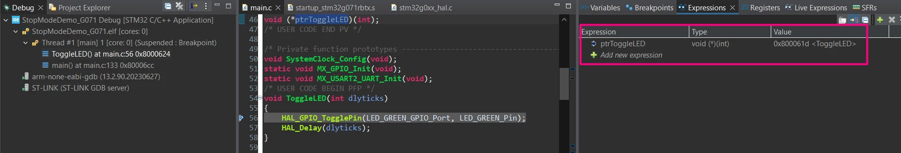

At this point, you can build and program the board. The LED should be blinking normally at the 250ms ratio. If you want to explore more, you can even debug and check that the pointer worked. Place a breakpoint inside the original function and check the pointer in the [Expressions] tab.

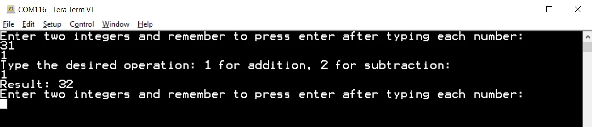

2.  Example 2 results
Press [Ctrl + B] to build the project; there should be no errors or warnings. Program the board and open your preferred terminal. In this case, we use Tera Term with the 115200, 8, N, 1 setting. Running the code, we can play with the simple example by adding or subtracting:
