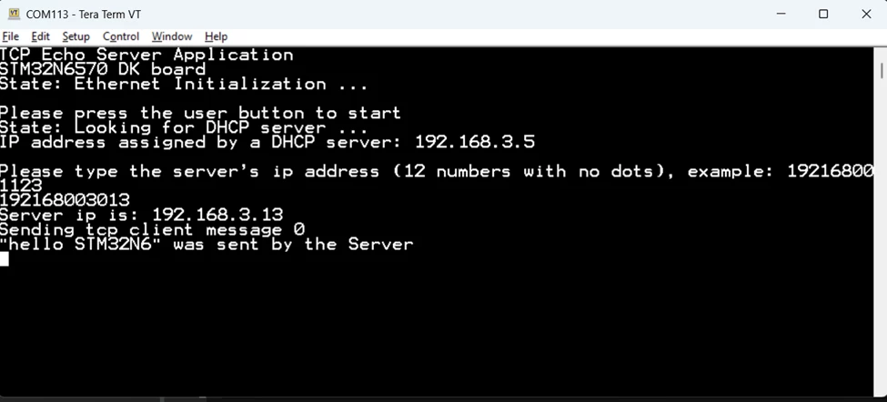

I've made a quick demo (temporarily in a very old repo I have, this will be moved to the hotspot once the articles are completed), running on the FSBL that uses FreeRTOS and LWIP to create a simple server/client application. It is using DHCP and you can configure the server's IP via the UART/VCOM terminal. As this was a simple demo, you'll have to type the IP with the 0s and no ".", for example: 192168001123. The main.h has the TCP SERVER PORT it expects to connect to, the default is 2048. If all goes well, you should see something like this on the terminal

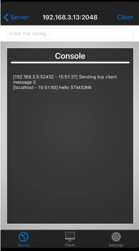

And like this on your server, I've used an app called "TCPConsole" available on App Store, but any server could be used:
