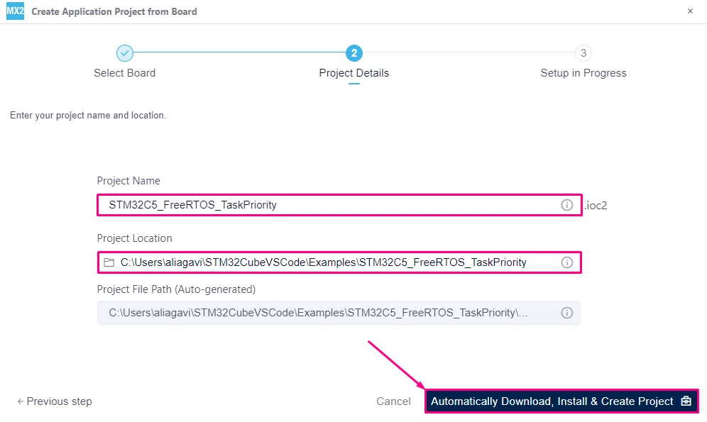

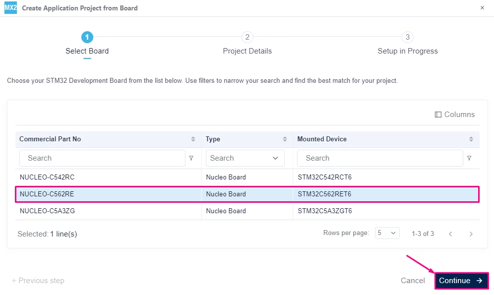

1. Create a new STM32CubeMX2 project
  • Launch STM32CubeMX2.
  • Create Application Project from Board.
  • Select [NUCLEO-C562RE] and [Continue].
  • Set the Project Name and Project Location.
  • Continue with [Automatically Download, Install & Create Project].

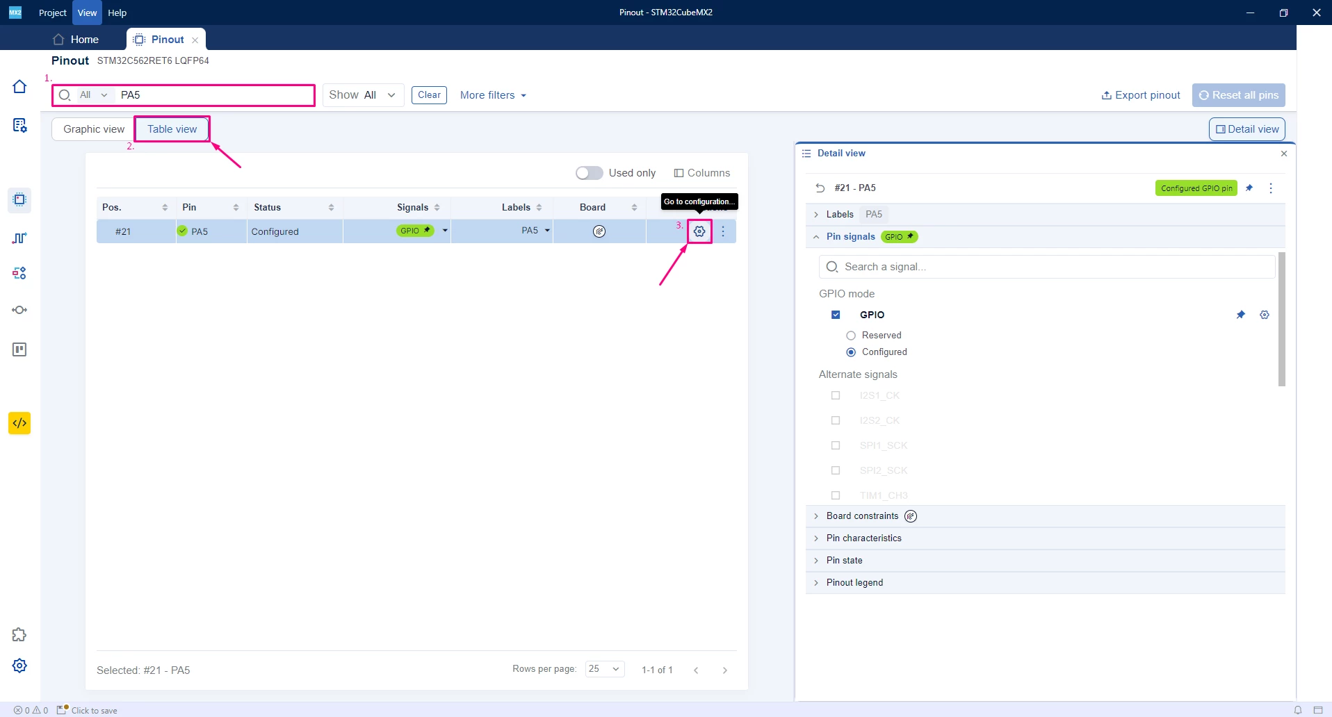

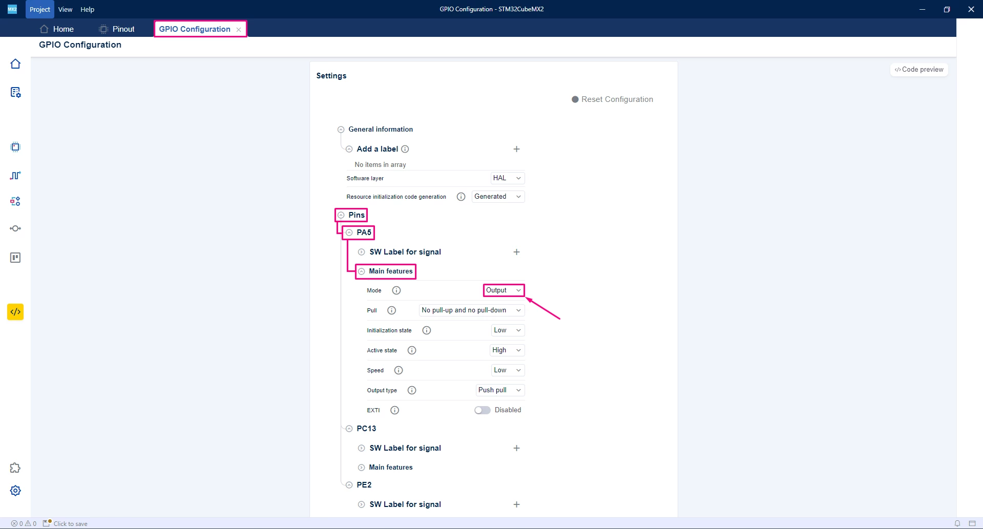

2. Configure the User LED GPIO
  • In the Pinout tab [Table View], locate PA5 (User LED pin on the NUCLEO-C562RE).
  • Go to configuration.
  • In [Pins] → [PA5] → [Main features] change PA5 mode to [Output].

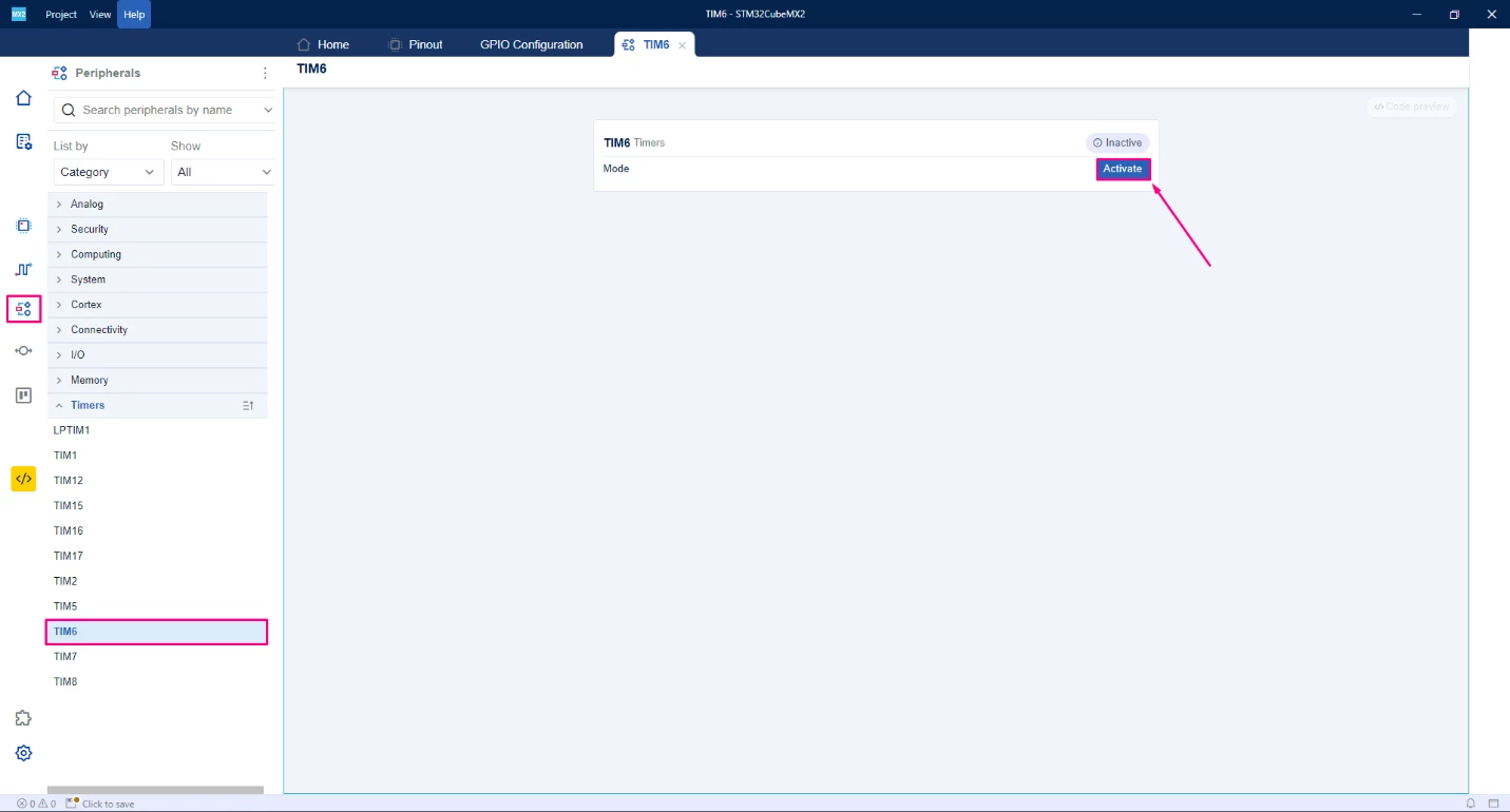

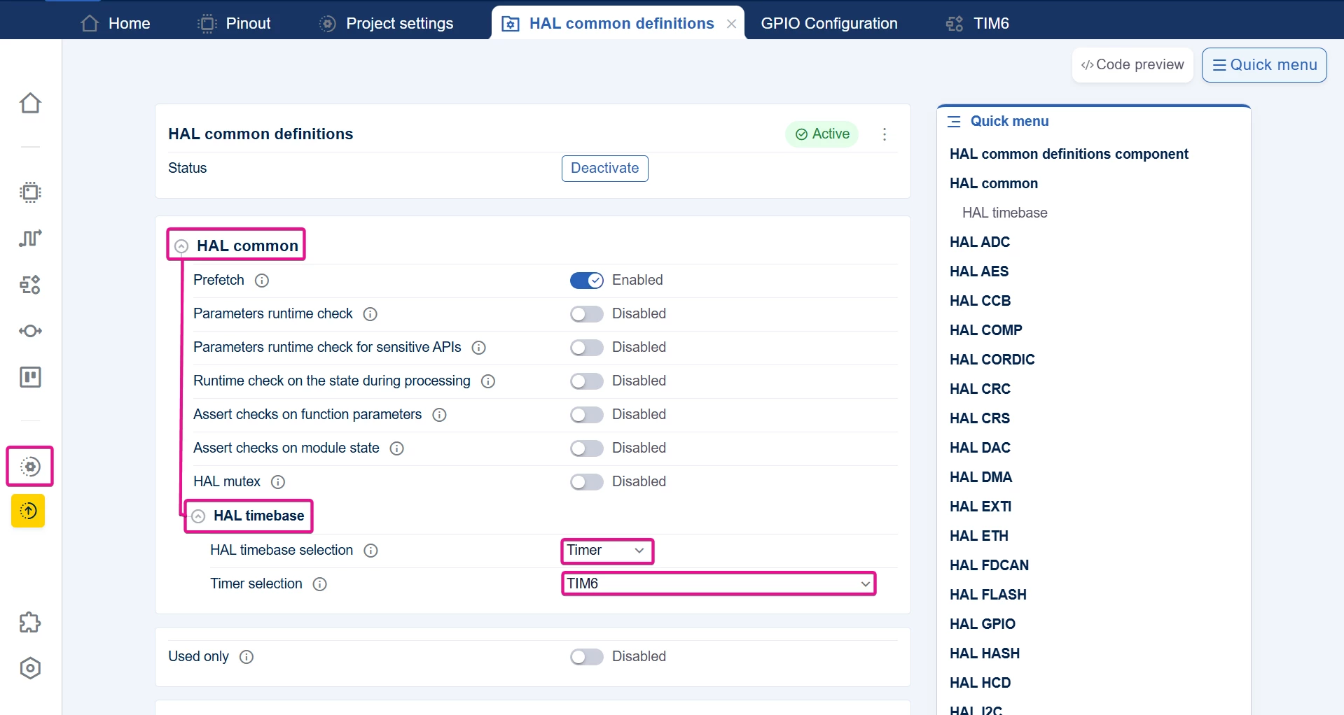

3. Configure HAL timebase to use Timer
  • Navigate to the Peripherals section.
  • Select and [Activate] TIM6.
  • Go to the Project Settings section.
  • In [HAL Core] → [HAL common] → [HAL Timebase], change the HAL Timebase to Timer, and select TIM6.

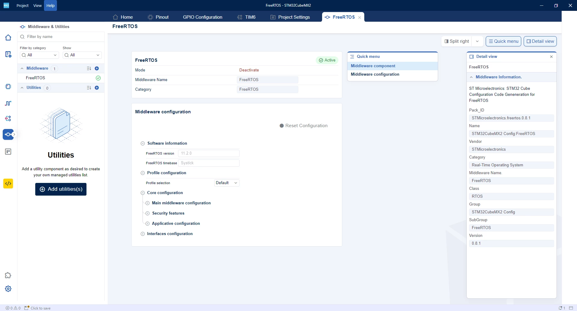

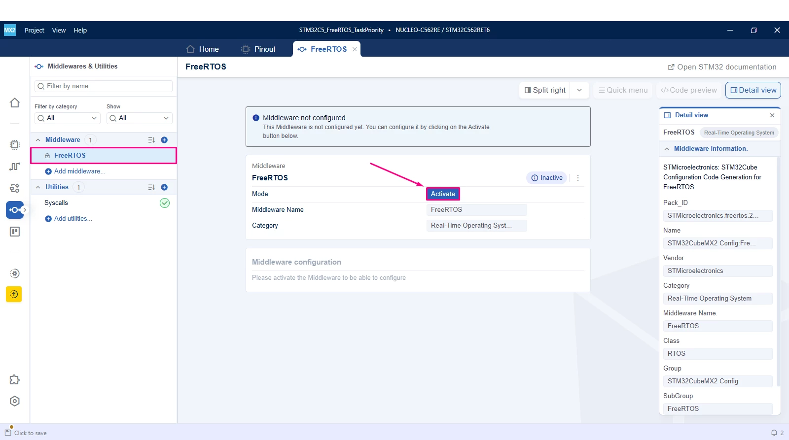

4. Enable and configure FreeRTOS™ middleware
  • Navigate to the Middleware section and [Add middleware(s)].
  • Add [FreeRTOS].
  • Activate FreeRTOS by checking the [Activate] box.
  • No changes are needed in [Main Middleware Configuration] or [Security Features].
  • By default, CubeMX creates an Idle task automatically with a priority of 0.
  • The idle task runs only when no other tasks with higher priority are ready to execute. It essentially acts as a background task to keep the system active when no other work is pending.

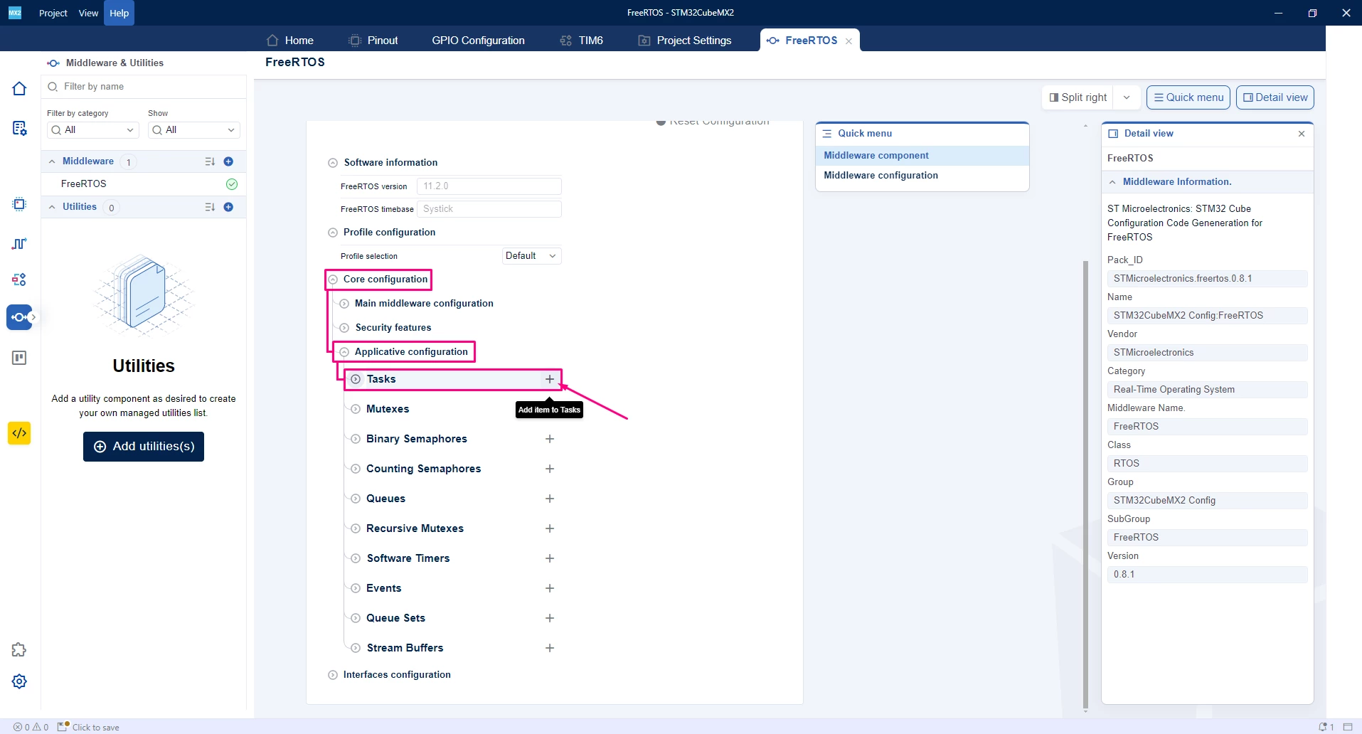

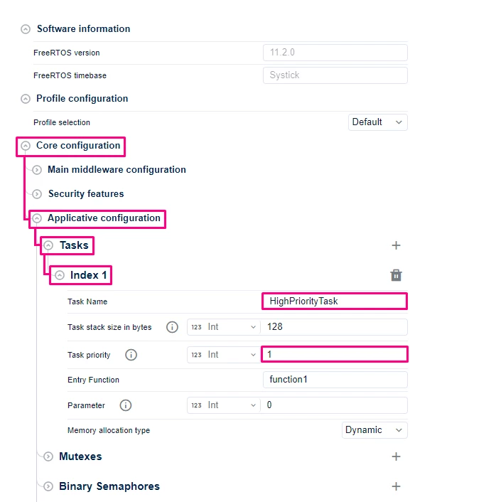

  • To illustrate task priority, in [Core configuration] → [Applicative configuration] → [Tasks], Add [+] a task.
  • Task configurations:
    • Name the new task (HighPriorityTask).
    • Set its priority to one level higher than the Idle task (for example, 1).
    • Leave the other parameters as default.

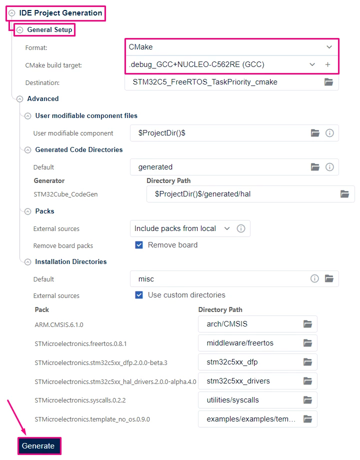

5. Generate and import the project code
  • In the [Project Settings] → [IDE Project Generation] → [General Setup] section.
  • Ensure the Format is set to [CMake] and the build target is set to [.debug_GCC+NUCLEO-C562RE (GCC)].
  • [Generate] the project.

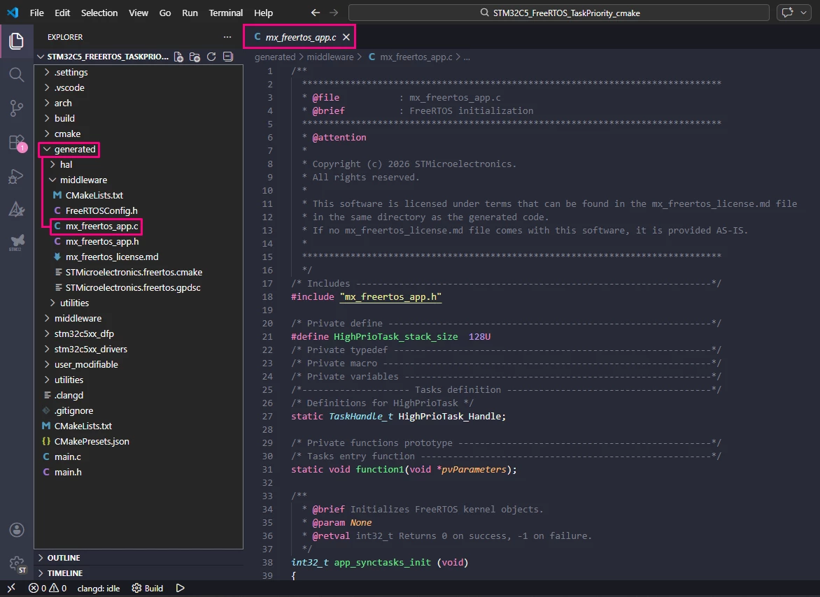

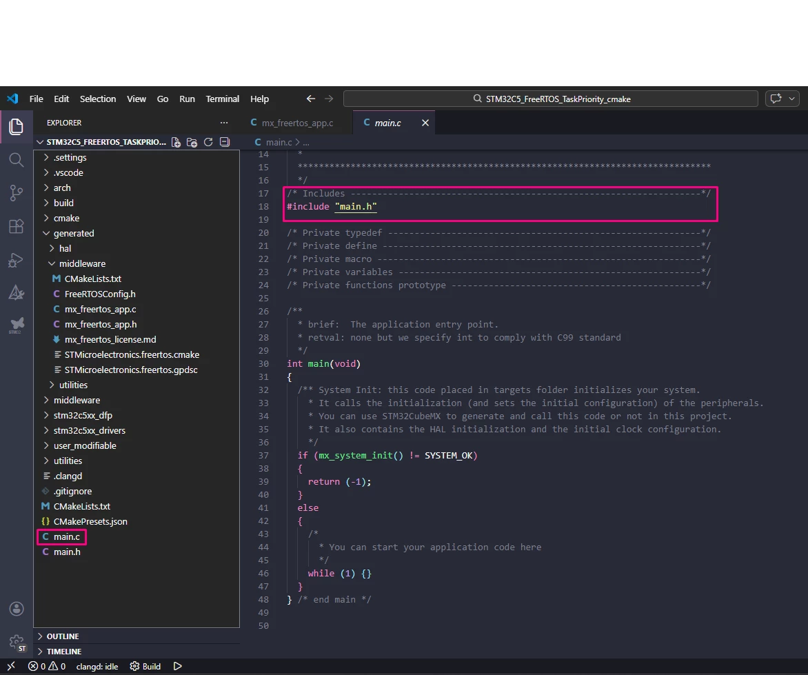

6. Code editing and task implementation
  • In [generated] → [middleware] locate the mx_freertos_app.c file. This file contains the FreeRTOS™ task creation and task function generated by CubeMX2.
  • Find the task function created for your HighPriorityTask (for example, function1).
  • Add the following code to toggle the onboard LED every 500 ms.

  • In the main.c file, include the mx_freertos_app.h and mx_gpio_default.h headers.
#include "main.h"
#include "mx_freertos_app.h"
#include "mx_gpio_default.h"

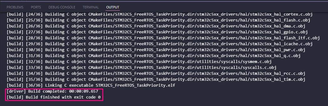

  • Press Ctrl+Shift+P and [CMake: Clean Rebuild the project] to build the project.
  • Confirm that the project compiles without errors.

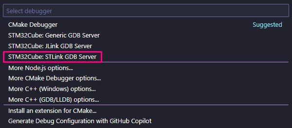

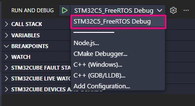

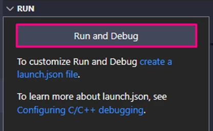

7. Create and modify launch.json
  • Open the Run and Debug view (Ctrl+Shift+D).
  • Click create a launch.json file.
  • Select STM32Cube: STLink GDB Server from the list of debuggers provided by STM32CubeExtension.
  • The extension generates a default launch.json with configurations tailored for STLINK debugging.
Edit the generated launch.json to support debugging FreeRTOS™ with all features enabled.

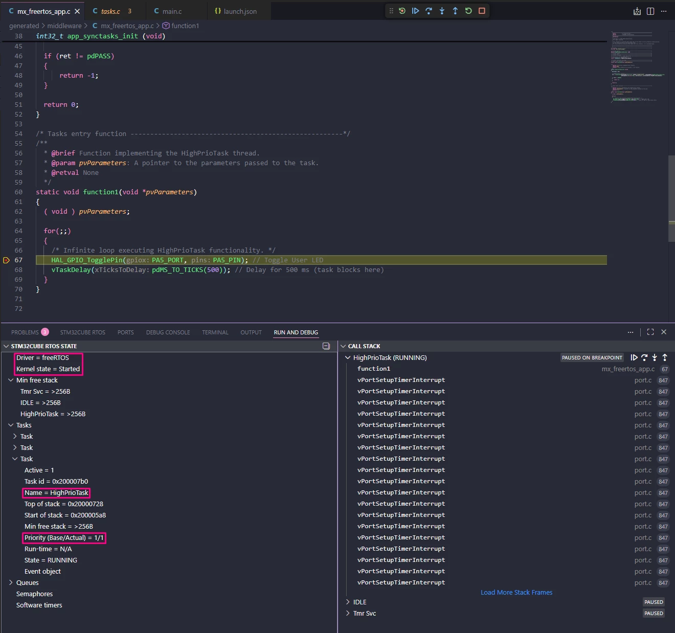

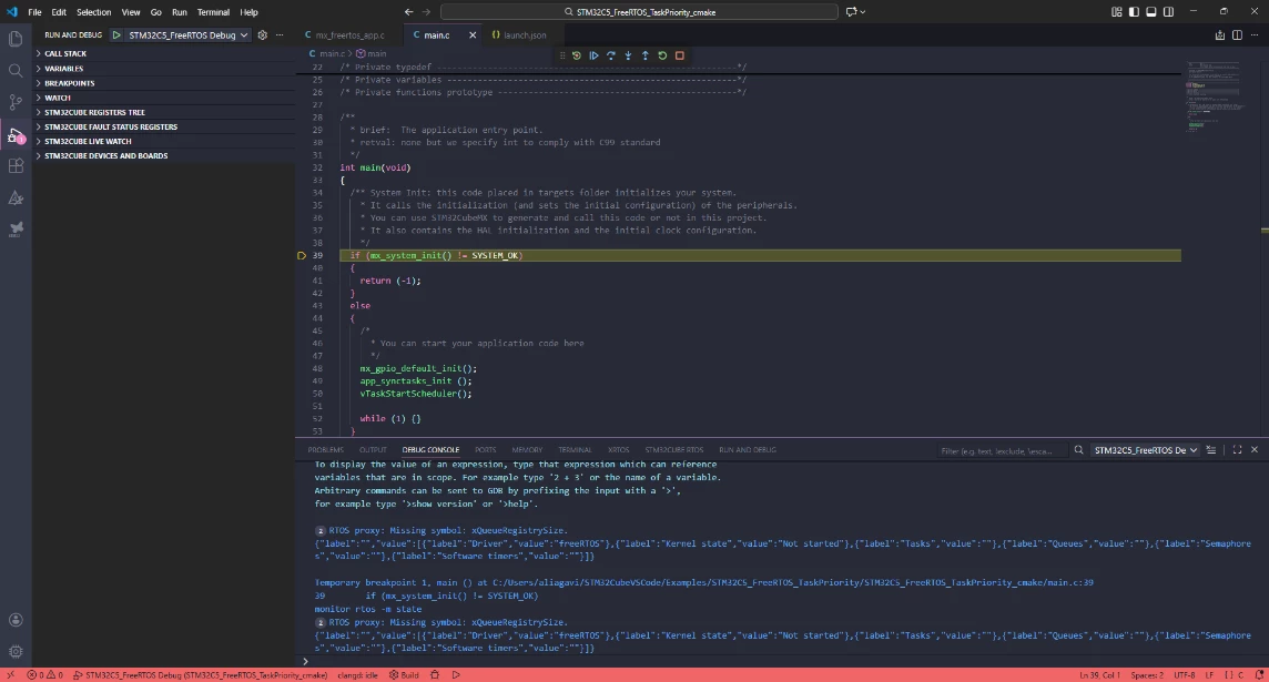

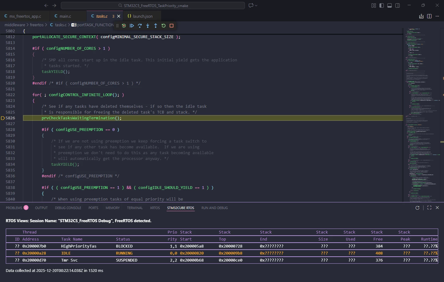

8. FreeRTOS™ debugging with VS Code
  • Connect your STM32 board to your PC using the STLINK debugger.
  • In VS Code, select the debug configuration you created.
  • Press F5 or click the green [Start Debugging] button.

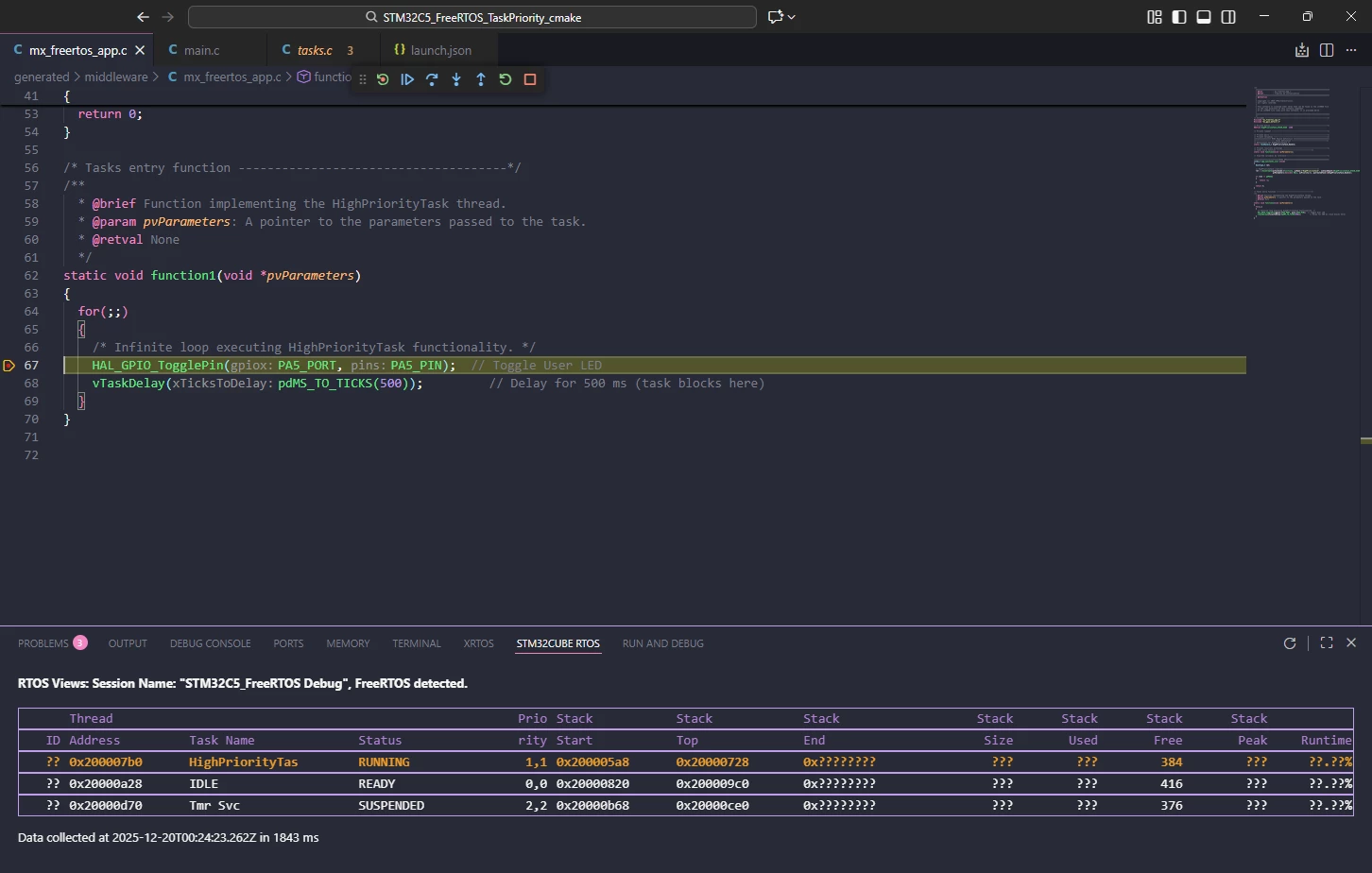

  • The application should halt at main.c
  • Open the XRTOS or STM32CUBE RTOS pane in VS Code.
  • This view displays all FreeRTOS™ tasks, their priorities, and states (Running, Ready, Blocked, Suspended).
  • Run the program and observe the RTOS view:
    • When the LED toggling code executes, your user task shows as [RUNNING].
    • When the task calls vTaskDelay(), it enters the Blocked state, and the IDLE task becomes Running.
    • When the delay expires, your user task wakes and preempts IDLE immediately due to higher priority.
Additionally, with "serverRtos" enabled you get an additional RTOS panel in VS Code that shows richer information about the system at runtime. This makes it much easier to analyze and debug FreeRTOS behavior.
