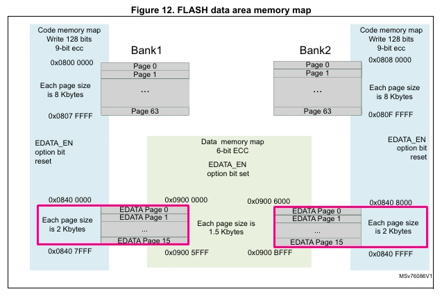

3. STM32C5 EDATA sector and option bytes
Before running the EEPROM emulation example, the STM32C5 EDATA sector must be understood and configured correctly.
EDATA sector overview
On STM32C5, the EDATA region is a dedicated 64 Kbyte FLASH sector intended for EEPROM emulation:
  • Total size: 64 Kbytes
  • Banks: 2 banks
  • Pages per bank: 16 pages
  • Page size: 2 Kbytes
This organization provides:
  • Small page size, which improves endurance and flexibility for wear leveling.
  • A dedicated region, separated from the main program FLASH, simplifying memory mapping and protection.

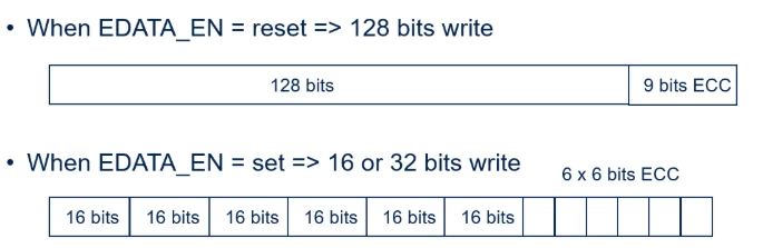

Data granularity: 16-bit vs 128-bit mode
The EDATA region supports two write granularities, configured through an option byte:
  • 16/32-bit mode
  • 128-bit mode
The mode impacts how data is written and read: the access width must match the configured mode, and it also determines how ECC is managed for erased and programmed locations.
If the EDATA region is configured in 128-bit mode and is accessed as 16-bit or 32-bit, this can generate ECC errors and trigger a non-maskable interrupt (NMI).
In 16-bit mode, erased 16-bit words cannot have ECC bits all set to 1. Such a pattern also leads to ECC errors and NMI on read access to erased data or OTP.
The EEPROM emulation driver and configuration must be aligned with the chosen mode. The Visual Studio Code example is configured accordingly in its FLASH driver and should be used with a matching EDATA configuration.

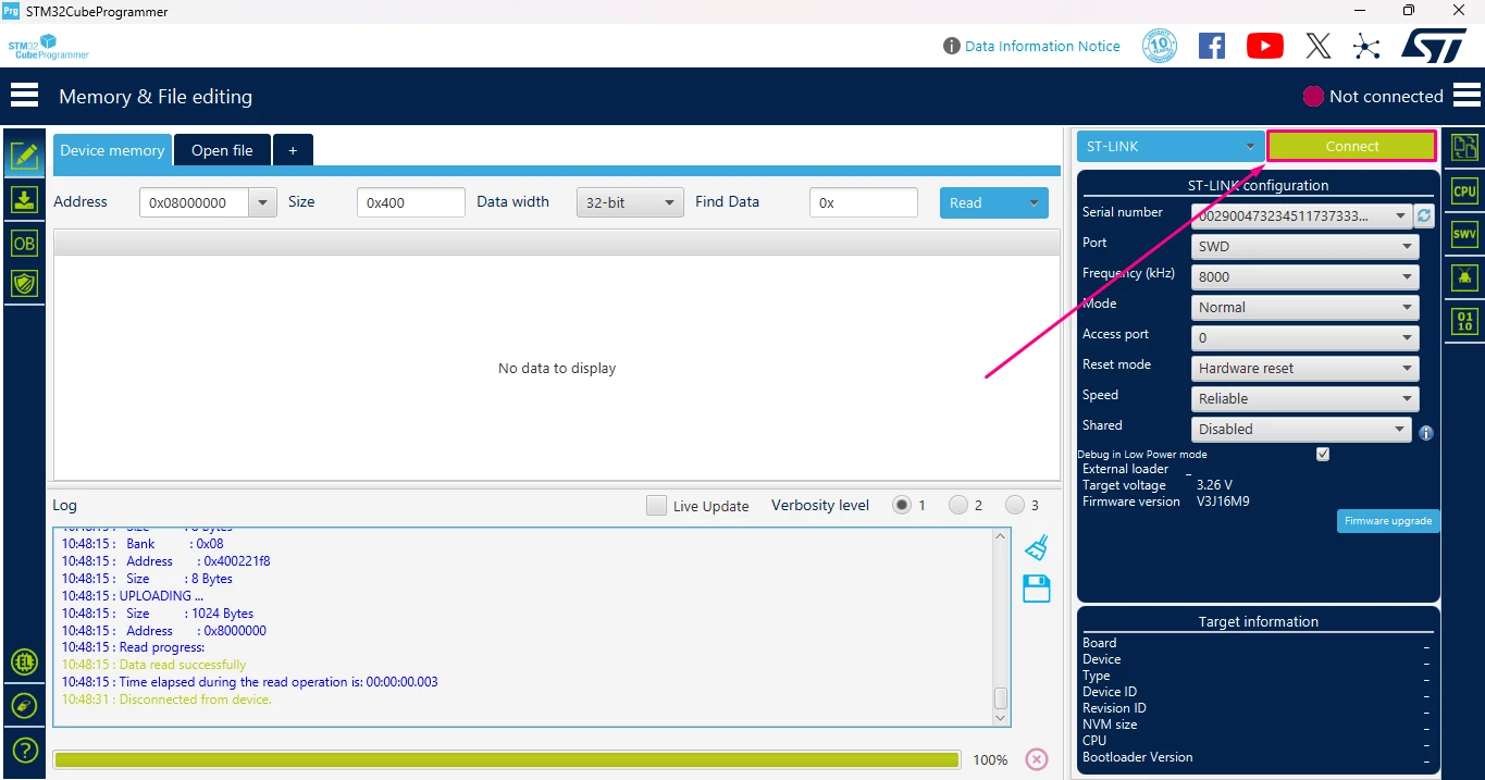

Configuring EDATA via STM32CubeProgrammer
The EDATA region is enabled and configured outside the Visual Studio Code project, using STM32CubeProgrammer:
  1. Launch STM32CubeProgrammer and connect the NUCLEO-C562RE board to the host PC using the USB Type-C® cable.
  2. Select the appropriate connection interface, then click [Connect].

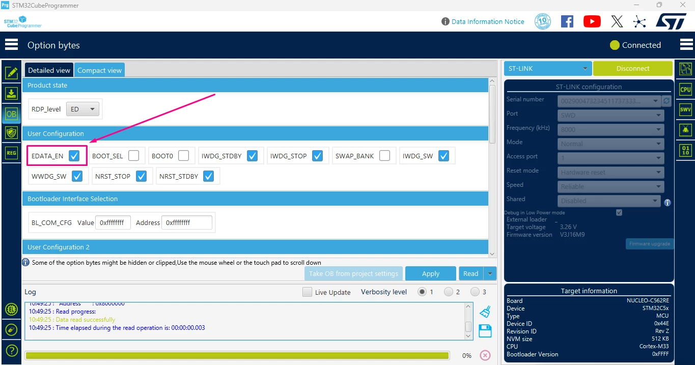

  1. Open the Option Bytes tab and enable [Compact View].
  2. In the User Configuration section:
    • Enable the EDATA (EDATA_EN) option to activate the EDATA sector for 16‑bit or 32‑bit data granularity, consistent with the EEPROM emulation driver configuration used by the example.
  1. Click [Apply] to write the option bytes and let the device reset if requested.

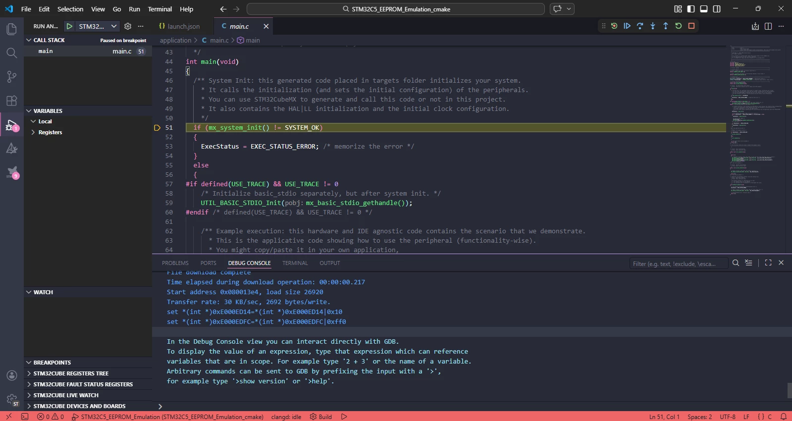

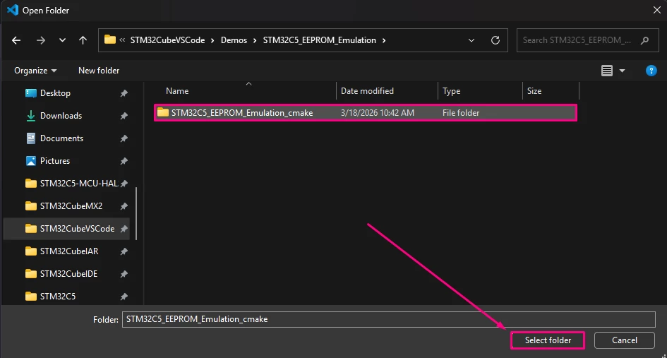

4. Overview of the EEPROM emulation example

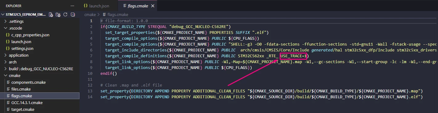

4.1 Example structure and toolchain
The example is provided as a ready-to-build Visual Studio Code, CMake, and GCC project. The layout is:
  • generated/hal: System and device initialization (startup, clock configuration, HAL init, mx_system_init()).
  • stm32c5xx_drivers/: STM32C5 HAL and low-level drivers.
  • utilities/eeprom_emulation/: Complete EEPROM emulation driver, split into:
    • Core API: eeprom_emul_core.c/.h
    • Algorithms: eeprom_algo_flitf.c/.h, eeprom_algo_nvm.c/.h
    • Interfaces:
      • Flash: eeprom_itf_flash.h, eeprom_itfflash_flitf_edata.c, eeprom_itfflash_nvm_edata.c, templates
      • CRC: eeprom_itf_crc.h, eeprom_itfcrc_crc.c, template
      • ECC: eeprom_itf_ecc.h, eeprom_itfecc_bch.c, template
  • eeprom_mx_config: Glue and configuration:
    • eeprom_emul_conf.h – configuration of the emulation (algorithm selection, EDATA mapping, endurance, and variable count).
    • mx_eeprom_emul.c/.h – glue tying the generic driver to STM32C5 HAL flash and CRC handles.
  • Application:
    • example.c/.h – demonstration scenario: initialization, write, cleanup, read and verify, de-initialization.
    • main.c/.h – system entry point, example loop, and LED/status reporting.
  • Build configuration:
    • CMakeLists.txt and related CMake files to drive GCC.
    • Visual Studio Code configuration files (.vscode/) to build, flash, and debug via the STM32Cube extension.

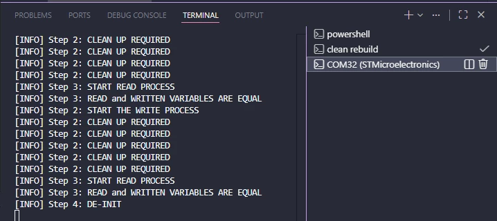

  • Step 1 – Initialization (app_init): Call mx_eeprom_emulation_init() and report success or failure.
  • Step 2 – Write all variables and handle cleanup (app_process, first part): Write 1000 8‑bit variables (IDs 1..1000) into the emulated EEPROM, handling EE_INFO_CLEANUP_REQUIRED.
  • Step 3 – Read back and verify (app_process, second part): Read all variables back and compare with the original values.

  • Launch Visual Studio Code.
  • Select Open Folder.
  • Browse to and select the root folder of the EEPROM Emulation project.
  • Click Select folder to load the project into VS Code.

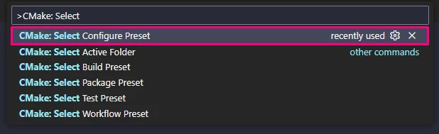

  • Press Ctrl+Shift+P and [CMake: Select Configure Preset].
  • Select [debug_GCC_NUCLEO_C562RE].
  • Press Ctrl+Shift+B to trigger the [CMake: clean rebuild] task

The project provides a launch.json file with a debug configuration named STM32C5_EEPROM_Emulation, based on the STM32Cube ST-LINK GDB server. You do not need to create or modify it; just select and use it.
  1. Open the Run and Debug view
    • Press Ctrl+Shift+D (Run and Debug) in VS Code.
    • In the configuration drop‑down, select:
  2. Start debugging
    • Connect the NUCLEO‑C562RE board to your PC via USB Type-C® (ST‑LINK).
    • With STM32C5_EEPROM_Emulation selected, press F5 or click Start Debugging.
  • The debugger launches the ST‑LINK GDB server and start your application.
  • Execution halts at main().
This configuration is already set up to:
  • Build the project before starting the session.
  • Load the correct ELF/binary produced by the CMake + GCC toolchain.
  • Attach to the target via ST‑LINK with standard STM32 debug options.

  • Console logs (if USE_TRACE=1)
In the serial/ITM output, you should see:
  • [INFO] Step 1: EEPROM INITIALIZATION COMPLETED.
  • [INFO] Step 2: START THE WRITE PROCESS
  • Optionally [INFO] Step 2: CLEAN UP REQUIRED when cleanup is triggered
  • [INFO] Step 3: START READ PROCESS
  • [INFO] Step 3: READ and WRITTEN VARIABLES ARE EQUAL
Any [ERROR] message indicates where the scenario failed (init, write, read, or comparison).

    • Check EDATA option bytes in STM32CubeProgrammer (EDATA_EN enabled, granularity matches the driver).
