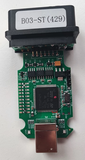

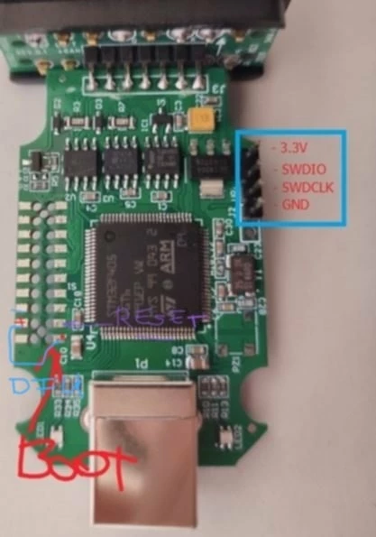

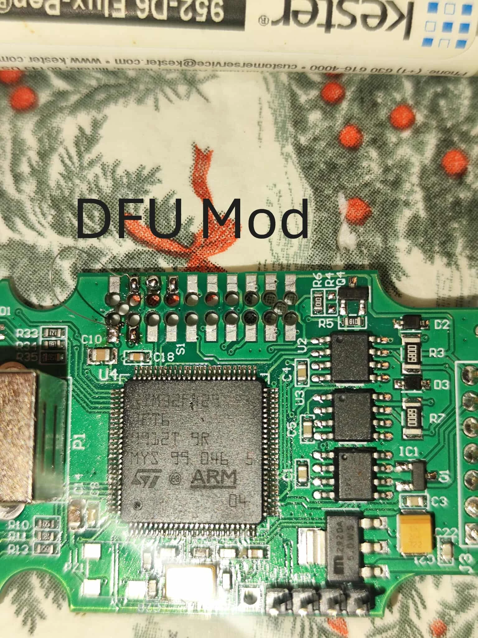

hello!
STM32F429 RDP Level 2 unlocking – help
Message:
Hello!
I have an STM32F429 microcontroller (VCDS USB cable) accidentally locked to RDP2 due to a bad firmware (FLY firmware). Since then:
DFU / bootloader does not appear on USB
ST-Link does not connect
Even Connect under reset does not work
Only two LEDs flash briefly
I know that RDP2 is “final”, but I would like to know if there is any realistic or documented way to reset the chip (hardware tricks, ST tools, ROM commands, etc.), or is it really just a matter of replacing the MCU.
Details:
MCU type: STM32F429VET6
unfortunately I loaded a different firmware: FLY !! / VCDS clone cable
I put it in DFU mode but the system still doesn't see it :(
Is there any way to unlock RDP2?
Is there an ST internal tool / command for this?
Can hardware methods (e.g. glitch) help?
Can ST service help with this?
Thanks in advance for all your answers!
