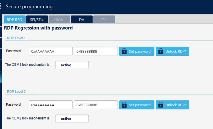

1. How to define an OEM password
To define an OEM2 password, you must do the following:
           1.Check if your sample is on RDP level 0 (no protection).
          2. In the "secure programming" menu, define your password.
  3. Click on "set password" and after on "apply lock RDP2."
At this point, you are sure that the OEM2Key is correctly defined.

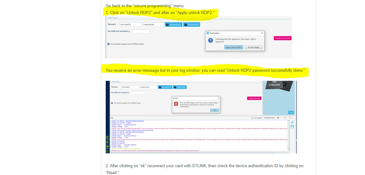

3. How to regress from RDP level 2 to level 0
Go back to the "secure programming" menu:
1. Click on "Unlock RDP2" and after on "Apply unlock RDP2."
You receive an error message but in your log window, you can read "Unlock RDP2 password successfully done."
2. After clicking on "ok" reconnect your card with STLINK, then check the device authentication ID by clicking on "Read."
3. Disable the RDP regression with a password.
4. Go back to the "Read Out Protection" menu and check the value of the RDP.
5. Change the RDP value to “AA” then click on apply.
You have correctly downgraded the RDP from level 2 to level 0.

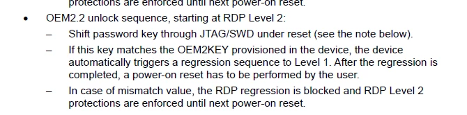

@Diane POMABIA , @Jocelyn RICARD  hello, I'm working on a STM32U595 and I encountered the same issue (not being able to do the regression from RDP2 to RDP1 even with my OEMKEY1 and 2 set etc.
First of all I configured OEMKEY1 and 2 :
Then I followed the full process using Reference Manual + a nice tutorial by ST
:https://www.youtube.com/watch?v=B3l6iuA7U8Q&list=PLnMKNibPkDnEkeKd_fytwc_9x2Ht2gRUn&index=2&ab_channel=STMicroelectronics

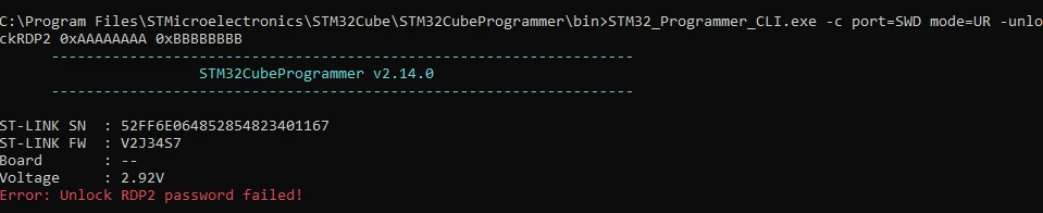

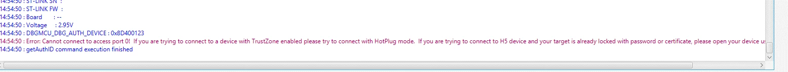

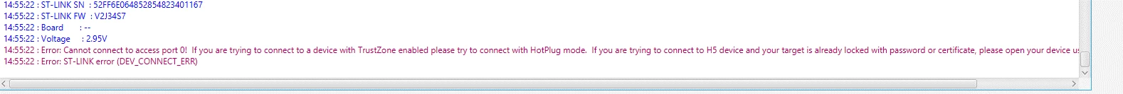

However, it doesn't work, I have two weird behavior :
If I use STM32CubeProgrammer I can read the Auth device ID :
But I can't unlock RDP2 (By the way I tried twice as you answered above):
I tried in command line and what a surprise to see " Unlock RDP2 password failed!"
At some point, I was like "oh it's me, I typed the wrong password", so I tried on an other STM32U595, we were two doing it, so double check. Same issue happened.
