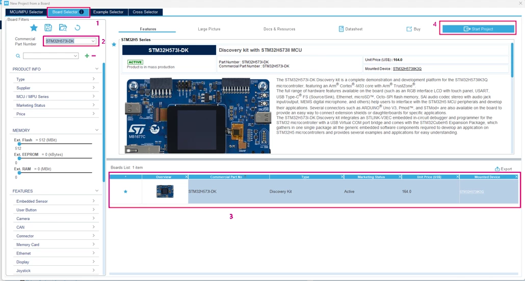

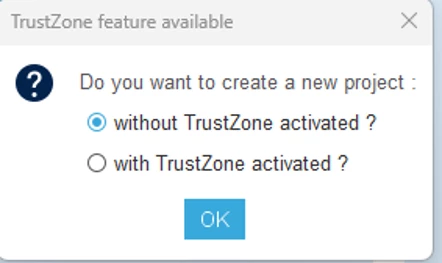

Open STM32CubeMX and navigate to the Board selector: Search for and select STM32H573I.
  • Create a project without TrustZone® activated.

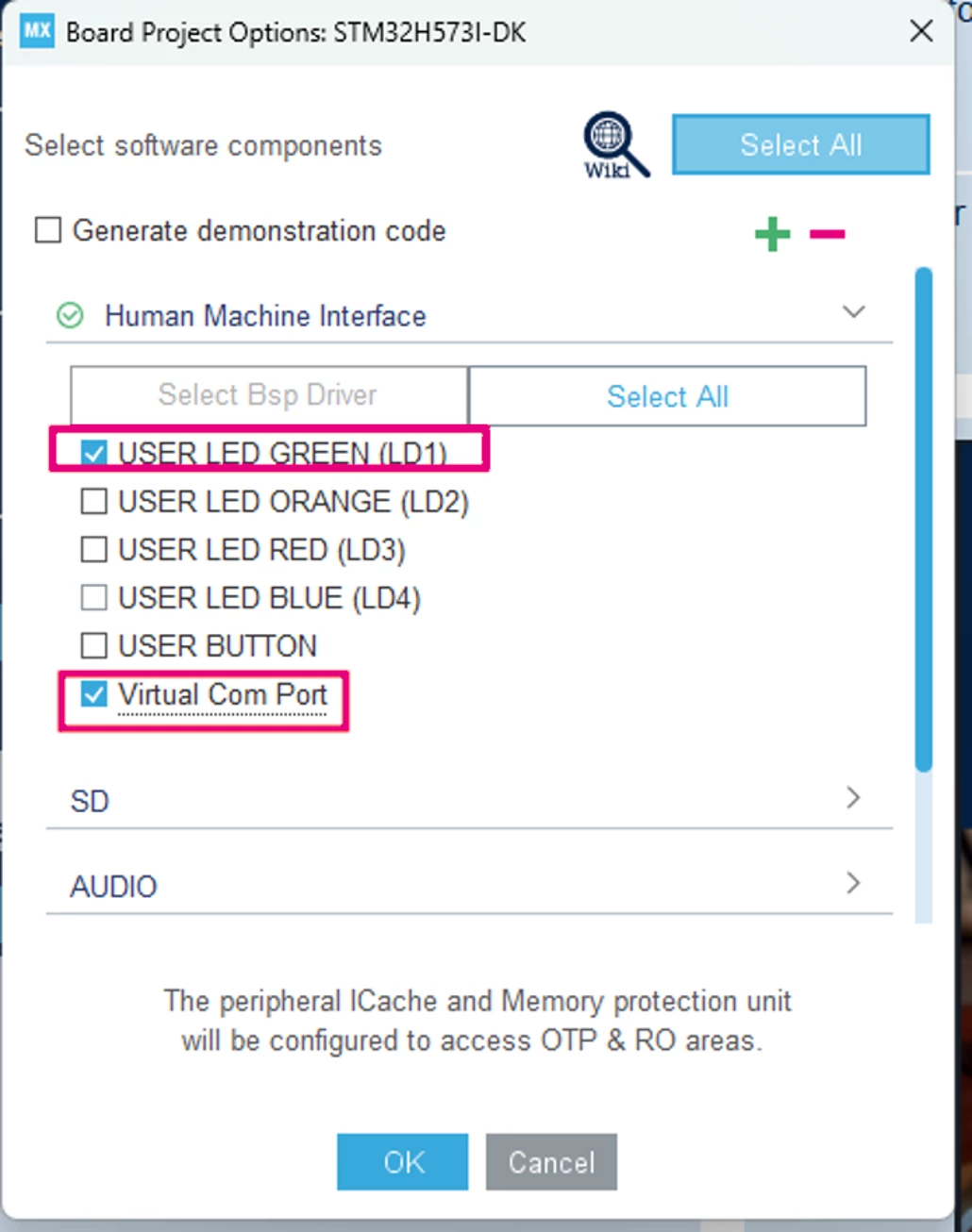

  • For the BSP configuration, configure it as follows. In the software components, click unselect all, then enable only the Green LED and the virtual COM, then click ok.

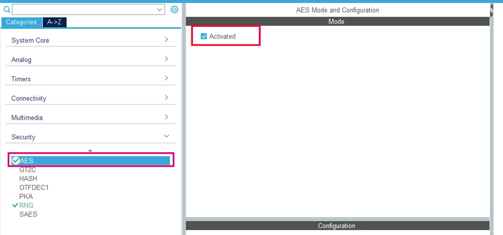

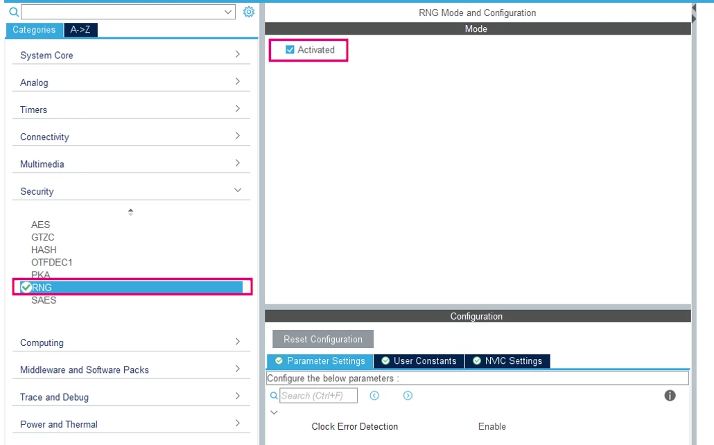

  • Navigate to the security section and enable RNG.
  • Enable the AES.

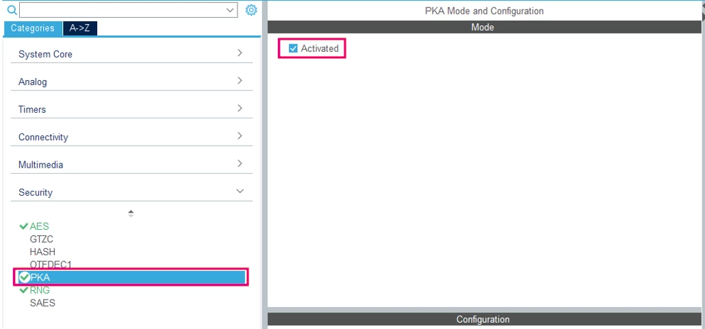

  • Enable PKA.

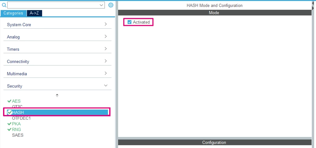

  • Enable HASH.
  • These peripherals provide the hardware acceleration used by the STM32H5 mbedtls_alt implementations.

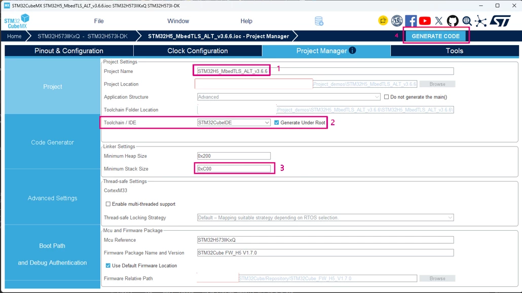

2.2 Project management
  1. Set a project name
  2. Configure the IDE to be STM32CubeIDE
  3. Update the minimum stack size from 0x0400 ~ (1 KB) to 0x0C00 (3 KB)
  4. Click generate
Refer to the memory limitations at the end for more information, then click generate code.

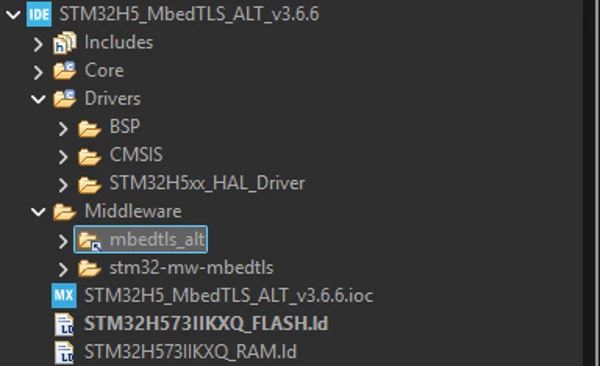

  • Open the project in STM32CubeIDE.

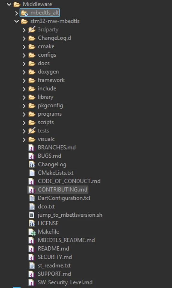

  • The stm32_mw_mbedTLS version 3.6.6 should be installed, and we import it now to our project.

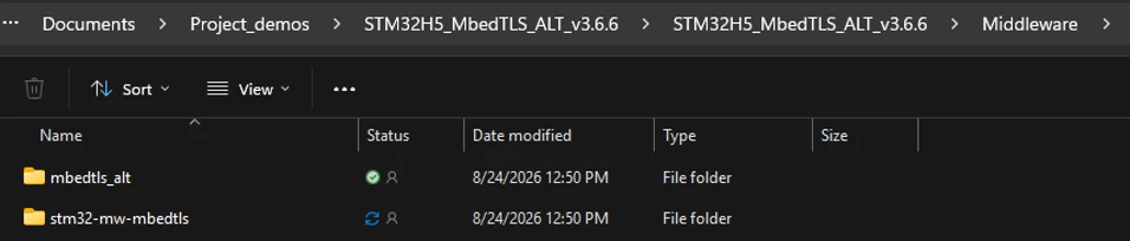

  • Right click on the project and create an empty folder named Middleware.
  • Unzip the stm32_mw_mbedtls.zip, then copy it under the Middleware directory.
  • Right-click and refresh the project, we renamed it to stm32-mw-mbedtls.
  • Include the mbedtls_alt, locate the installation of STM32CubeH5 firmware and copy it to the Middleware directory.
STM32Cube\Repository\STM32Cube_FW_H5_V1.7.0\Middlewares\ST\mbedtls_alt
The resulting project structure should look like the following:

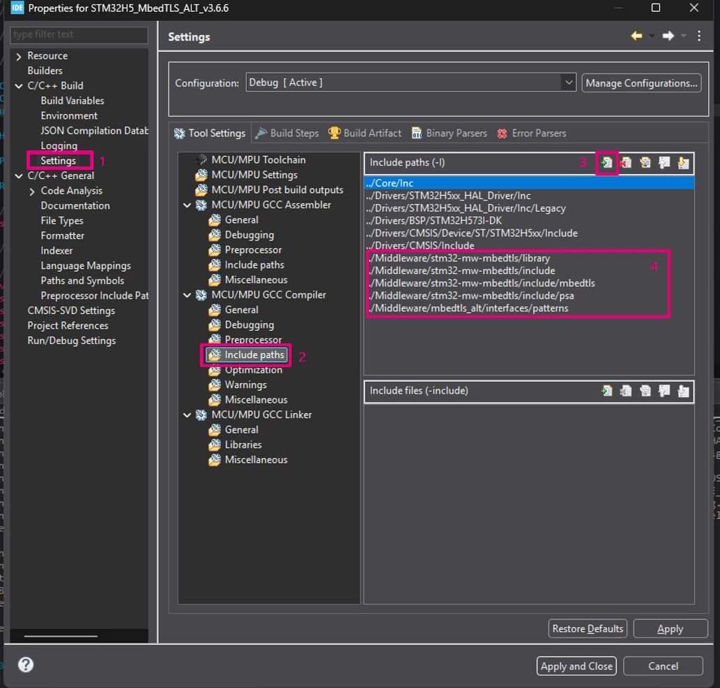

2.3 Project configuration
  • Now, go to project properties → settings  →  include paths, and add these paths:
../Middleware/stm32-mw-mbedtls/include
../Middleware/stm32-mw-mbedtls/include/mbedtls
../Middleware/stm32-mw-mbedtls/include/psa
../Middleware/mbedtls_alt/interfaces/patterns
../Middleware/stm32-mw-mbedtls/library

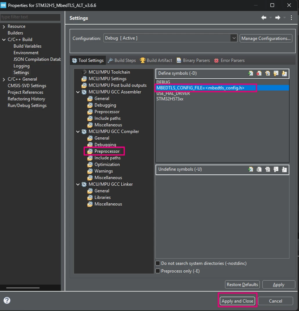

•    In the preprocessor, add: MBEDTLS_CONFIG_FILE=<mbedtls_config.h>
  • Click apply and close.

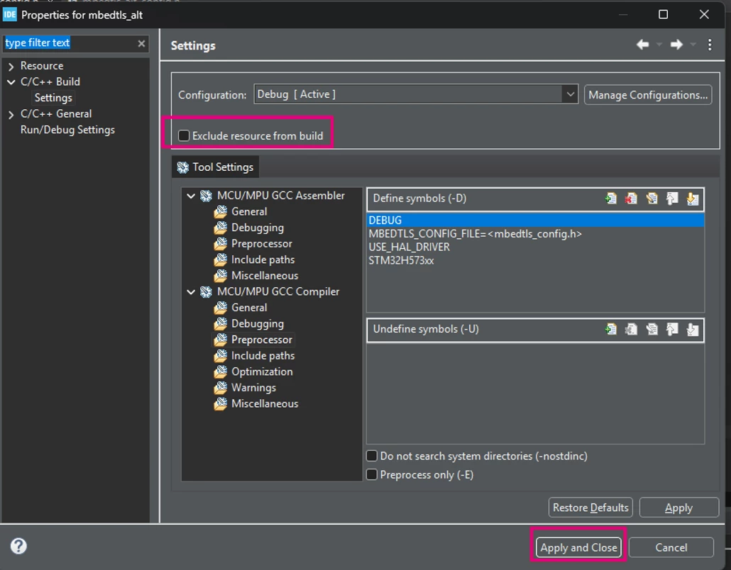

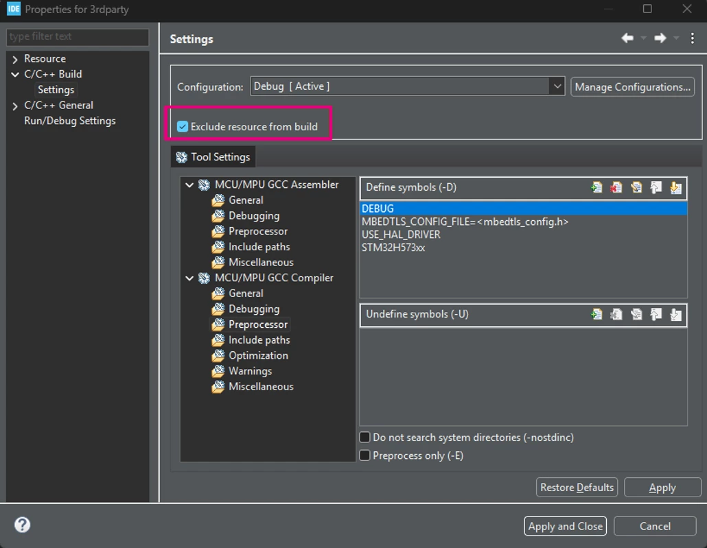

Both stm32-mw-mbedtls and mbedtls_alt need to be included in the compilation process.
  • Right click on the mbedtls_alt and stm32-mw-mbedtls, go to properties -> settings, then unselect exclude from build.
  • Before building, several directories and files that are not required by the application must be excluded from the build.
Middleware/mbedtls_alt/interfaces/patterns/storage_interface_template.c
Middleware/mbedtls_alt/interfaces/patterns/storage_interface_template.h
Middleware/stm32-mw-mbedtls/3rdparty directory
Middleware/stm32-mw-mbedtls/tests directory
Middleware/stm32-mw-mbedtls/programs directory
  • The resulting configuration should look like the following:

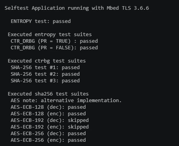

  • Build and run the project from STM32CubeIDE.
  • Open the serial monitor, configure the baud rate to 115200.
  • If the Mbed TLS configuration and hardware acceleration are correctly integrated, the self-tests should be completed successfully. The output should look like the following:

3.2 Memory limitations
Memory allocation must be carefully sized according to the application's requirements. The stack and Mbed TLS memory pool are separate allocations, although both consume the device's available RAM.
For the configuration tested in this article:
  • A 3 KB dedicated memory pool is allocated for Mbed TLS instead of using the system heap.
  • With -O0 optimization, the measured peak stack usage was approximately 2 KB.
  • The 3 KB Mbed TLS memory pool is independent of the stack because it is declared as a global variable. It should therefore not be added to the stack requirement.
The measured stack usage should not be treated as a universal value. The required stack size depends on the Mbed TLS features enabled in mbedtls_config.h, the optimization level, and the application's runtime behavior.
In our case, a 2 KB stack was sufficient for the tested self-test application. However, applications using additional Mbed TLS functionality should provide an appropriate safety margin and verify their actual peak stack usage.
Conclusion
Integrating Mbed TLS with hardware acceleration on STM32H5 microcontrollers provides an efficient way to leverage the device's built-in cryptographic peripherals.
The integration process is straightforward. Add the Mbed TLS library and the corresponding STM32H5 mbedtls_alt implementations to the project and configure the required include-paths. Enable the necessary Mbed TLS features. Finally, build and run the application.
The successful execution of the Mbed TLS self-tests confirms that the cryptographic functionality is correctly integrated and that the supported operations can use the STM32H5 hardware accelerators.
