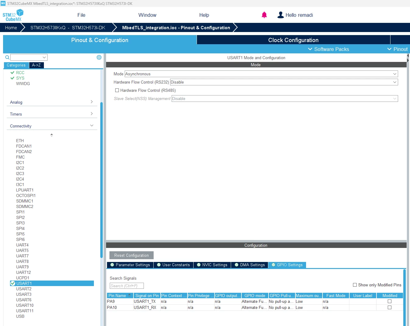

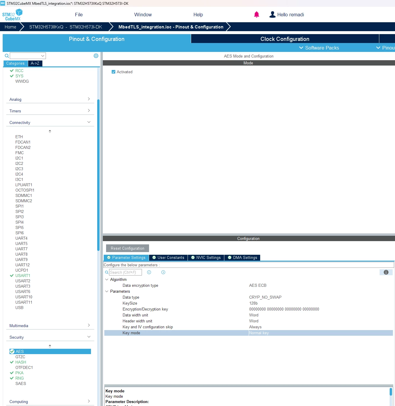

Start a project from CubeMX in which we activate the crypto accelerator modules as well as the USART1 for logging purposes:

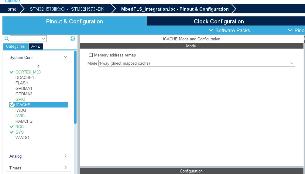

1. Activate the ICACHE.

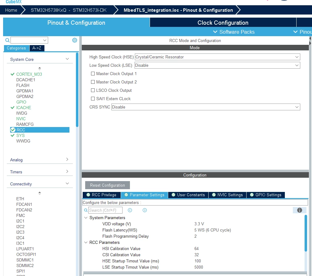

2. Configure the clock.
3. Enable USART1 with pins PA9 and PA10 (mapped to Virtual Com Port) leaving other settings as-is.
4. Enable AES PKA RNG and HASH leaving the default configuration.

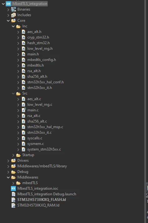

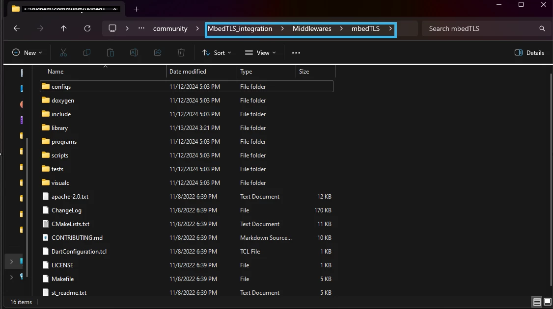

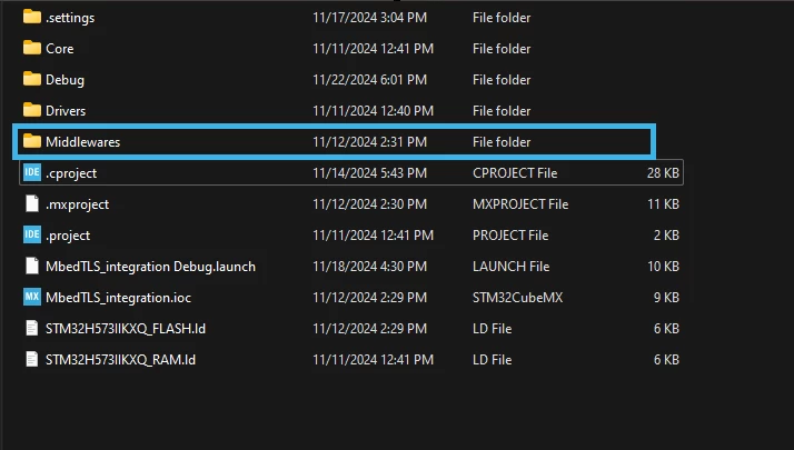

You should have the following file system skeleton. We copy the folder containing the MbedTLS source code into our generated project as shown below. If you want the attached project to work, set the paths as illustrated bellow as they will be referred to later in the project settings.
6. Open the project in STM32CubeIDE and add the header and source files for the alternate implementation. Do this before opening the project by adding the files in the project's Src and Inc folders.

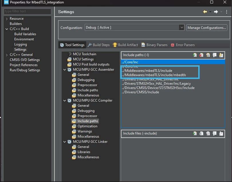

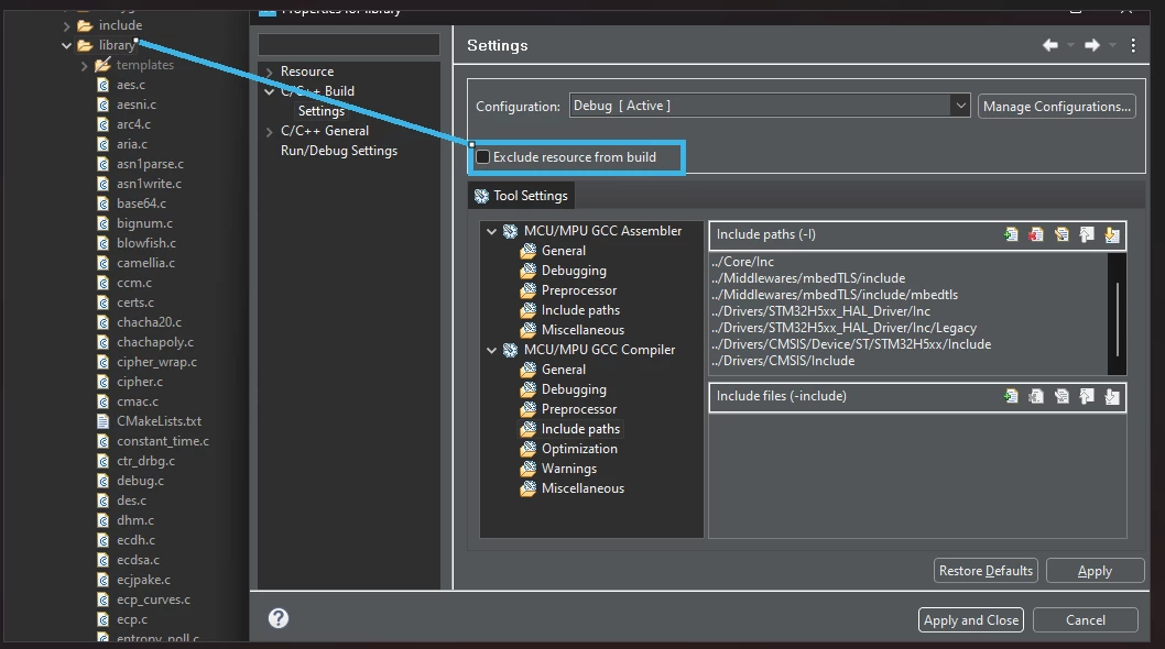

7. Add the include paths for MbedTLS header files to be recognized by your project.

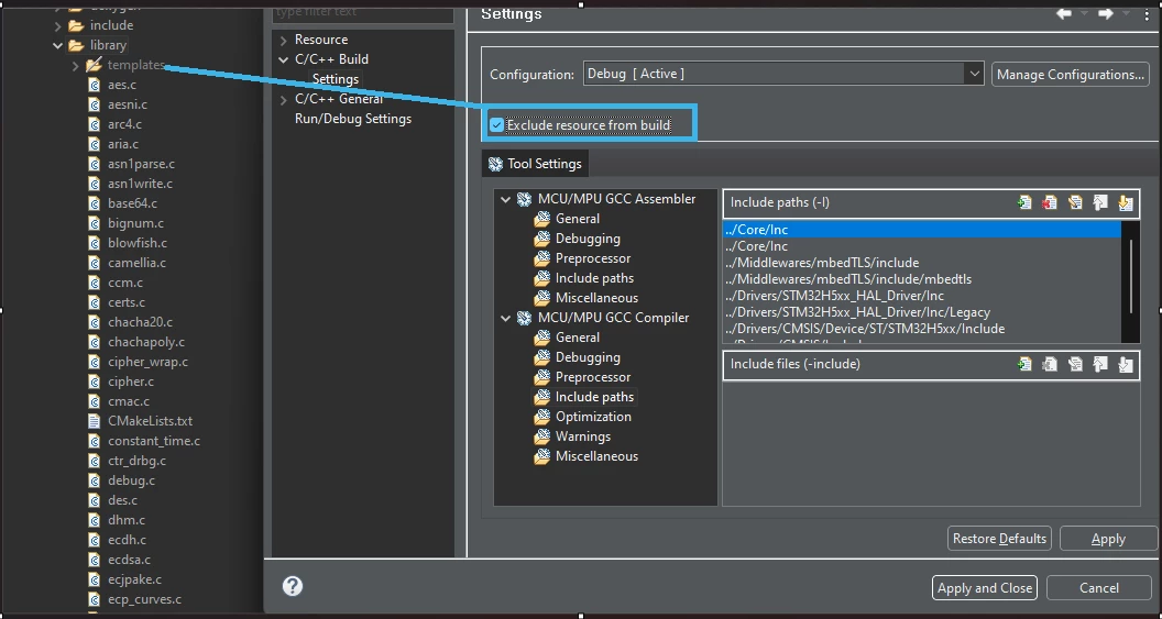

8. In the project explorer, include the "Middlewares/MbedTLS/library" folder in the build and exclude the "Middlewares/MbedTLS/library/templates" from the build.

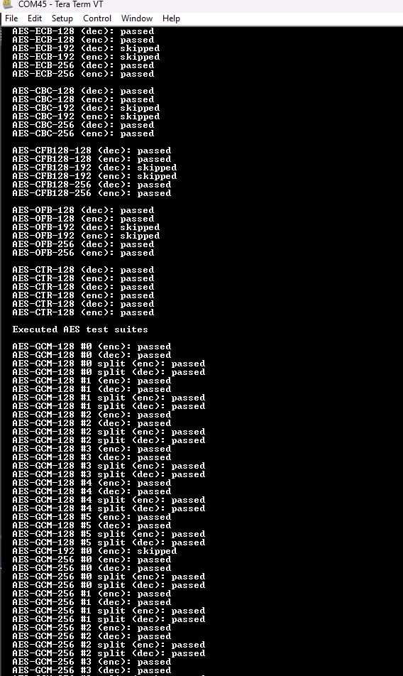

10. Add the following calls below and include the "mbedtls.h" into your main.c file to make the requested header files of the MbedTLS library visible from main.c. To make sure that the lib is properly integrated, we run the selftests for the enabled crypto algorithms which benefit from hardware leveraging.
Note: Other calls to the software-implemented algorithms are still available and valid and can be used when Hardware acceleration is unavailable.
 int v = 1; /* v=1 for verbose mode */
if( mbedtls_sha256_self_test(v) == 0 )
mbedtls_printf( " Executed SHA256 test suites\n\n" );
if( mbedtls_aes_self_test(v) == 0 )
mbedtls_printf( " Executed AES test suites\n\n" );
if( mbedtls_gcm_self_test(v) == 0 )
mbedtls_printf( " Executed AES GCM test suites\n\n" );
if( mbedtls_rsa_self_test(v) == 0 )
mbedtls_printf( " Executed RSA test suites\n\n" );
11. Build and run. We should visualize via a terminal emulator like Tera Term that all selftests passed, indicating that the alternate implementation is working as expected.
