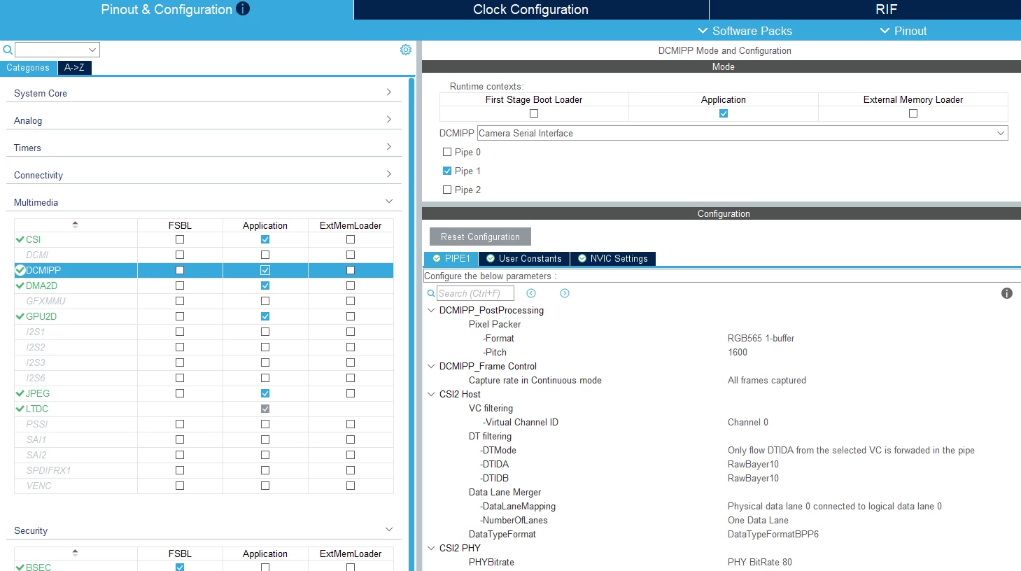

4.2 Activating the digital camera memory interface pixel pipeline (DCMIPP)
From the same tab, select the DCMIPP as a camera serial interface, configure the Pipe 1 as shown in the picture, and apply the configuration:

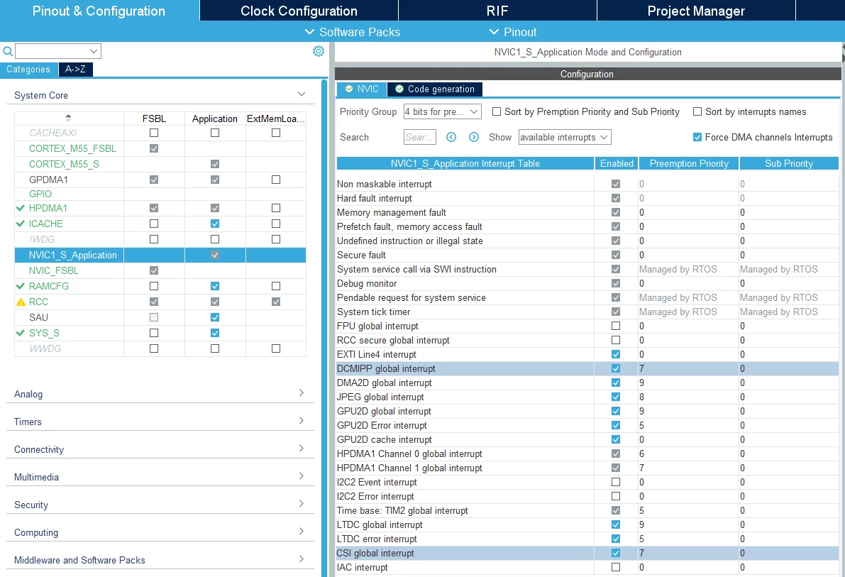

4.4 Handling interrupts
In the Pinout & Configuration tab, navigate to the System Core section. Go to NVIC1_S_Application and activate both DCMIPP global interrupt and CSI global interrupt. Set the preemption priority to 7.

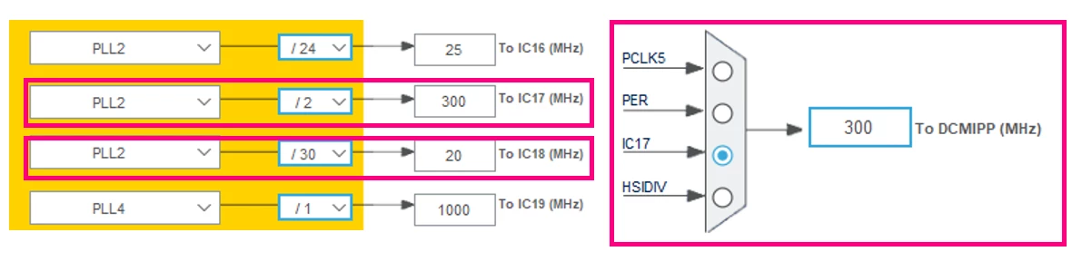

4.5 Clock configuration
Go to the Clock Configuration tab. To achieve the target clock frequency of 300 MHz for the DCMIPP peripheral, set its clock source to IC17, which is derived from PLL2 configured with a divider of 2. This provides a stable and accurate 300 MHz clock for high-speed camera data.
Based on the MCU reference manual, the CSI interface is physically connected to IC18, which supports a maximum clock frequency of 20 MHz. In this example, PLL2 with a divider of 30 is selected as the clock source for IC18 to obtain a CSI clock frequency of approximately 20 MHz.clock_config.png

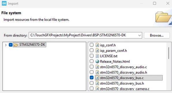

 Then do a right click on the created BSP folder → Import... → File System → Browse → STM32N6570-DK
Import the file needed, which is the stm32n6570_discovery_bus.c.
Click on [Finish] and your Driver's folder structure should be like this in the Project Explorer Window:

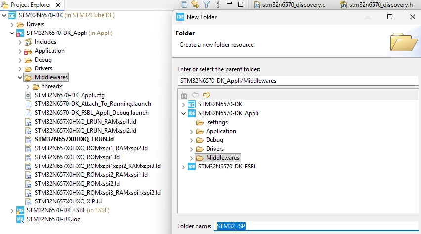

Go back to the STM32CubeIDE. Create a folder under the STM32N6570-DK_Appli middleware's folder and name it STM32_ISP:ISP_create.png
To import the necessary files, right-click on the folder created → import → File System → Browser and navigate to the stm32-mw-isp folder in your project directory. Select only the following necessary files:
Finally click [Finish].
To make sure that everything is as intended, your middleware's folder structure should be like this in the Project Explorer Window:

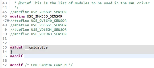

Similarly to how we handled the BSP folder, go to the template file cmw_camera_conf_template.h.
Open the file. Comment out every sensor that is not used. Leave only the IMX335 camera sensor:
//#define USE_VD66GY_SENSOR
#define USE_IMX335_SENSOR
//#define USE_OV5640_SENSOR
//#define USE_VD55G1_SENSOR
//#define USE_VD65G4_SENSOR
//#define USE_VD1943_SENSOR
Exactly as shown in the screenshot below:

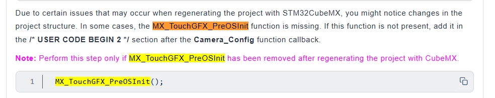

In the main.c file; add this include file in the USER CODE BEGIN Includes:
#include "cmw_camera.h"
/* USER CODE END Includes */
When adding the BSP folder, it is important to note that the I2C2 peripheral is already configured in CubeMX. This pre-configuration creates a conflict with the existing initialization function MX_I2C2_Init. To resolve this issue, rename the function MX_I2C2_Init to MX_I2C2_Init_Cube wherever it appears in the main.c file. This ensures compatibility and prevents conflicts during compilation.
static void MX_I2C2_Init_Cube(void);
Go to your user /* USER CODE BEGIN PFP */ and add the following code:

pPipeConf.PixelPackerFormat = DCMIPP_PIXEL_PACKER_FORMAT_RGB565_1;
/* Set Pitch for Main and Ancillary Pipes */
pPipeConf.PixelPipePitch = 1600 ; /* Number of bytes */
/* Configure Pipe */
if (HAL_DCMIPP_PIPE_SetConfig(*hDcmipp, DCMIPP_PIPE1, &pPipeConf) != HAL_OK)
Error_Handler();

Due to certain issues that may occur when regenerating the project with STM32CubeMX, you might notice changes in the project structure. In some cases, the MX_TouchGFX_PreOSInit function is missing. If this function is not present, add it in the /* USER CODE BEGIN 2 */ section after the Camera_Config function callback.
Note: Perform this step only if MX_TouchGFX_PreOSInit has been removed after regenerating the project with CubeMX.
 MX_TouchGFX_PreOSInit();

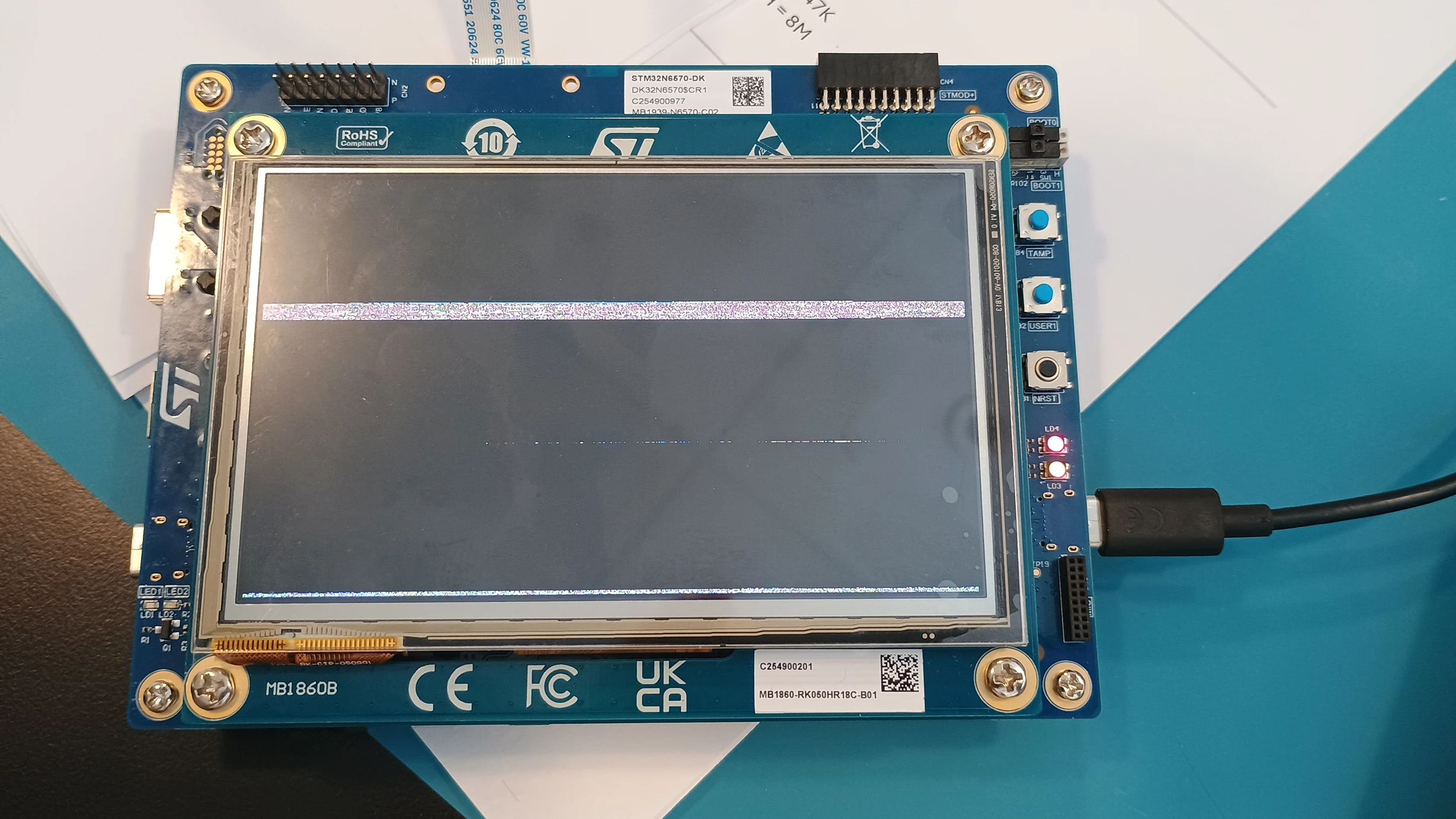

Thanks for posting the guide on getting started with STM32N6570-DK and TouchGFX/camera middleware.
I’ve successfully built and flashed the devkit, but the screen just shows random gibberish pixels of different colors.
The error LED is off.
It seems other commenters have successfully followed your guide, so I must’ve made a mistake along the way.
Could you share the STM32 project or binaries via github or the like?
Perhaps anyone else had a similar problem?
I cannot run this in debugger for some reason, so I can’t see where it fails.
Explorer II
Aug 18, 2026 10:29 AM UTC
Ifound the problem.
MX_TouchGFX_PreOSInit(); was missing.
Power cycling the devboard is necessary.
OumaimaFekih
Aug 26, 2026 11:01 AM UTC
Hello Simon,
I’m glad that you have solved the issue in the end.
This is an STM32CubeMX bug that we are aware of and happens unintentionally and it’s not occurrent after each regeneration, you can regenerate and does not get removed. For this purpose, I already added a note to the article for anyone who encounters it, they should manually add MX_TouchGFX_PreOSInit(); to their code.
You can find this note in the relevant section, as shown in the attached screenshot.
Best regards,
Oumaima

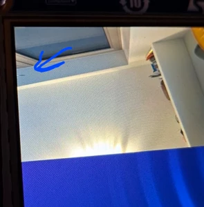

I’ve a few more questions:
  • Did you notice a line creeping upwards on the left side of the live feed?
    It seems to be a wrapping issue, because the “line” contains live feed pixels from the right side.
    I fixed it by changing the HRatio, VRatio, HDivFactor and VDivFactor (values based on the “DCMIPP_ContinuousMode” example).
       DonwsizeConf.HRatio = 26542;
    DonwsizeConf.VRatio = 33177;
    DonwsizeConf.HDivFactor = 316;
    DonwsizeConf.VDivFactor = 252;
    I can still see some tearing that creeps upwards when I wave my hand side to side. I’m not sure how to get rid of that.

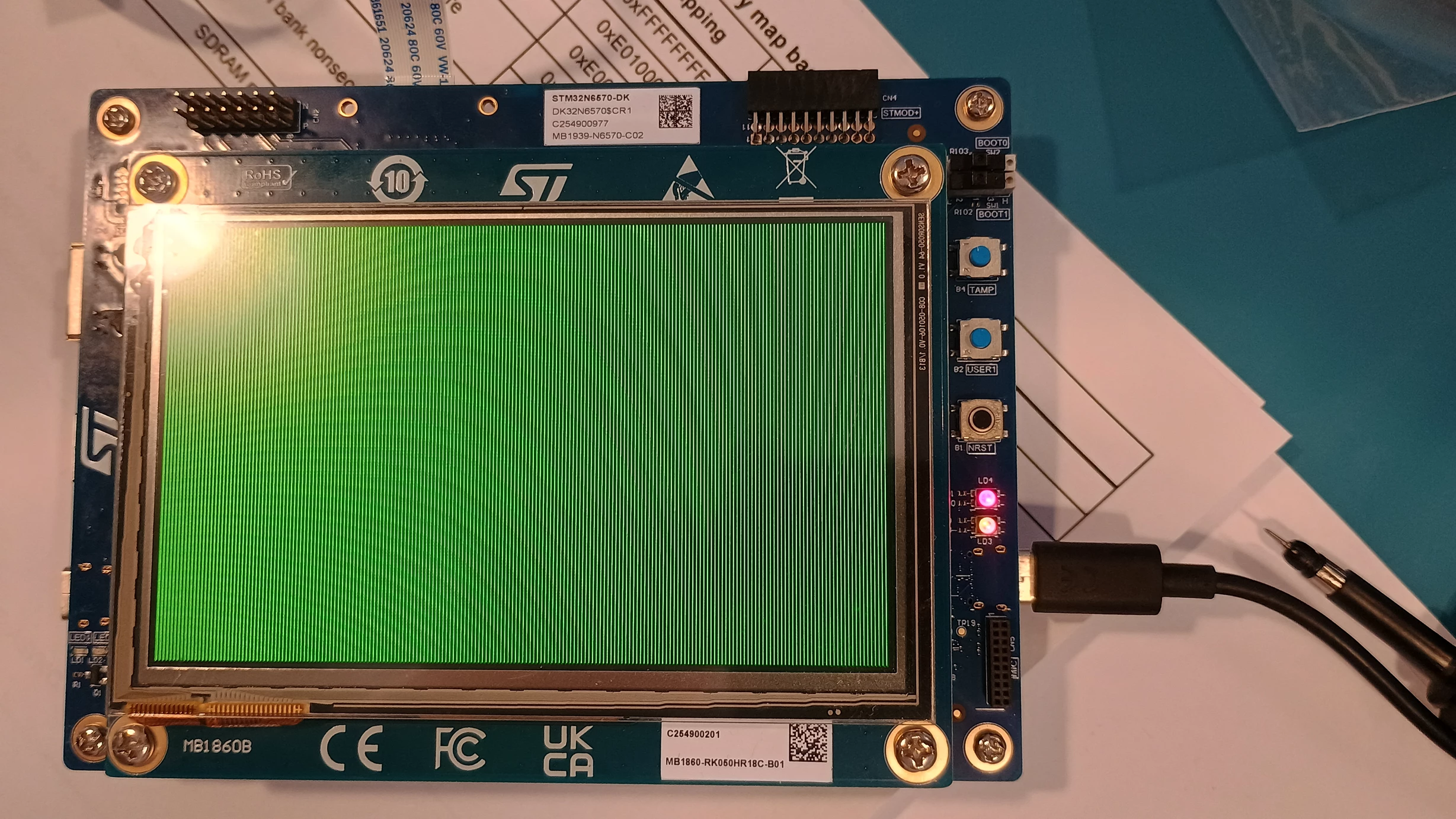

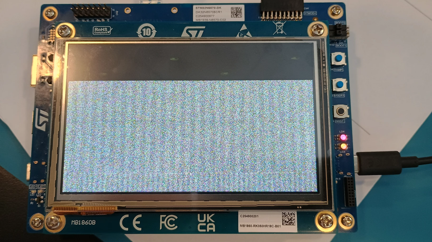

Hi OumaimaFekih
Thanks for this well explained guide, and I look forward to part2 with the ai implementation.
But
I have tried to make all the steps from the guide and et compile without any error. But when i load it up on the board I only get this green screen.
I actually tried with a plain touchgfx generated code without your addons, but with the same result --> Green Screen.
I am using:
I have etried to set the pLayerCfg.FBStartAdress = (uint32_t)0x34146000;(FB_RAM addres) but only gives me black screen and a fat line of random pixels.
I then tried to pLayerCfg.FBStartAdress = (uint32_t) L2_BASE_ADDRESS; (camerabuffer), and i get the top black screen with these dots thats moves when camera moves around, the rest is random pixels.
Do you have any idea what can be wrong and why touchgfx is not in the frabuffer, is it something with the version or have I missed something ?
Best
This is solved !!! --> I forgot to upload resource file "STM32N6570-DK_Appli_assets.hex"
