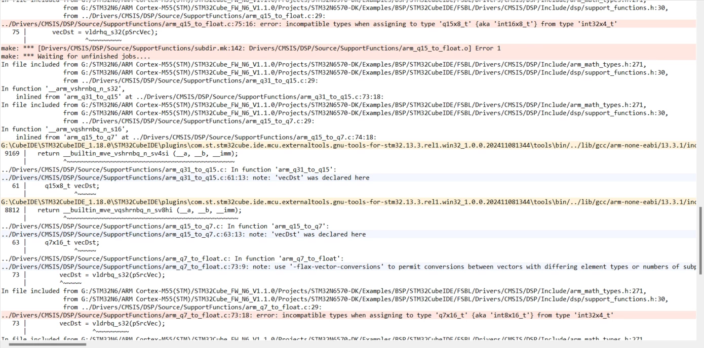

Hello, in the process of importing DSP library, I followed the tutorial steps to delete the relevant files, but in the SupportFunctions folder, I reported the above two errors, how to solve? thank you
Mar 30, 2025 2:46 AM UTC
I have not experienced those errors, JACK-LUCK. Maybe check that you added the folders to your project's include paths as shown above, and have #include "arm_math.h"?
Mar 30, 2025 4:03 PM UTC
What mcu are you compiling the support_functions that you are having the errors?
Mar 31, 2025 1:16 AM UTC
I included the relevant content according to the tutorial, also added #include "arm_math.h", I used STM32N657X0H, please, thank you

Hello @JACK-LUCK and welcome to the community;
For STM32N6 devices could you please try to add this flag -flax-vector-conversions in Project => Properties => C/C++ Build => Settings => MCU/MPU GCC Compiler => Miscellaneous => "Other flags"
If the issue isn't solved, I recommend you to create a new post in the community and share your project?
I hope this help you!
