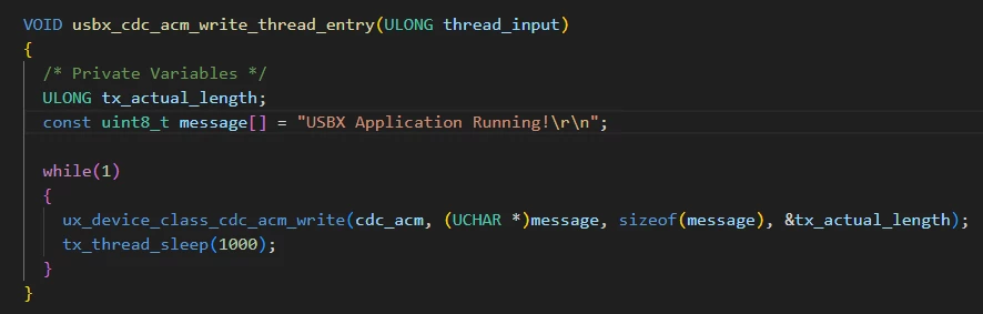

/* USER CODE BEGIN 1 */
VOID usbx_cdc_acm_write_thread_entry(ULONG thread_input)
 /* Private Variables */
 ULONG tx_actual_length;
 const uint8_t message[] = "USBX Application Running!\r\n";
 while(1)
 ux_device_class_cdc_acm_write(cdc_acm, (UCHAR *)(message), sizeof(message), &tx_actual_length);
 tx_thread_sleep(100);

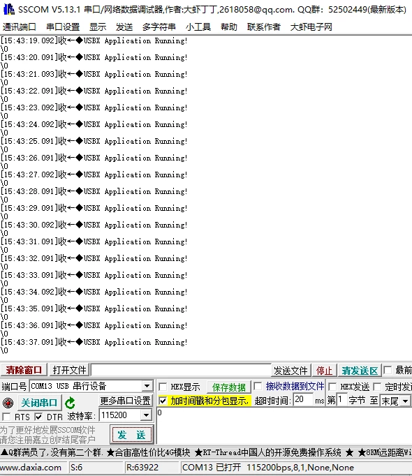

And that concludes our example code. Connect the USB of the STLINK in your board, then the USB Type-C®, start a debug session and see the application running!
2. Results
Once you have opened the debug session, let the code run and open a virtual COM port terminal in your computer. The “USBX Application Running!” message should be printed on every second. If you send the character ‘1’ the Orange LED should be turned ON, and it should be turned OFF when the character ‘0’ is sent.

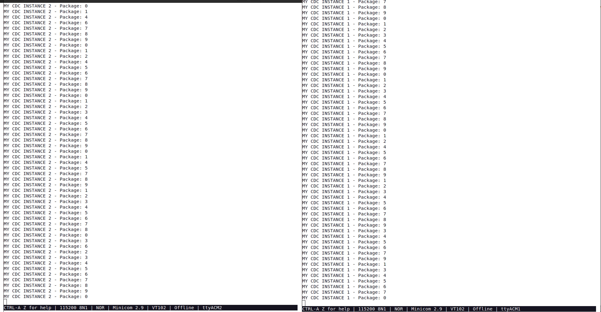

However, I am facing an issue when I try to add a dual composite cdc-acm device (Two ACMs).
I have not received any support from ST on two of my posts:
Could you please look into it?

Hi @NRedd.2 ,
I have a USBX running dual CDC ACM for the STM32H503, hope this is a good starting point for your application. I've added the zip project in a temp repo> brunomontanari/USBX_2CDC (github.com)

Aug 17, 2024 7:08 AM UTC
Hi @B.Montanari,
Thank you for the quick response!
I am not able to open the Zip after I downloaded. Can you please upload it again?
> unzip dual_cdc_acm_h503.zip
Archive: dual_cdc_acm_h503.zip
 End-of-central-directory signature not found. Either this file is not
 a zipfile, or it constitutes one disk of a multi-part archive. In the
 latter case the central directory and zipfile comment will be found on
 the last disk(s) of this archive.
unzip: cannot find zipfile directory in one of dual_cdc_acm_h503.zip or
 dual_cdc_acm_h503.zip.zip, and cannot find dual_cdc_acm_h503.zip.ZIP, period.
B.Montanari
Aug 19, 2024 1:40 PM UTC
Hi @NRedd.2
Just uploaded again, should be all set now.
B.Montanari
NRedd.2
Aug 19, 2024 8:37 PM UTC
Hi @B.Montanari,
Thank you so much!
I got it working with your example code on STM32WB5.
https://github.com/navinreddy23/USBX_Dual_ACM/tree/BrunoMontanari-Implementation.
But from the original implementation, when I make changes it still outputs gibberish on UART console. https://github.com/navinreddy23/USBX_Dual_ACM
Any idea what could be going wrong? I am not sure if or how UART is being involved when second ACM is added.

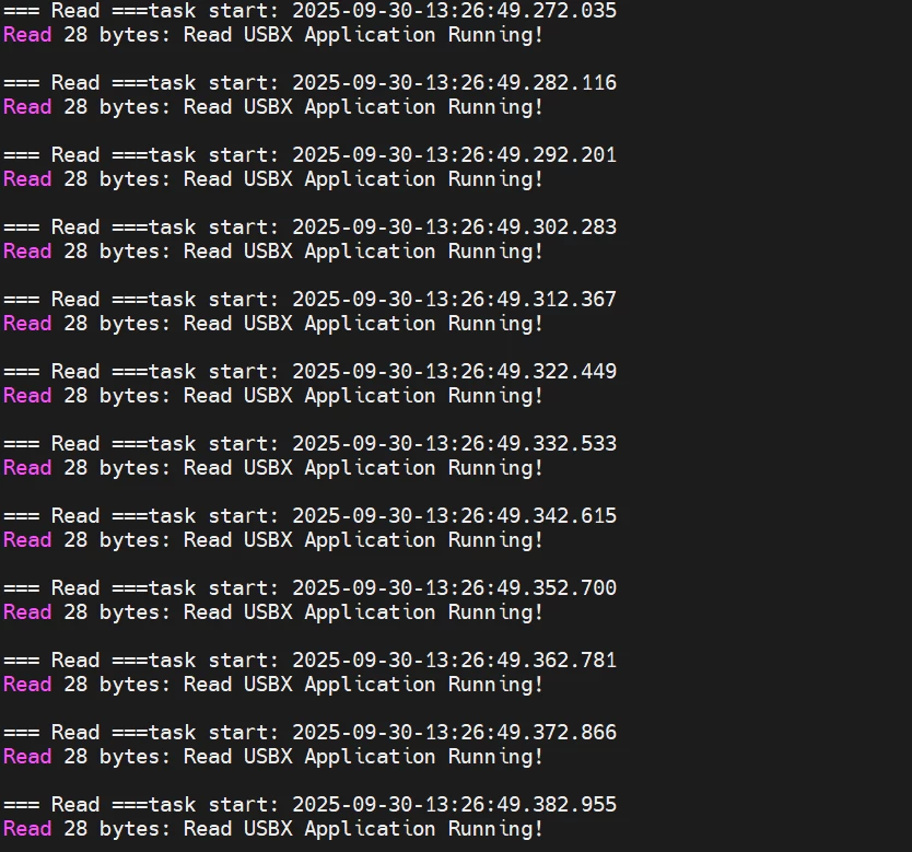

May 16, 2025 11:01 PM UTC
Hi All & @B.Montanari
  I'm trying to follow this example (and I've tried some others as well).  Each time I've run into a discrepancy that seems to be fundamental and not due to the fact that I'm using a BlackPill (STM32F411CE) board.
