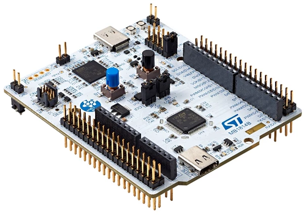

For this tutorial, we use the NUCLEO-H503RB board, to implement CDC (Communications Device Class) and HID (Human Interface Device) classes through USB communication. The CDC is used to open a Virtual COM port communication, and the HID acts as a mouse. This board has an STM32H503RBT6 microcontroller, and for further details about the board, refer to the user manual.  The steps shown here can be easily adapted to any other STM32. The STM32CubeIDE 1.15.1, the STM32CubeH5 1.2.0 releases were used to build this tutorial.
Figure 1. NUCLEO-H503RBFigure 1. NUCLEO-H503RB

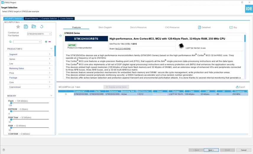

Let us start by creating a project for the STM32H503RBT6 microcontroller in STM32CubeIDE.
Figure 2. Project Creation - STM32CubeIDEFigure 2. Project Creation - STM32CubeIDE

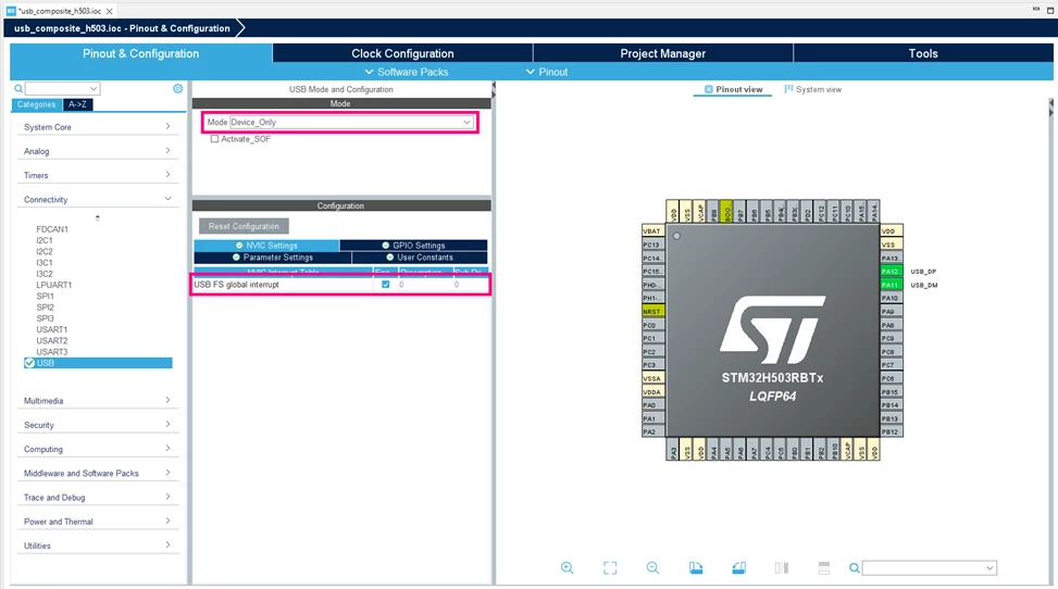

Once the project creation is done, enable the USB peripheral in [Device_Only] mode and activate its interrupt in the [NVIC Settings] tab.
Figure 3. USB Peripheral configuration - STM32CubeIDEFigure 3. USB Peripheral configuration - STM32CubeIDE

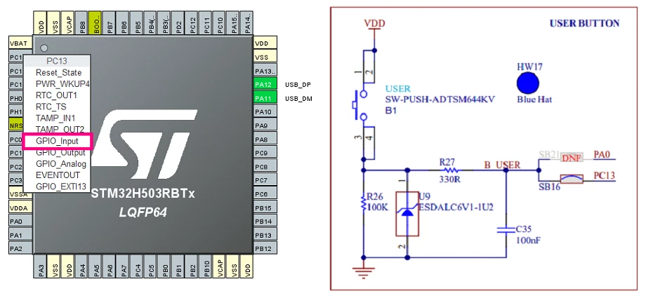

For this example, we use the User button to control the mouse through the HID class. For that, configure the GPIO PC13 as GPIO input. Since the pins have an external pull-down and the button shorts it to VDD, it is not necessary to enable either a pull-up or down internal resistor.
Figure 4. User button settingsFigure 4. User button settings

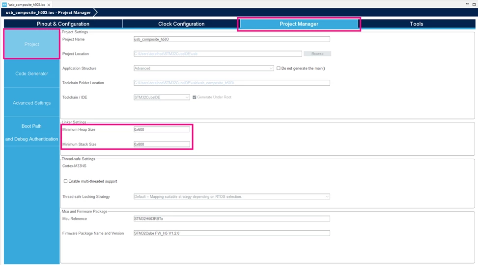

After that, increase the amount of heap and stack sizes of the project as indicated in the image below, this action is done in the [Project Manager] tab:
Figure 5. Heap and Stack size - STM32CubeIDEFigure 5. Heap and Stack size - STM32CubeIDE

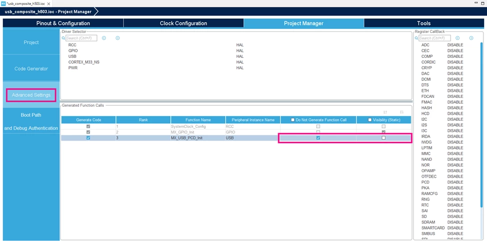

For the next step, navigate to the [Advanced Settings] tab, and change the USB generation settings as follows:
Figure 6. Code generation settings - STM32CubeIDEFigure 6. Code generation settings - STM32CubeIDE

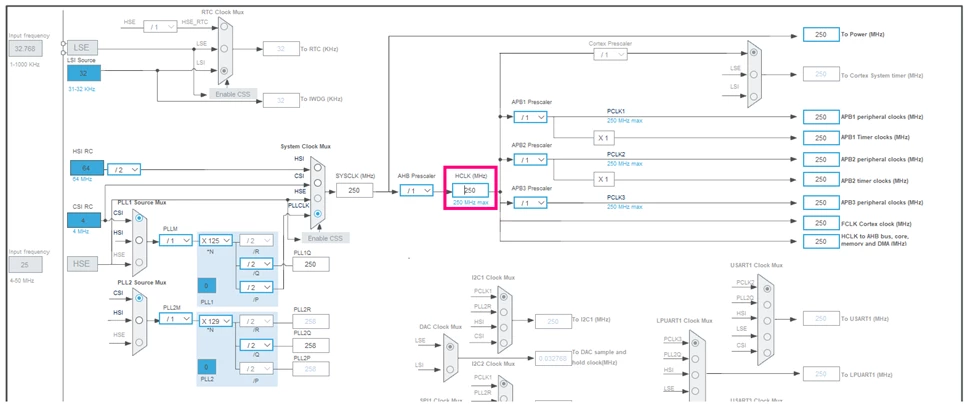

The last step before generating the code is to update the system clock frequency. According to the STM32H503 Reference Manual, the USB peripheral requires at least 12MHz of clock frequency at the APB2 bus to avoid data overrun and underrun problems. Just for this example, we set the clock frequency to the maximum allowed to achieve the best performance.
Figure 7. Clock configuration - STM32CubeIDEFigure 7. Clock configuration - STM32CubeIDE

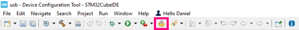

With those settings, you are all set to proceed with the code generation. So, click on the code generator button or press the alt + K shortcut.
Figure 9. Code generation - STM32CubeIDEFigure 9. Code generation - STM32CubeIDE

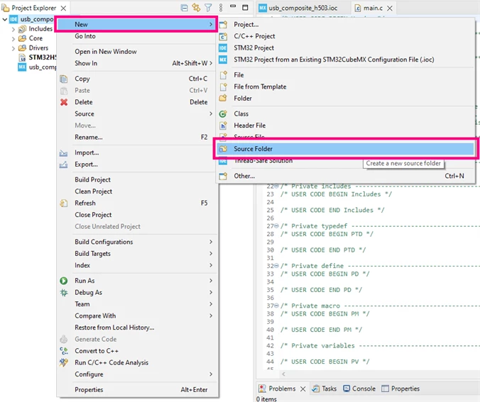

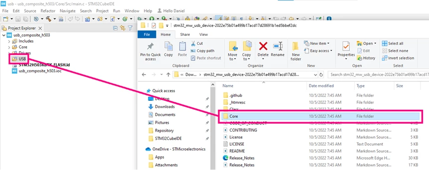

Once downloaded, extract the compressed content and go back to the STM32CubeIDE. Here we create a folder to accommodate the USB stack files. So, right-click over the project, then go to [New] -> [Source Folder], we give it a name “USB”.
Figure 10. Creating a source folder - STM32CubeIDEFigure 10. Creating a source folder - STM32CubeIDE
For the next step, open the USB middleware folder (the downloaded one), then drag and drop the Core folder within the created USB folder.
Figure 11. Importing Core folder - STM32CubeIDEFigure 11. Importing Core folder - STM32CubeIDE

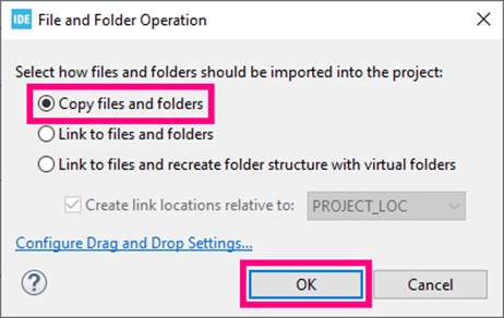

When prompted, select [Copy files and folders], then press [OK].
Figure 12. Import options - STM32CubeIDEFigure 12. Import options - STM32CubeIDE

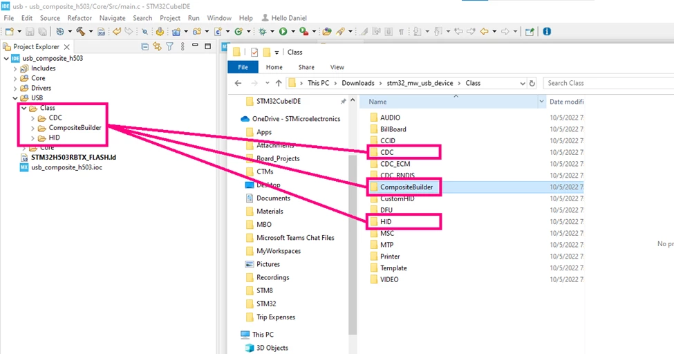

Now, within the created “USB” folder, create another one called “Class” and finally import all the classes that are used your application. In addition, copy the CompositeBuilder class. This contains all the necessary code to build the composite descriptor.
Figure 13. Importing files and folders - STM32CubeIDEFigure 13. Importing files and folders - STM32CubeIDE

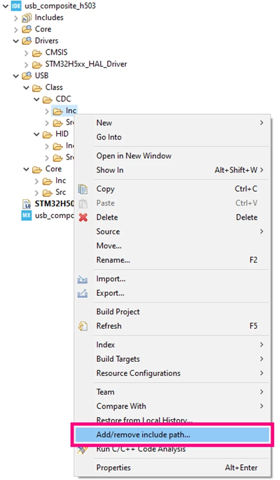

After doing that, we must configure the compiler to find all the include files. For that, right-click over all the folders called “Inc” then go to Add/remove include path… then click OK. It is necessary to do it for all the imported folders called “Inc”.
Figure 14. Referencing header files - STM32CubeIDEFigure 14. Referencing header files - STM32CubeIDE

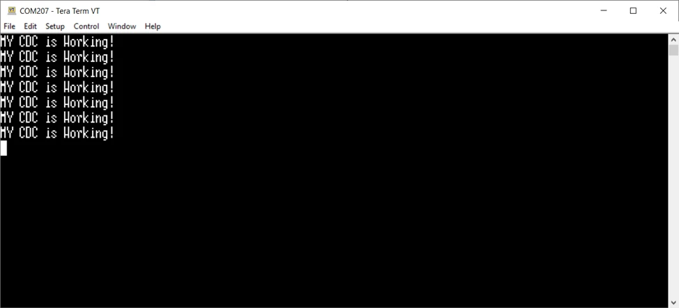

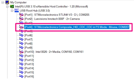

2. Results
After flashing the code, connect a USB Type-C® cable into the User USB Connector and connect to a computer. Once connected, a USB Composite device must be enumerated with the two classes HID and CDC. Open a terminal to observe the message being transmitted and the mouse being moved when the button is pressed.
Figure 15. Demo working - Tera TermFigure 15. Demo working - Tera Term
Figure 16. Composite Device recognized by host - USB Tree ViewFigure 16. Composite Device recognized by host - USB Tree View
