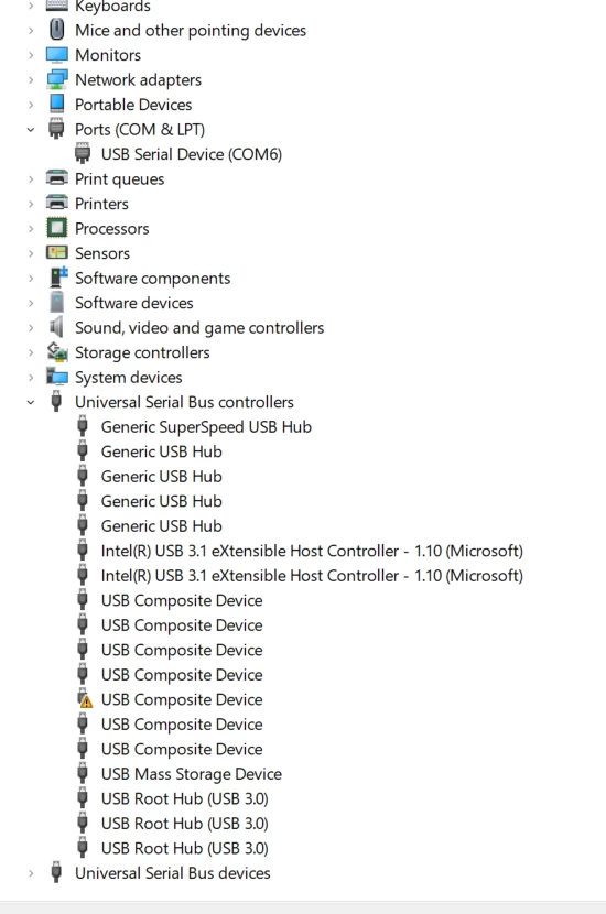

To use the HID and CDC classes, these settings are enough. If other classes are used, edit the file per your application requirements.
Once you are done with the changes, save and close the usbd_conf.h file. Then open the usbd_conf.c. Within this one, we need to link the HAL PCD drivers with the USB stack. So, let us start including the necessary header files. Here it's also necessary to include the header of all used classes.

Jan 24, 2025 4:20 AM UTC
hi,
I am using "NUCLEO-H533RE" and followed this tutorial exactly.
After flashing, I tried to connect the board to Windows11 and 10, it can enumerate partially and the Windows says "USB device functionality might be limited", and device manager shows like following (virtual com port is not showing, COM6 is the ST-Link's):
any suggestion to fix this issue?
Thank you very much
Don

Hello @abr,
To implement the composite with DFU, it's necessary to do some driver settings change.
Based on the request, we're finishing the development of an article which will cover the implementation. It should be released soon.
Regarding the multiple instances of CDC were you able to finish the implementation?
I've attached an example code showing on how you can do that.
