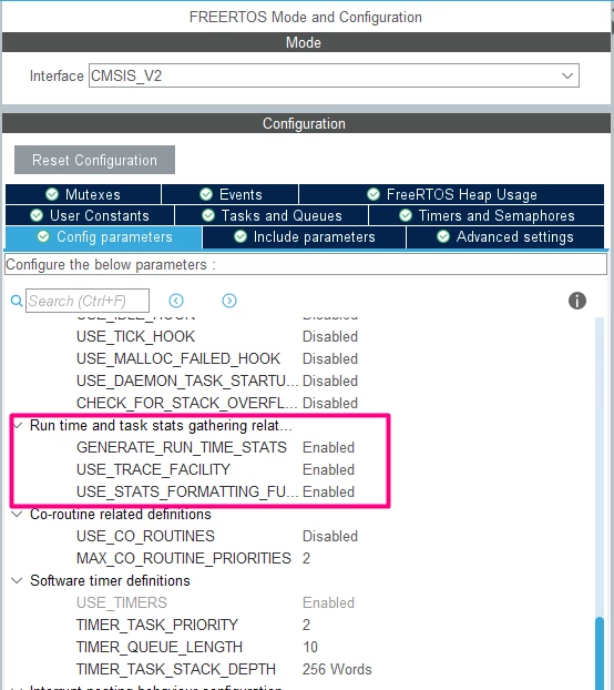

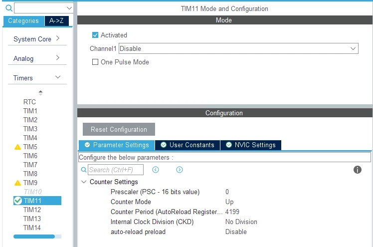

On the STM32CubeMX portion, the first peripheral to be configured is the SYS. Locate and change the debug settings to "Trace Asynchronous Sw." In the same portion, change the "TimeBase Source" from SysTick to another Timer.
BMontanari_0-1704993362634.pngWe must enable the trace information by setting the define configUSE_TRACE_FACILITY to 1 in freeRTOSConfig.h. It results in additional structure members and functions to be included in the build. Furthermore, it enables, for instance, stack checking in the FreeRTOS "Task List View" and lists the semaphore types in the FreeRTOS "Semaphores View." It is also possible to configure the RTOS through STM32CubeMX, as follows:BMontanari_1-1704993362640.png

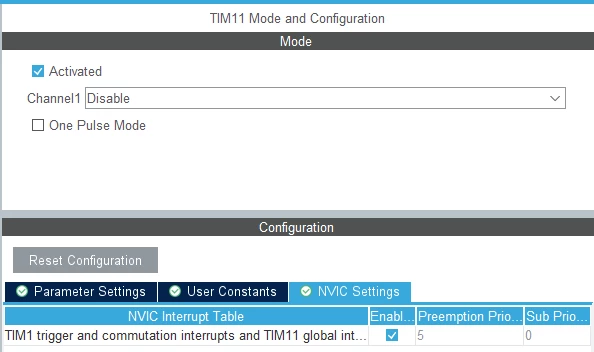

To validate the RTOS runtime statistics, the application must set up an additional time base. It is recommended to have it run at least 10 times faster than the frequency of the clock used to handle the RTOS tick interrupt. In this case, we selected TIM11
NOTE: Any timer can be enabled, except for SysTick or the Time Base Source selected for the HAL driver.

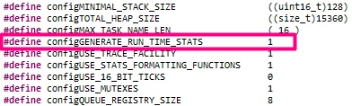

To enable the collection of run time statistics, the file freeRTOSConfig.h must include:
  1. Set the define configGENERATE_RUN_TIME_STATS value to 1.
  1. Define portCONFIGURE_TIMER_FOR_RUN_TIME_STATS() to call the function that configures a timer. The timer is used for profiling, and define portGET_RUN_TIME_COUNTER_VALUE() to call the function that reads the current value from the profiling timer

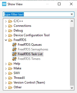

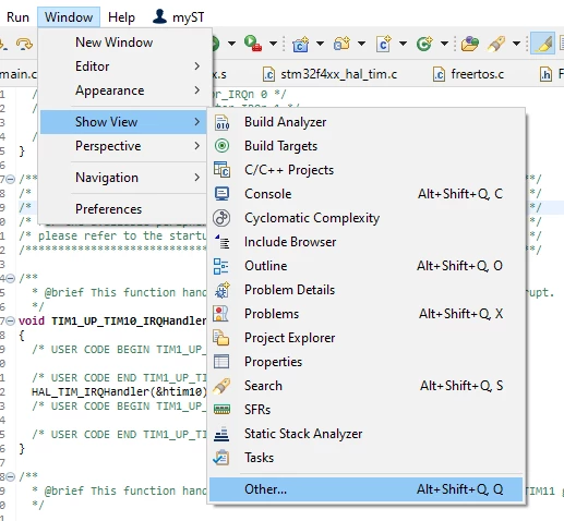

FreeRTOS debug views
From the debugger perspective, you can open the FreeRTOS-related views from the menu. To do so, select the menu command:
Window > Show View > Other > FreeRTOS > FreeRTOS Task List
Alternatively, use “Quick Access”. Search for “FreeRTOS” and select from the views. The FreeRTOS Task List view provides detailed information about all available tasks in the target system. The task list is updated automatically every time the target execution is suspended.

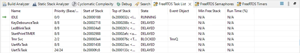

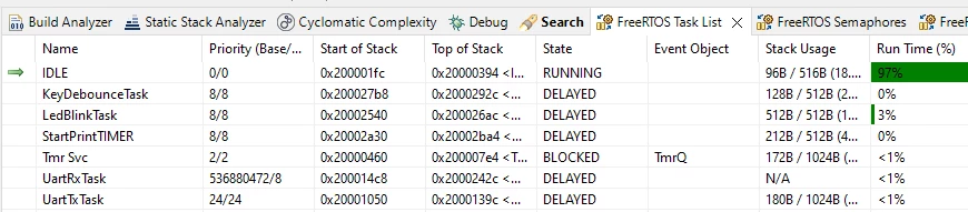

There is a column for each type of task parameter and a row for each task. By default, stack analysis (the Min Free Stack column) is disabled due to performance reasons. To enable stack analysis, use the Toggle Stack Checking button in the FreeRTOS Task List view toolbar, as shown in the figure below.
We can see the following view on the Task List tab if debug runs for a while and it's paused:

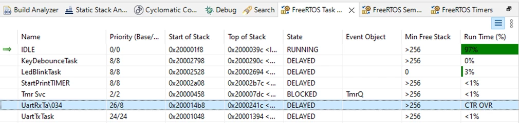

The column information is changed from Min Free Stack to Stack Usage if the project is built with the following define set in the FreeRTOS.h file (around line 401):
In this case, the full stack usage is presented according to the format Used/Total(%Used) as shown in the image below.
For comparison purposes, here is a screenshot of the Task List View with default settings. We can clearly note the significant data losses.

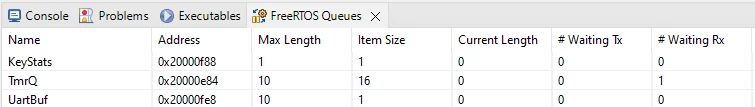

No additional change occurs on the other different perspectives that are available. The default view for Queue, Semaphore and Timer View are always showing its contents to the fullest:
Queue View:

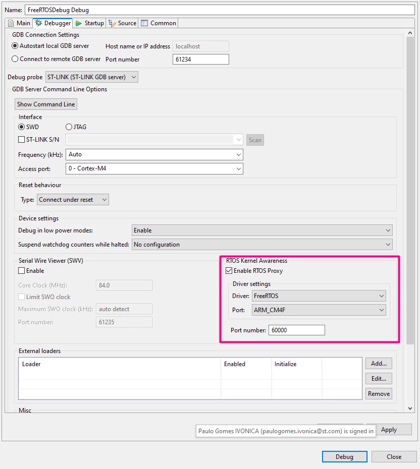

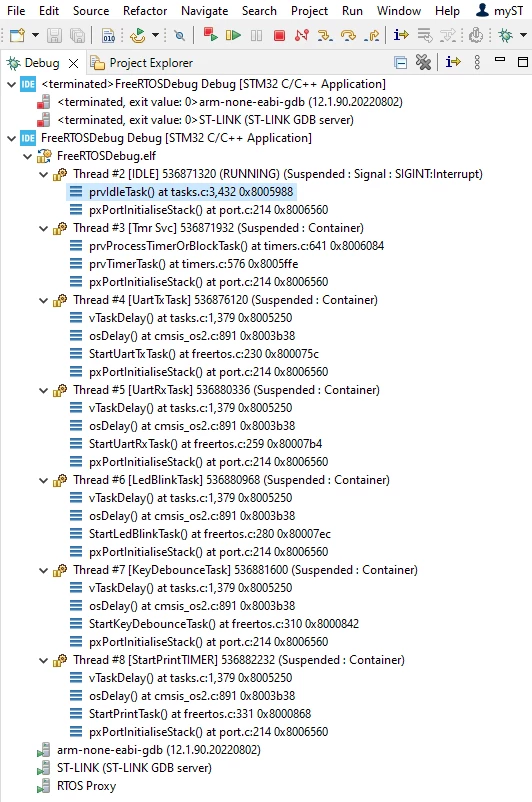

RTOS-kernel-aware debug
The RTOS-kernel-aware debug feature in STM32CubeIDE facilitates support for Microsoft Azure RTOS ThreadX and FreeRTOS™ operating systems, through the use of an RTOS proxy. The STM32CubeIDE includes the RTOS proxy, which can be utilized with an STLINK GDB server, OpenOCD, and Segger J-Link GDB server.
To enable RTOS-kernel-aware debugging, the "debugger" tab in the "Debug Configurations" dialog contains settings to enable and configure the following:
  • RTOS proxy
  • Driver (RTOS ThreadX or FreeRTOS)
  • Port (Cortex® core) and configuration of port number to use with the proxy.
Upon enabling RTOS-kernel-aware debugging and initiating a debug session, all threads are displayed in the debug view. By selecting a thread in the debug view, the current context of the thread is visualized in various views. For example, the variables, registers, and editor views reflect the active stack frame. For example:

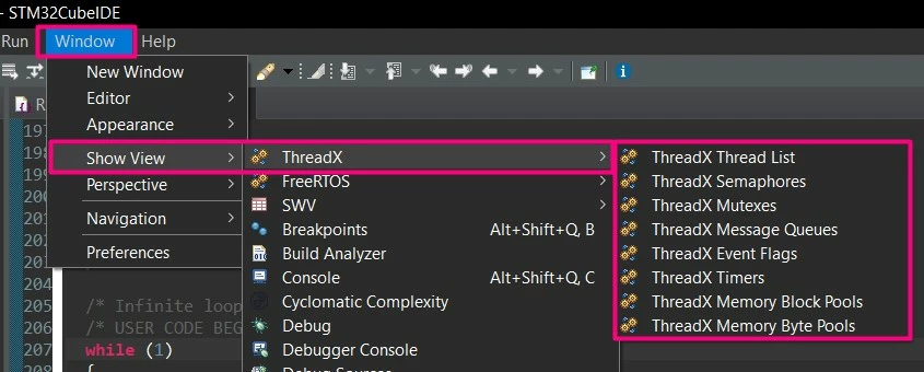

@diverger ,
Yes, you can have a very similar settings for ThreadX, once in debug mode, you can click on [Window][Show View][ThreadX] and select the resources you want to monitor:
ThreadX also allows you to enable TraceX, which is a great way to evaluate the behavior of the RTOS during a certain period of time. That works similar to a log, rather than a regular update during the debug session, but it can be quite helpful. We have two articles talking about it, in case you want to look>

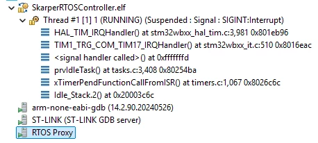

June 26, 2025
This is great. Everything works except the thread view, which only shows one thread. Any tips about how to debug it?
I am using FreeRTOS on a WB55. I have RTOS Proxy enabled and 15 threads running.
