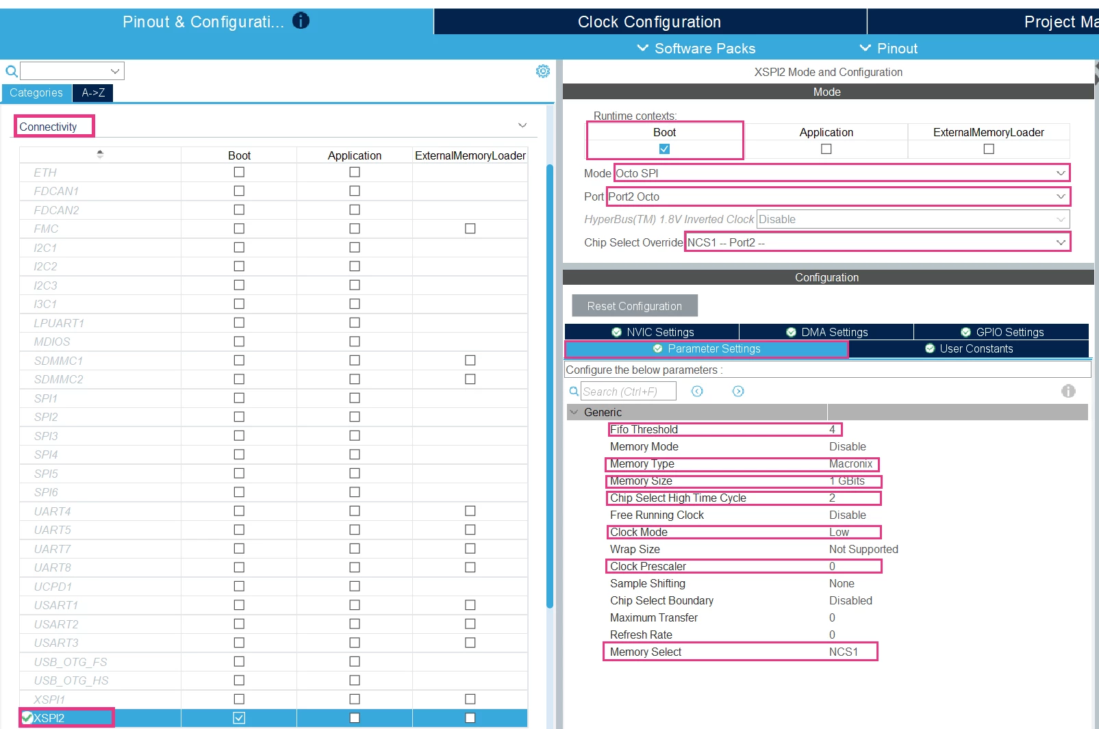

Step 4: XSPI mode and configuration
To access and communicate with the external flash memory, configure the XSPI2 interface as shown in the screenshot below.
For the GPIO Settings, verify that the XSPI pins are configured “Very High”.
Note: For more details about the type of external flash memory and its specifications, refer to "How to configure the external flash memory MX66UW1G45G on the STM32H7S78-DK via XSPI interface" article.
