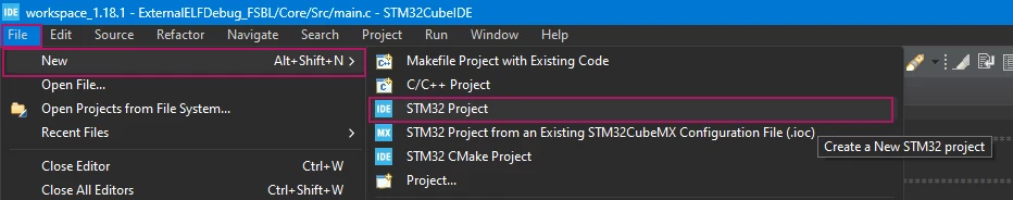

Create a new project using the STM32CubeMX integration inside the STM32CubeIDE, by clicking [File][New][STM32 Project], under the [MCU Selector] section for your desired microcontroller, in this case [STM32N657X0H3Q]. Once the project is created, press [Ctrl+S] to save the blank project, and the base code is generated.

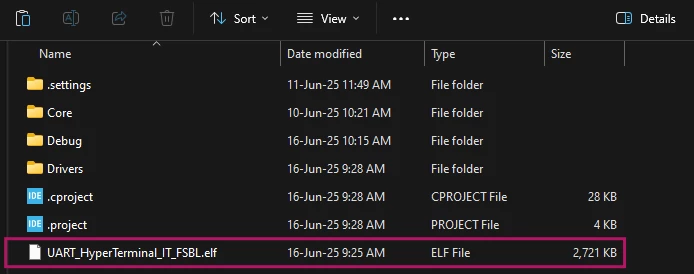

2.3 Debug file location
Place the *.elf file you wish to debug inside the directory of the project generated in the blank project.

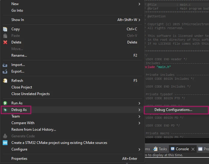

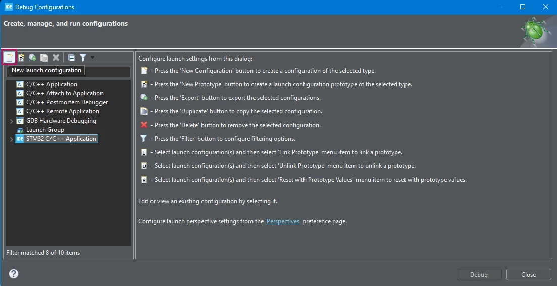

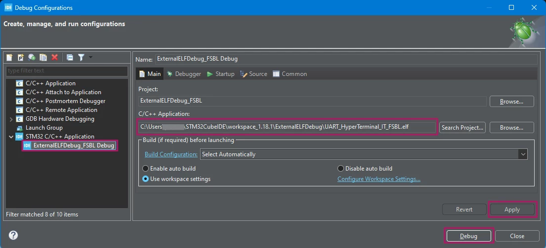

Back to the blank project, right-click on the Project name and then [Debug As] >> [Debug Configurations…].
OBS.: If your current project does not show up under the “STM32 C/C++ Application”, you can just select the “New launch configuration” button and then choose your current project:
Change "C/C++ Application" to your external *.elf with the absolute path (the path from the project generated in Step 2), click [Apply] and then [Debug]:
2.5 Enter in debug
Ensure that your board is properly connected to your PC, then click [Resume] icon or press the [F8] Key.
Note that a message claiming main.c was not found might appear, but it should not affect your debugging session. The *.elf file does contain the location of the original project’s file. This message only appears if the original project that generated the *.elf file is no longer at the same path.

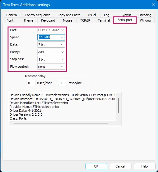

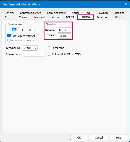

2.6 Validation
To verify the debugging, use terminal emulator software, such as Tera Term or the embedded software available in STM32CubeIDE, with the following configuration:
After setting it up, the code executes as it was intended to:
