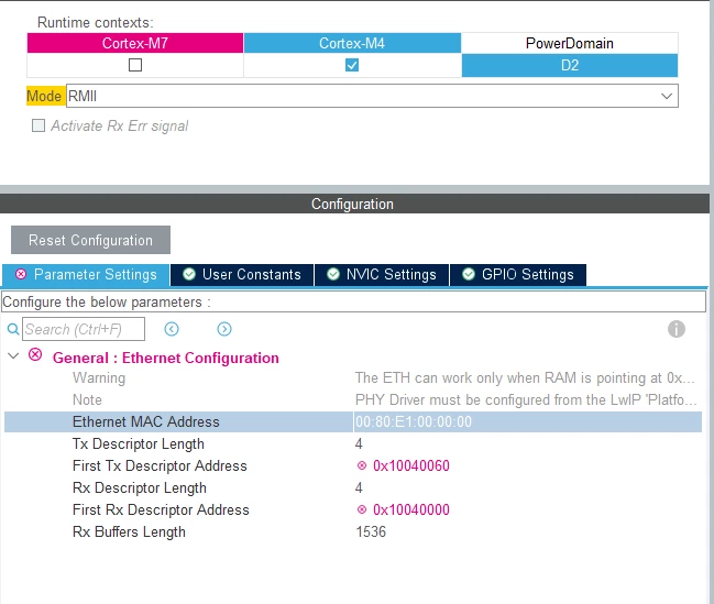

6.4 Ethernet configuration
  • Enable Ethernet peripheral in pinout view in MII mode (MII used on the board).
  • Enable Ethernet interrupt and set preemption priority to 5. This is required by FreeRTOS™ to call its functions from the interrupt handler.
  • Relocate Ethernet CRS and COL signals from PH2/PH3 to PA0/PA3.
    • These signals are optional in full-duplex mode and not connected in the default configuration.
    • This also allows using PH2/PH3 for QSPI.
  • Other pins should be correctly placed, since we create the project from the board selector.

  • Set the GPIO pin speed to “Very High”.
94.png ​
The ETH_MDC speed could not be changed, but it does not affect the application and is fixed in new versions.

After migrating my project to 1.10.1, I have made the necessary changes as this article describes.
But here is the picture of the cubemx perspective. I cannot figure out what to do to fix it.
Have a nice day.
