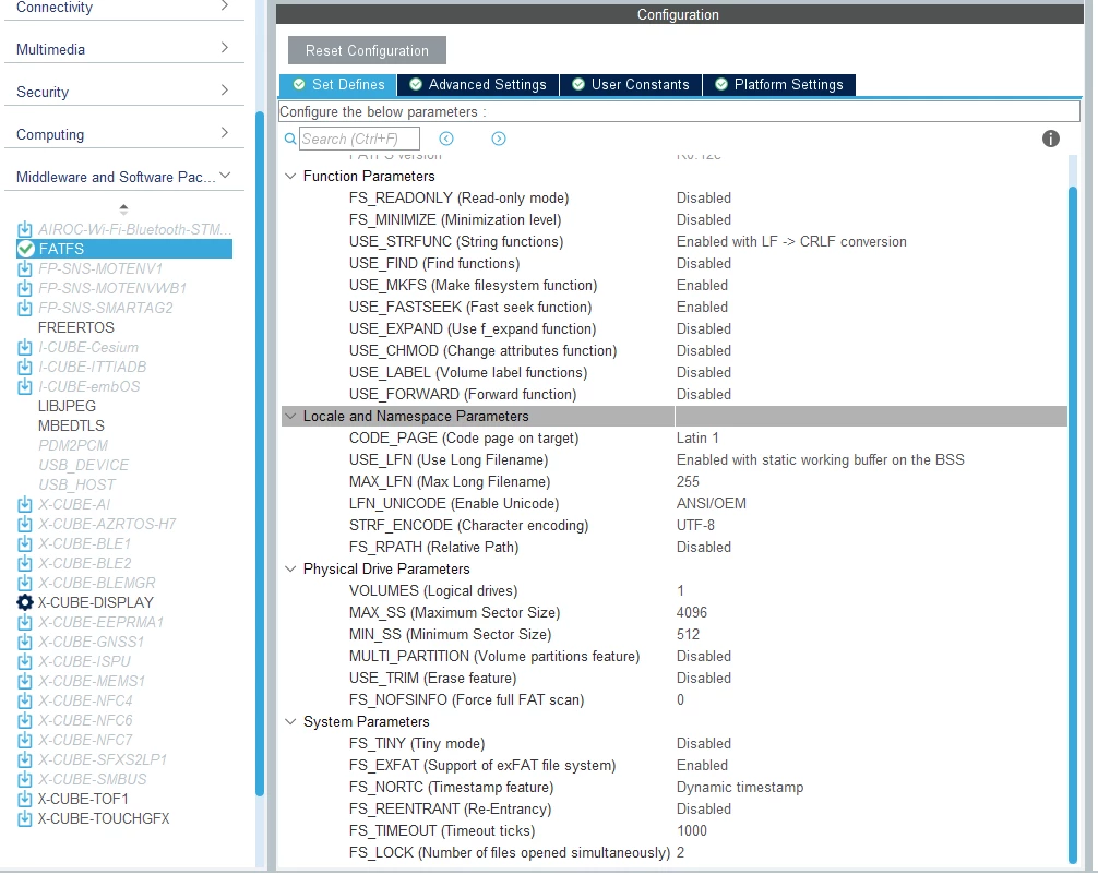

  1. In the "Middleware" category, for the FATFS middleware, enable the "SD card" option. In the "Platform Settings" panel, select "PC13 [uSD_Detect]" as a solution for "Detect_SDIO".1788.png
  2. As we are using DMA to access the SDMMC peripheral, in the "Advanced Settings" panel, enable the "Use dma template" option.pepfof_3-1755096797869.png

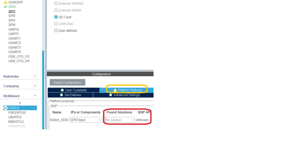

Jun 23, 2025 6:19 AM UTC
I am using Nucleo-F446ZE board.
The Platform Settings at FATFS stage, the ioc editor cannot find solutions for Detect_SDIO option.
ioc_warning.pngCan anyone give some advice on how to resolve it?
