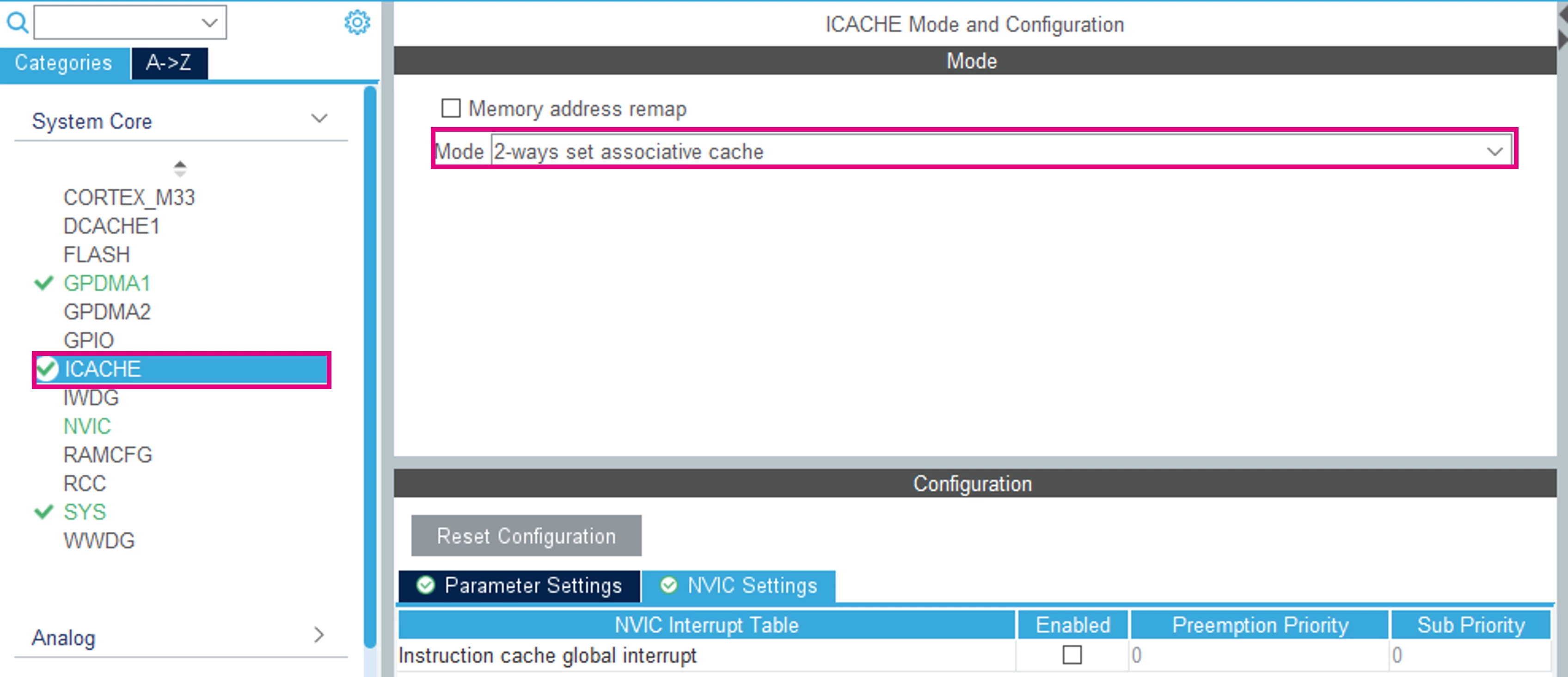

Start a new project and enable the instruction cache [ICACHE] to reach the maximum performance.
ICache configurationICache configuration

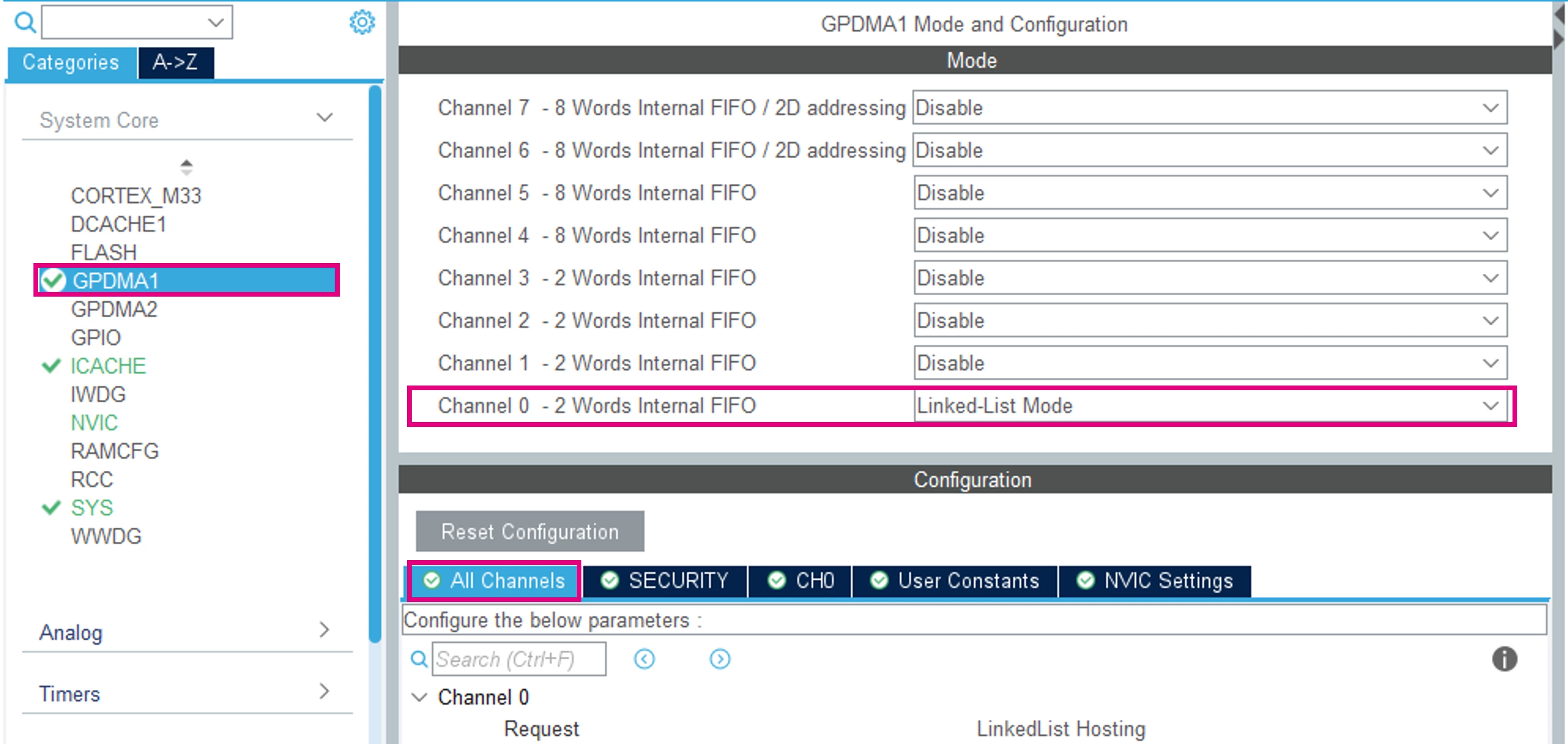

  • Select [GPDMA1] in the System Core category
  • Set the mode to [Linked-list mode] for channel 0. If channel 0 is not available, choose another channel and name the channel 0 request.
GPDMA configuration_1GPDMA configuration_1

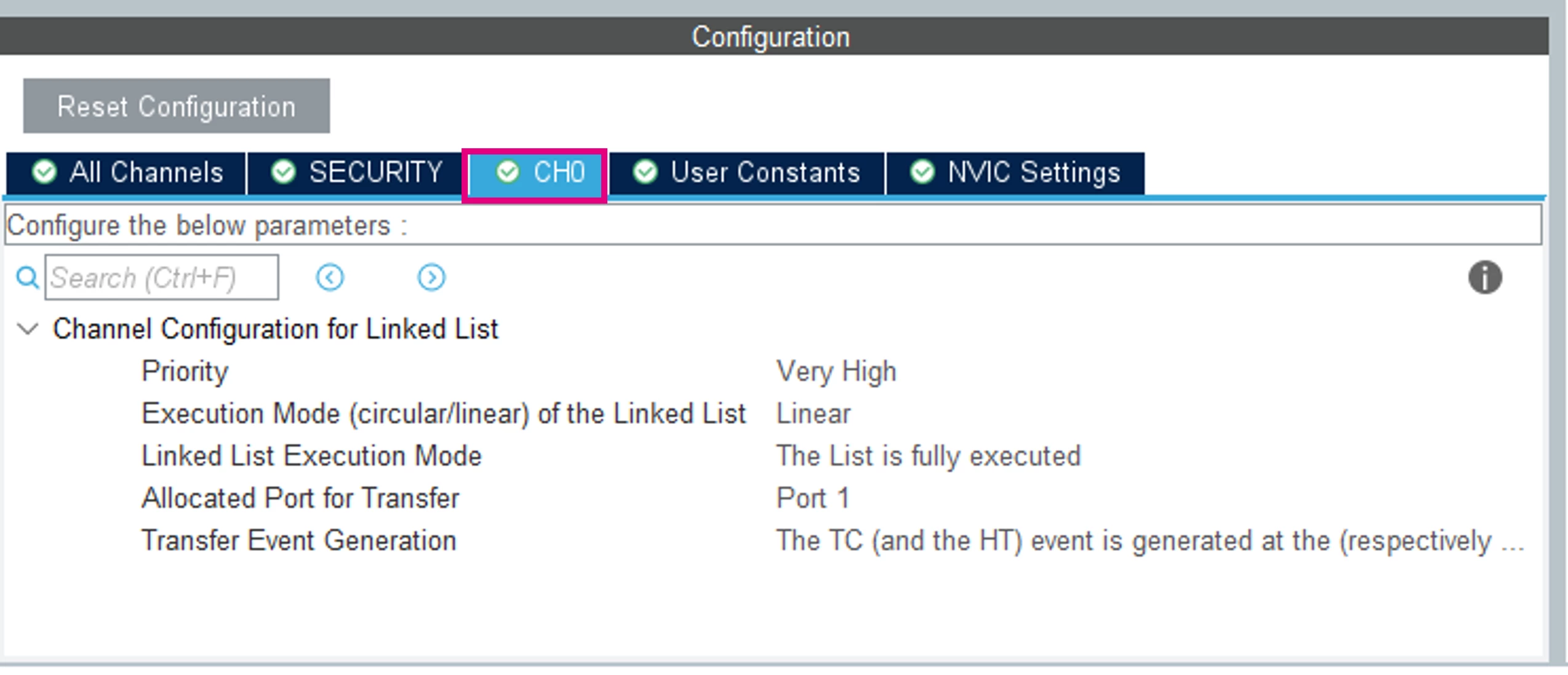

  • Set the execution mode to [Linear] and change the priority to [Very High].
GPDMA configuration_2GPDMA configuration_2

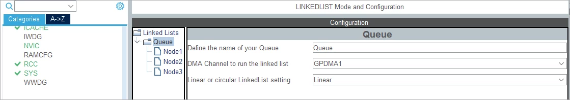

  • Under Categories → Utilities, add a list by clicking on the [Add List] button and configure the queue.
  • Rename the queue as shown in the screenshot below.
Linked_list_Queue_ConfigLinked_list_Queue_Config

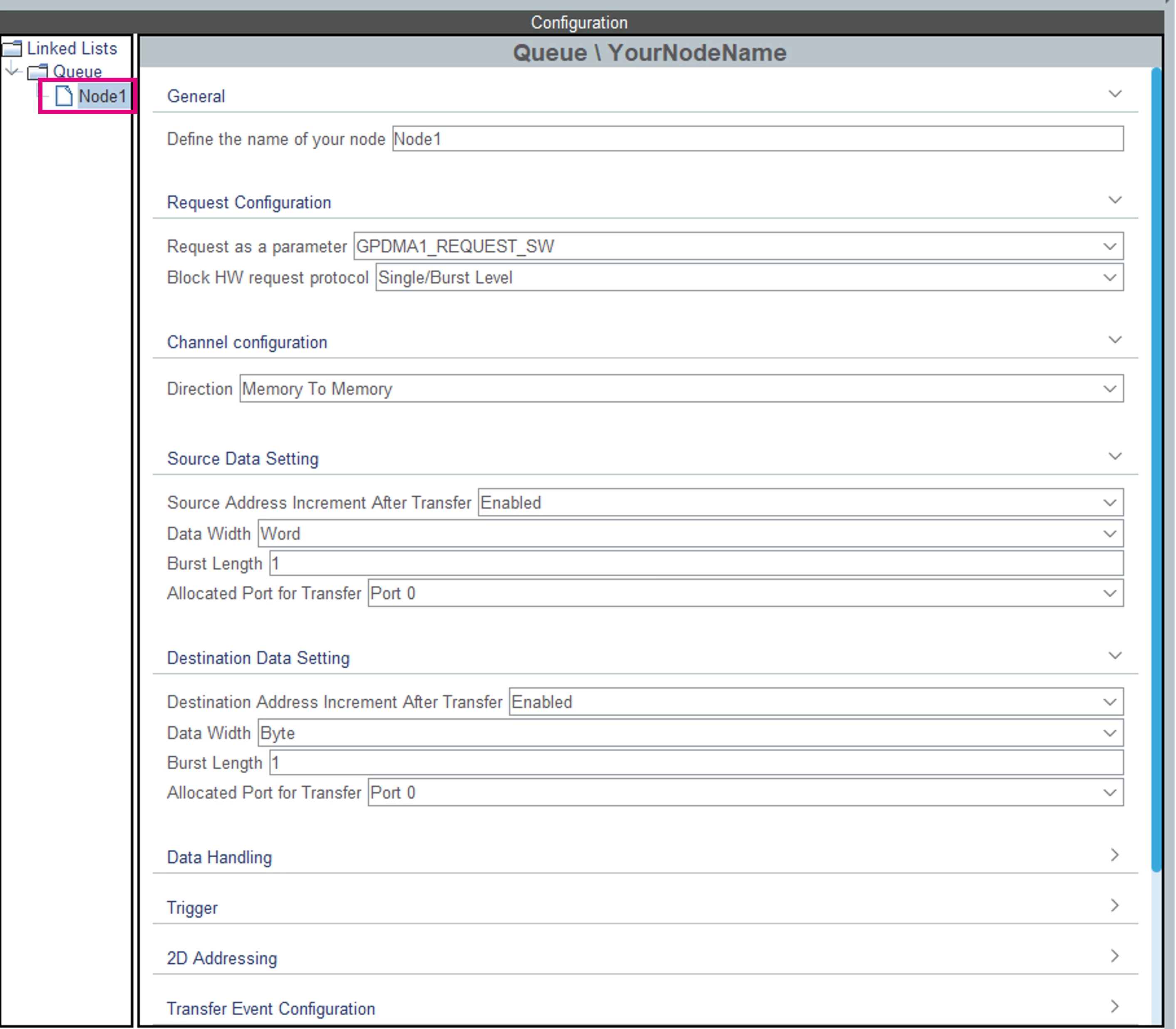

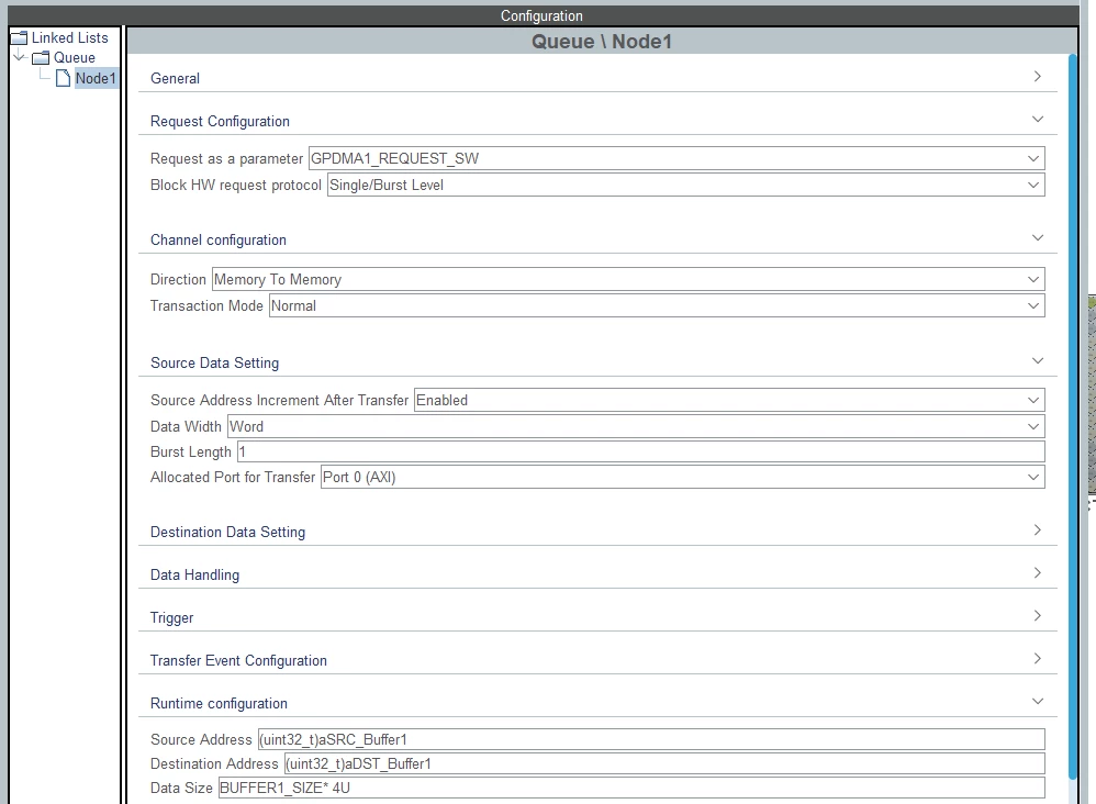

  • Add and rename three nodes as "Node1," "Node2," and "Node3."
  • Enable source and destination transfer increment after transfer and change the data width to Word.
  • Keep data handling, trigger, 2D addressing, and transfer event configuration disabled.
Node1 configuration_1Node1 configuration_1

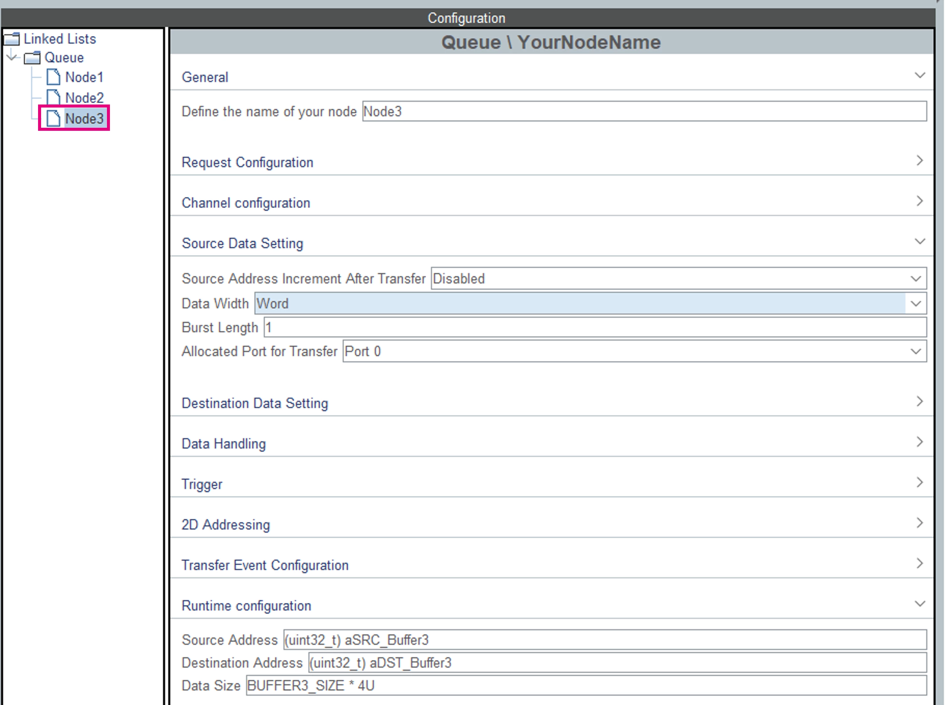

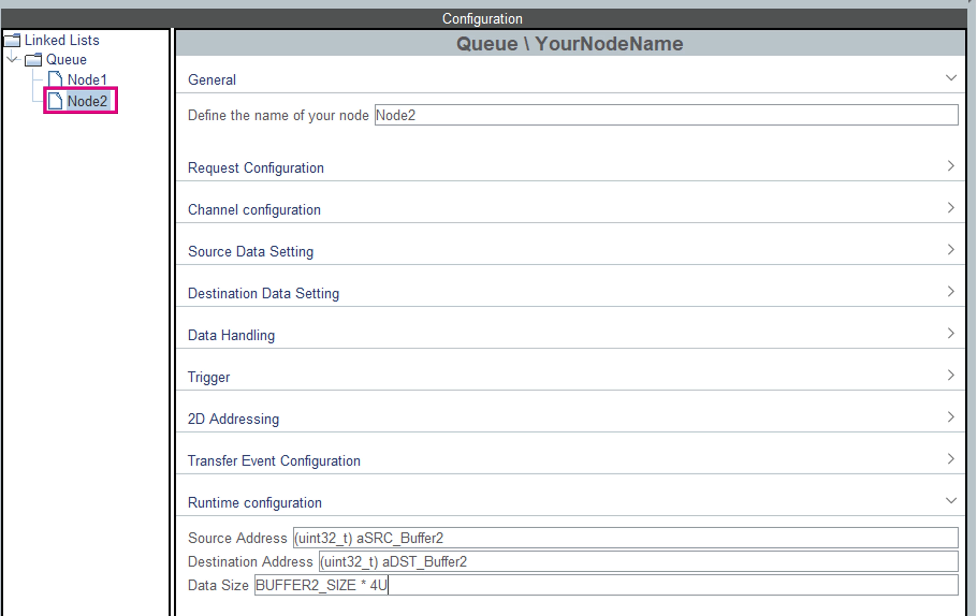

  • For each node, name the source and destination address buffers and specify the data size as follows
Node1 configuration_2Node1 configuration_2
  • Do the same for the Node2 and Node3 configuration:
Node2 ConfigurationNode2 Configuration
Node3 ConfigurationNode3 Configuration
  •  Note: Make sure to keep the same data width between source and destination in all nodes.

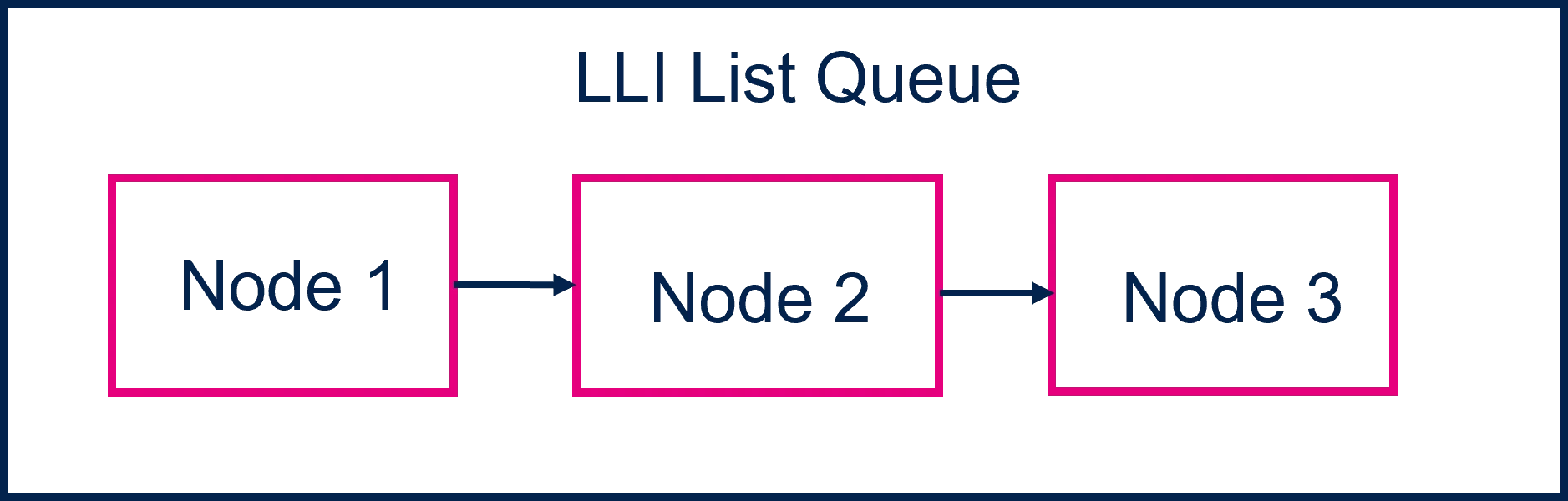

The first node in the loop is where the LLR from the last node in the queue is pointed. If there is only one node, it reloads the same configuration upon completion.
LLI List QueueLLI List Queue

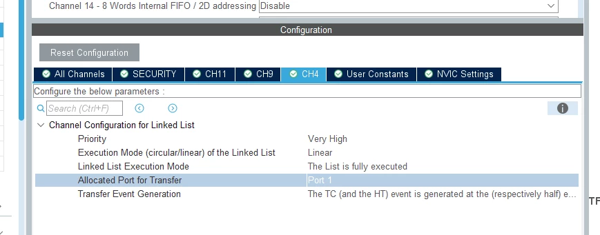

Oct 17, 2025 10:16 AM UTC
Hello, I followed your tutorial, but I’m running into a problem. I’m currently working on a Nucleo-H7SL8 with CubeIDE 1.19.0. However, my code gets stuck here:
while ((TransferCompleteDetected == 0) && (TransferErrorDetected == 0U));
My handle_GPDMA1_Channel is filling correctly, and the CDAR and CSAR registers have the correct addresses for aSRC_Buffer1 and aDST_Buffer1. I think it’s never being triggered. I’ve tried using a software request and a timer trigger.
Configuration GPDMA :
Node configuration :
And the code :
MX_Queue_Config();
HAL_DMAEx_List_LinkQ(&handle_GPDMA1_Channel4, &Queue);
HAL_DMA_RegisterCallback(&handle_GPDMA1_Channel4, HAL_DMA_XFER_ERROR_CB_ID, TransferError);
if (HAL_DMAEx_List_Start_IT(&handle_GPDMA1_Channel4) != HAL_OK)
Error_Handler();
if (TransferErrorDetected == 1U)
Error_Handler();
I’m not sure where the problem comes from. Do you have any idea?
