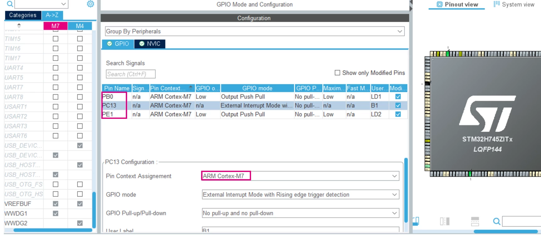

Step 1: Create a new project in STM32CubeMX and select NUCLEO-H745ZI-Q.
  • Initialize all peripherals with their default mode? Yes. Then, clear pinout
  • Configure 2 LEDs (PB0 led 1 for Bank1, PE1 Led2 for bank2) and 1 user push button B1 (PC13).
  • All used pins should be assigned to Cortex® M7. CM4 boot should be disabled.
  • Keep clock configuration default state.
  • In the project manager, rename your project (Swap for example) and generate code with EWARM tool chain
Step 2: Update code
