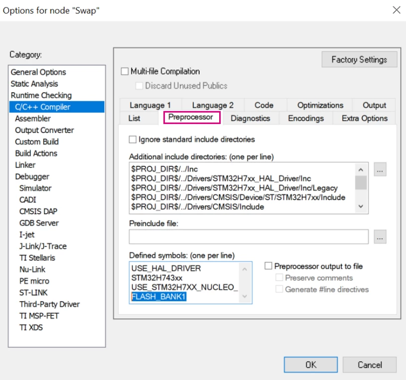

1. Add FLASH_BANK1 as preprocessor: Project Options> C/C++ Compiler > Preprocessor1666.png

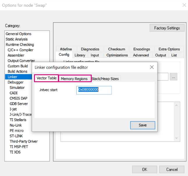

2. Check that vector table settings are as following (Project Options > Linker > Linker Configuration File Editor):
  • _intvec start: 0x08000000
  • ROM Start: 0x08000000 under Memory Regions
  • ROM End: 0x080FFFFF under Memory Regions

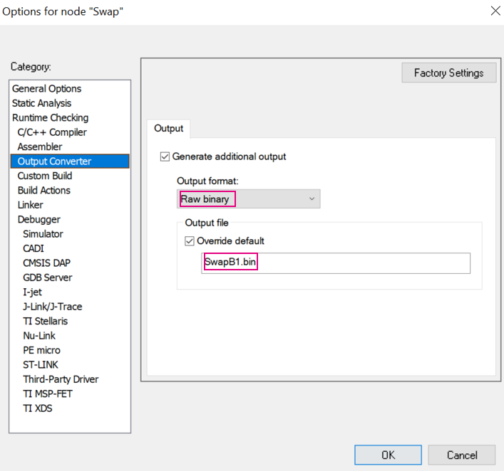

3. In output converter, select Raw binary and name the output file for bank1 as shown in the figure below
4.  Build the first part of the program dedicated to BANK1.

1. Remove the previously added defined symbol preprocessor: FLASH_BANK1

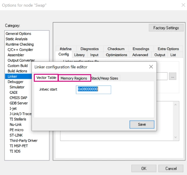

2. Make sure that Linker Configuration is the same.

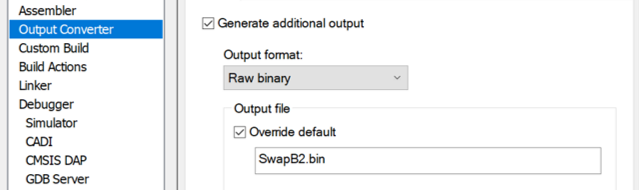

3. Go back to Output Converter and change the name of the binary file as follows.

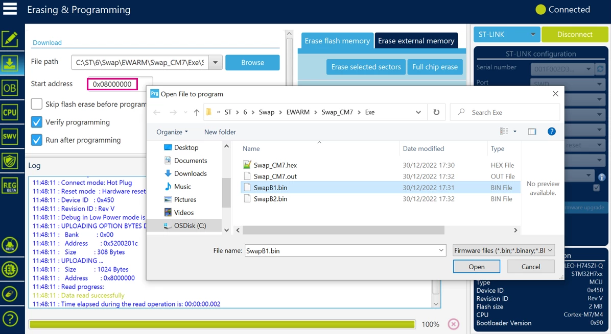

Step 5: Execute the binaries & check behavior

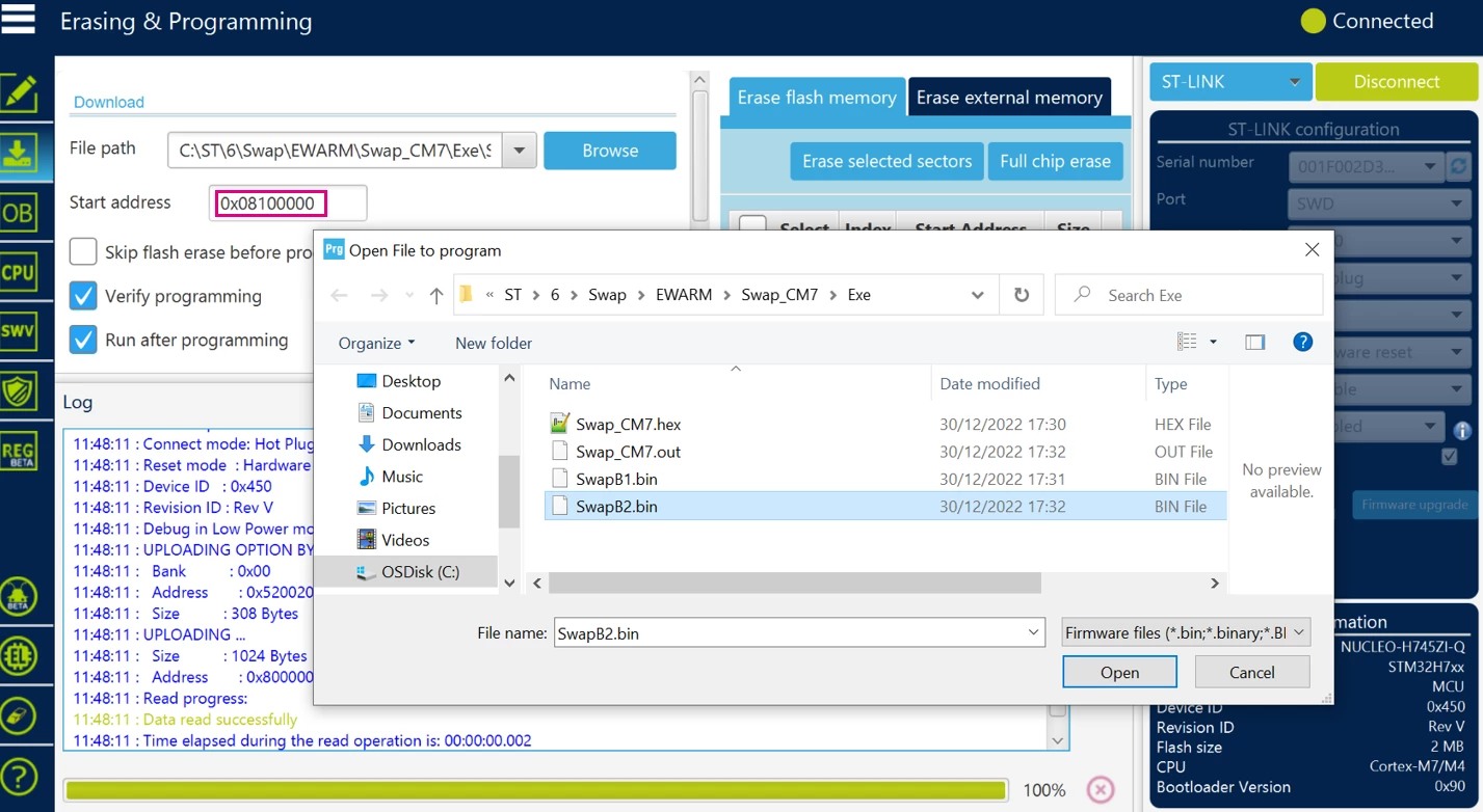

Use CubeProgrammer to connect and download the binary files.
  1. From Download>file path, select the path of your binary SWAP_Bank1.bin ( it should be under your workspace: xx\Swap\EWARM\Swap_CM7\Exe)
  2. Make sure that the start address is 0x0800 0000
  3. Click on download.
    4. The same way as previously described; you can download the second binary file at the start address of Bank2 (0x0810 0000).
At this level, you can disconnect from STM32CubeProgrammer. You can check that:
  • LED1 (Green led) is blinking ==> code execution from Bank1
  • Once you press on user push button or tamper then on reset, LED2 (yellow led) will be blinking ==> code execution from Bank2
For further tests, you can write in the flash for example starting from 0x08003232 in bank1. You can see the content is swapped to 0x08103232.
Program counter should be always started executing from 0x0800 0000.
