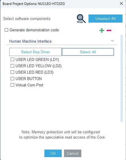

  • Use the [Board selector] tab and select the [NUCLEO-H723ZG].
  • In the board project options that pops up, unselect all, and press [OK]

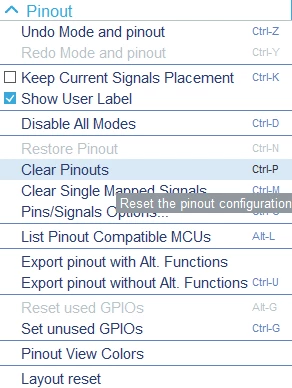

  • When the .ioc file opens, press [Pinout→ Clear pinouts].

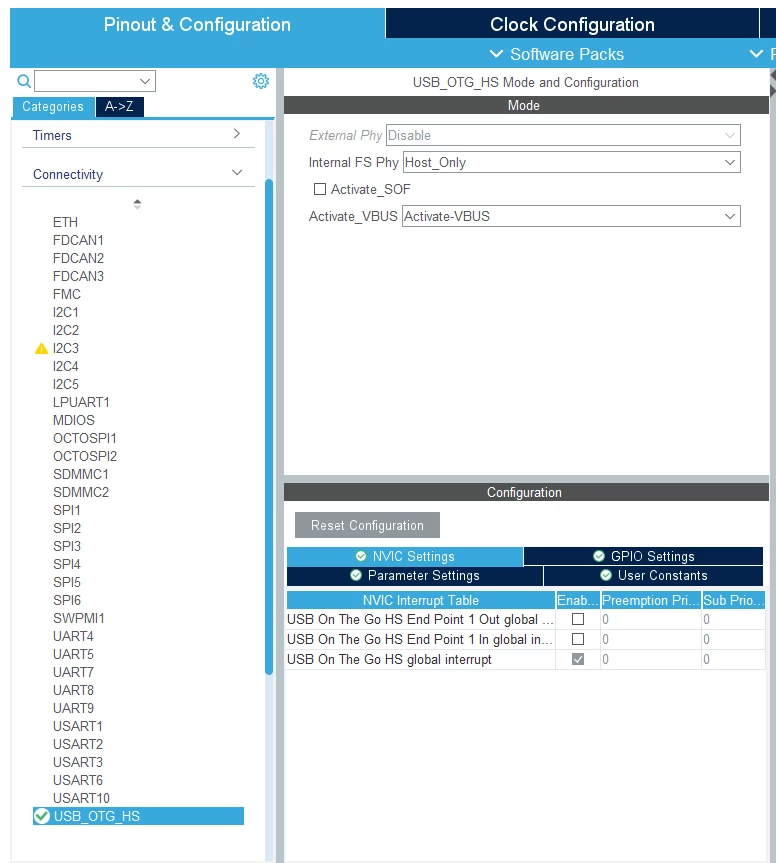

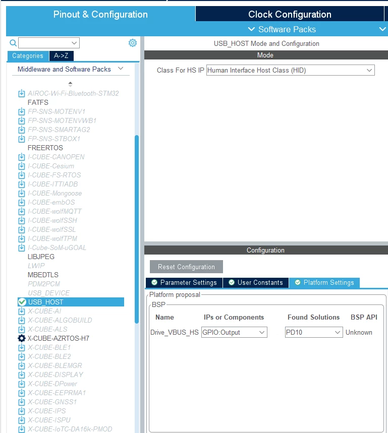

In the connectivity category, click on USB_OTG_HS and choose:
  • Host only under internal FS PHY.
  • Activate VBUS under “Activate VBUS".
  • Select "USB on the Go HS global interrupt" checkbox in NVIC settings.
  • In “Middleware and Software Packs”, choose USB_Host then select HID as a class.

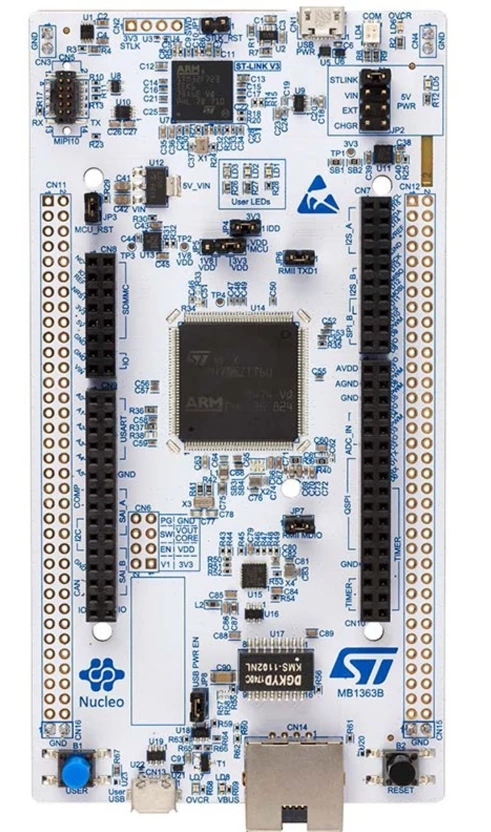

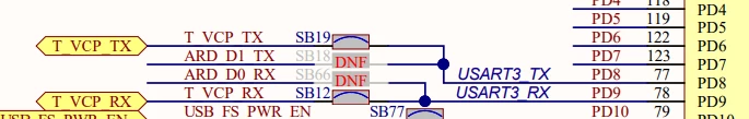

  • In the “Platform Settings”, select “GPIO:Output” as Drive_VBUS_HS and choose your specific board VBUS supply pin after configuring it as GPIO output in the pinout view.
To know your USB_FS_PWR_EN pin, check your board schematic. In our case, for example, we need to refer to the MB1364 schematic:

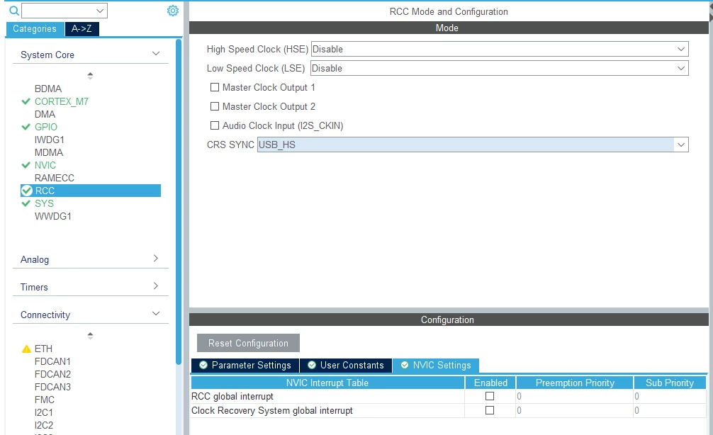

  • In the system Core category and for RCC, select USB_HS for CRS SYNC.

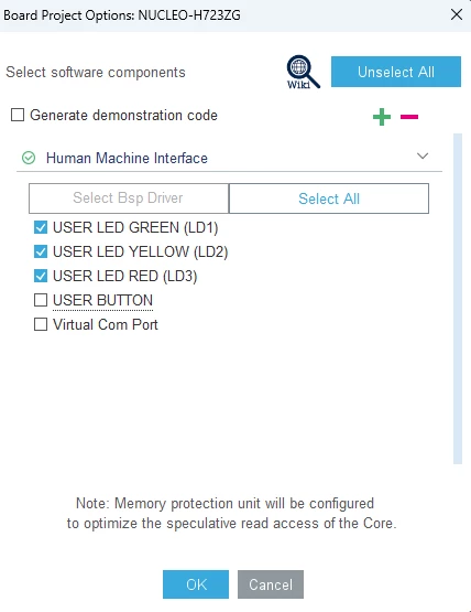

  • Use the [Board Selector] tab and select the [NUCLEO-H723ZG].
  • In the board project options that pops up, select only the USER LEDs, and press [OK]

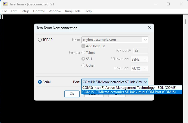

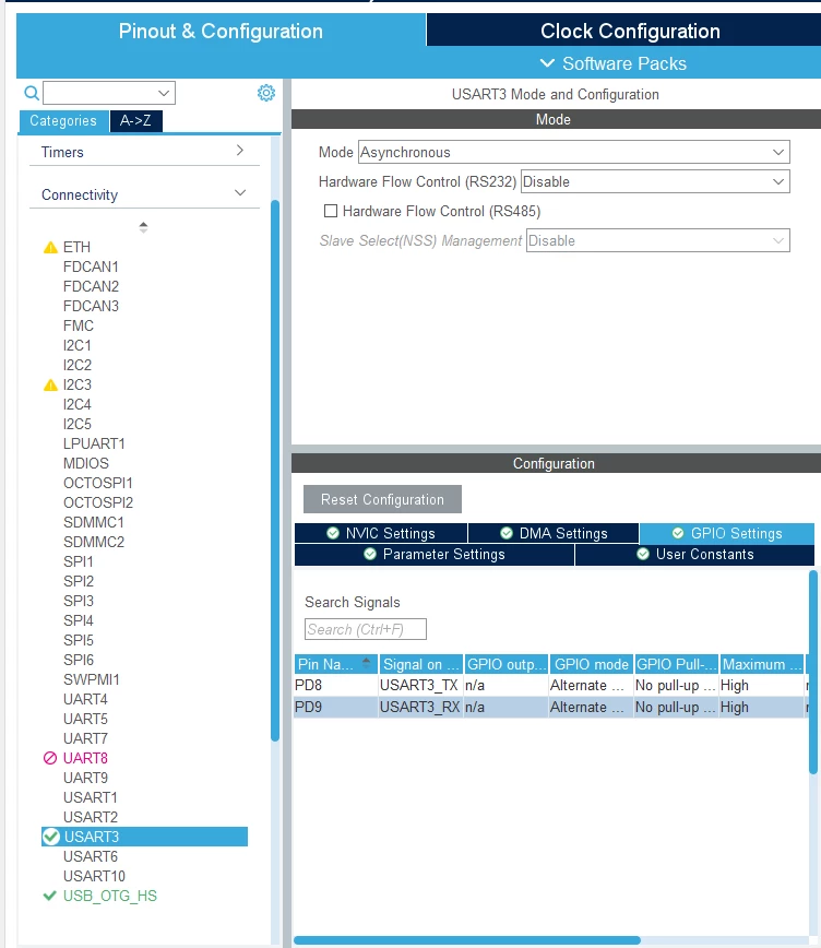

  • In the “Connectivity” category, click your board specific USART linked to your ST-LINK via the Virtual Com Port. Check the board schematic to identify the USART to activate. In our case, it is USART3.
  • Choose asynchronous mode.
  • Make sure that STM32CubeMX has configures the exact pins that are used on your board schematic.

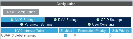

  • Ensure that you select a High speed for the GPIOs and enable your USART global interrupt in NVIC settings.

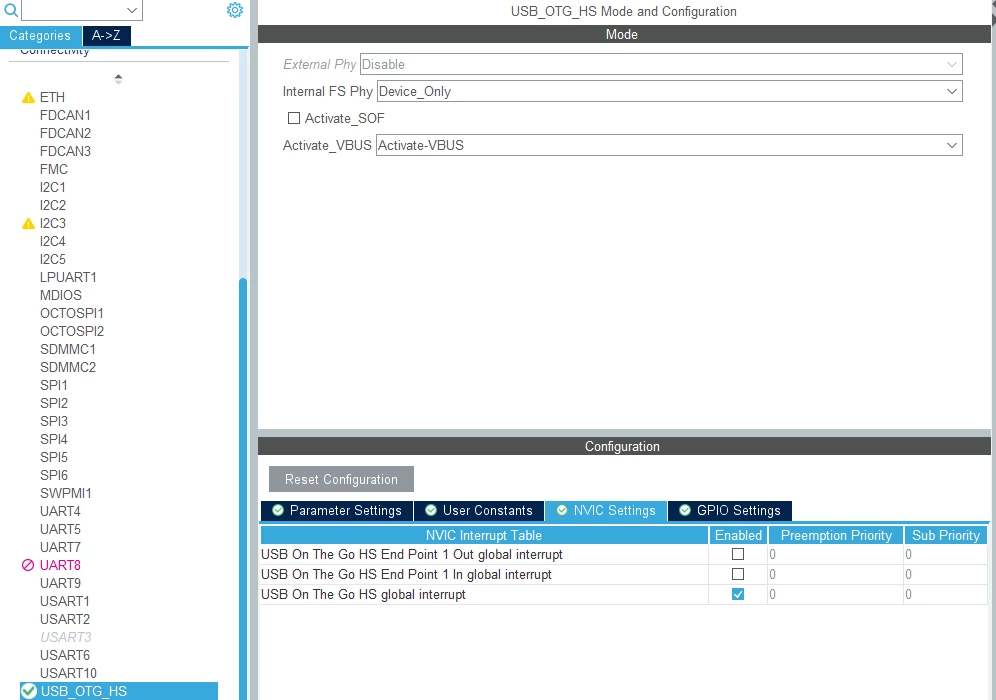

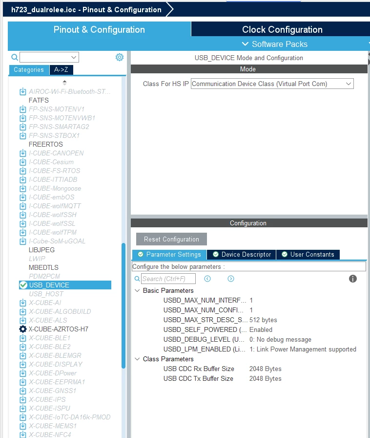

  • In USB_OTG_HS select “Device only” and activate VBUS as well as USB OTG global interrupt in NVIC settings.
  • In “Middleware and Software Packs”, click on "USB_Device" and choose “Communication Device Class”.

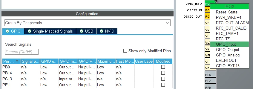

  • Configure the board-specific pin connected to the blue button as a GPIO input (PC13 in our case):

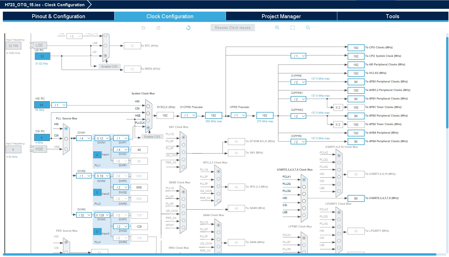

  • In clock configuration, ensure that you are using the HSI clock source from the PLL source.

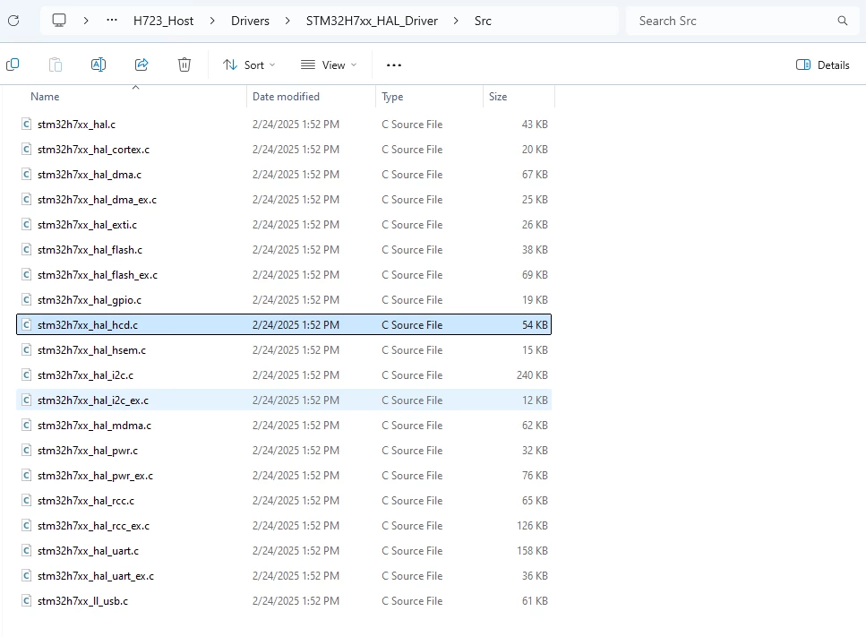

The first step is complete. Now, copy the necessary files from the first project to the second project to include all mandatory files for both modes in the same project.
  • Locate the folders where the host project and dual role project are saved in your computer.

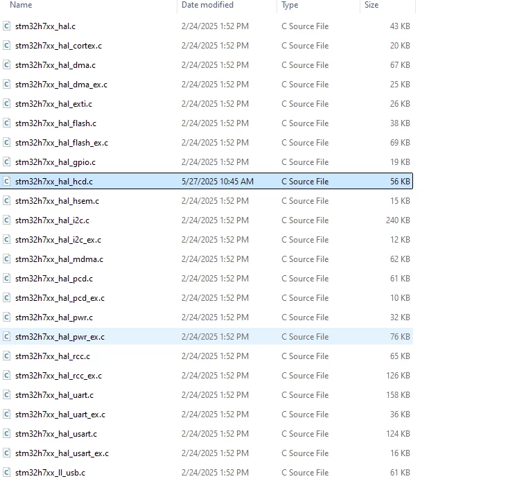

  • In the host project, go to "Drivers/STM32H7xx_HAL_Drivers/Src”.
  •  Copy the stm32h7xx_hal_hcd.c file to the corresponding location under “Drivers/STM32H7xx_HAL_Drivers/Src” in the dual role project:

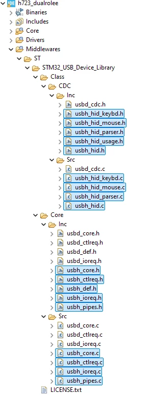

  • The table below lists all the required middleware files to add :
Source path Destination path Files
h723_Host\Drivers\STM32H7xx_HAL_Driver
\Inc
h723_dualrole\Drivers
\STM32H7xx_HAL_Driver\Inc
stm32h7xx_hal_hcd.h
h723_Host\Middlewares\ST
\STM32_USB_Host_Library\Class\HID\Inc
h723_dualrole\Middlewares\ST
\STM32_USB_Device_Library\Class
\CDC\Inc
usbh_hid_keybd.h, usbh_hid_mouse.h, usbh_hid_parser.h, usbh_hid_usage.h
\STM32_USB_Host_Library\Class\HID\Src
\CDC\Src
usbh_hid.c, usbh_hid_keybd.c, usbh_hid_mouse.c, usbh_hid_parser.c
\STM32_USB_Host_Library\Core\Inc
\STM32_USB_Device_Library\Core\Inc
usbh_core.h, usbh_ctlreq.h, usbh_def.h, usbh_pipes.h
\STM32_USB_Host_Library\Core\Src
h723_dualrole\Middlewares\ST\
STM32_USB_Device_Library\Core\Src
usbh_core.c, usbh_ctlreq.c, usbh_ioreq.c, usbh_pipes.c
  • Then click refresh.
Your project structure should be as shown below:

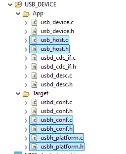

  • The table below lists the source files to add :
h723_Host\USB_HOST\App h723_dualrole\USB_DEVICE\App usb_host.c, usb_host.h
h723_Host\USB_HOST\Target h723_dualrole\USB_DEVICE\Target
usbh_conf.c
usbh_conf.h
usbh_platform.c, usbh_platform.h
The structure should be organized as illustrated below:

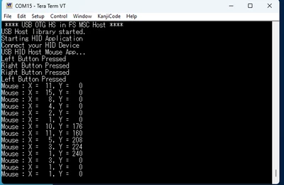

  • Open usb_host.c under USB_HOST/App and replace the existing code with the code provided below:
This code implements mouse and keyboard host functionalities.

  • In usbh_conf.c, add this line:
#include "stm32h7xx_hal_hcd.h"
  • In "stm32h7xx_hal_conf.h" look for HAL_HCD_MODULE_ENABLED and uncomment it:
 #define HAL_HCD_MODULE_ENABLED

  • Baud rate: 115200
  • Data: 8 bits
  • Parity: None
  • Stop bits: 1
  • Flow control: None

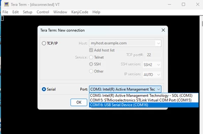

  • Attach a mouse to the board through the Type A micro-B adapter and open your serial monitor toolchain.
  • Choose the ST-LINK port.
You should see mouse traffic in the serial monitor.
  • Remove the mouse and attach the board to the pc from the USB connector through a “Type A to micro-B” cable. Press the blue button. Integrated LEDs turns on to validate the switch.
The device mode is programmed as CDC class that prints hello world repeatedly on the serial monitor.
  • Baud rate: 9600
  • Data: 8 bits
  • Parity: None
  • Stop bits: 1
