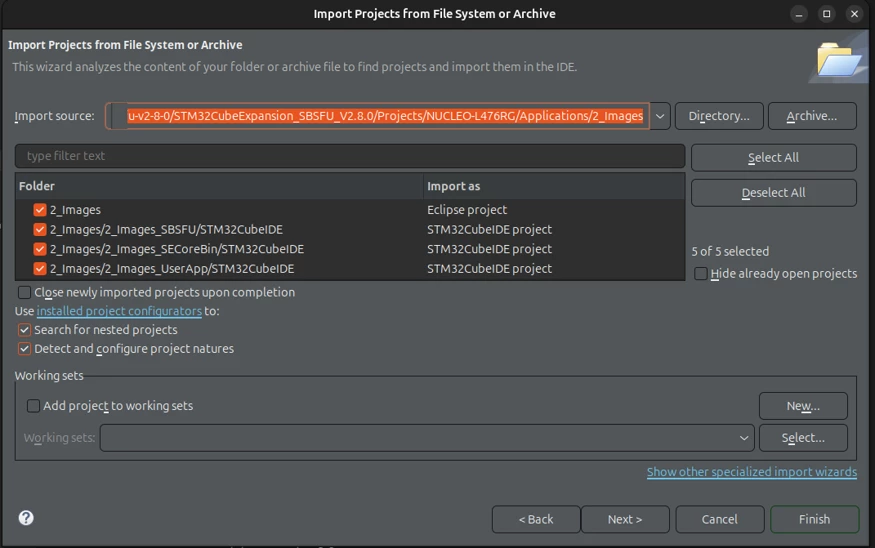

Start by importing the project to STM32CubeIDE:
File → STM32 Project Create/Import →  STM32CubeMX/STM32CubeIDE Project →  Next, then copy the project path.
x-cube-sbsfu-v2-8-0/STM32CubeExpansion_SBSFU_V2.8.0/Projects/NUCLEO-L476RG/Applications/2_Images
Click finish, the imported project is shown:

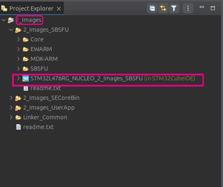

To build the project, follow this specific process:
  1. Build the 2_images_SECoreBin project.
  2. Build the 2_images_SBSFU project.
  3. Flash the SBSFU.elf file using STM32CubeIDE.
  4. Build the user application. This generates a UserApp.sfb file under 2_images_UserApp/Binary.
  5. Using Minicom, upload the user application to the device.
To build or flash the project, click on the STM32CubeIDE project highlighted by the red rectangle in the image before performing the corresponding step

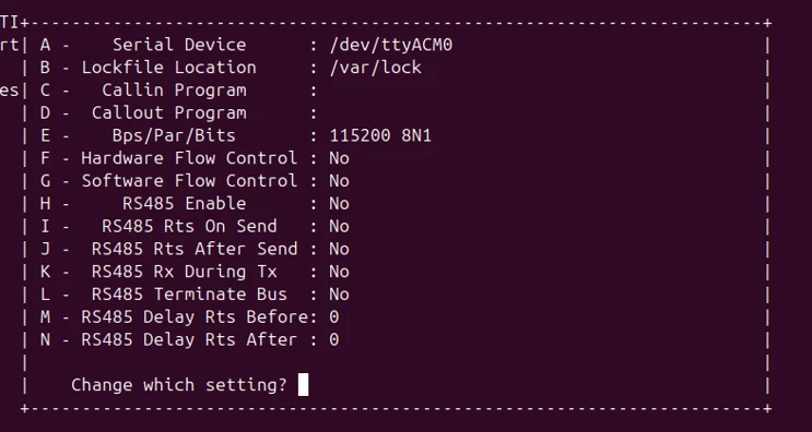

  • Configure the serial port Ctrl + A followed by O.
    • Serial device: /dev/ttyUSBx or /dev/ttyACMx
    • Bps/Par/Bits: match the above
    • Hardware flow control: No
    • Software flow control: No
    • Using the keyboard clicks the escape key to exit the configuration menu

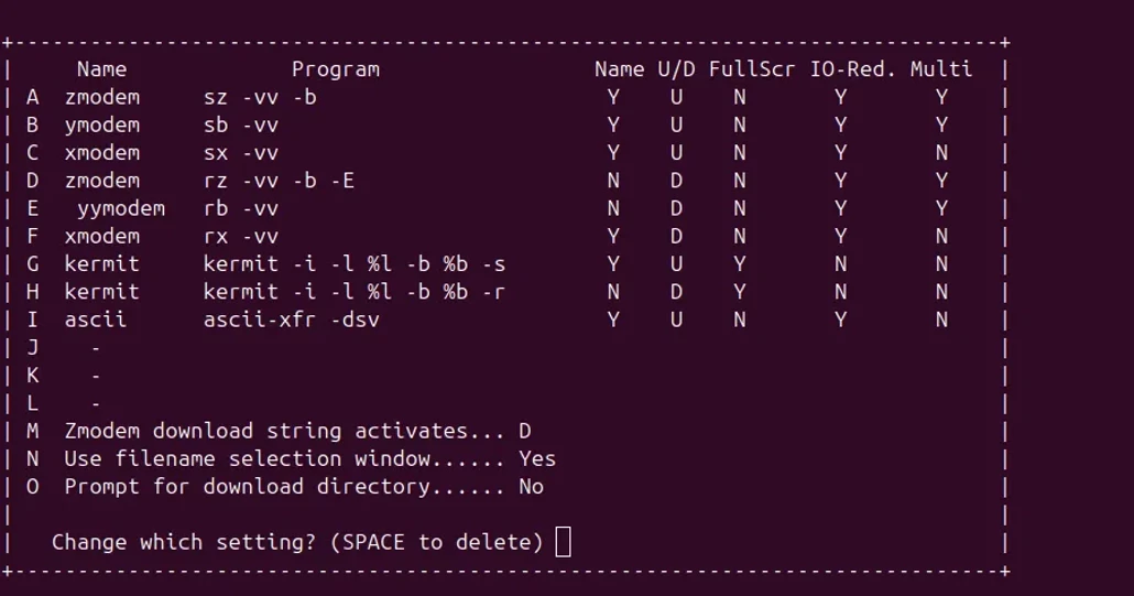

  • Configure file transfer protocols: Ctrl+A then O, then set: ymodem sb -vv.
 The configuration should be as the figure below.

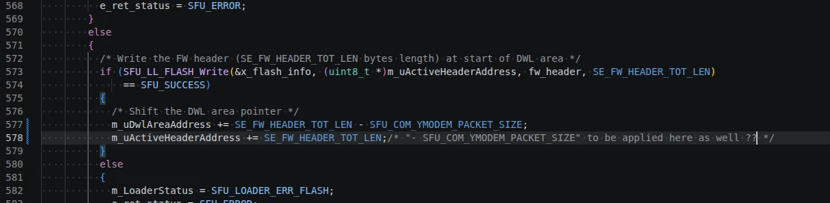

  • To improve compatibility with Minicom's YMODEM implementation, two changes are required in the SBSFU YMODEM reception code.
  1. Adjust the download address in SFU_COM_YMODEM_DataPktRxCpltCallback() (2_images/2_images/SBSFU/sfu_loader.c)
m_uDwlAreaAddress += SE_FW_HEADER_TOT_LEN - 128;
Note: There are two implementations of the SFU_COM_YMODEM_DataPktRxCpltCallback() function: one for Minicom and one for Tera Term. The two implementations are separated using #if / #else preprocessor directives. Make sure to use the implementation corresponding to minicom when applying the modifications described in this section. The Tera Term related section uses #ifndef MINICOM_YMODEM.

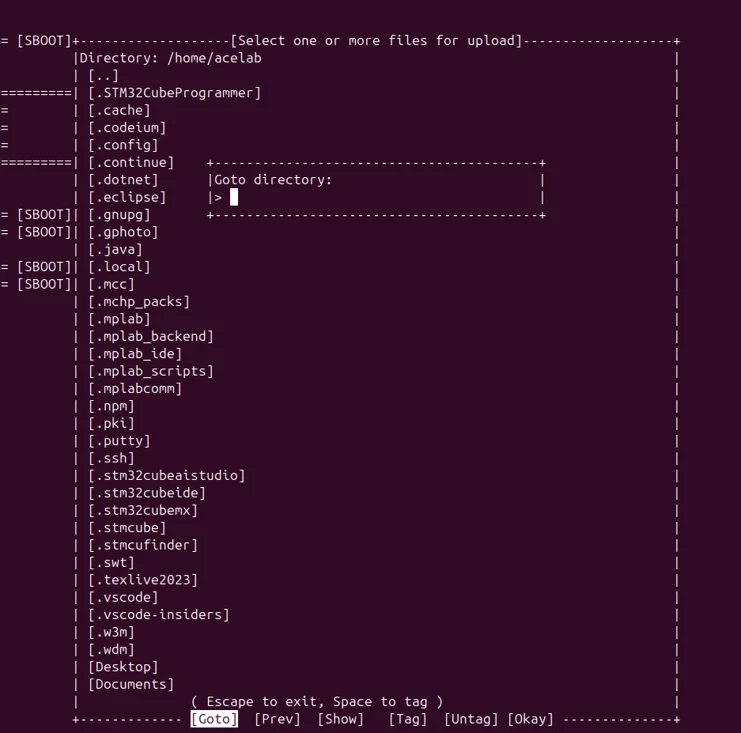

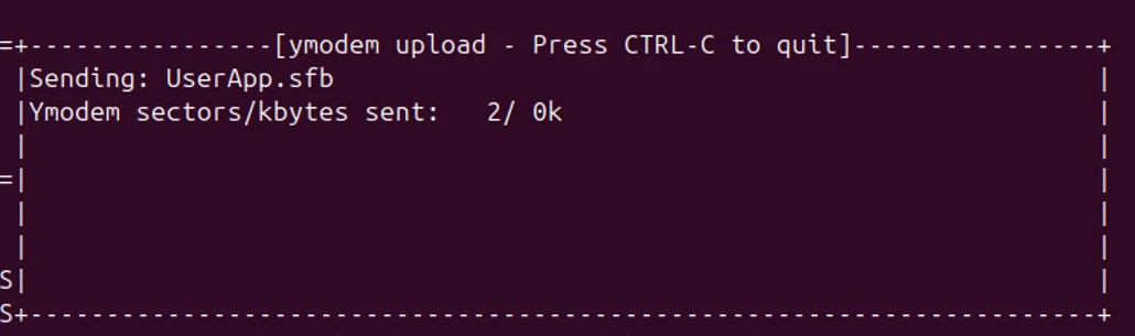

1.4 Update software using Minicom
  • To upload a file using Minicom, press Ctrl A + S.
  •  A small list appears, select ymodem.

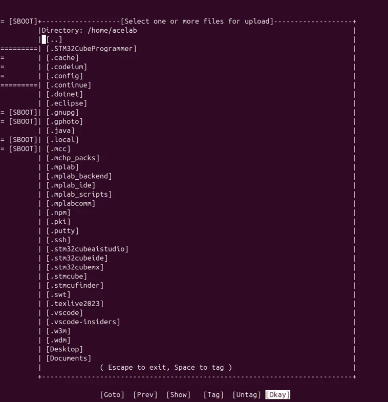

•    Provide the path for the sfb file using two methods:
Method one. Navigating to the location of the sfb file using the arrow key.
Method two. Providing the path to the location of the sfb file.
The image below demonstrates method one, navigating to the file:

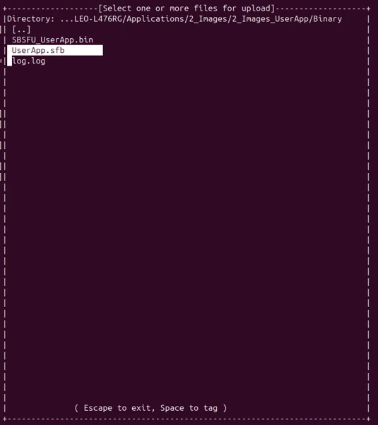

The image below demonstrates the second method.
•    Select [Goto] by navigating using the arrow ->, then specify the directory location of the sfb file.
HOME_DIR_PATH/x-cube-sbsfu-v2-8-0/STM32CubeExpansion_SBSFU_V2.8.0/Projects/NUCLEO-L476RG/Applications/2_Images/2_Images_UserApp/Binary
Remember to change the HOME_DIR_PATH.
  • Using keyboard arrows, navigate to the file to upload. Press [space] to select the file, and hit enter.

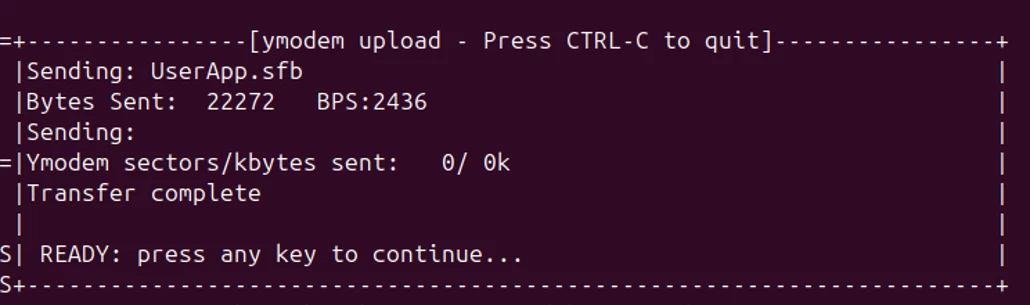

  • The transfer starts.
  • After the transfer is completed, a transfer complete message is shown. Hit any key and the SBSFU boots to the new application if the verification process is ok.

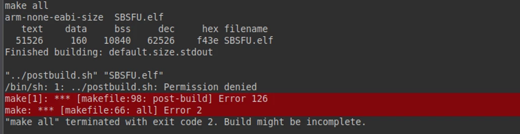

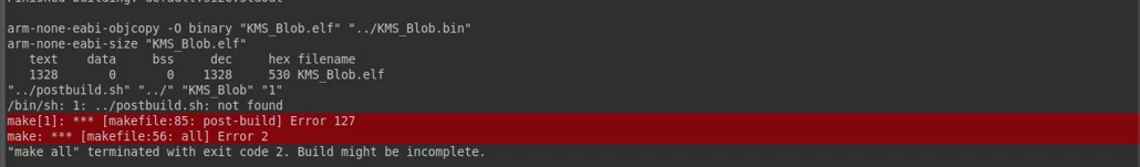

2.1 Script permission issue
  • Permission denied error.  This is because the bash scripts (.sh) do not have the right permissions.
  • To fix this issue, we add the execute permission.
cd x-cube-sbsfu-v2-8-0/STM32CubeExpansion_SBSFU_V2.8.0/Projects/NUCLEO-L476RG/Applications/2_Images/2_Images_SECoreBin/STM32CubeIDE
chmod +x *.sh
cd x-cube-sbsfu-v2-8-0/STM32CubeExpansion_SBSFU_V2.8.0/Projects/NUCLEO-L476RG/Applications/2_Images/2_Images_SBSFU/STM32CubeIDE
chmod +x *.sh
We perform the same operation for all the other scripts .sh files located in the 2_images example.
  • Another issue appears as shown in the image below:
  • The issue is caused by incorrect line endings. The script is configured with Windows line endings (CRLF, \r\n), which can cause Bash syntax errors on Linux. To fix the issue, convert the file endings to Linux format (LF, \n). The command below removes the (\r) characters from the end of each line.
sed -i 's/\r$//' *.sh
chmod +x *.sh

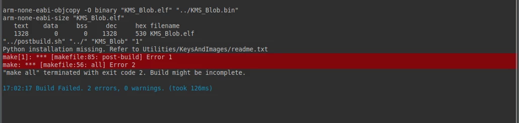

2.2 Python configuration
  • The scripts also incorporate a python command. On Linux the command should be python3 instead of python, the picture below shows the error produced:
  • Implentations are shown below:
  • Update all the.sh files located in the 2_images example (attached at the end of this article).
  • Additionally, SBSFU requires installing python packages on the system.
cd x-cube-sbsfu-v2-8-0/STM32CubeExpansion_SBSFU_V2.8.0/Middlewares/ST/STM32_Secure_Engine/Utilities/KeysAndImages
pip3 install -r requirements.txt --break-system-packages

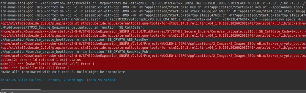

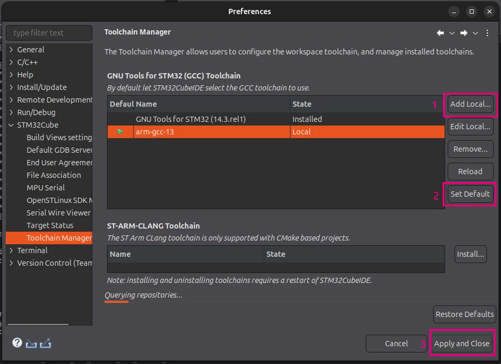

2.3 Compilation process
A separate issue can occur when building the SECoreBin project with Arm GCC 14. In the tested environment, GCC 14.3.1 produced linker errors in the secure engine components, as shown in the image below:
The tested workaround is to build the SBSFU project with an Arm GNU toolchain version earlier than GCC 14. An older STM32CubeCLT v1.118 release can be used. It provides a compatible Arm GCC toolchain (arm-gcc 13).
We updated the STM32CubeIDE toolchain to point to the new arm-gcc toolchain. Go to Window → Preferences →  STM32Cube → Toolchain Manager.

CTare.1
Oct 7, 2026 3:36 PM UTC
The code portion for 1_Image SBSFU is not the same:
Shall the line “m_uActiveHeaderAddress += SE_FW_HEADER_TOT_LEN;” be treated as well with the offset ?
