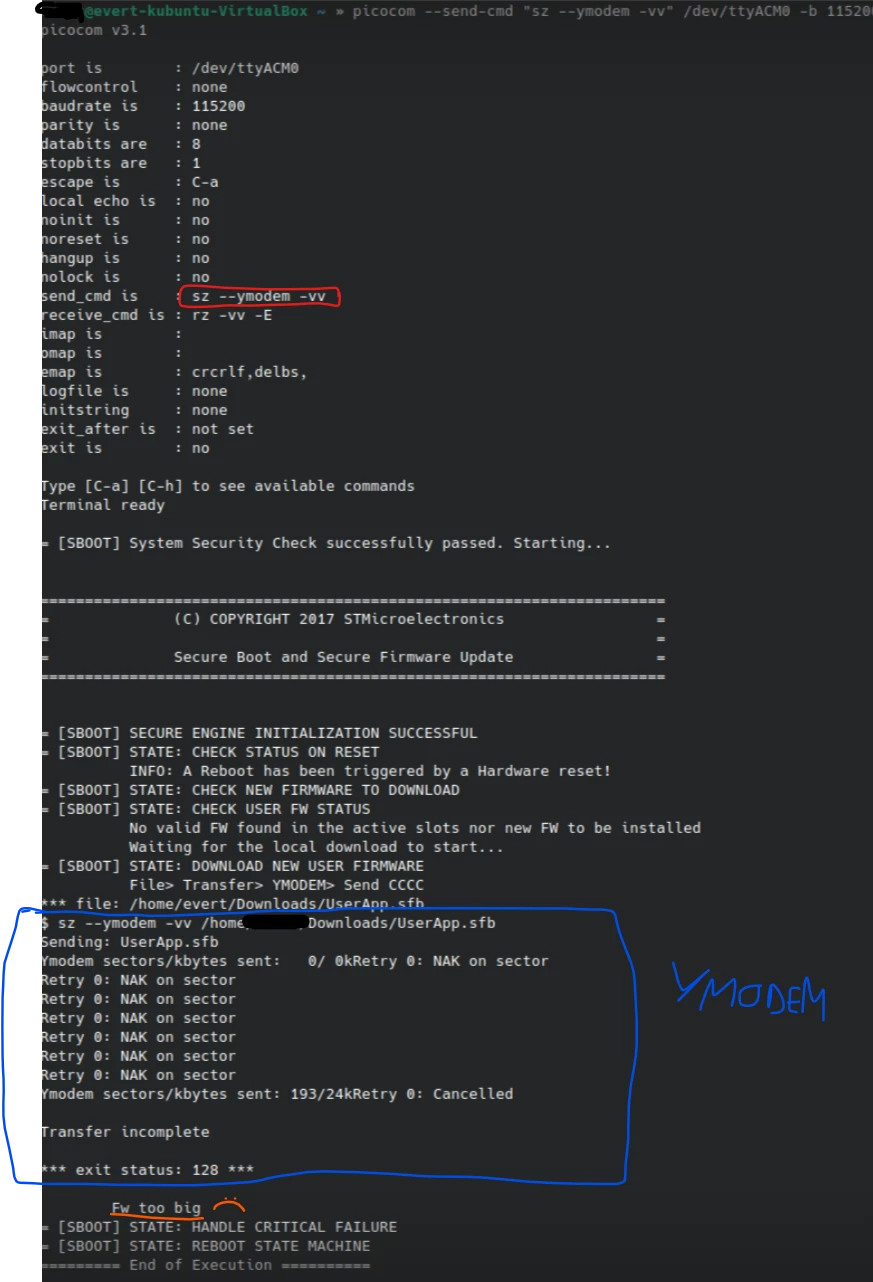

After succesfull compiling (NUCLEO-G474RE) SBSFU and uploading UserApp troguh (TERATERM)
\en.x-cube-sbsfu-v2-7-0\STM32CubeExpansion_SBSFU_V2.7.0\Projects\NUCLEO-G474RE\Applications\2_Images
I decided time to do the same in linux, the issue is teraterm doesnt work for linux.
Trying to use minicom:
Adding the simbol for minicom special compilation and recompiling SBSFU
installing minicom
 sudo apt install minicom
Reading package lists... Done
Building dependency tree... Done
Reading state information... Done
The following additional packages will be installed:
 lrzsz
minicom uses by default YMODEM lrzsz implementation
The FW update is VERY SLOW (for only 24K) and ends up with incomplete
half update:
full update, it says incomplete:
and the SBSFU console says FW too big
= (C) COPYRIGHT 2017 STMicroelectronics =
= Secure Boot and Secure Firmware Update =
= [SBOOT] SECURE ENGINE INITIALIZATION SUCCESSFUL
= [SBOOT] STATE: CHECK STATUS ON RESET
 INFO: A Reboot has been triggered by a Hardware reset!
= [SBOOT] STATE: CHECK NEW FIRMWARE TO DOWNLOAD
= [SBOOT] STATE: CHECK USER FW STATUS
 No valid FW found in the active slots nor new FW to be installed
 Waiting for the local download to start...
= [SBOOT] STATE: DOWNLOAD NEW USER FIRMWARE
 File> Transfer> YMODEM> Send CCCCC
 Fw too big
= [SBOOT] STATE: HANDLE CRITICAL FAILURE
= [SBOOT] STATE: REBOOT STATE MACHINE
========= End of Execution ==========

im trying again with my raspi forcing YMODE to use 1k block size
console1 opens the serial port:
minicom -b 115200 -D /dev/ttyACM0
console2 uses the opened serial port:
sz -k --ymodem /media/greenUSB/UserApp.sfb > /dev/ttyACM0 < /dev/ttyACM0
result: are those garbage ACK errors?
Sending: UserApp.sfb
Ymodem sectors/kbytes sent: 1/ 0kRetry 0: NAK on sector
Retry 0: Got 49 for sector ACK
Retry 0: Got 41 for sector ACK
Retry 0: Got 4e for sector ACK
Retry 0: Got 68 for sector ACK
Retry 0: Got 4f for sector ACK
Retry 0: Got 55 for sector ACK
Retry 0: Got 53 for sector ACK
Retry 0: Got 48 for sector ACK
Retry 0: Retry Count Exceeded
Transfer incomplete

Im cornering the "FW too big" problem to this line inside SFU_COM_YMODEM_DataPktRxCpltCallback()
 /* Check size to avoid writing beyond DWL image size */
 if ((m_uDwlAreaAddress + rx_size) > (m_uDwlAreaStart + m_uDwlImgSize))
 m_LoaderStatus = SFU_LOADER_ERR_FW_LENGTH;
 e_ret_status = SFU_ERROR;
m_uDwlAreaAddress = always 0x8048000
m_uDwlAreaStart = changes ?
rx_size is always 128
m_uDwlImgSize = received image size by YMODE block 0 info,  (in my case 24704)
i believe the last packet being received is not expected?

Alright after two full days of untangling spaggeti.
The magic changes that make the SBSFU 2.7.0 , u FW update work with minicom  are: (only 128 bytes packet size)
To fix YMODEM transmission:
To fix the padding bytes mess from the FW update (128==SFU_COM_YMODEM_PACKET_SIZE)
If ST had this code in a public git repo i would create a bugfix report, but they dont .... :D , and they labeled the code as legacy and not supported.... release it to the community, come oon!
Kudos a @Pavel A. for the support
