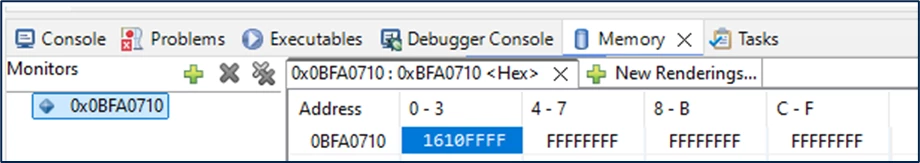

These values are stored in memory at the following addresses:
  • TS_CAL1: 0x0BFA0710 to 0x0BFA0711
  • TS_CAL2: 0x0BFA0742 to 0x0BFA0743

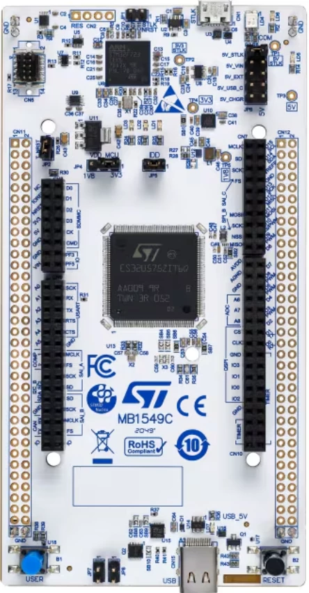

Hardware:
  • Micro-USB cable to power and program the board
  • NUCLEO-U575ZI-Q

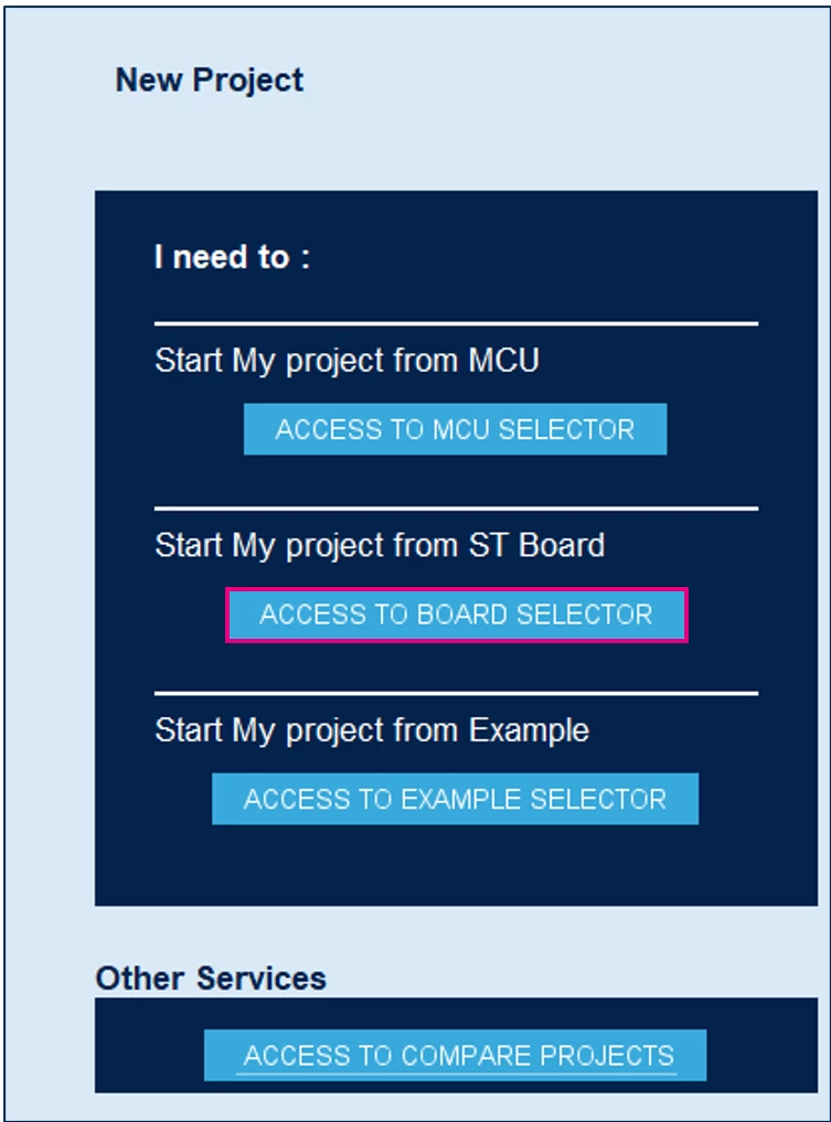

Step 1: Open STM32CubeMX and click the ACCESS TO BOARD SELECTOR button

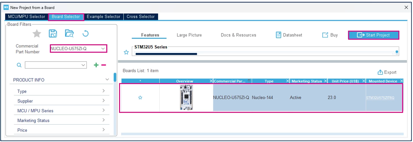

Step 2: Enter the part number in the Commercial Part Number field (in this example, the NUCLEO-U575ZI-Q board is used), select it, and then click Start Project

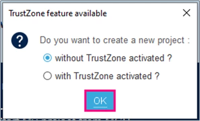

Step 3: A pop-up is displayed. Click [without TrustZone activated], and then click [OK]

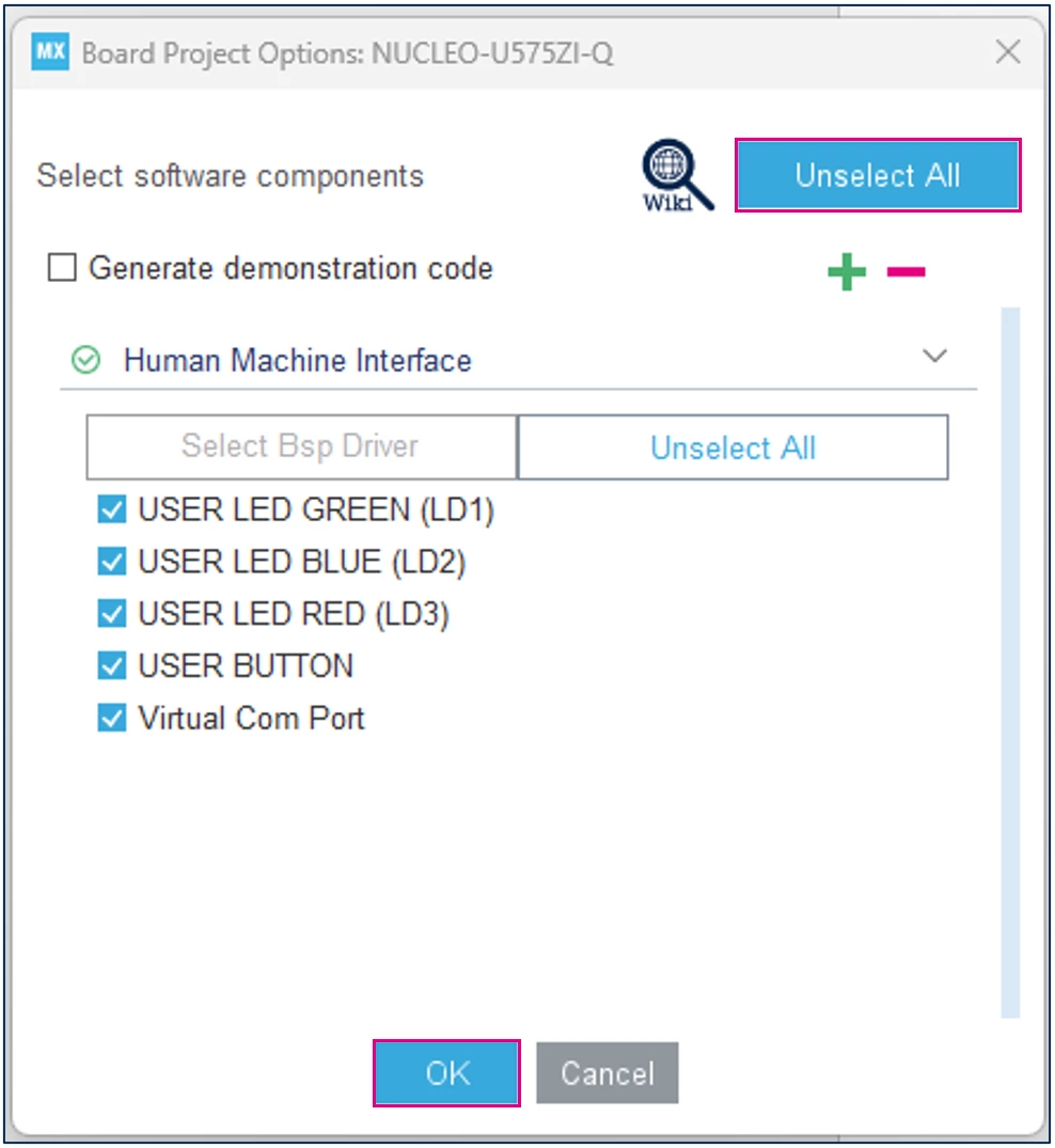

Step 4: Another pop-up is displayed. Unselect all LEDs and buttons by clicking [Unselect All], and then click [OK]

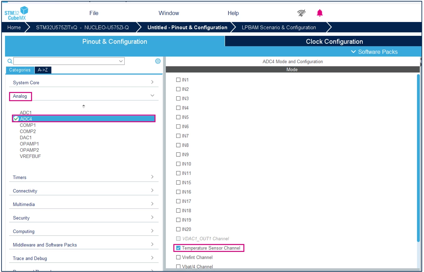

Step 5:  ADC4 Mode and Configuration
  • In the Analog menu, select ADC4, and then select Temperature Sensor Channel.

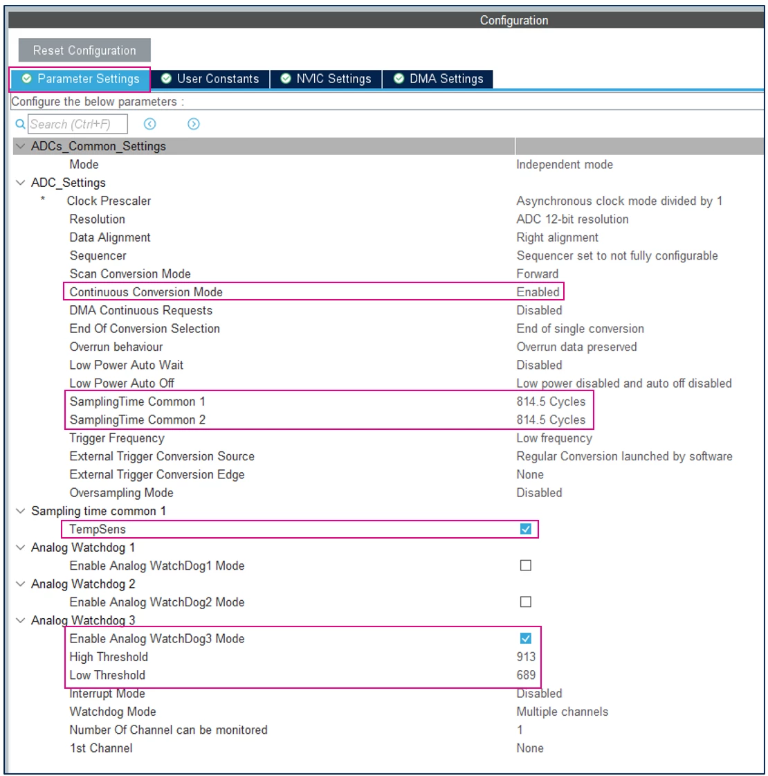

  • In the parameter settings, enable Continuous Conversion Mode and set Sampling Time Common1 and Sampling Time Common2 to 814.5 cycles. Select TempSens, enable Analog WatchDog3 Mode, and set the High Threshold to 913 and the Low Threshold to 689, as shown in the screenshot below.

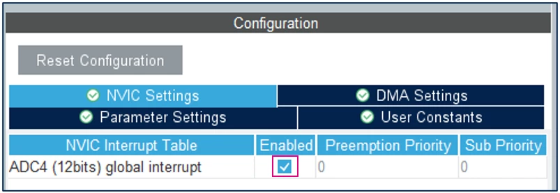

  • In the NVIC settings, select ADC4 (12-bit) global interrupt to enable it, as shown in the screenshot below.

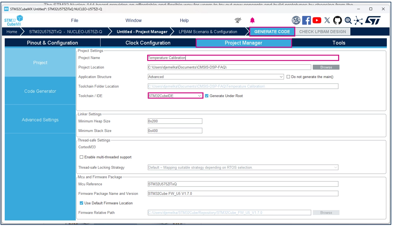

Step 6: Generate code
In the Manager Project section at the top, enter the project name in the Project Name field. Select STM32CubeIDE in the Toolchain / IDE field, and click the Generate Code button, as shown in the screenshot below:

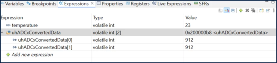

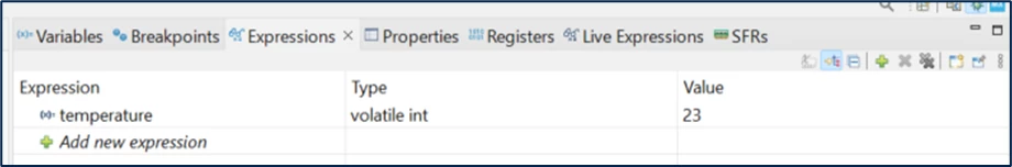

Step 8: Add the temperature variable to the Watch Expressions in the debugger to observe the calibrated temperature value
Step 9: Checking temperature value with the theoretical formula
To verify the returned temperature, refer to the following formula:
Temperature in °C = ((TS_CAL2_TEMP - TS_CAL1_TEMP) / (TS_CAL2 - TS_CAL1)) × (TS_DATA - TS_CAL1) + TS_CAL1_TEMP
With:
  • TS_CAL2_TEMP = 130°C (± 5°C)
  • TS_CAL1_TEMP = 30°C (± 5°C)

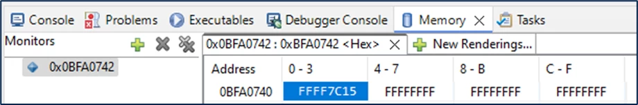

  • TS_CAL2 at address 0x0BFA0742 - 0x0BFA0743 is 0x7C15 = 0b0111 1100 0001 0101 => two-bit right shift: 0b0001 1111 0000 0101 => 0x1F05 = 7941.
  •  TS_CAL1 at address 0x0BFA0710 - 0x0BFA0711 is 0x1610 = 0b0001 0110 0001 0000 => two-bit right shift: 0b0000 0101 1000 0100 => 0x0584 = 1412
  • TS_DATA is the actual temperature sensor output value converted by the ADC.
    In this case, uhADCxConvertedData represents the TS_DATA content, which is 912.
Temperature in °C = ((130 - 30) / (7941 - 1412)) × (912 - 1412) + 30
                              = 0.015 × (-500) + 30
                              = -7.65 + 30
                              = 22.34°C ≈ 23°C
