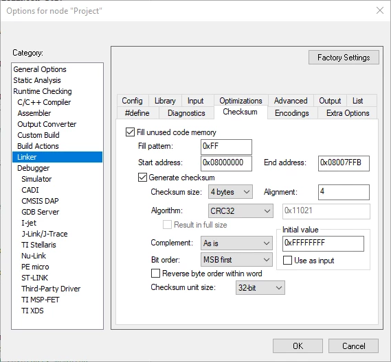

  • With IAR EWARM Toolchain
IAR EWARM provides a way to generate checksum in Project--> Options:

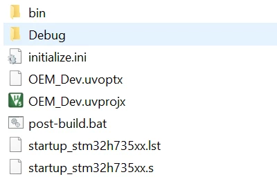

  • Copy srec_cat.exe, srec_cmp.exe, and srec_info.exe files in a new “bin” folder to the root of a Keil project as shown below.

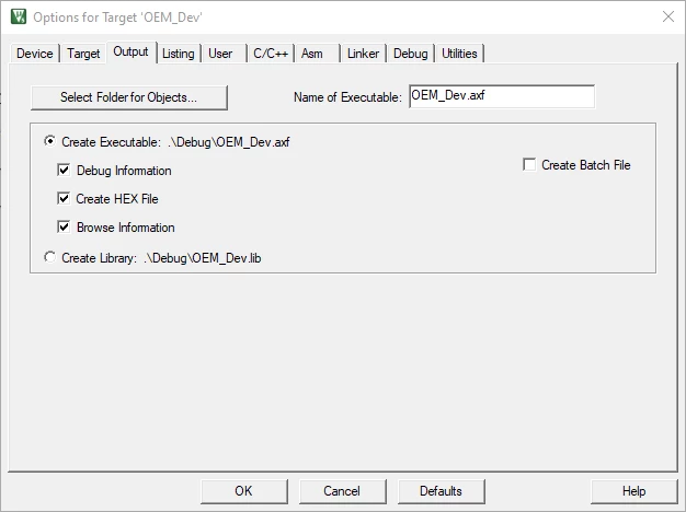

  • Enable the option “Create HEX file” in tab “Output” of Options:

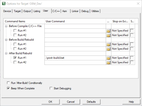

  • Enable the post-build option
To add a CRC after build, it is necessary to enable option “After Build/Rebuild” in User tab and call Srecord commands:
  • Create an empty text file in a text editor
  • Copy this command in your file:
.\bin\srec_cat .\Debug\OEM_Dev.hex -intel -crop 0x08000000 0x08002F02 -fill 0xFF 0x08000000 0x08002F10 -CRC16_Little_Endian 0x08002F10 -o .\Debug\OEM_Dev_CRC16.hex -intel
This command isolates section data from address 0x08000000 to 0x08002F02, fill unused datas of this sector with 0xFF, calculate CRC of the isolate section and place it at address 0x08002F10.
These operations are saved in the output hex file: OEM_Dev_CRC16.hex
You can adapt this command to your own usage.
Refer to srecord-1.63.pdf for more information about the Srecord commands.
  • Save your file as “post-build.bat”.
  • Enable post-build option and call this file:

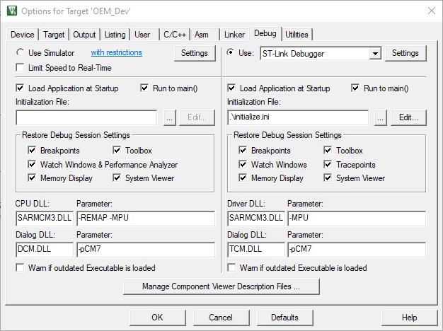

  • The hex file to be used for debug and download must be filled in Debug tab.
The edited hex file generated in post-build step will be then used for programming and debugging.

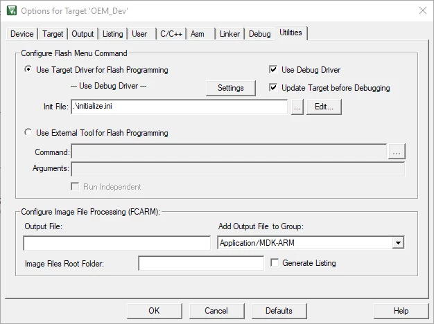

Create a text file, rename it as “Initialize.ini”.
Save it in the root of the project.
Write this command to the file and save it: LOAD .\debug\ OEM_Dev_CRC16.hex INCREMENTAL
Enter this file in Debug tab:
And in “Utilities” tab:
