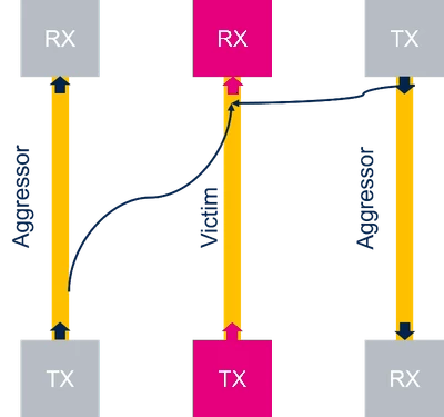

1.2 Crosstalk
This is the unwanted coupling of signals between adjacent conductors or traces in a circuit, where the signal transmitted on one channel (known as the aggressor) induces an undesired signal in a neighboring channel (known as the victim). This phenomenon occurs primarily due to the electromagnetic interactions between the conductors, specifically through mutual inductance and mutual capacitance.
Mutual inductance causes crosstalk when a changing current in the aggressor trace generates a magnetic field that induces a voltage in the victim trace.
Mutual capacitance leads to crosstalk when the electric field between adjacent conductors allows a portion of the signal’s voltage to couple across, transferring energy from the aggressor to the victim.
Crosstalk is categorized into two types based on where the interference is observed relative to the aggressor signal.
Near-end crosstalk (NEXT): The interference appears at the receiving end of the victim trace closest to the aggressor’s transmitter.
Far-end crosstalk (FEXT): The interference appears at the far end of the victim trace, away from the aggressor’s transmitter.
The severity of crosstalk increases with faster signal rise times because rapid voltage changes generate stronger electromagnetic fields, which more readily couple into adjacent traces.
Figure 2. Signals crosstalk

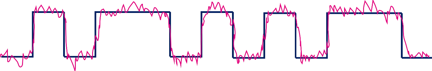

1.3 Noise
External or internal noise sources introduce unwanted variations in the signal, which can distort the data and reduce the overall signal integrity.
Figure 3. Signal noise
