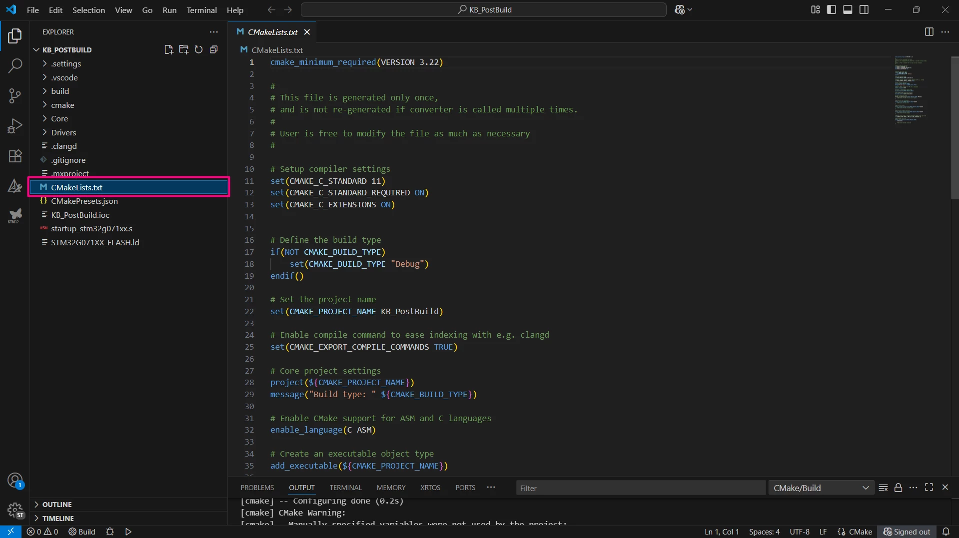

2. Adding post build commands to CMakeLists.txt
Import your project and locate the CMakeLists.txt file in the root of your STM32 project.
Insert the following code snippet at the end of your CMakeLists.txt file:

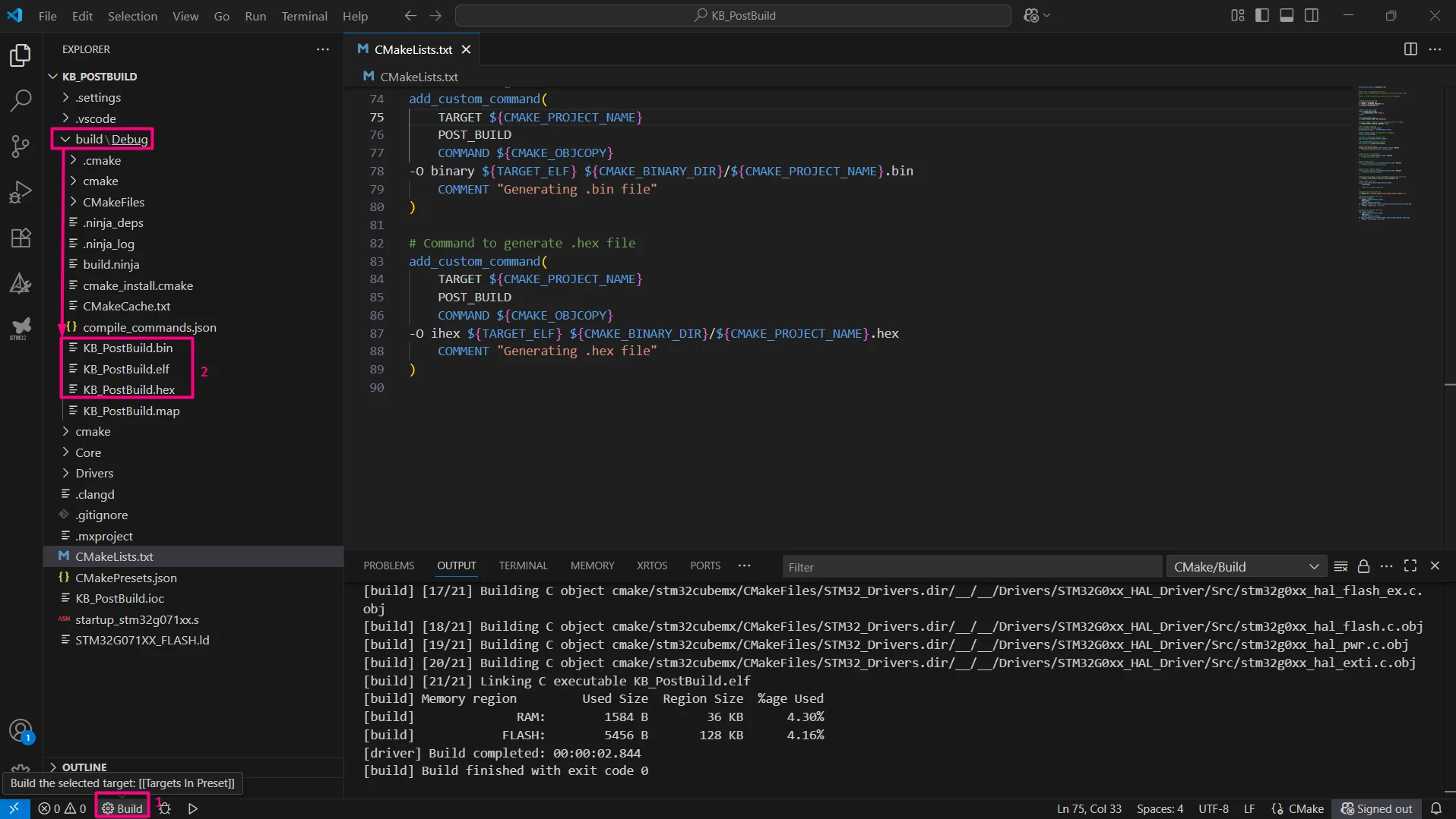

3. Verifying the output
Build the project by using the [Build] button at the lower left corner and after the build completes, navigate to the [build/] directory to verify that the *.elf, *.bin and *.hex files have been generated.
After generating the .bin or .hex files, you can flash them to your STM32 microcontroller using STM32CubeProgrammer to validate the code at runtime.

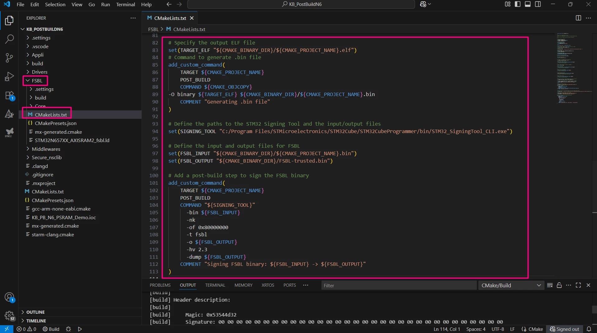

4.1 Example: signing the FSBL
Since the signing tool will be called every time a new build is performed, it is mandatory to echo the "y" to replace the previous signed binary. A possible way to implement this is shown below, slightly editing the previous commands. Starting from STM32CubeProgrammer version 2.21.0 a new parameter is needed "-align". Please make sure you use the updated command, as follows:

# Define the paths to the STM32 Signing Tool and the input/output files
set(SIGNING_TOOL "C:/Program Files/STMicroelectronics/STM32Cube/STM32CubeProgrammer/bin/STM32_SigningTool_CLI.exe")
# Define the input and output files for FSBL
set(FSBL_INPUT "${CMAKE_BINARY_DIR}/${CMAKE_PROJECT_NAME}.bin")
set(FSBL_OUTPUT "${CMAKE_BINARY_DIR}/FSBL-trusted.bin")
# Add a post-build step to sign the FSBL binary
add_custom_command(
 TARGET ${CMAKE_PROJECT_NAME}
 POST_BUILD
 COMMAND ${CMAKE_COMMAND} -E echo y > input.txt
 COMMAND "${SIGNING_TOOL}" -bin "${FSBL_INPUT}" -nk -of 0x80000000 -t fsbl -o "${FSBL_OUTPUT}" -hv 2.3 -align -dump "${FSBL_OUTPUT}" < input.txt
 WORKING_DIRECTORY "${CMAKE_BINARY_DIR}"
 COMMENT "Signing FSBL binary: ${FSBL_INPUT} -> ${FSBL_OUTPUT}"
