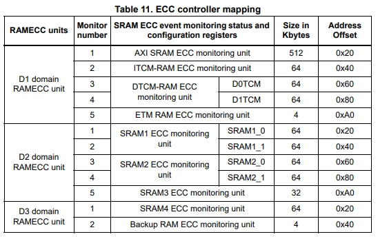

2. RAMECC monitors
The list of monitors varies depending on the STM32H7 series.
The STM32H74x/5x has one monitor for each RAM block in the MCU.
  • RAMECC1 controller has 5 monitors for D1
  • RAMECC2 controller has 5 monitors for D2
  • RAMECC3 controller has 2 monitors for D3
The detail is given in table 11 of the reference manual.

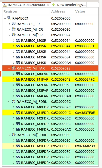

June 26, 2024
@Christophe VRIGNAUD
That does not really work out. I got the following notification (on STM32H753AII):
RAMECC1_M1SR (0x52009044) = 3 (Single and double ECC error)
OK, so this is D1 monitor 2 which belongs to ITCM. Should be a 64-bit bus.
RAMECC1_M1FAR (0x52009044) = 0x3ffd
RAMECC1_M1FDRL (0x52009048) = 0x152f2fef
RAMECC1_M1FDRH (0x52009044) = 0xa9ebe8f8

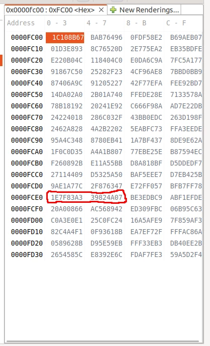

ITCM base address is 0x00000000.
Failing address is supposed to be 0x00000000 + (0x3ffd * 8 ) = 0x01ffe8.
There is nothing mapped to this address; naively writing the data there results in HardFault.
Shall I mask the address register first to a few lower bits? (Since the maximum size is 64k, and scaling factor is 8, only the lower 13 bits could possibly be set for a valid address.)
Indeed, if I just mask the FAR content like described, I get 0x1ffd to work with which results in memory address 0x0FFE8. The content there in the Memory monitor matches the provided Data Register content.
Is it safe to just mask it like this? Are the FAR higher bits don't care or do they carry additional information?

Putting together RM0433 table 11 (ECC controller mapping) and table 7 (memory layout),
I came to the conclusion that DTCM, SRAM1 and SRAM2 are those meant as "interleaved", which means that despite of looking like continuous RAM they are subdivided into 64kB slices.
Rest of comment redacted: False speculation. See below.
June 28, 2024
@KORourke Now I know what the "interleaved" means.
For DTCM, it's not that the two RAM blocks are put one after another, like it is the case for D2 SRAM.
They are interwoven, i.e. we have a 64-bit bus but accessing two 32-bit units of RAM (of 64 kB = 16 kWords each) simultaneously. So for address calculation you multiply the FAR content by 8, but being a 32-bit monitor, each unit will only provide you data in the FDRL register.
DTCM ramRAMECC1_Monitor3
(0x52009060)
DTCM ramRAMECC1_Monitor4
(0x52009080)
0x20000000FAR == 00x20000004FAR == 0
0x20000008FAR == 10x2000000AFAR == 1
0x20000010FAR == 20x20000014FAR == 2

1. DTCM-RAM is a specific RAM.
The Release Manual (RM0433 for the STM32H743) explains that the DTCM bus is 2x32-bit and why it is so:
"The 2x32-bit DTCM bus allows load/load and load/store instruction pairs to be dual-issued on the DTCM memory."
The DTCM-RAM content is interleaved in D0TCM and D1TCM.
The AN5342 - section 3.1.3 Interpreting FAR - explains how to calculate the failing address in this case: the word size is 8 bytes. The 64 bits which are read at a given address are composed of 32 bits from D0TCM followed by 32 bits from D1TCM. Each 32-bit data has its own ECC.
In your case, depending on which of monitor 3 (D0TCM) or monitor 4 (D1TCM) has signalled the error, the 32-bit failing address is:
- for D0TCM: 0x2000 0000 + 0x3B22 * 8 = 0x2001 D910
- for D1TCM: 0x2000 0004 + 0x3B22 * 8 = 0X2001 D914

The STM32H743 has 2 monitors in RAMECC2 for SRAM1 (monitor 1 and monitor 2) and SRAM2 (monitor 3 and monitor 4), each monitor covering 64 Kbytes of the SRAM. But in this case, it just has an impact on the start address.
- monitor 1 for SRAM1_0: RAM failing address = 0x3000 0000 + FADD * 4
- monitor 2 for SRAM1_1: RAM failing address = 0x3001 0000 + FADD * 4
- monitor 3 for SRAM2_0: RAM failing address = 0x3002 0000 + FADD * 4
- monitor 2 for SRAM1_1: RAM failing address = 0x3003 0000 + FADD * 4

RAMECC1_M1SR is the status register of RAMECC1 monitor 1 = 0x52009024. This is the AXI SRAM monitor.
As RAMECC1_M1FAR (0x52009028) = 0x3ffd, the ECC failure is in AXI SRAM at address:
RAM failure address = 0x2400 0000 + 0x3ffd * 8 = 0x2401 FFE8.
The Failure address read in the FAR register is directly usable. You can forget all your mask stuff; it's not needed at all.
July 6, 2024
OK, let's do it one more time.
The ECC interrupt occurs; scanning the state registers reveals a 1 at address 0x52009044 (single bit failure).
This belongs to D1 domain (RAMECC1) monitor 2 (address offset 0x40), which is, according to RM0433 Table 11, assigned to ITCM-RAM which is 64 bit.
FAR at 0x52009048 reveals 0x3F9C.
RAM address = ITCM base + (8 * FAR) = 0x00000000 + (8 * 0x3F9C) = 0x001FCE0
This is an invalid address. The last valid address of ITCM would be 0x0000FFFF.
On the other hand, assuming that only 13 bits of FAR can possibly be valid, the content would be 0x1F9C which results in RAM address 0x0000FCE0, which fits pretty well when comparing the content of the two failing data registers and the observed RAM content from Memory monitor.Bildschirmfoto vom 2024-07-06 21-44-39.png
So the question still is, why is there sometimes a stray extra bit set. (I've never observed it at a higher position).
But obviously it can just be ignored. I have not yet observed this behavior for any other monitor than ITCM, actually.
