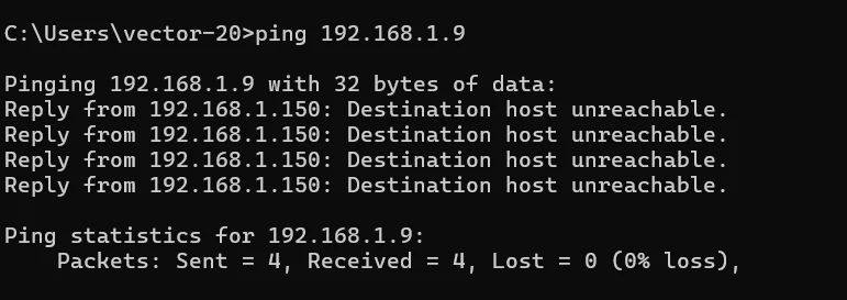

The Ethernet peripheral on STM32H7x3 is not sending, or receiving data correctly. Or, the IP stack is not able to establish connection to other devices.
What could be the problem?
