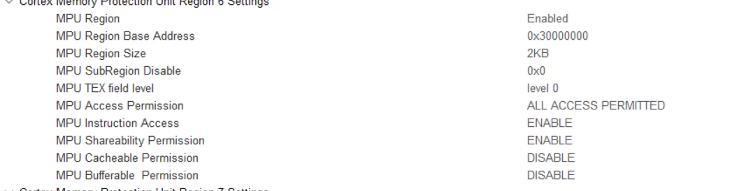

  • Disable the D-cache for a portion of the memory by configuring the memory protection unit (MPU). However, the MPU regions have specific alignment restrictions, and it is necessary to place the DMA buffers in designated parts of the memory. Each toolchain (GCC, IAR, KEIL) must be configured differently.
    • Note that MPU regions can overlap, and the higher region number has priority. Together with subregion disable bits, this feature can soften the alignment and size restrictions.

Below are the possible MPU configurations. Green configurations are suitable for DMA buffers, blue configurations are suitable only for TX-only DMA buffers, and red configurations are forbidden. Other configurations are not suitable for DMA buffers and require cache maintenance operations:

4. Solution example 2: placing buffers in separated memory part
D-cache must be disabled through the MPU for the specific memory region where the DMA buffer is placed. Note that the MPU region size must be a power of two. Additionally, the region's start address must have the same alignment as its size. For example, if the region is 512 bytes, the start address must be aligned to 512 bytes (the 9 least significant bits must be zero).
