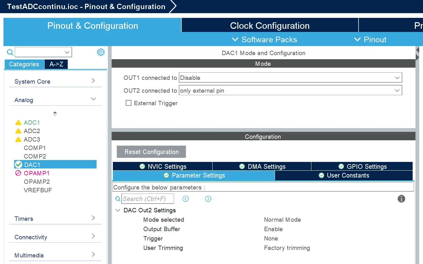

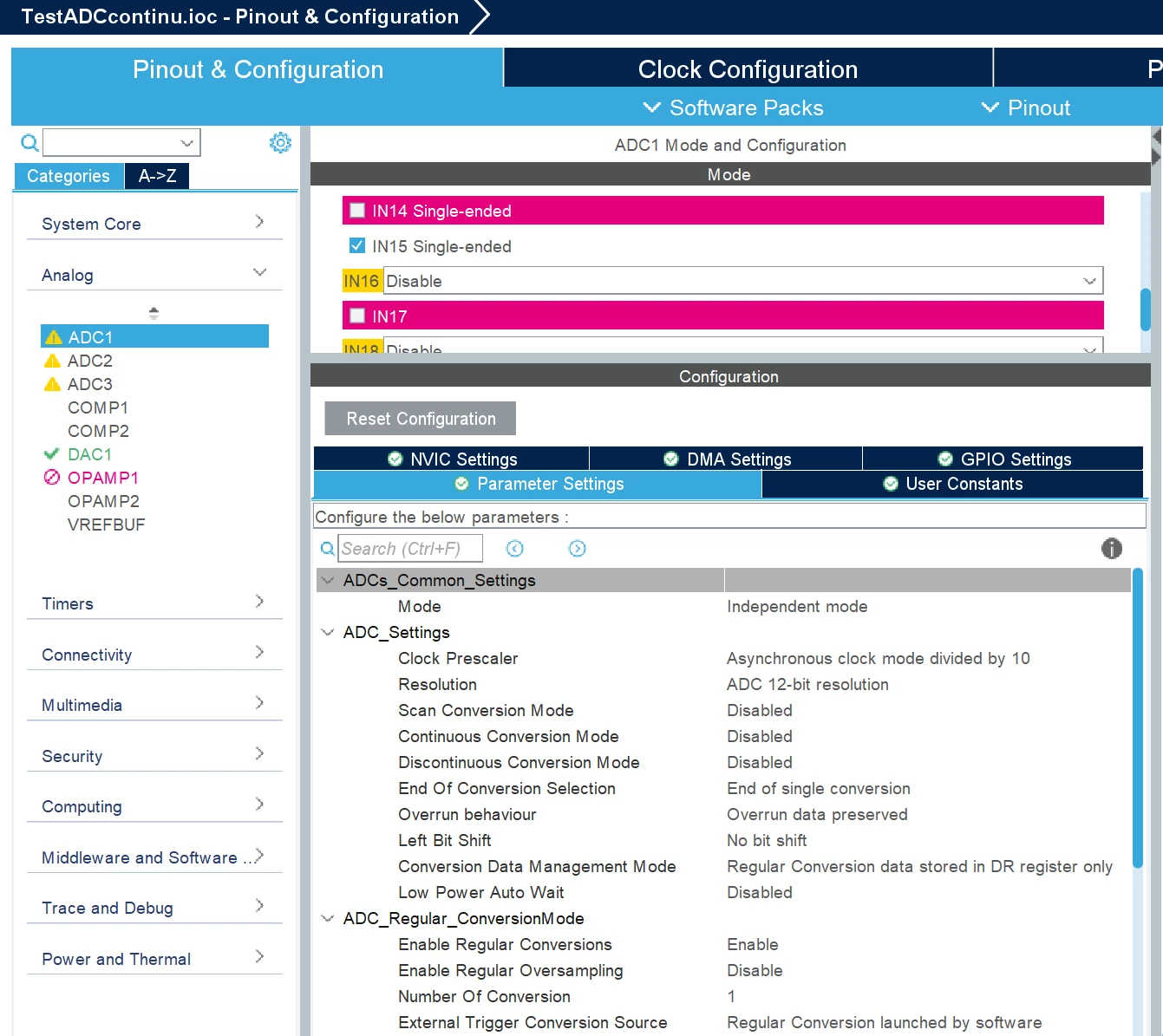

Nov 27, 2023 3:06 PM UTC
Hello HTD,
So I followed the tutorial (getting started with ADC) step by step.
For reading a one time shot value from ADC it works fine:
I create the DAC and ADC:

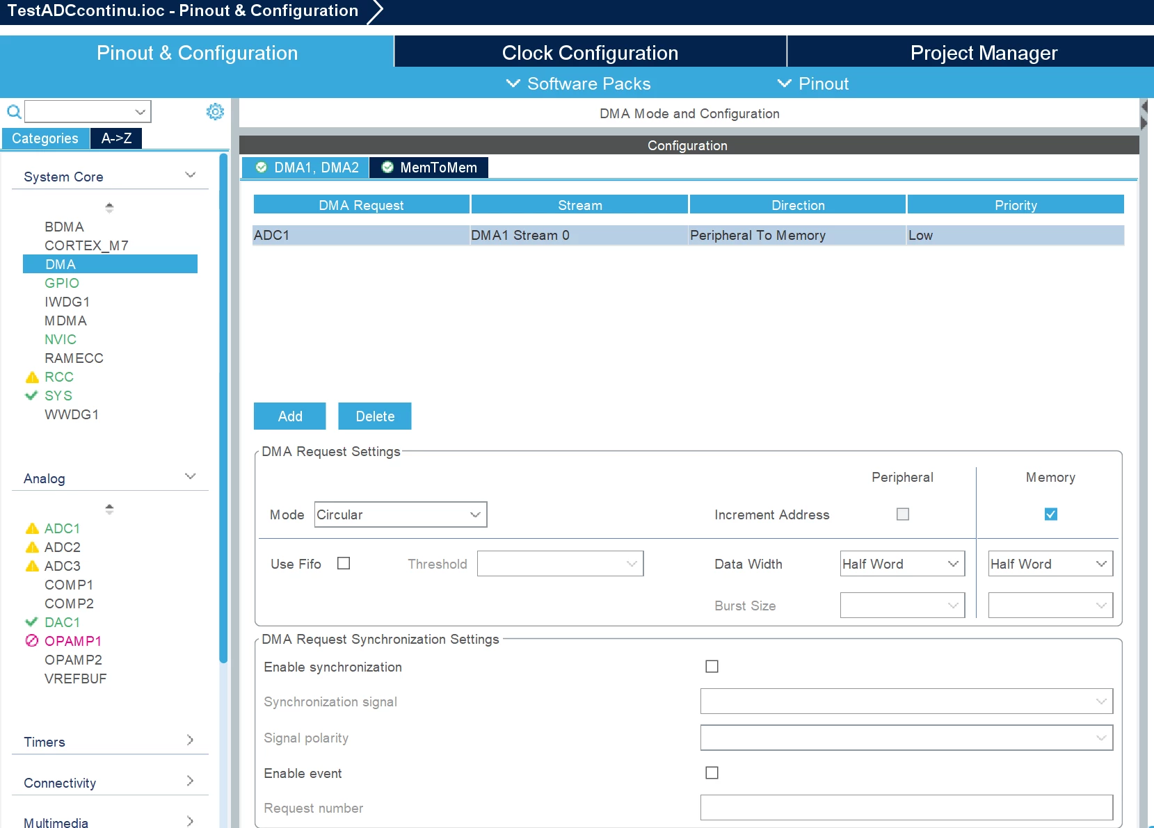

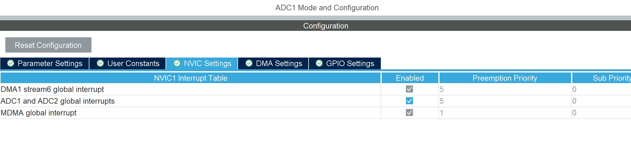

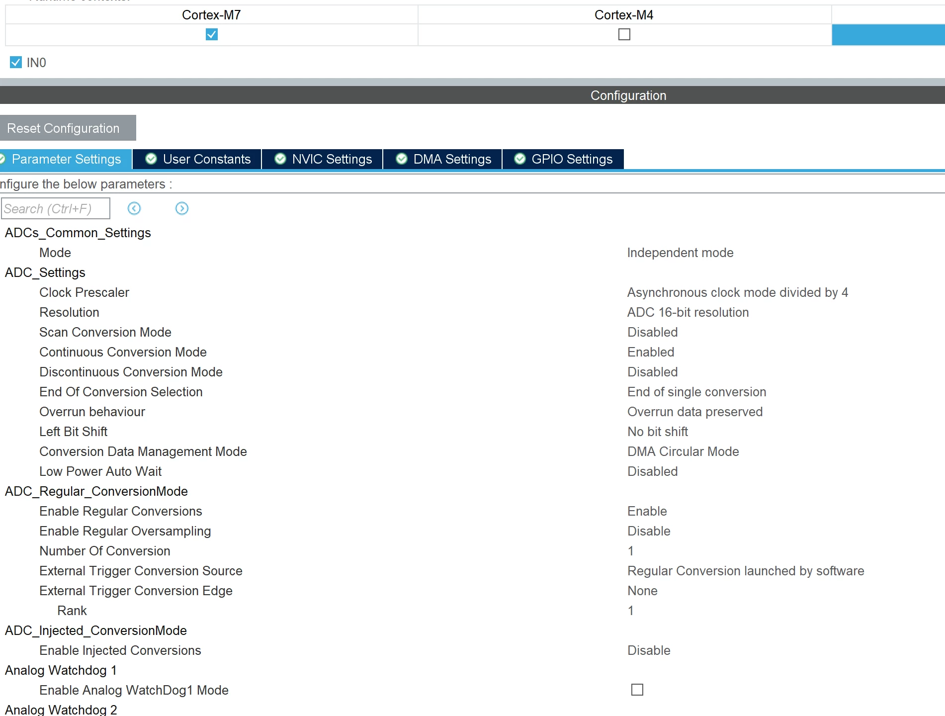

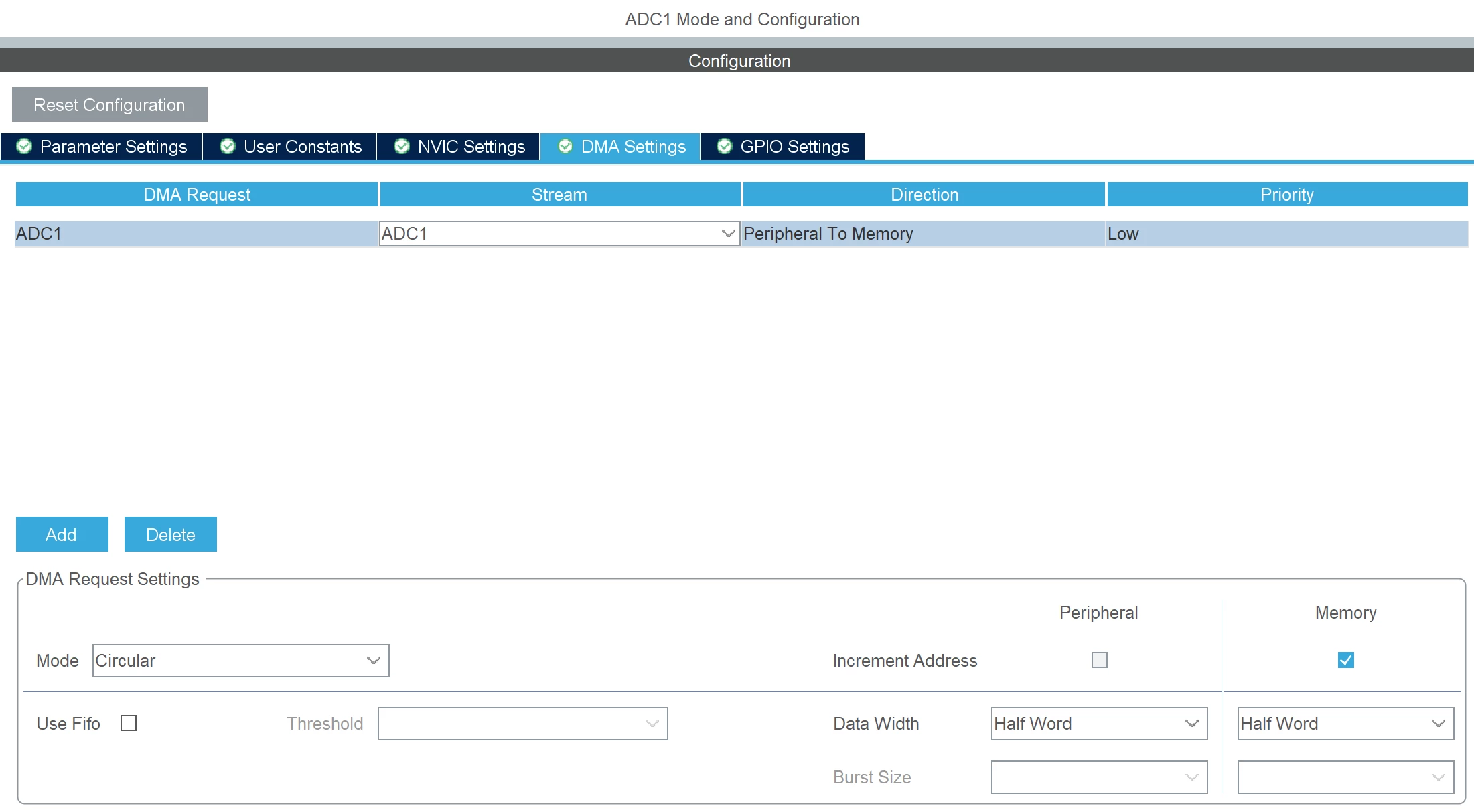

Now, I want to use a DMA to continuously read from the ADC.
As a first step I don't use a buffer but still one int for value_adc and it should get updated as the tutorial suggests.
I create the DMA and update the ADC. I don't change the DAC.

So I guess the value_adc doesn't get update. I guess there is missing some kind of trigger to say that it should be updated with the DMA.

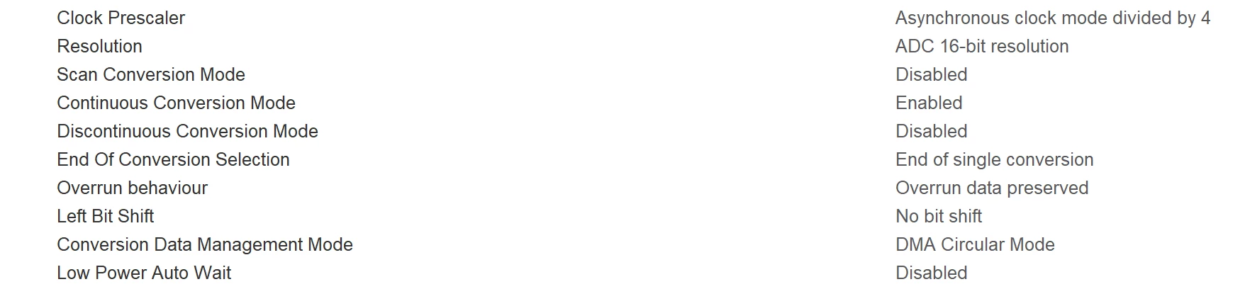

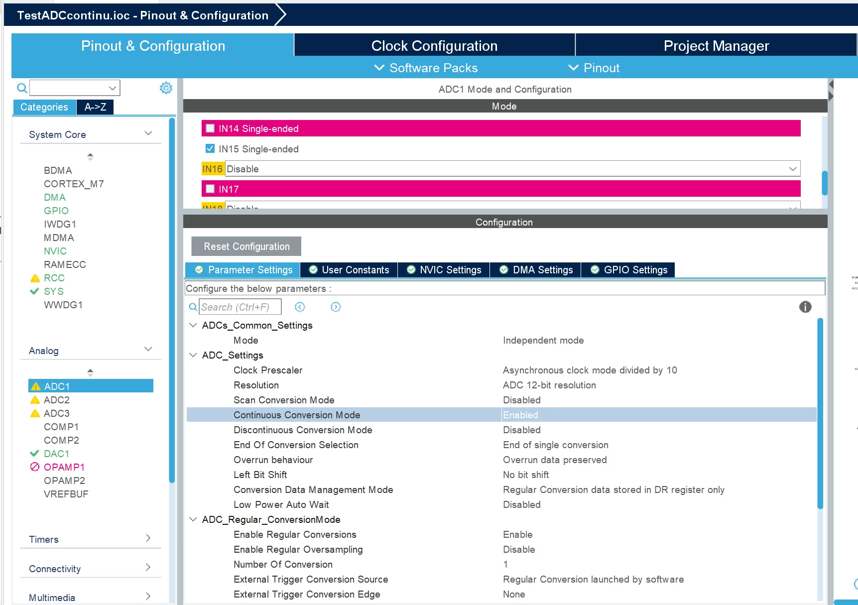

It seems like you need "Continuous conversion mode" enabled:
Then, using DMA I don't use HAL function to read value. I just start reading with HAL, then I read the data directly from my buffer.
I set the callback to be notified when the conversion is complete:
HAL_ADC_RegisterCallback(m_hadc, HAL_ADC_CONVERSION_COMPLETE_CB_ID, conversionComplete);
Inside the function `conversionComplete` I just calculate the average from all samples in the buffer and trigger another notification when it's done. Of course instead of averaging the values you can do anything else with them, like copy them somewhere else.
I would paste my code but it's unnecessarily complex because it handles multiple channels and performs additional calculations, also it's done in C++. The only important part is the function takes `ADC_HandleTypeDef` as the only parameter. As this is an ISR, whatever you do in that function must be done very quickly, without blocking or god forbid waiting. So using UART from it is a no-no. It only averages the values and sets a variable that tells the other thread in my code that the new value is ready to be read. Then the other thread just reads the result. So in case of no OS used - your main thread is your main loop. It can loop and test if you set a special variable that the value is ready, when it's ready read it and send it to the UART, then clear the flag and loop. The callback mentioned earlier is responsible for actual reading exactly when the data from ADC is ready. Remember to not block / wait in callback, otherwise you would deadlock the MCU and it won't work.
Nov 27, 2023 4:12 PM UTC
Yes I put the  "Continuous conversion mode" enabled in my second example.
I used UART but if comment it and read by the debugger the value_adc variable it is still 0.
I also tried the
function be it is never called.

Looking at your screenshot, you have `Conversion Data Management Mode` set to `Regular Conversion data stored in DR register only`, I believe it should be set to `DMA Circular Mode`.
Here's how it's set in my project:
BTW, try to use more than 1 word for the data, define a buffer for like 128 samples as array. If your resolution is set to 12 bits, that the closest word size will be 16-bits. So I would use an array of let's say 128 of `uint16_t`, the length of the data should be 128 (number of 16-bit words). That's what I believe is half word in DMA settings, here:
Also be sure to have IRQ enabled:
Then the registered callback function should start to be called. And the elements of the buffer array should contain the measured values. I guess the main point of using DMA here is to quickly get many samples without interrupting MCU. So if you set like 128 samples (buffer size) - you will get the interrupt and the callback called when all of the samples are written in the buffer, so not on the single reading, but when multiple readings complete. IDK, maybe it would just work on a single value, but I haven't tested it. Try to replace single value with a buffer (and best make it length divisible by 4), then in the callback try to calculate the average of the values in the buffer, then copy result to another variable. Then in your main loop just print this value using UART debugger function. Please tell me if it worked.
Nov 29, 2023 2:51 PM UTC
Silly me, I just saw the parameter you pointed out : 'Conversion Data Management Mode' to `DMA Circular Mode`. I guess this is the new parameter corresponding to the "DMA continuous request" from the outdated tutorial I was looking for.
When I choose this option, then my variable "value_adc" is updated correctly.
I replaced it with a buffer and the buffer was filled correctly too. There was a trick though, to declare as uint16_t buffer_adc[N] but then casted it as (uint32_t*)&buffer_adc, otherwise the buffer is filled weirdly.
However, I didn't use your callback function "HAL_ADC_RegisterCallback", but I use the functions explained in some other tutorials HAL_ADC_ConvHalfCpltCallback and HAL_ADC_ConvCpltCallback and it is correctly called.
