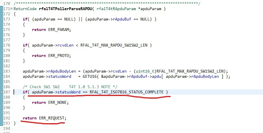

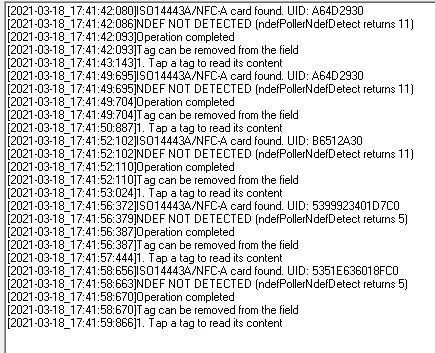

I have boards - NUCLEOL476RG and X-NUCLEO-NFC06A1 with project "STM32L476RG-Nucleo_PollingTagDetectNdef" running on it.
And got an error when trying to read any tag:
0693W000008xIJLQA2.pngWhen debugging program i found that error, its here in the code, doesn't match
apduParam->statusWord == RFAL_T4T_ISO7816_STATUS_COMPLETE
The walue of statusWord is 27266 instead of 36864 (0x9000)

Ulysses HERNIOSUS
Mar 18, 2021 3:41 PM UTC
Hi VIVAN.1,
NDEF can only be read/written from NFC Forum formatted tags. Not all tags are capable of that. Above indicates you are using NFC-A tags supporting ISODEP/ISO7816 APDUs.
The value 27266=0x6A82 indicates that this tag does not answer success (0x9000) to the command. I think 0x6A82 means "not supported. I assume this to be the response to the "Select NDEF application" command. NFC-A smartcards are available for a plethora of applications, e.g. NFC Forum T4T, EMVCo, Passport, .....
If you use tags like ST25TA which implement T4T it will report success.

Wladimir
WladimirAuthor
Mar 18, 2021 3:58 PM UTC
Thank you for answer.
NDEF is NFC supported data format for exchange ​and isn't all NFC devices have to support NDEF format ?
NFC-A tag isn't NFC Forum tag?
Those messages you see on the picture I got using 2 types of tags: NFС 1К s50 F08///716 Вytеs and ntаg213/137 Bytеs.
But I also used smartphone and app NFC Tools Pro​ and there was again NDEF NOT DETECTED message.

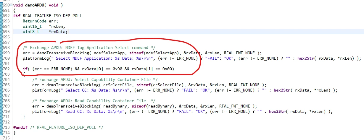

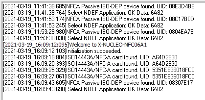

I've tried to format (whatever it means in that case) my tags (NFС 1К s50 F08///716 Вytеs and ntаg213/137 Bytеs) by NFC Tools app but its failed, it doesn't support this tags.
Yes, card emulation is available in Pro version, its in the WRITE menu --> ADDITIONAL OPTIONS.
I also tried project named "STM32L476RG-Nucleo_PollingTagDetect" (without "Ndef" in the end). And have output:
ISO-DEP its my phone.
OK Data: 6A82 it means that "Select NDEF Application" command failed (result must be 0x9000). See the code:
Ulysses HERNIOSUS
Mar 19, 2021 2:29 PM UTC
I don't have this Pro version and cannot try. However this code of 6A82 means that the NDEF applet is not supported.
Similar to the T2T below I would try to use a second phone to read this emulated tag (Please make sure to de-activated Android Beam and if available on your mobile settings switch to Card Emulation mode only option)

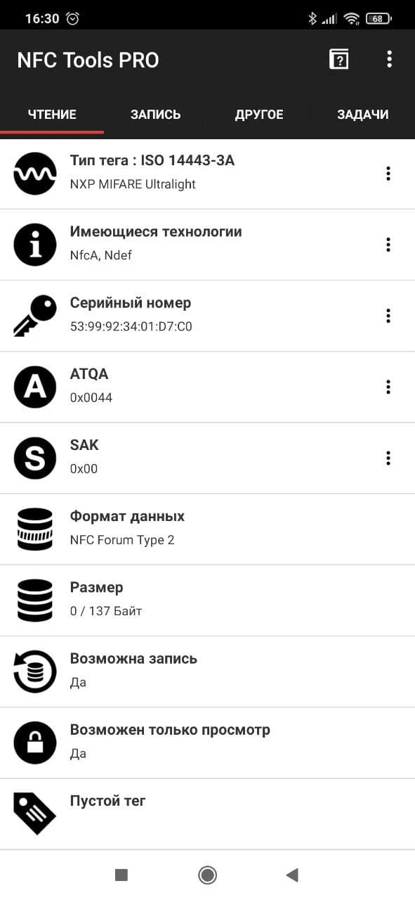

I copied content of my clean tag.
0693W000008xOg6QAE.jpgmemory content is:

Ulysses HERNIOSUS
Mar 19, 2021 2:12 PM UTC
this one seems to be a tag from Shanghai Feiju Microelectronics (Manufacturer 0x53). Not a real NTAG but claims to be compatible to NFC Forum T2T. The memory contents looks correct from first glimpse, should be detected as T2T. However I would need to perform some experiments and it can also be that the tag content may be correct but on the RF layer it does not comply (timings, etc.).
If you write e.g. an URI to it and present it to an Android phone without any app opened, does it then ask to open the web page?

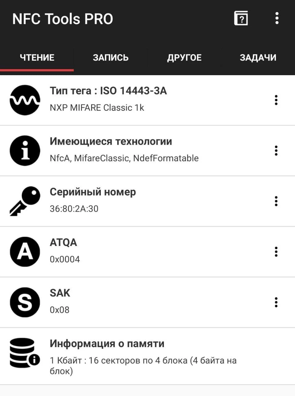

Wladimir
WladimirAuthor
Mar 19, 2021 1:38 PM UTC
and another tag
0693W000008xOilQAE.jpg[ 36:80:2A:30:AC:08:04:00:02:97:10:99:8C:B4:C7:1D ] Сектор 00 : UID0-UID3 / MANUFACTURER

Ulysses HERNIOSUS
Mar 19, 2021 2:15 PM UTC
this tag looks like a Mifare Classic tag or a clone of it. This type of tag uses a proprietary and in the meantime broken crypto. It is not part of NFC Forum, however on some phones (typically with NXP NFC chipset) it is supported. I cannot recommend to use such tags.
If you look around in this community you will find further hints on it.

Mar 19, 2021 3:04 PM UTC
can you tell what Android app is able to data exchanging with X-NUCLEO-NFC06A1?
I actually need not tags (tags for practice, its useful:) ) but data exchange (read and write) between phone and ST NFC board. P2P mode - the best option for me)
I've tried "NDEF Tag emulator" android app and magic happens - "READ-ONLY NDEF detected." See picture below.
But read-only doesn't fit to me, i need read and write capabylities.
Here is the output:
Initialization succeeded..
1. Tap a tag to read its content
NFCA Passive ISO-DEP device found. UID: 080630C2
NDEF NOT DETECTED (ndefPollerNdefDetect returns 4)
Operation completed
Tag can be removed from the field
NFCA Passive ISO-DEP device found. UID: 083B0C62
NDEF Capability Container
 * CCLEN: 15 T4T_VNo: 20h MLe: 59 MLc: 52 FileId: e104h FileSize: 4095
 * readAccess: 00h writeAccess: ffh
 CC File Raw Data (length 15)
 [0000] 00 0F 20 00 3B 00 34 04 | . .  . ; . 4 . |
 [0008] 06 E1 04 0F FF 00 FF  | . . . . . . .  |
NDEF Len: 21, Offset=2
 NDEF Content (length 21)
 [0000] D1 01 11 54 02 65 6E 48 | . . . T . e n H |
 [0008] 65 6C 6C 6F 20 57 6F 72 | e l l o  W o r |
 [0010] 6C 64 21 21 20     | l d ! !     |
Decoding NDEF message
Record #1 - Short Record
 Text: "Hello World!! " (UTF8, language code "en")
 MB ME CF SR IL TNF
 1 1 0 1 0  1
 Type Name Format: NFC Forum well-known type [NFC RTD]
 Type: "T"
 Payload: (length 17)
 [0000] 02 65 6E 48 65 6C 6C 6F | . e n H e l l o |
 [0008] 20 57 6F 72 6C 64 21 21 |  W o r l d ! ! |
 [0010] 20           |         |
Operation completed
I will answer on your other questions later. appreciate for your help
