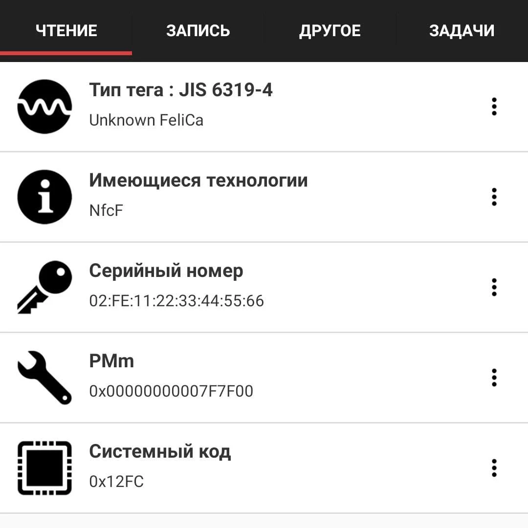

I set up Card Emulation mode on X-NUCLEO-NFC06A1 board by adding
#define ST25R3916
#define DEMO_CARD_EMULATION_ONLY true
in demo.h file.
Phone polling for NFC-A and NFC-F technologies both, so i commented
//case RFAL_NFC_POLL_TYPE_NFCA:
in demoCycle() function, so i have only NFC-F enabled in CE mode.
( Besides, when i commenting
//case RFAL_NFC_POLL_TYPE_NFCF:
i.e. setting up only NFC-A its not working, NFC Tools recognizing it as NFC-F and writing on "tag" (board) doesn't working. )
And what's happening in NFC-F mode. Its not working properly.
After board reset reading board as tag showing info in NFC Tools:

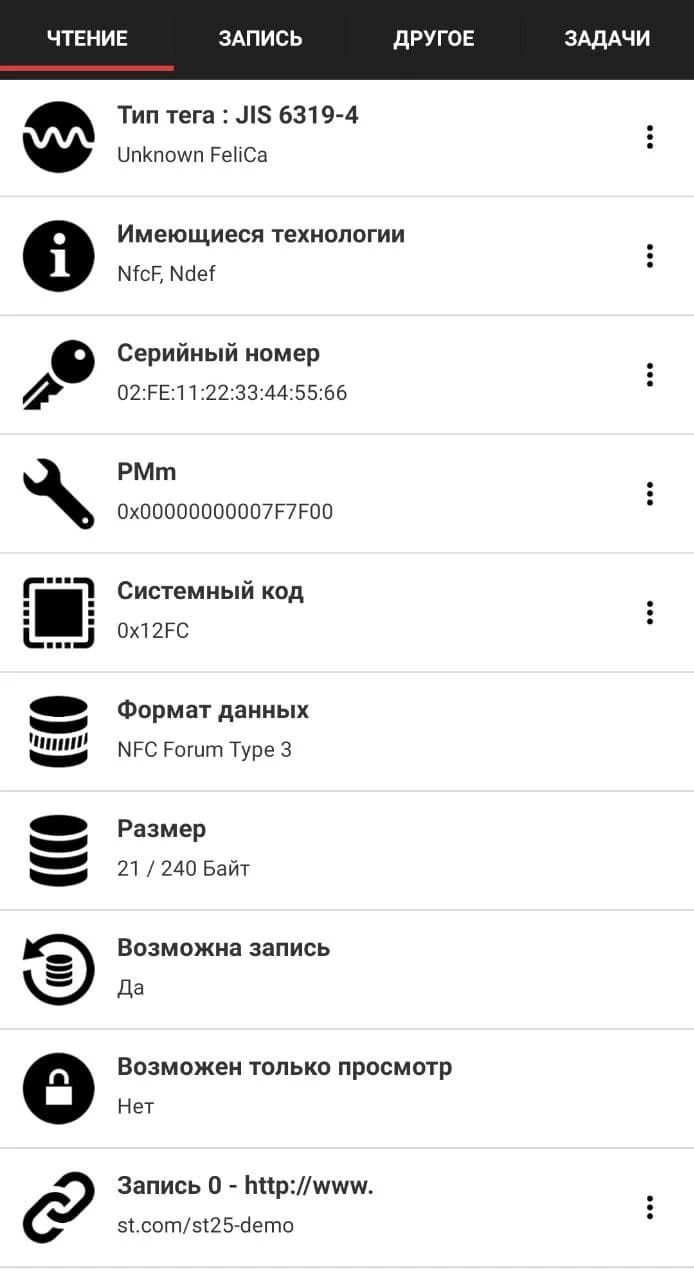

0693W000008xghHQAQ.jpgWhen i trying to write plain text ("hello!!") first time - there is success info message in NFC Tools. Second time (and subsequent) - i got fail info message.
After writing on "tag" 1st time, reading "tag" gives another results:
So there is no message on the label that I wanted to record.

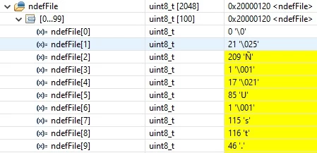

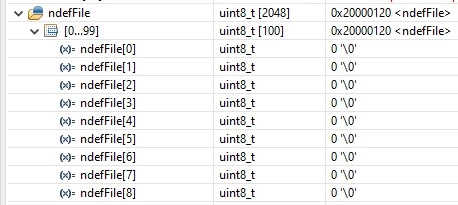

Here is interesting detail, when X-NUCLEO-NFC06A1 board starting after reset, ndefFile buffer is empty (observing via debug):
0693W000008xkfoQAA.jpgWhen reading a "tag" (board in CE mode) 1st time its initializing by default value:
0693W000008xkcaQAA.jpgMaybe its because CE mode initializing when reading "tag" happens.

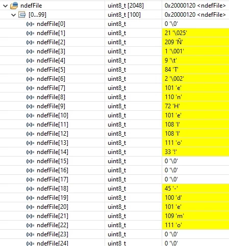

Ok, whats happens next - i writing message on "tag", and its ok:
0693W000008xkkUQAQ.jpgAlthough we also see leftovers from the previous package.
But the problem is that this recorded message cannot be read, the reading ends with an error in NFC Tools app.
I also compared the content of the InformationBlock before and after writing a "tag", it does not change except for the size of the payload and NDEF mapping version (don't know what it is).
Perhaps this problem, when it is not possible to read the NFC tag, that is, the useful information written to it, is similar to the one when it is not possible to read the information from the NFC-A tag. But with the NFC-A tag, the information cannot be read immediately after the board is started.

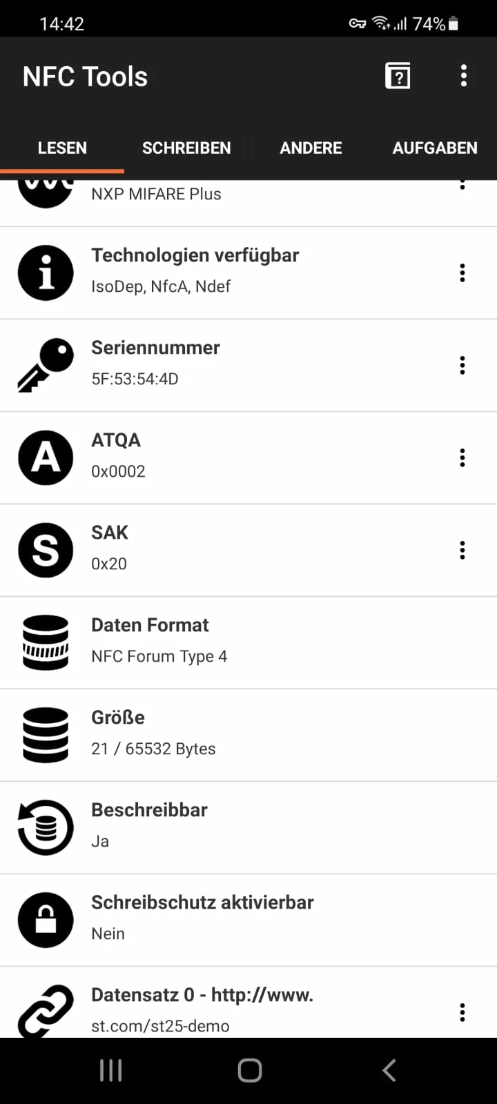

Mar 24, 2021 2:16 PM UTC
the trick should not be playing with the state machine but just change techs2Find.
Please try the attached hex, it was compiled according to my above instructions.
0693W000008xnVJQAY.jpgYes, with my proposal you need to have your own Android app.
Not sure what you want exactly you want to achieve. Just reading/writing some messages to trigger an action?
Regards, Ulysses
Wladimir
WladimirAuthor
Mar 24, 2021 3:26 PM UTC
I used your hex and the result of reading the label is the same as yours. I did as you said, changed tech2find and I recognized the NFC-A tag, okay. The writing is more difficult, the text or URL is written in ndefFile, I looked in debugging, but the problem is that when reading the label in ndefFile, the default entry is written again - the address of the page st25demo.
Writing to NFC-F problems doesn't change.
