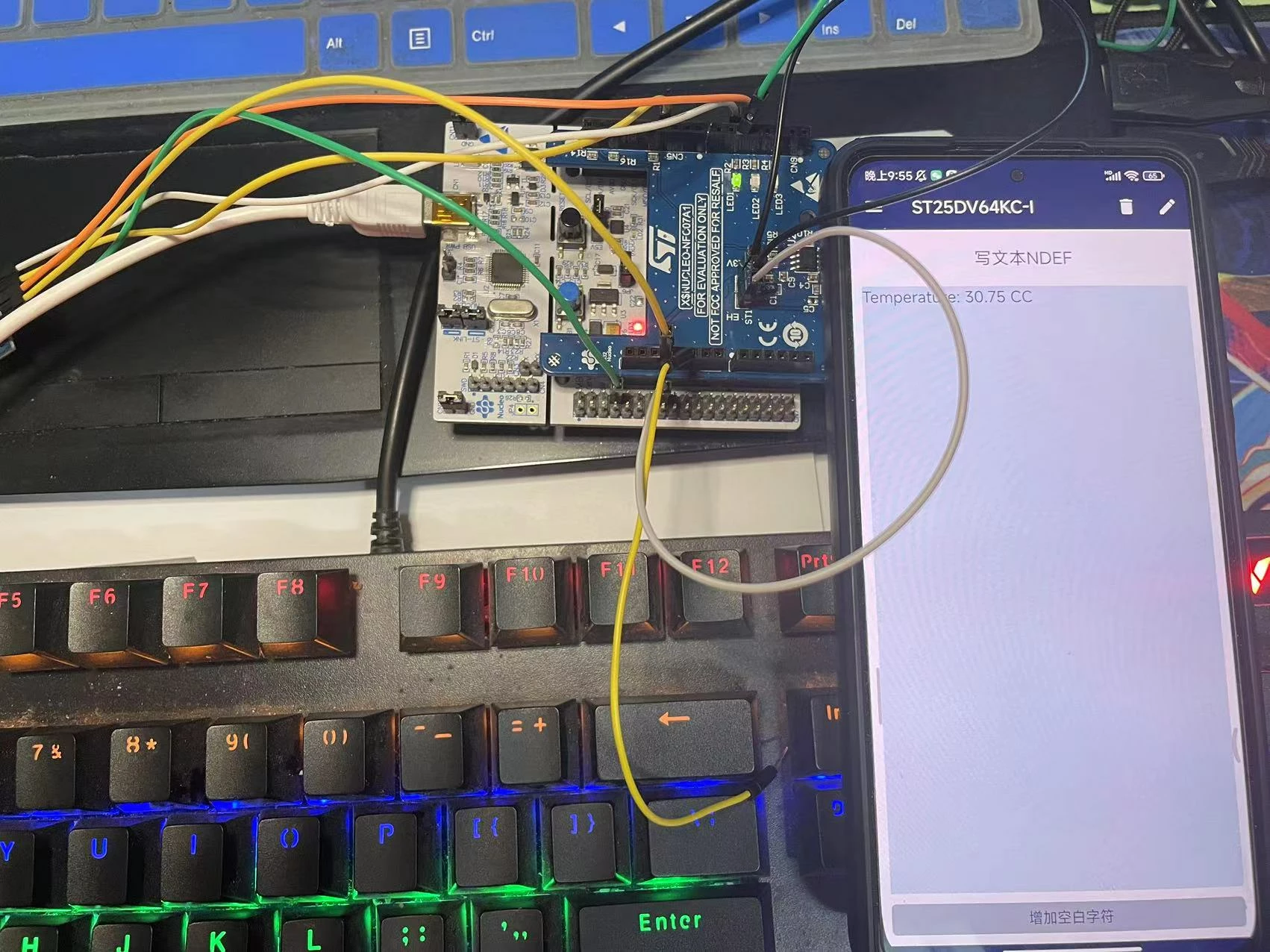

According to what you said, I have finished programming to make LD2 flash, and then connected EH pin to 3.3V of CN6, and NFC07A1 and L4 used nucleo version, grounding and power supply were connected together, but I still did not drive L4 to complete the flashing test with the electric energy obtained through EH pin. What should I do? Here is my connection diagram.

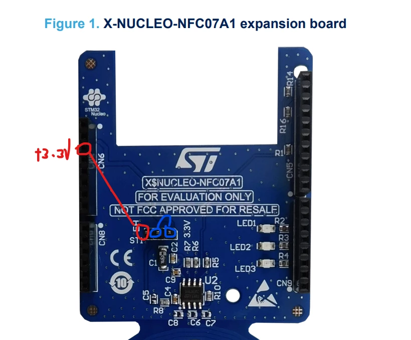

I need to use NFC07A1 to power STM32l476RG, but the PIN 4 connecting CN6 according to the instructions failed to make the MCU run. I tried to write the LD2 flicker program, but the NFC power did not make the LD2 flicker after the USB power failure. But the LD3 power indicator of my L4 was already on, so why didn't I succeed in getting the MCU wirelessly powered? According to the instructions I find that the LD3 works as long as it is successfully lit. What do I need to do to make the EH output pin power the L4 operation?

Some tricks:
Basically, as already mentioned, the initiator field (reader ?) must be strong enough for powering for the STM32L476.
If the EH is used the X-NUCLEO-NFC07A1 ST1connector jumper must be correctly set.
It is recommended to populate C5.
Multiple powering requires arbitrations, for only VEH.
On the Nucleo mother board the powering must be disconnected ( SB2)
To avoid powering IOs conflicts the tracks coming from the embedded ST-Link must be disconnected (card breakable)

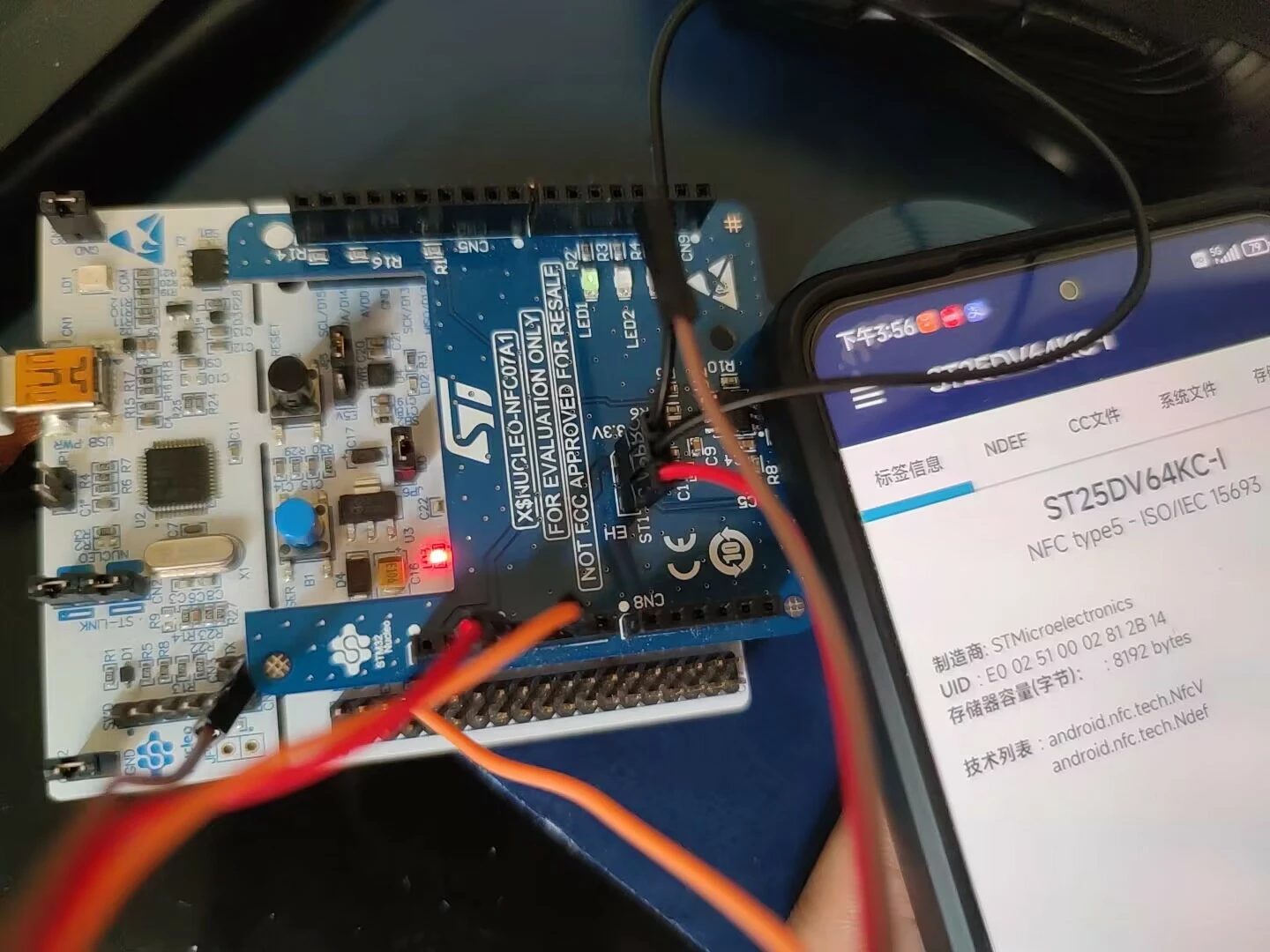

August 3, 2023
I have disconnected the ST-Link, then connected the EH pin to 3.3V, and the NUCLEO-L476RG power light was on, but the LD2 flashing light test with power programming did not succeed, indicating that L4 failed to power, why?

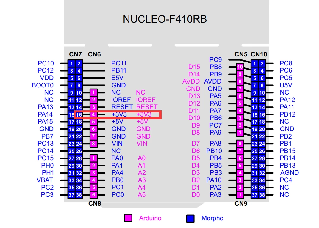

@JDEME
I used a jumper to connect pin EH to pin 16 of CN7, power light LD3 is on, so why did the MCU fail to start? If the energy is insufficient, then how can I use the EH energy to power the MCU?
