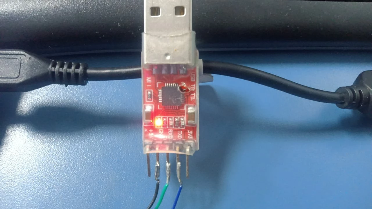

  • have you cross connected the Tx (board) with Rx (CP2102) or how is your CP2102 labeled ? does the CP2102 required Tx to Tx connect or Tx to Rx ?
  • could you send a picture with your wiring between the board and the CP2102 ?

  • 0693W000008yzGbQAI.jpgcan you confirm that CP2102 use the same voltage level as STM32L4 ? 3.3V ? - Yes it uses same 3.3V
  • can you confirm that the CP2102 is able to operate at 3MBit/sec ? - No it is operatable upto 1Mbit/sec
  • just to be sure, did you also connected DTR/RTS lines between the HPEV and the CP2102 ? as explained, they are needed to bring the STM32L4 into bootloader mode, if you want to upgrade the FW. DTR/RTS lines are also used by the GUI during connect and when starting the upgrade process. If DTR and RTS are not proper configured the board will not boot from User code nor enter bootloader. - No RTS and DTR lines are not connected between CP2102 and STM32l4. Already latest firmware is downloaded previously then also it asks for firmware upgrade while UART is connected.
  • just to be sure, do you have connected GND ? - YES
  • have you cross connected the Tx (board) with Rx (CP2102) or how is your CP2102 labeled ? does the CP2102 required Tx to Tx connect or Tx to Rx ? - It is cross connect I have verified that with other board. Its Tx pin connected to RX to STM32L4.
  • could you send a picture with your wiring between the board and the CP2102 ? - Images are attached.
