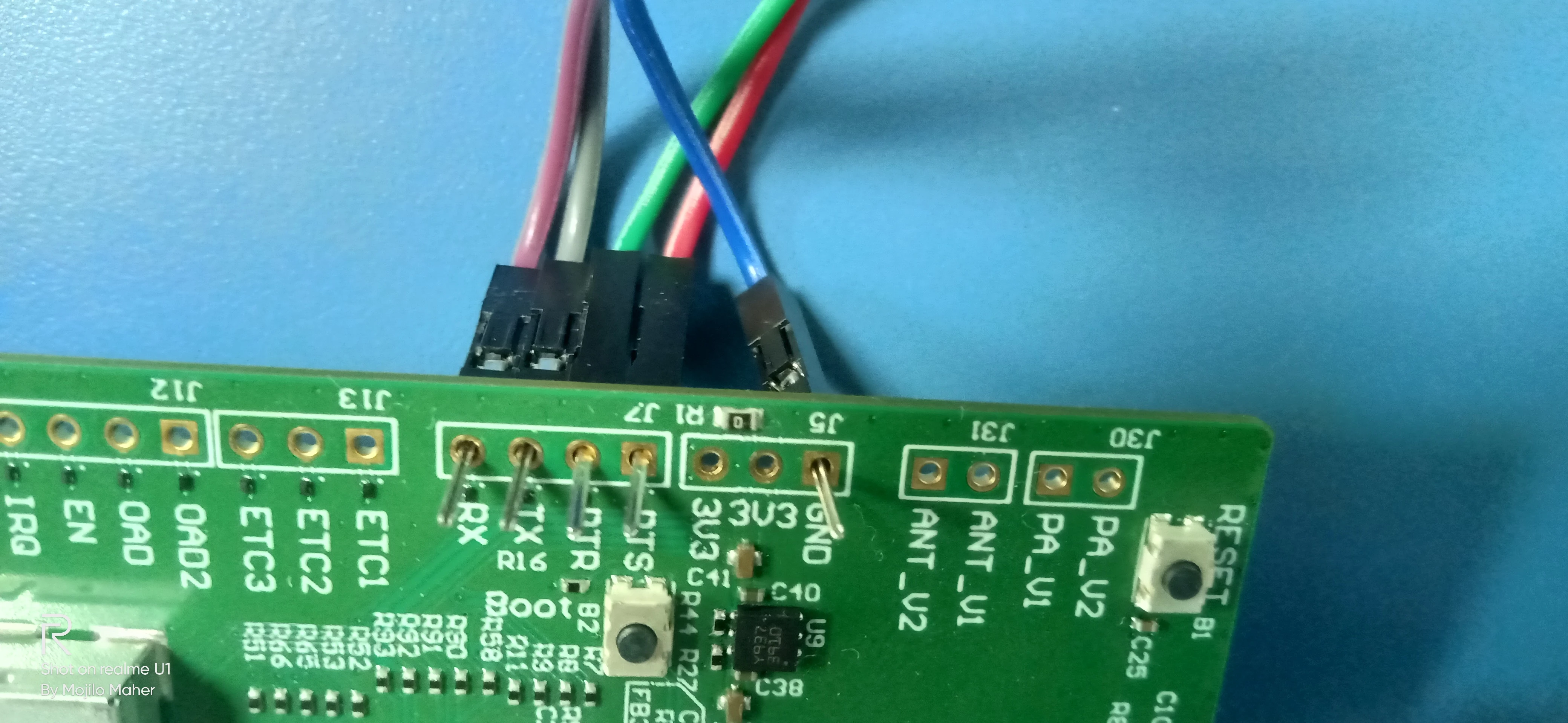

Hello SPraj1.
  • can you confirm that the CP2102 is able to operate at 3MBit/sec ? - No it is operatable upto 1Mbit/sec
    • The stock FW operates at 3Mbit/sec. If CP2102 operates with max 1Mbit/sec communication can not work. Please use a USB-UART converted which is able to work with 3Mbit/sec.

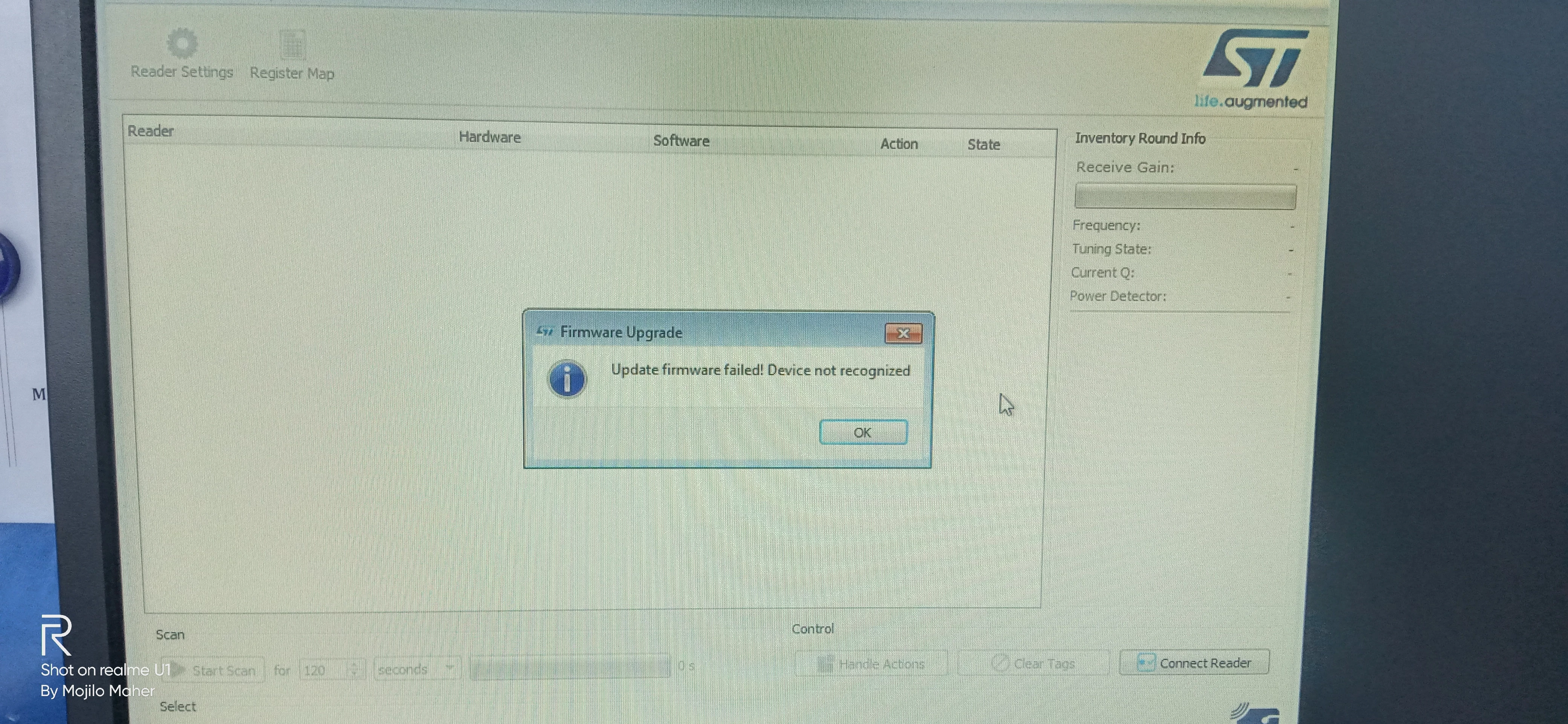

  • just to be sure, did you also connected DTR/RTS lines between the HPEV and the CP2102 ? as explained, they are needed to bring the STM32L4 into bootloader mode, if you want to upgrade the FW. DTR/RTS lines are also used by the GUI during connect and when starting the upgrade process. If DTR and RTS are not proper configured the board will not boot from User code nor enter bootloader. - No RTS and DTR lines are not connected between CP2102 and STM32l4. Already latest firmware is downloaded previously then also it asks for firmware upgrade while UART is connected.
    • RTS and DTR lines are needed to define boot-behavior of the STM32L4. If DTR and RST are not configured correct the board will not boot. Neither into bootloader code nor into user code. Please connect them as the GUI controls them to boot the board.
  • could you send a picture with your wiring between the board and the CP2102 ? - Images are attached.
    • Thanks for the picture, but the connections on the CP2102 side is not visible, the cable for GND connection is not visible and the DTR, RTS pins are not connected.
  • could you send traces of the DTR, RTS, Rx, Tx lines when trying to connect the GUI with the board ? - Did not get your question. what you want waveforms?
    • Yes, waveform captured at the DTR, RTS, Rx, Tx wires to check the communication on the wires, if it can be assumed that all wires are connected correct and communication still not work

Point#1: Currently we are not having UAB-UART bridge that support 3 Mbit/sec. So I will order it but till now What if I change the firmware baud rate to lower? in our final application STM32L4 will connect to BLE thorugh and UART and it receives command so we need to change the baud rate. So is it good to change the baudrate?
Point#2: You mean to say that RTS and DTR lines are connected to CP2102? If it is connected to CP2102 then how it can be configured by GUI application?
Point#3: GND is connedcted to another side of board so it is not visible. BLUE - Tx, GREEN - RX and BLACK -GND.
Point#4: Give me some I will ask my hardware engineer to capture the waveforms and send it to you.

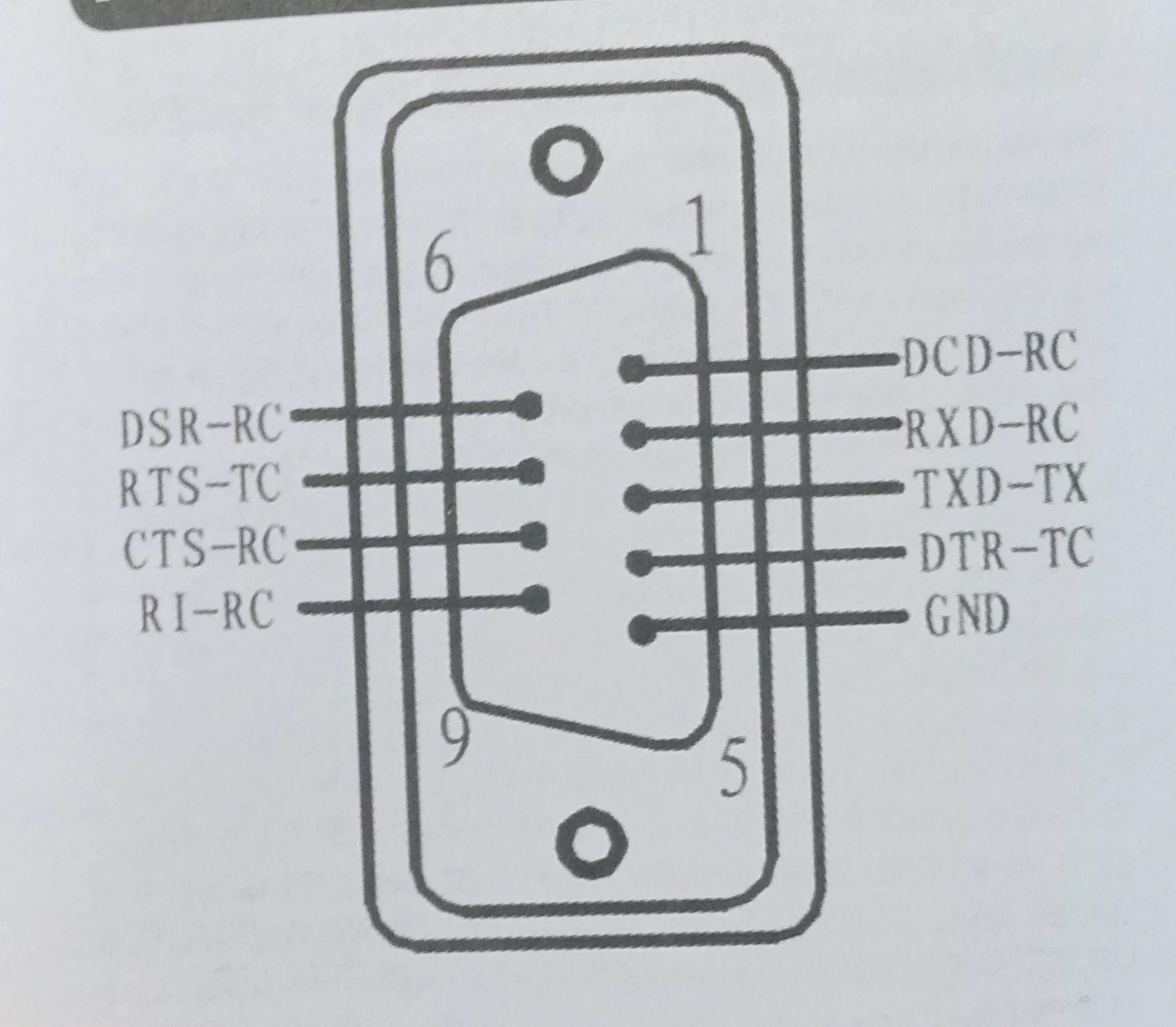

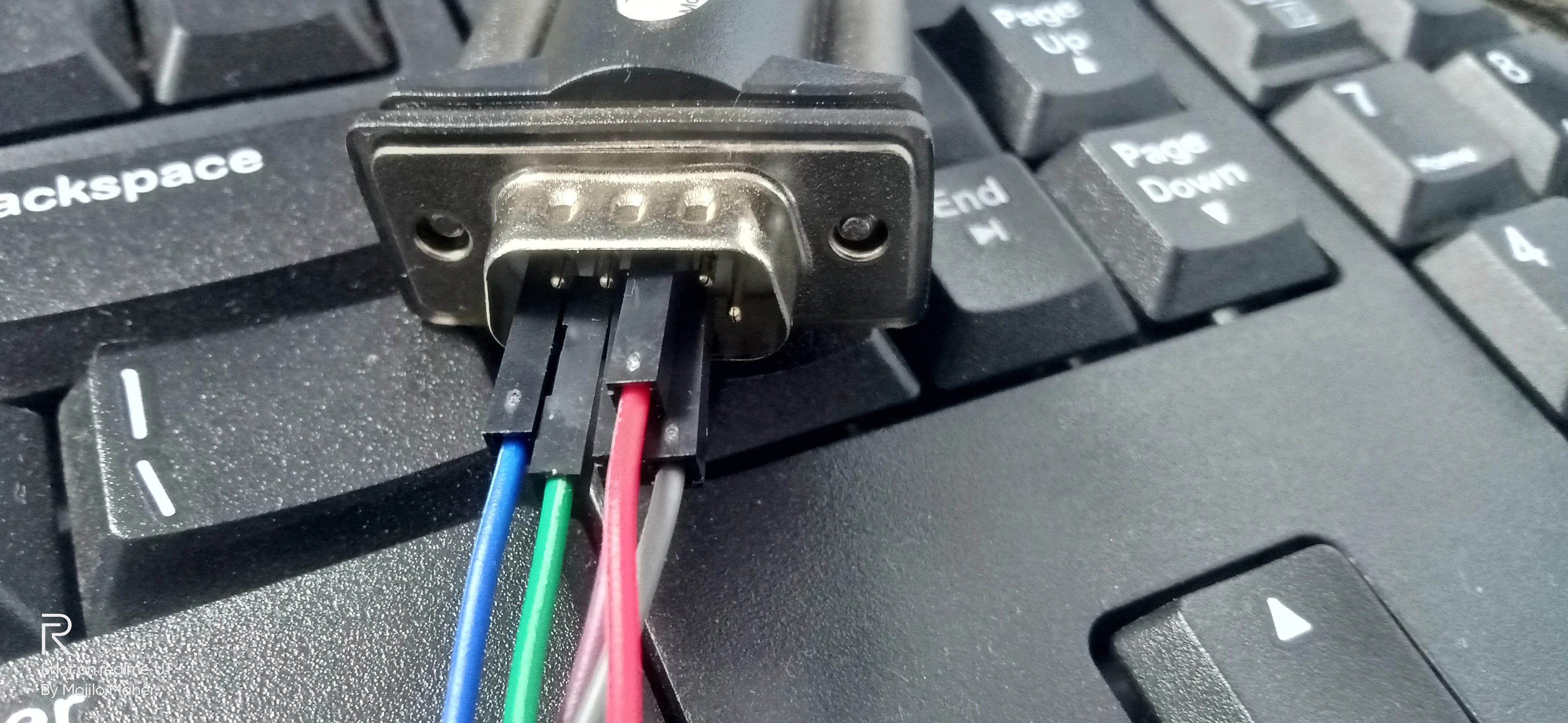

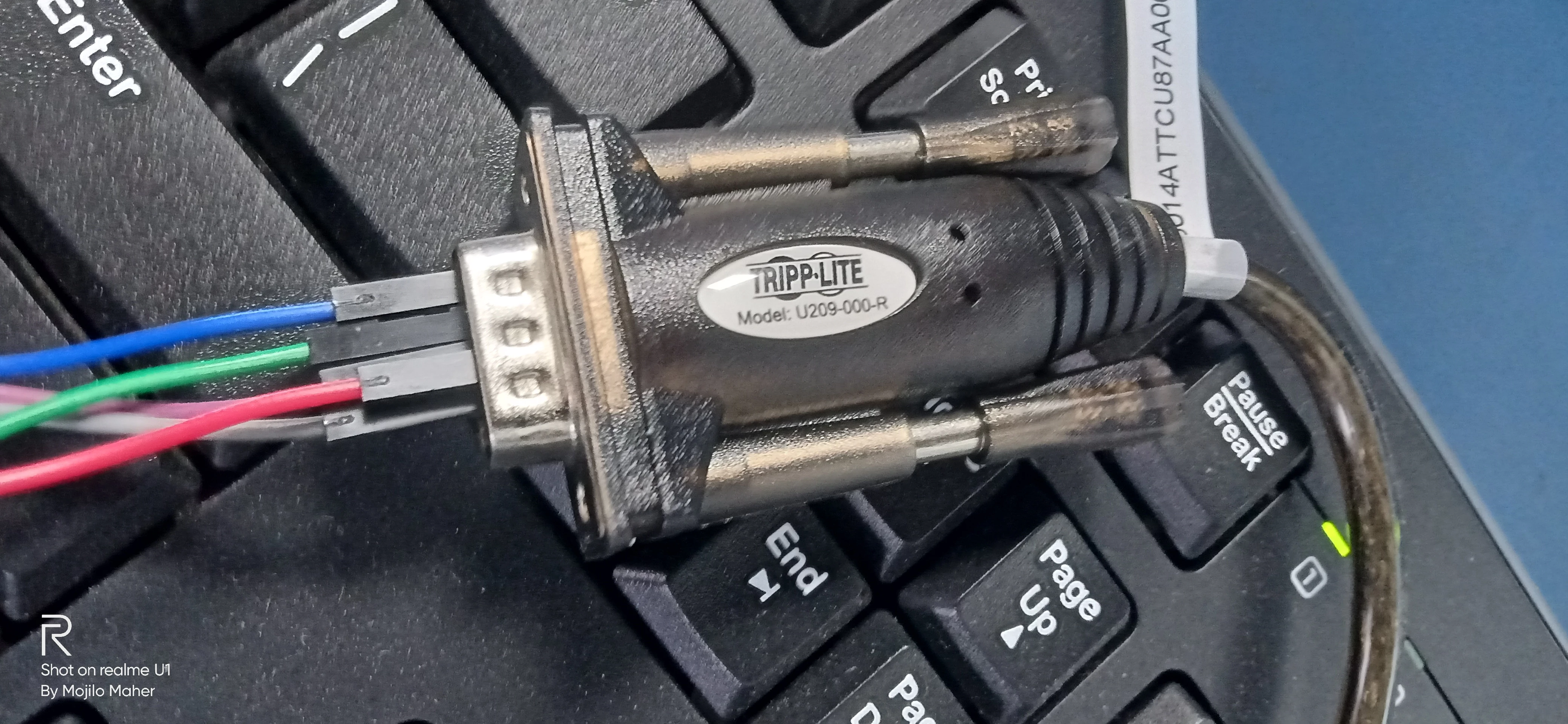

Apr 9, 2021 4:53 AM UTC
0693W000008z3nPQAQ.jpgHello Nick,
As ou said we have changed the USB UART converter and connect RTS and DTR. But still we are getting same result. I am attaching all the images for your reference.0693W000008z3nFQAQ.jpg0693W000008z3n1QAA.jpg0693W000008z3mvQAA.jpg0693W000008z3mqQAA.jpg
