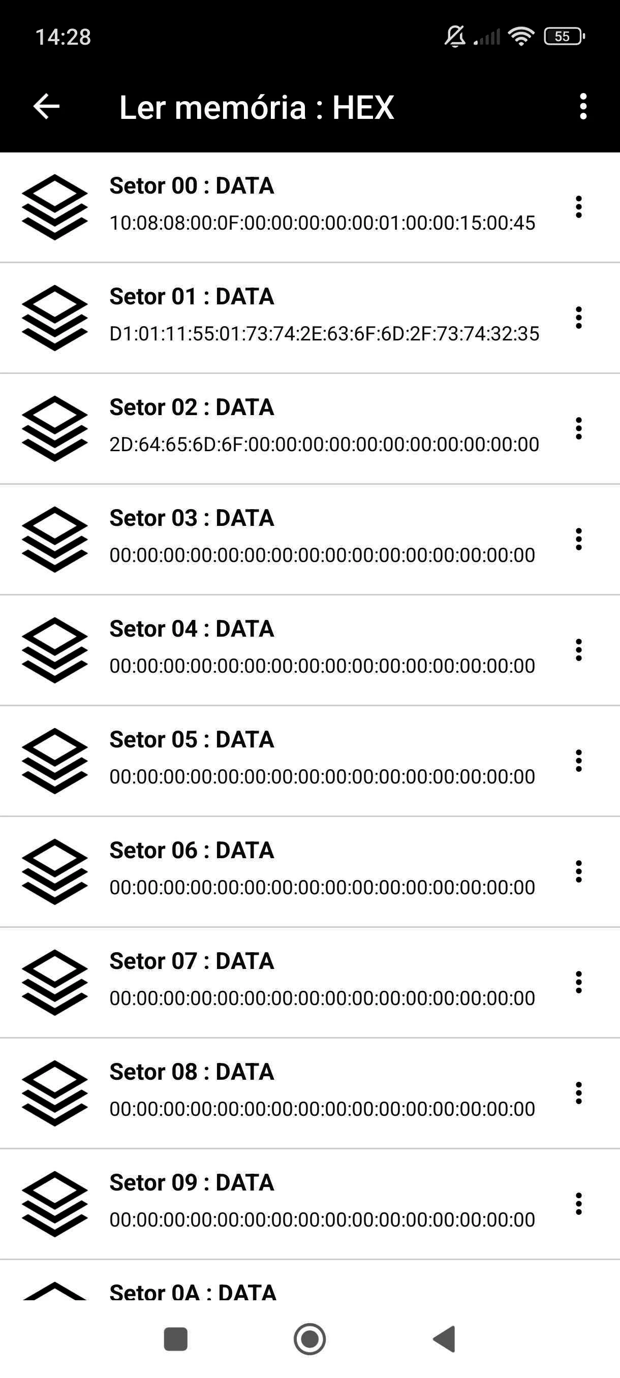

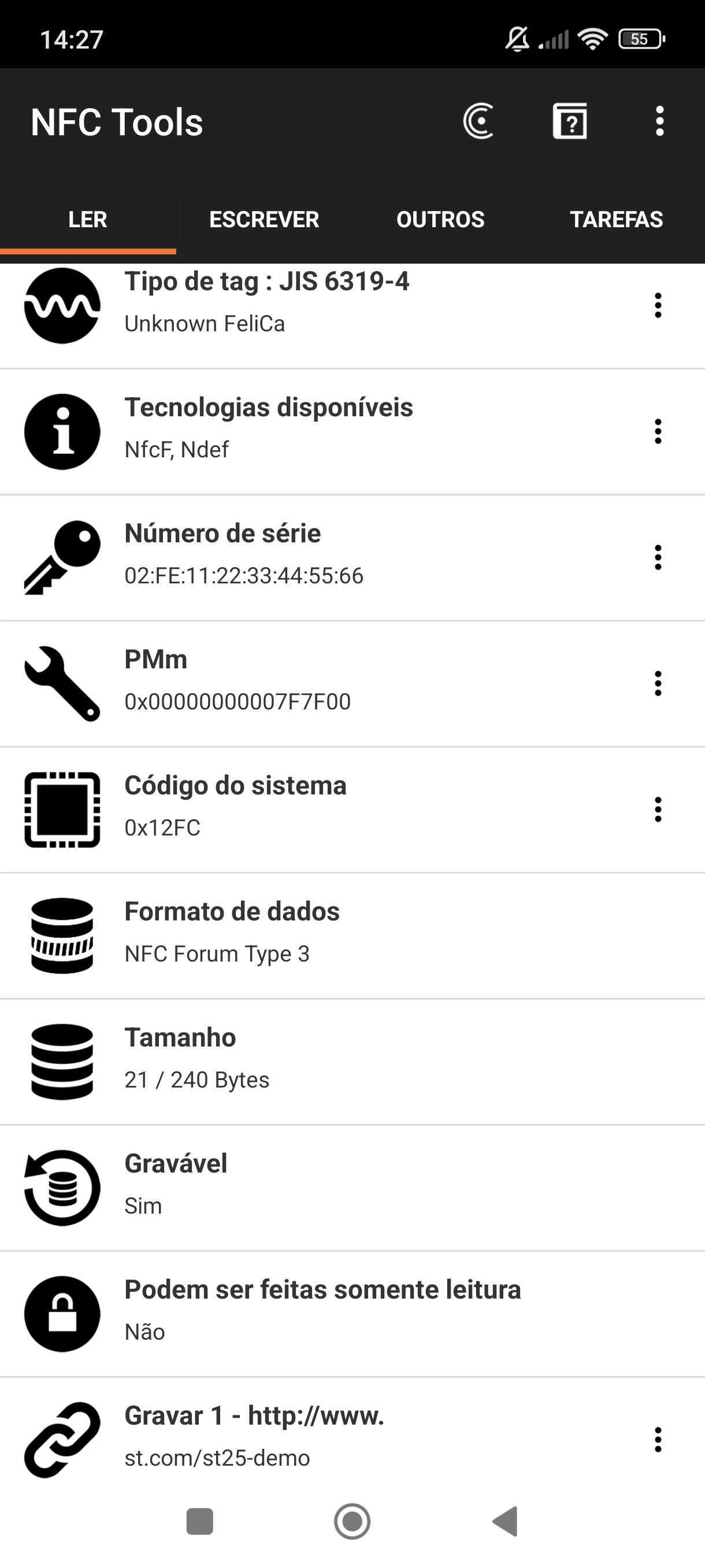

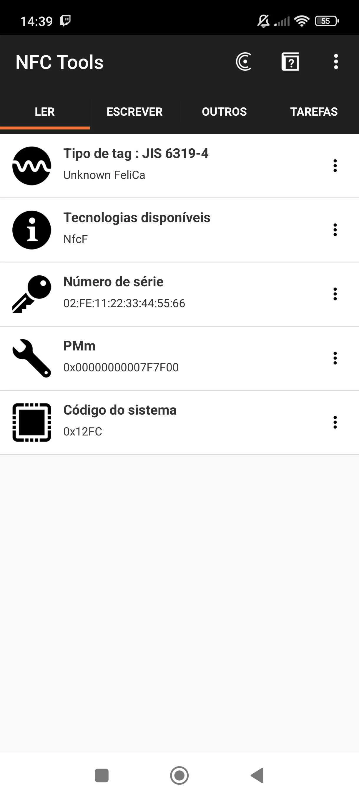

JPortilhaAuthor
January 24, 2025
Hello, for some reason I cannot read the tag using the ST25NFC application. I have tried with 2 smartphones from 2 different brands and in both cases I got the messages "Unknown tag" or "Error reading tag" in the application. However, I can read the tag using the NFCTools app and I will leave you the prints with the tag information and memory dump.
From these informations I can conclude the following:
- My smartphone is recognizing the tag as Type 3 (Felica, JIS 6319-4). I have read in some forums that bluetooth pairing requires a Type 4 Tag, but I am not 100% sure of this. Can you clarify this to me?
- When I run the default example (without calling the OOBBluetoothRecordEncode function), the smartphone can detect the ST link and acess the webpage. The memory dump also confirms this. However, when is a Bluetooth record, I cannot read the tag memory ("This tag is not supported" message), and the application shows me less information about the tag itself (I will also leave a print).
I hope this information helps, tell me if you need more information.
BR.Screenshot_2025-01-24-14-39-38-305_com.wakdev.wdnfc.jpgScreenshot_2025-01-24-14-28-10-338_com.wakdev.wdnfc.jpgScreenshot_2025-01-24-14-27-09-829_com.wakdev.wdnfc.jpg
Brian TIDAL
January 24, 2025
as far as I remember, ST25NFCTap does not provide the support for Felica tag. As an alternative, TagInfo app can be used rather than NFC Tools.
By default, the paring demo emulates both a T4T tag and a Felica tag. You can disable the Felica emulation by commenting the following line  in demo_polling.c:
Line 317: discParam.techs2Find |= RFAL_NFC_LISTEN_TECH_F;
"bluetooth pairing requires a Type 4 Tag" is probably a wrong information: I have no issue to retrieve pairing information with a Felica Card Emulation.
I've ran the pairing demo on my side and can properly decode the content of the NDEF (whatever Felica or T4T card Emulation is used). I've attached the result of the scan from TagInfo as a reference.
In order to debug your issue, the content of the CardEmulation memory is needed. It should be available with ST25NFCTap if you disable Felica or with TagInfo if you want to emulate both Felica and T4T.
