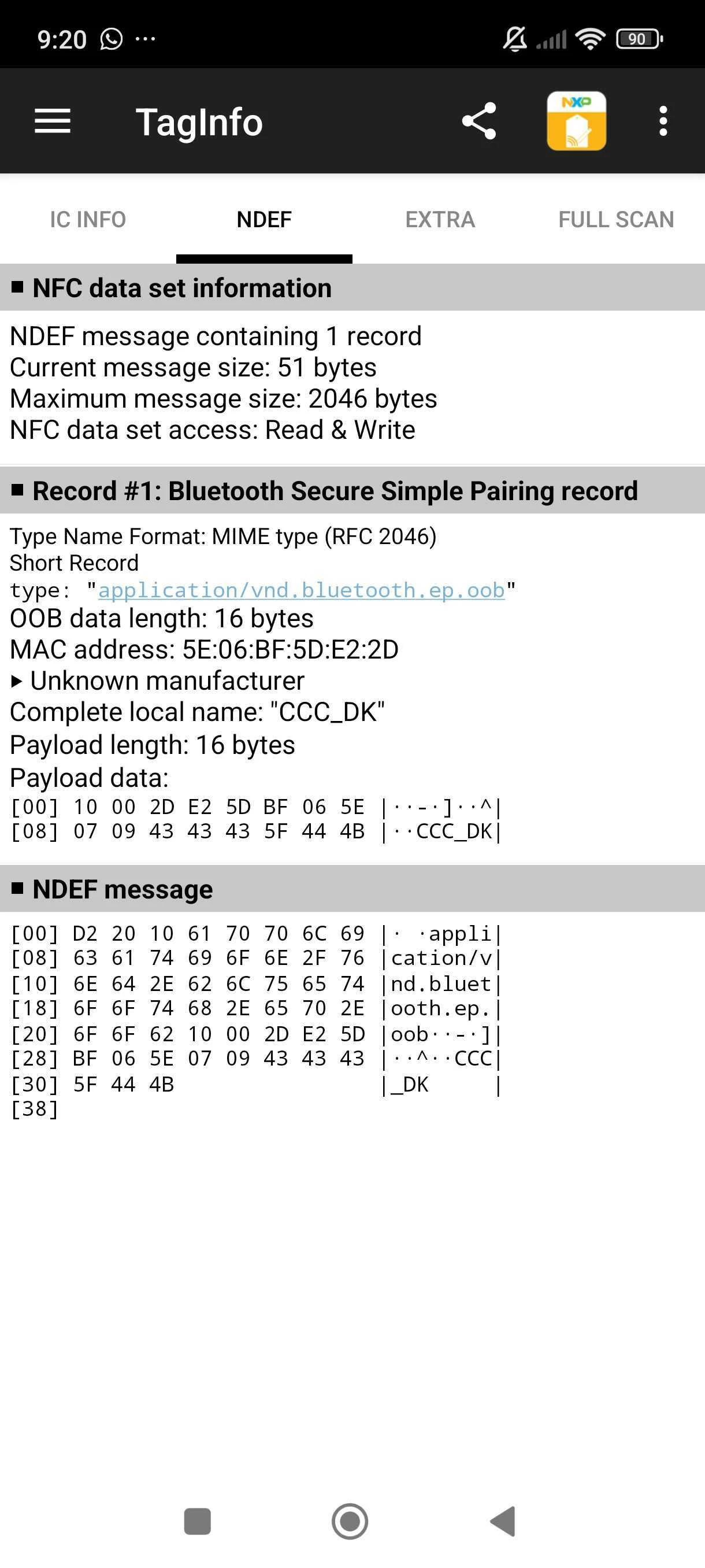

JPortilhaAuthor
January 27, 2025
For some reason whenever the logs in terminal indicate "Activated in CE NFC-A mode", from the demoCycle function my smartphone does not detect the tag. Only when the log indicates "Activated in CE NFC-F mode" is possible to read. Do you know why this is happening?
Additionaly, when I use the ndefBluetoothBrEdrInit, I can sucessfully read the memory using TagInfo application (print below). However when I use the ndefBluetoothLeInit the application says that the tag memory is empty. Can this be an hardware problem rather than software?
BR

Brian TIDAL
January 27, 2025
"however is seems that is not being correctly written in the tag": there is no tag... This is card emulation. The card emulation reads the data from the ndefFile[] buffer.
The content of ndefFile is wrongly encoded.
002B Length of the NDEF (43 bytes)
D2 Record Header
20 Record type Length (32)
0E Payload Length (14 bytes)
==> the message length is
  • 1 byte for the record header +
  • 1 byte for the record type length byte+
  • 1 byte for the payload length byte +
  • 32 bytes for the record type
  • 14 bytes for the payload
Total is 49 types. As the 2 first bytes indicates a total length of 43 bytes, the message cannot be decoded by the mobile phone.
With the proper message length (i.e. 0x31), the BLE pairing record is correctly decoded:
Make sure to properly encode your BLE pairing record and to update ndefFile[0] and ndefFile[1] with the proper NDEF message length.
Rgds
BT

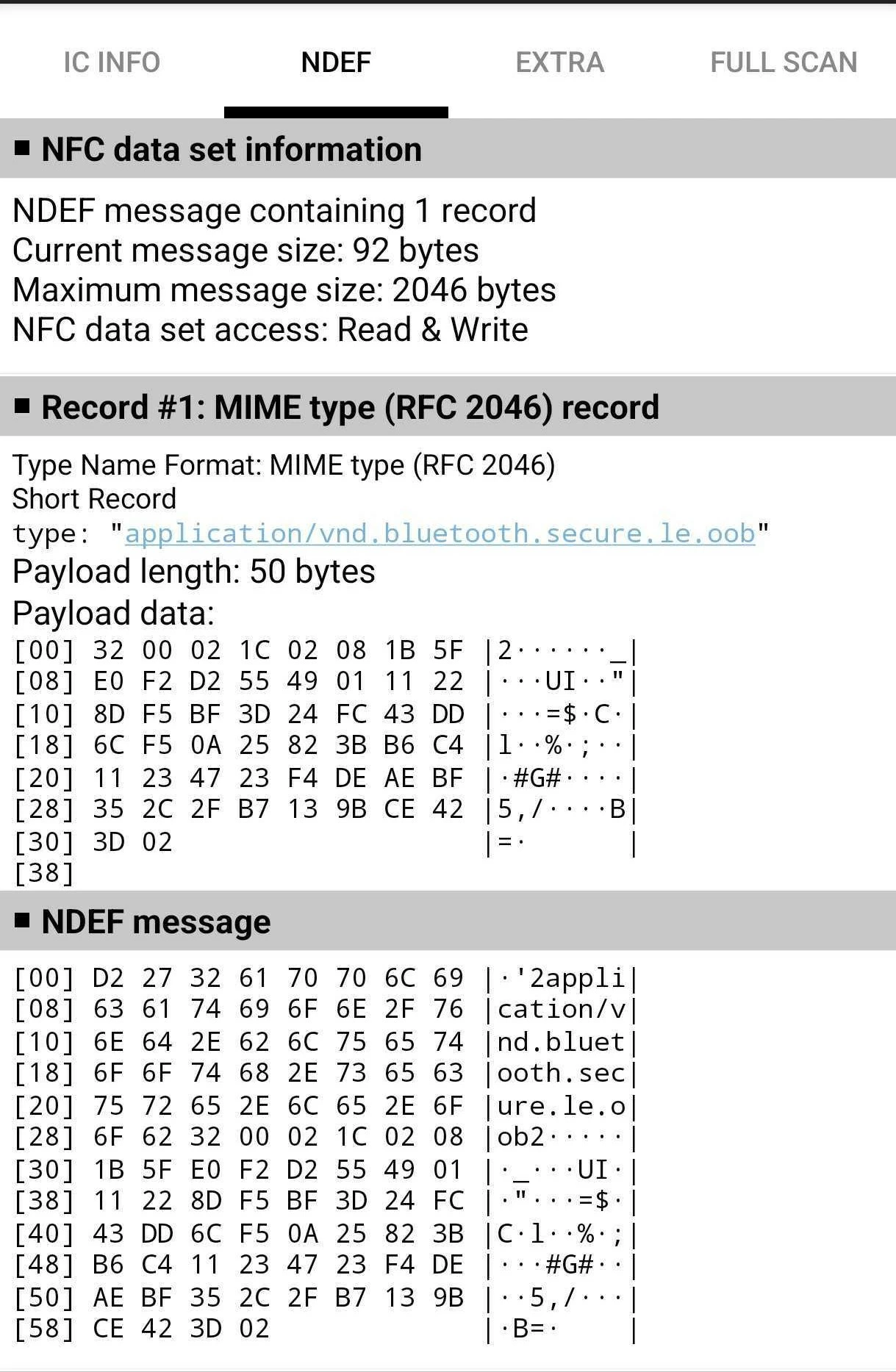

JPortilhaAuthor
January 28, 2025
Yes that seems correct, now I can start a legacy BLE pairing. Does the same logic apply to LE Secure Connections? When I init a LESC record instead of a normal one I stop being able to start pairing. I am sending Random and Confirm value instead of TK. Do I need anything else?
BR.

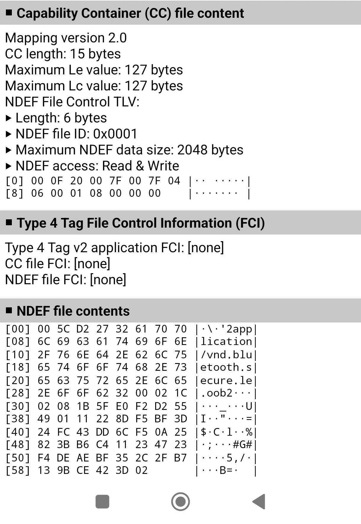

JPortilhaAuthor
January 28, 2025
I think everything is OK with the record, the smartphone can decode it as a LE Secure Connection Bluetooth Record, however when I tap the phone the pairing does not start as it happens with normal BLE.
Screenshot_2025-01-28-12-12-33-148_com.nxp.taginfolite.jpgScreenshot_2025-01-28-12-12-27-951_com.nxp.taginfolite.jpg
BR
