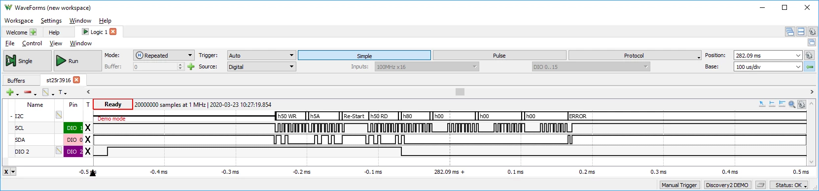

    here a brief setup scheme that shows our electrical connections and the trace derived from waveforms software.
    For controlling the st25r3916 i am currently using a nrf51822 mcu, while for tag-a slave we are using a nrf52822 mcu with nfc that acts like a card slave.
    I also include the source code used, that i derived from the st25r3916 discovery demo sources and rfal documentation.

    Ulysses HERNIOSUS
    March 23, 2020
    unfortunately the trace is not usable. In the beginning it looks ok but later on (when the field got turned on?) it gets unreadable. Please try to see to improve the quality - twist wires, move them away from the antenna, etc.

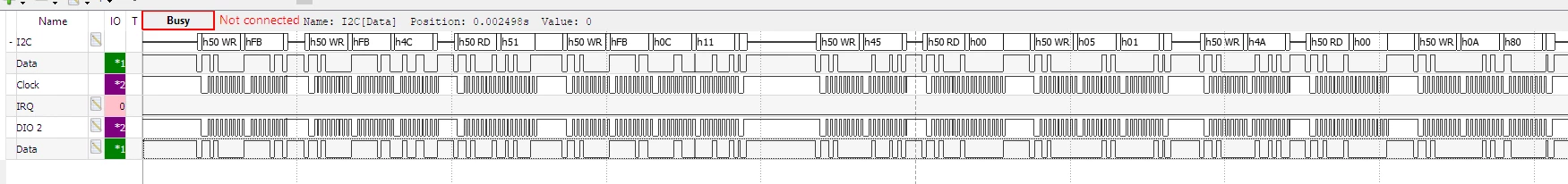

    For your reference I am attaching two screenshots of clearing an interrupt. The first one which looks ok. and a second one where the payloads make no sense at all.
    Regards, Ulysses

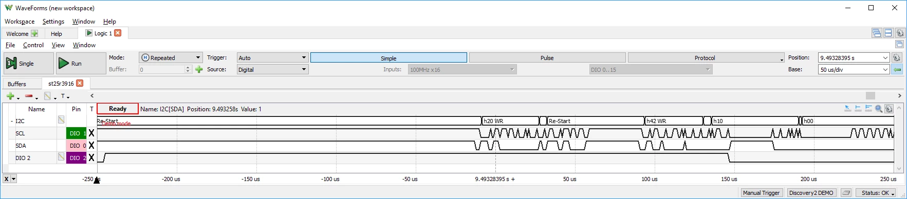

    Ulysses HERNIOSUS
    March 23, 2020
    And here the good interrupt handling. You can see the device address, the 5Ah for reading interrupt status and all the received bytes.
