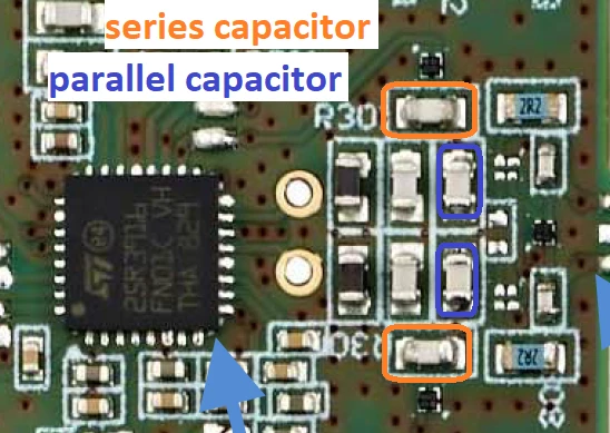

    e.g. MB1414-B:
    C303, C314 (series capacitors) = 150pF
    C307, C312 (parallel capacitors) = 200pF (180pF in parallel with 22pF)
    MB1414-A
    same location different designator.
    Please let me know, if this is working for you.

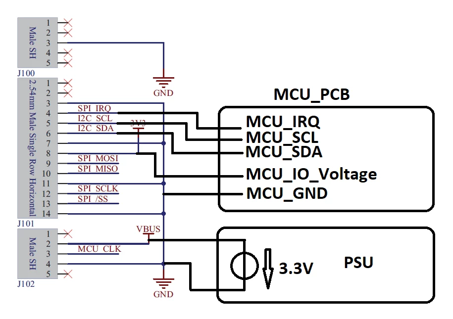

    Travis Palmer
    March 20, 2020
    1bit corresponds to 13.06mV. 100dec should be equivalent to 1,306V on the RFI pins, 171dec should be 2,23326V. In general these values are good.
    Your i2c connection is not entirely clear to me. Below is a schematic of all necessary connections do drive the ST25R3916-DISCO MB1414-B with an external MCU PCB.
    All these connections are mandatory for i2c.
    Please let me know, if this solves your problem.
    BR Travis
    MPeli.1
    MPeli.1Author
    March 20, 2020
    Yes mine is the same, i just took the i2c and irq, pin 1-2-3 of cn100 connector as for page 26 of the user manual of the discovery board.
    Vbus (pin 2 of the image that you linked) was disconnected, but since switch is on 3v3 position it should be ok right?
    I tried connecting it to 3v3 but nothing changes.
    Thank you very much,
    Regards
    Travis Palmer
