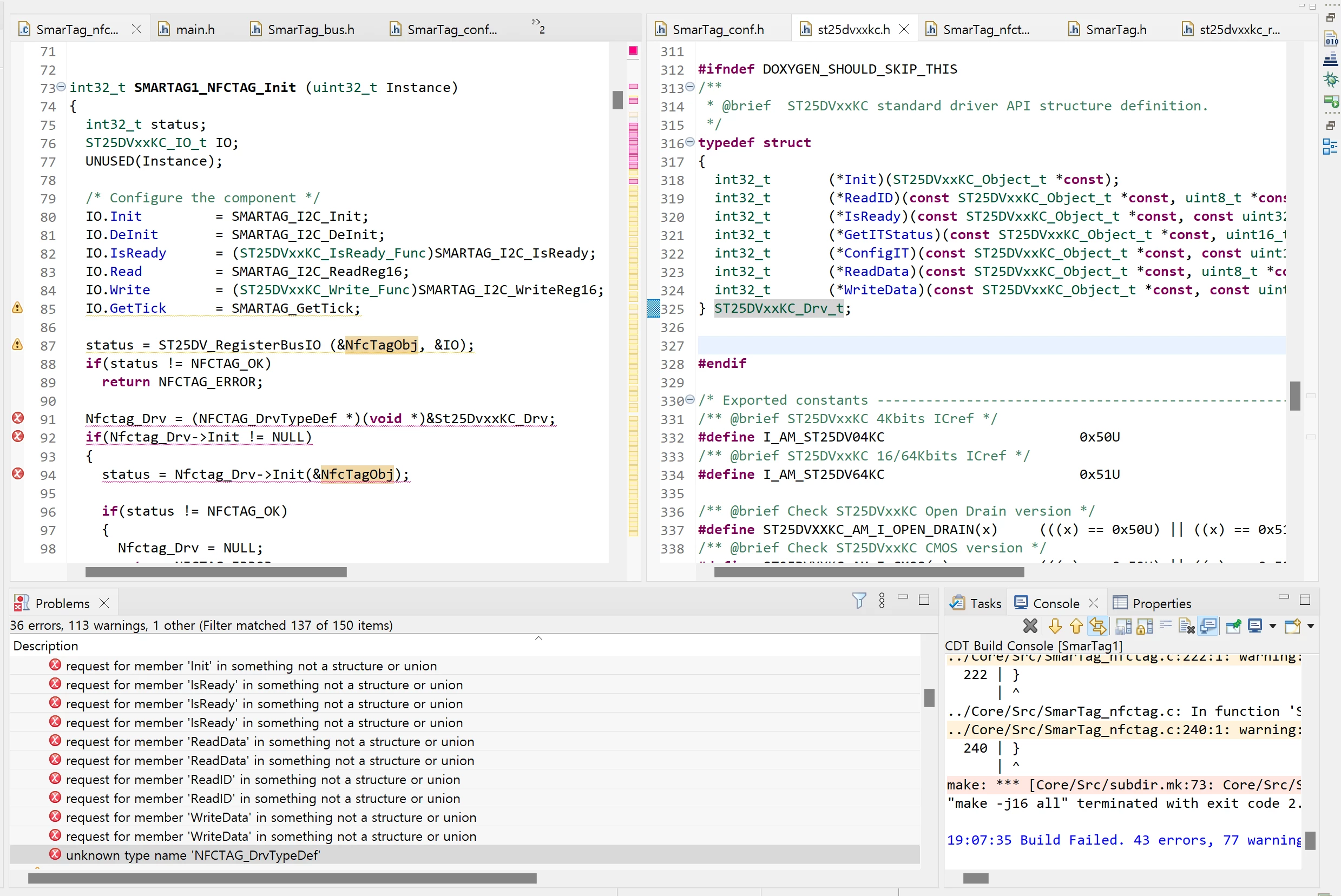

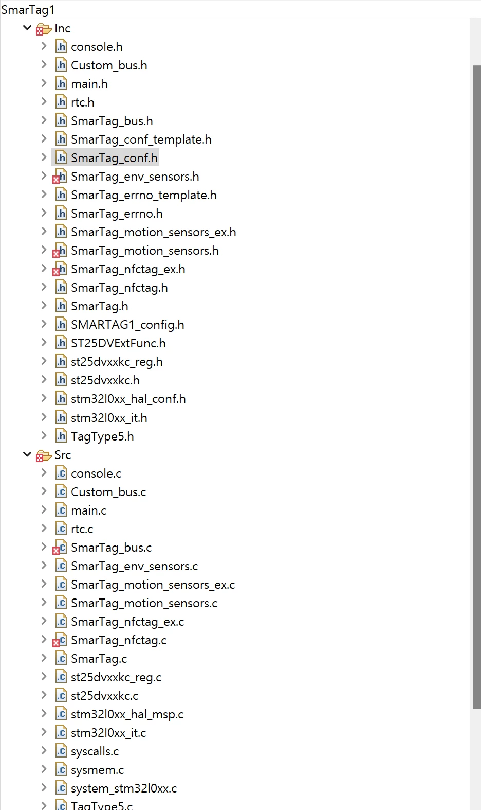

WPARK.1
WPARK.1Author
January 23, 2023
Actually, I did similar thing you recommended here.
  1. Opened project with SMARTAG1 IOC.
  2. Substituted ST25DV source and header file to ST25DVxxKC
  3. Redefine address to ST25DVxxKC from ST25DV
But I still have error like (unknown type name 'NFCTAG_DrvTypeDef') and I could not find the place where NFCTAG_DrvTypeDef is defined.

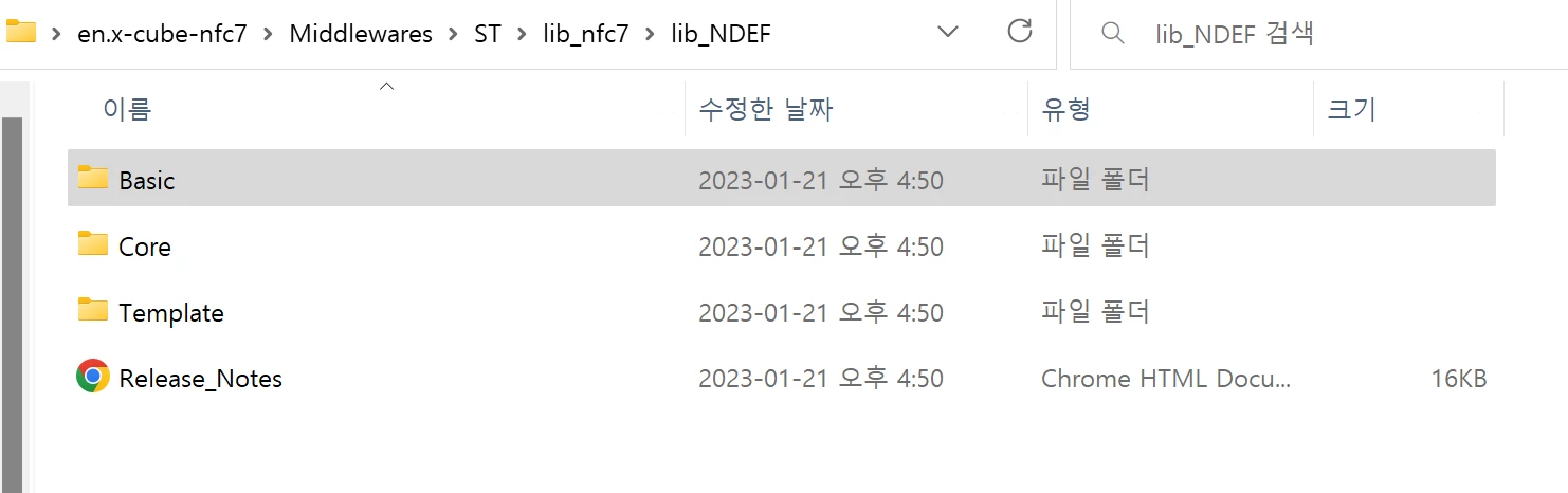

It is a bit hard for me to determine which source and header files are required to be imported from different projects. Furthermore, if I use IOC, it shows an error that I2C and some functions are overlapped (Due to the IOC file, they are automatically defined and for BSP file and main.c from the project, they are also defined so it causes crack among them)
Thank you for reading.
Rene Lenerve
January 23, 2023
Hi @WPARK.1​,
I was trying to port it to STM32CubeIDE on my side, and at the end I got the following message :region `FLASH' overflowed by 9836 bytes (with max optimization).
Then reading the readme file of the project, I found this information :
 - When the source code get compiled through the STM32CubeIDE toolchain it slightly overcome the maximum available memory.
 For that reason the related project is excluded from the package.
 - debug mode is not available.
So it seems that with STM32CubeIDE it is not possible to compile this project for that MCU.
Keil has a free license for compiling binaries under 32KB . The binary for this project is 30KB so you should be able to compile it, but adding code will lead to license problem.
Kind regards
