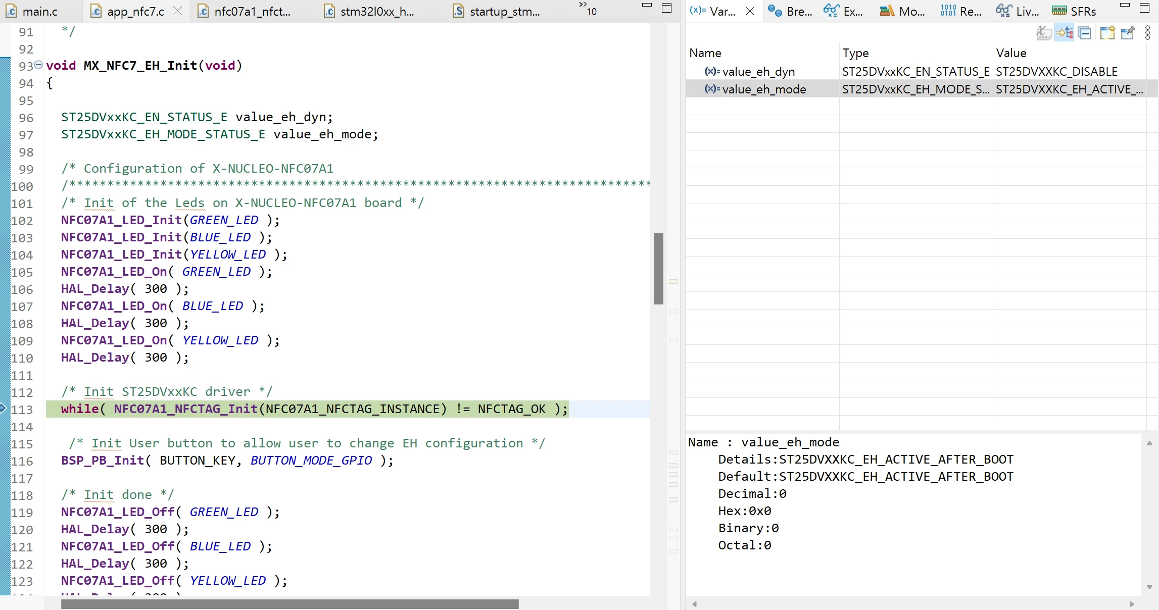

Now I received NUCLEO-L053R8 and X-NUCLEO-NFC07A1 and operating EH example provided by STM32CubeIde. However, there is a problem in MX_NFC7_EH_Init.
On debug mode, if I "Step Into"  while( NFC07A1_NFCTAG_Init(NFC07A1_NFCTAG_INSTANCE) != NFCTAG_OK );, it is not stuck but on running mode and if I do "Step Over", the whole section of firmware is stuck.
0693W00000Y9S8vQAF.pngThank you for reading.

January 30, 2023
Same thing happens for NDEF example.
I think
while( NfcType5_TT5Init( ) != NFCTAG_OK );
These lines having some problem as it cannot return NFCTAG_OK without manually "Step Into" in the debug mode. (Running mode stuck after LEDs are turned on).

Rene Lenerve
January 30, 2023
Hi @WPARK.1​,
I have downloaded NFC7 v1.0.0 package on st.com, and I tried both projects, it was working fine in debug and running mode for me. I tried with STM32CubeIDE and Keil and same behavior with debug and running mode.
Can you get the value returned by nfctag_id in the function ST25DVxxKC_Init from st25dvxxKC.c file (both in debug and running mode) to see if the program read the correct value (for NFC7 should be 0x50 or 0x51).

It is good news that after updating my cubeIde to 1.11.2. It is working now. Therefore, I modified EH project code to detach the BSP button and LEDs while it is always working in EH mode (Active boot).
For EH project, I have one more question. As you told me EH_mode is nonvolatile, if I already set ST25DVxxKC_EN_STATUS_E = ST25DVXXKC_ENABLE and ST25DVxxKC_EH_MODE_STATUS_E = ST25DVXXKC_EH_ACTIVE_AFTER_BOOT for my extension board ST25 chip, can I remove MX_NFC7_EH_Process (as in my case, I will not turn off EH function).

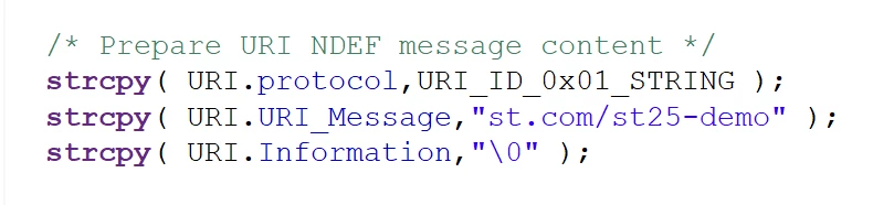

And for NDEF example, I have some questions.
0693W00000Y9VSAQA3.pngIt is very interesting that by this strcpy function, can directly change the payload length and set other headers. What is the URI_ID for MME (Text, in my RF430 code, I use 0x02, // URI header identifier). And furthermore, what is the difference between URI_Message and Information. It is a bit confused as I originally used TI chip for NFC.
In my case, I want to send ADC sensor values in TEXT format when I put my mobile phone to my ST25.
I will attach my RF430 NDEF format.
0693W00000Y9VSAQA3.pngAnd furthermore, what is the difference between URI_Message and Information. It is a bit confused as I originally used TI chip for NFC.

  • For EH, if you have set the register to the value ST25DVXXKC_EH_ACTIVE_AFTER_BOOT, EH will be always active (when a field is present) until you modify this register. (please read the DataSheet of the ST25DV64KC to have more information on it and other features).
  • For NDEF, NDEF is a file format message described by the standard from NFC Forum specifications, it describes how data are organized in the memory. There are multiple formats defined by NFC Forum, URI is one to store URI information as for this example an URL (could be also phone number, email, ftp, ...). The field information is just additional information used for smart poster (it is an extended format that contains more fields not mandatory to store only an URL). For NDEF Text format you need to use another format than the URI, in the ndef lib you have a file named lib_NDEF_Text that allow you to build such messages. But it is recommended to read the standard or find some resources on google to learn more about NDEF format (This standard is used for applications with NFC but are not NFC spec).
