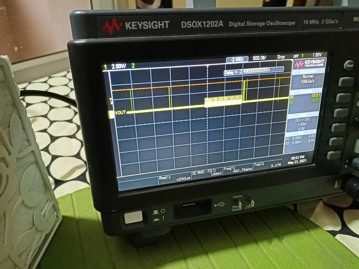

RShiv.1
RShiv.1Author
May 21, 2021 11:35 AM UTC
Hi BT,
SPI init is succeeding whereas INT i s failing what could be the issue??..hardware NFC05A1...then how do we proceed from here??,,kindly help us on this.
regards
Ravi
Brian TIDAL
May 21, 2021 11:50 AM UTC
is the Gnd properly connected on the scope probe?
Can you confirm that you have press the B1 reset push button on the STM32L476VG-DISCO  while probing?
is the CN8.1 pin high or low?
Have you properly connected ST25R3911B VDD_IO and VDD power supply?
Rgds
BT
RShiv.1
RShiv.1Author
May 21, 2021 12:09 PM UTC
Hi BT,
1.Yes, the GND is connected properly on the scope probe.
2.Yes we have pressed the B1 reset push button on the STM32L476VG-DISCO.
3.CN8.1 pin is low
4.Yes we are seeing the green light in ST25R3911B  board..we are seeing SPI init passed as mentioned earlier.
regards
Ravi
RShiv.1
RShiv.1Author
May 21, 2021 12:18 PM UTC
Hi BT,
attaching the SPI CLK . for your reference we are seeing clk for every sec
rgrds
Ravi

Brian TIDAL
May 21, 2021 1:51 PM UTC
Can you measure ST25R3911B VDD and VDDIO?
Rgds
BT

Brian TIDAL
May 21, 2021 2:52 PM UTC
Hi
Can you check whether R200 is properly soldered on the X-NUCLEO-NFC05A1? can you probe INTR_11 on the board while resetting the MCU?
Rgds
