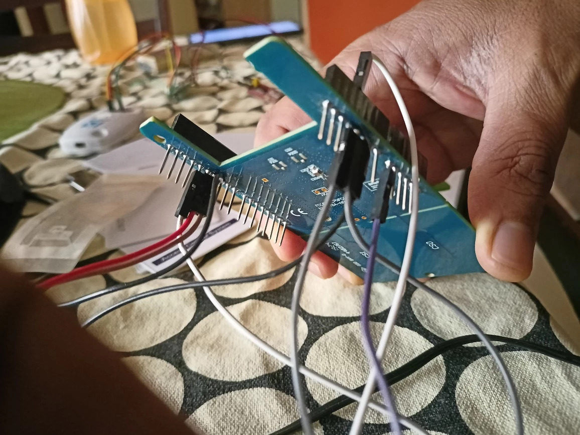

RShiv.1
RShiv.1Author
May 21, 2021 9:56 AM UTC
Hi BT,
Yes we are sure we have connected to CN8 pin1 ..attaching the pics for your reference..
No interrupt seen when probing in scope..on the MCU side and also on the CN8.
regards
Ravi

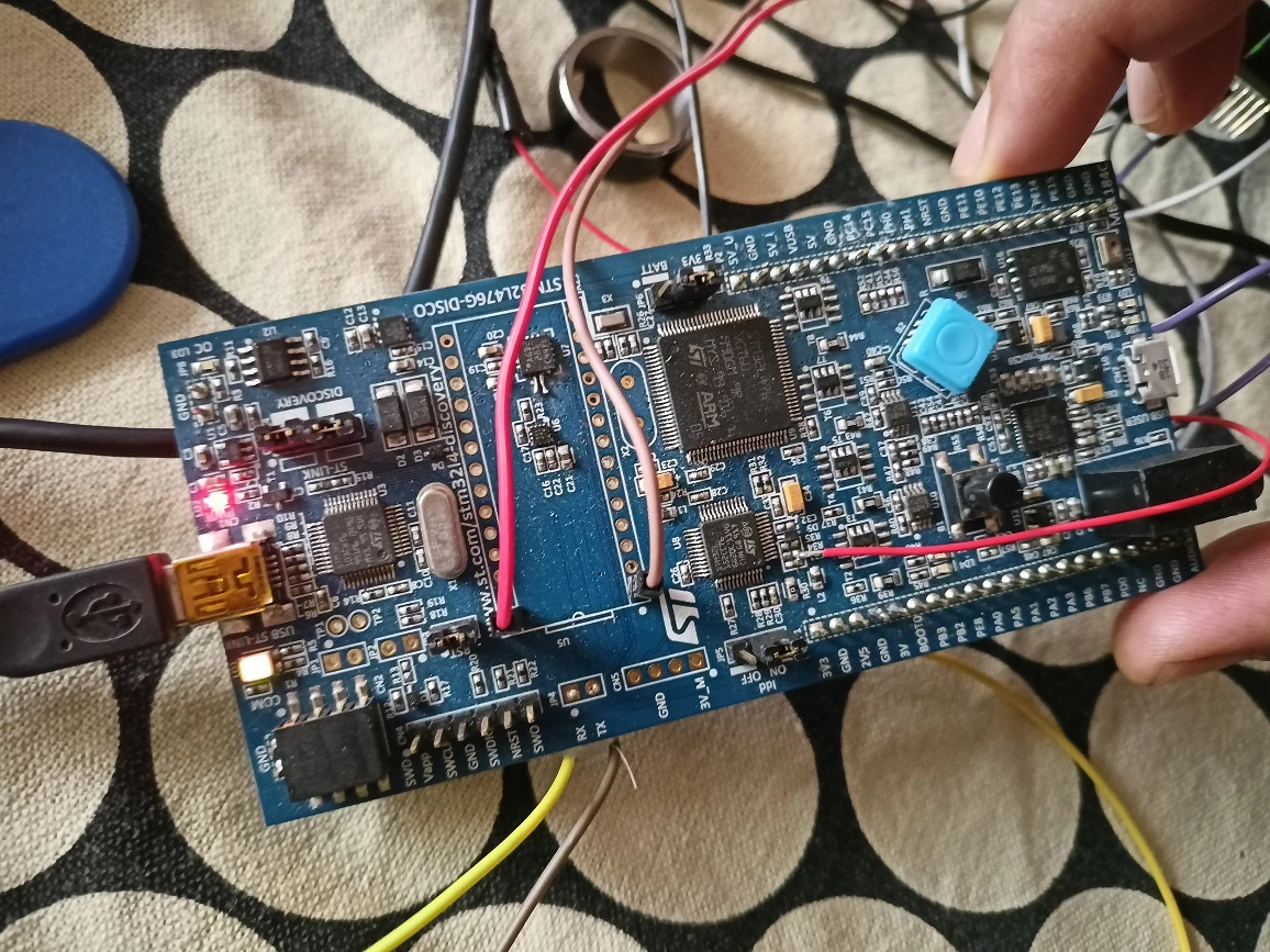

RShiv.1
RShiv.1Author
Hi BT,
attaching for PA3 and PA5

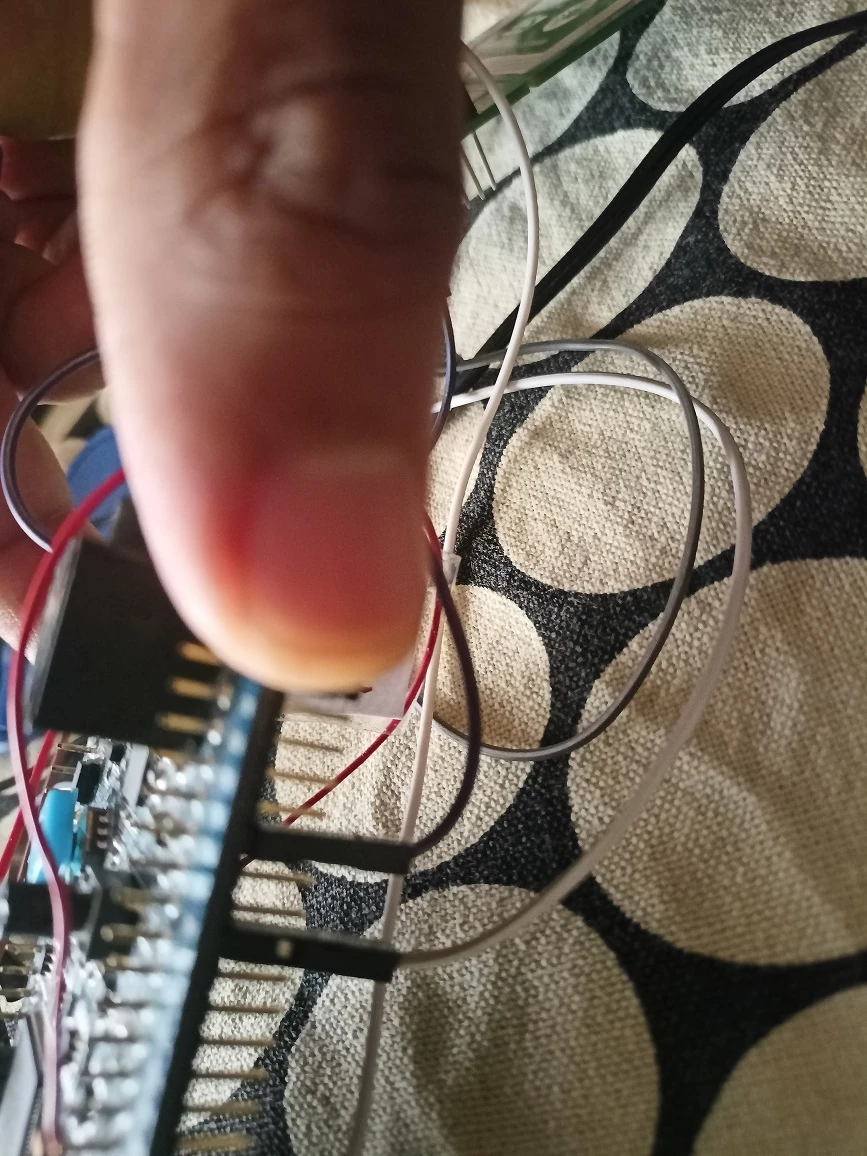

RShiv.1
RShiv.1Author
May 21, 2021 9:57 AM UTC
Hi BT,
attaching for PA4 ,PA2and PA6.
regards
Ravi
RShiv.1
RShiv.1Author
May 21, 2021 9:58 AM UTC
Hi BT,
let me know if these connections are fine.
regards
Ravi
Brian TIDAL
May 21, 2021 10:27 AM UTC
disconnect the ST25R3911B IRQ pin from the STM32L476VG-DISCO board and probe the IRQ on the X-NUCLEO-NFC05A1 with a scope (CN8 pin 1) : when resetting the MCU, you should see a falling interrupt just after few SPI exchanges following the MCU reset.
Do you see the interrupt?
Rgds
BT
RShiv.1
RShiv.1Author
May 21, 2021 10:41 AM UTC
Hi BT,
No we are not seeing any activity after removing PA3 and connecting to CN8 pin 1 on the NFC side.
regards
