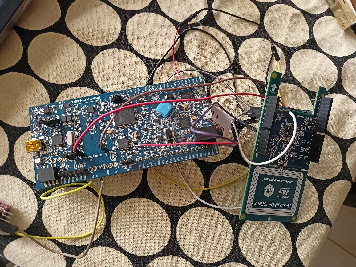

since Interrupt is coming from ST25R3911 it must be GPIO_INPUT..is this correct??
regards
Ravi
Brian TIDAL
May 20, 2021 1:57 PM UTC
as explained in previous posts, the PA3 GPIO connected to the interrupt line has to be configured as GPIO_EXTI3 external interrupt mode with rising edge trigger detection.
If the interrupt is not seen, I suggest to check the board with your HW engineer.
Rgds
BT

Brian TIDAL
May 20, 2021 2:44 PM UTC
Hi, You mean you are using the ST25R3911B-DISCO and have connected the SPI + IRQ from X-NUCLEO-NFC05A1 on P204 points and have isolated the onboard ST25R3911B?
Well, in that case, the IRQ pin is connected to PA0 EXTI0 (see schematicshttps://www.st.com/content/ccc/resource/technical/layouts_and_diagrams/schematic_pack/group0/71/e3/fd/6c/0c/db/42/21/Schematics-ST25R3911B-DISCO-MB1325/files/Schematics-ST25R3911B-DISCO-MB1325.PDF/jcr:content/translations/en.Schematics-ST25R3911B-DISCO-MB1325.PDF).
So if using the the ST25R3911B-DISCO, you have to modify you SW to use PA0 instead of PA3.
Rgds
BT

RShiv.1
RShiv.1Author
May 20, 2021 5:51 PM UTC
Hi BT,
As we are using nucleo board NFC05A1 - and STM32L476VG ...we are wired from PA3 ..so anything PA0 or PA3 can be configured right and also
in main.h we have pointed IRQ pins as follows
#define IRQ_3911_Pin GPIO_PIN_3
#define IRQ_3911_GPIO_Port GPIOA
#define IRQ_3911_EXTI_IRQn EXTI3_IRQn
is this correct?..if we configure for PA3 then this becomes GPIO_PIN_3 and if PA0 GPIO_PIN_0...is this methodology correct??
I think we had configured this to pin 0 and EXTI0 ....let me know
regards
Ravi

RShiv.1
RShiv.1Author
May 21, 2021 5:42 AM UTC
Hi BT,
attached is the img of X-nucleo-NFC05A1 along with STM32L476G-disco board which we have connected .Here we have used PA3 and configured the same in stmcubeMX as said in our previous post.
